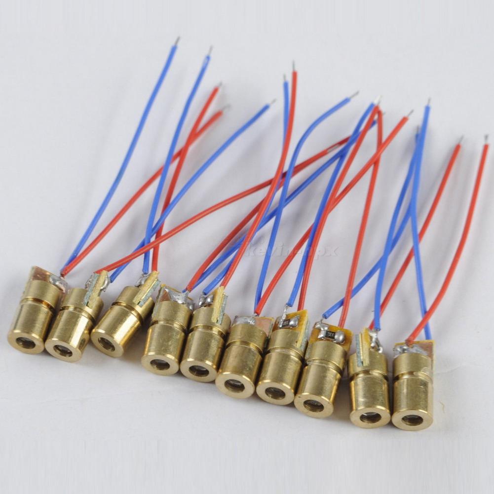

Tonight I finished up the LEDs in the headlight and taillight assemblies. I also ordered some of these lasers for target acquisition. :) These are only 6mm in diameter. Should be able to mount them in the mantle and try to sight it in with in reason. Hoping to run the sighting system off the aux power on the Clark board.

pale, I did that on my ZTZ using the same ones, make sure you put a resistor on them, as the AUX power on the Clark is full 5.0v + as it is not a LED power like the headlight and the MG. I learn this the hard way.

MichaelC wrote:pale, I did that on my ZTZ using the same ones, make sure you put a resistor on them, as the AUX power on the Clark is full 5.0v + as it is not a LED power like the headlight and the MG. I learn this the hard way.
Resisiter on power side? Thanks for the heads up.

Either way it doesn't matter. As long as it is on the circuit path. If you don't the laser will loose focus after a minute or so from over power.

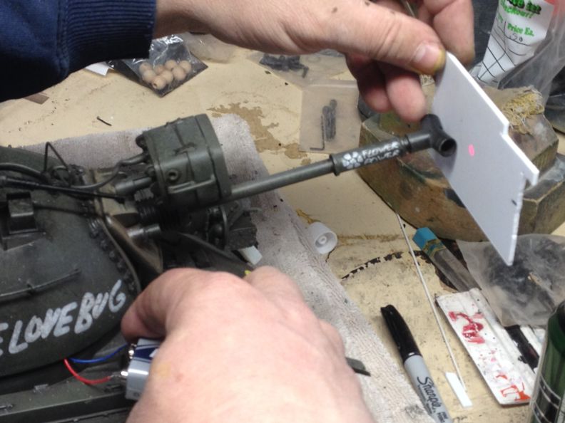

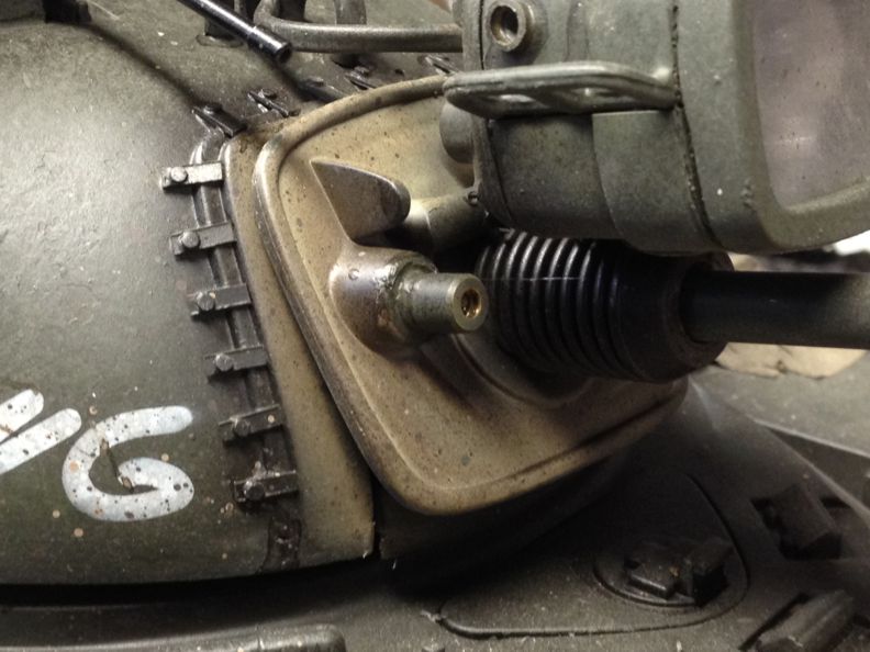

Tonight I tore the barrel assembly down and added the target acquisition system. :) It went pretty smooth and has a range of about 20-25 feet in modest lighting. Maybe give me an advantage in night time battling. :)
