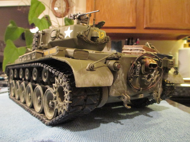

W.W.,

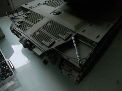

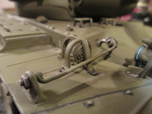

Thanks for the lesson on 3D printing. I have a lot of questions and have been guilty of seeing the process as a do-all panacea for our Hobby. My fender turnbuckle solution was a rod with 'welded' on supports that were mounted using small screws. Sturdy and looks good but not quite scale.

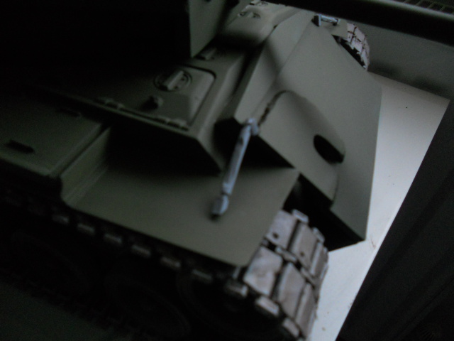

Re: Super Pershing
I was thinking of doing much the same with brass rod, and then sliding some styrene tube over it to create the centre section. It wouldn't be 100% accurate but it would look ok from a distance.

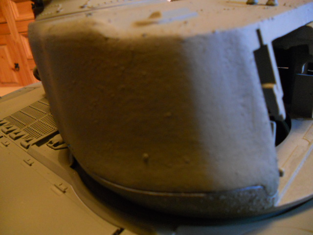

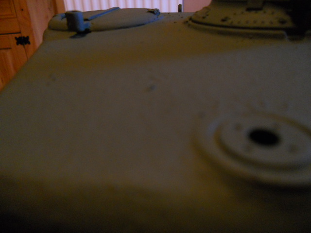

I did some texturing on the turret today, and gave it a once over with primer and the airbrush. Rather than buy expensive texturing stuff, all I do is apply a puddle or two of superglue, and then spread it around and tap it repeatedly with a toothbrush. Keep tapping rapidly until the superglue hardens. You end up with a nice cast surface. If you want it rougher, use plastic glue, as it melts the plastic. You can see a bit of that effect on the lower turret in the pics. The parts can be primed and painted almost straight away, as the glue dries in seconds. Any large bumps that appear can either be scraped off with a fingernail or lightly sanded. It's a cheap as chips, and gives a nice natural non-uniform finish.

Re: Super Pershing

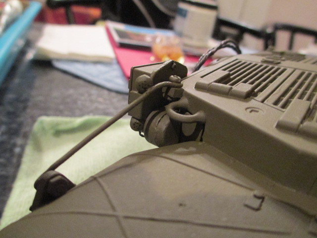

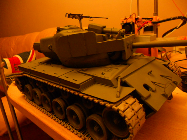

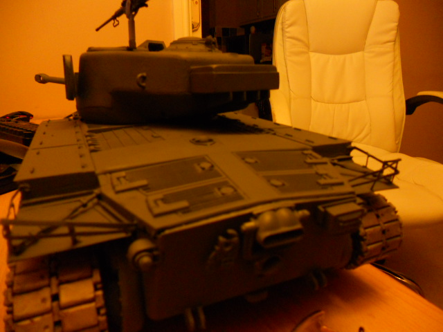

Did some turnbuckles, just need to glue them in place. It needs a few more coats of paint and detailing/weathering, but it's almost done now.

The turnbuckles look really good! The whole tank is very pleasing to the eye. Following along.

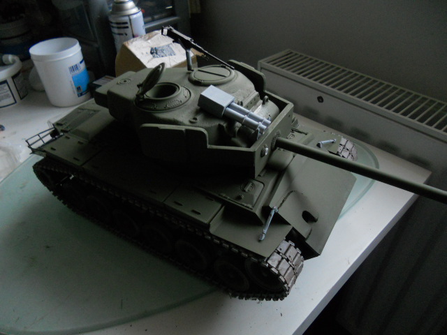

I am looking forward to getting this one running, I really want to find a way of compressing the front suspension like the real one, will have to figure that one out. I should be able to make some real progress this week.

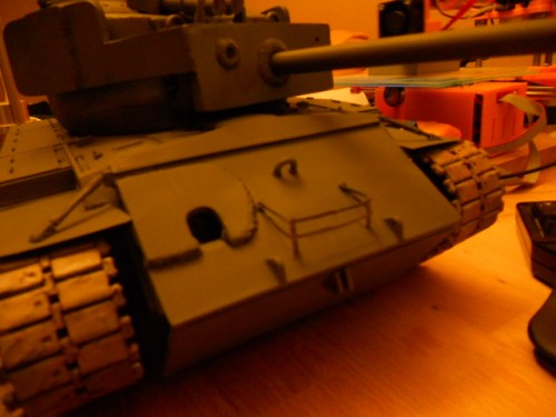

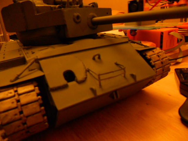

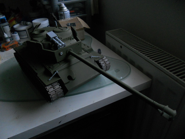

Getting close, all green now, will start on a bit of rust and weathering soon. The hull machine gun plate annoys me every time I look at it, cos I know that it is the wrong shape. . grrr

Re: Super Pershing

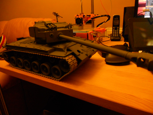

Still painting it, almost done the rubber paint on the road wheels, done some shading with the airbrush, need to attach the turret armour securely to stop it bouncing off when on the rough stuff, still lots of detail to make/add/paint etc. But its getting there!
