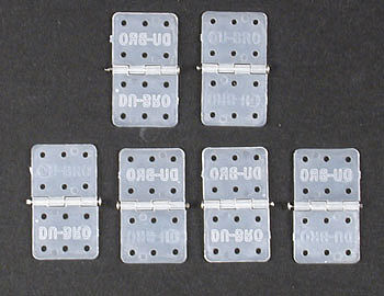

Found RC rudder/ aileron hinges were perfect...my mistake was not using two and doing the entire length...one went half way...still works ...but would have looked better going completely across ...the nice thing was the "loops" matched the molded on set perfectly...so they still blend in even though I went half way

Here's a Hobby shop listing...made by DU BRO
http://www.hobbylinc.com/htm/dub/dub116.htm
this is in the states...I'm sure you can find similar there down under
When I did mine...I kept one side full extension and glued it inside the hull reinforcing that end with some plastic dust...cut the top end in half and secured it to the hatch in the same manner...you will have to carve away the molded on hinges leaving a slight indentation to accommodate the new hinges..but that was easily done with an xacto knife

Yep, the aircraft route was the first port of call tomorrow, next is aluminium(aloominum!) sheet so I can bend my own.
Thanks for the tips, I am far to impatient to wait for a package from overseas for these damn things
