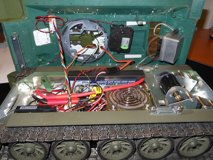

Kiaser, here is my Taigen metal lower T34 hull, with Clark board and a hard case lipo 5000 mAh 2S battery sitting on its side and TARR Mk I sitting between the gearset, but attached to the upper since that's where the exhaust is for most of the Russian tanks. Both KVs and T34s has to have their smoker mounted to the upper hull.
Here is the video of the smoker in action with a 11.4v 3S dedicated lipo with the set-up and Mega Steam. Might have posted this before but here it is:
https://www.youtube.com/watch?v=mLWa7YDOAaU
