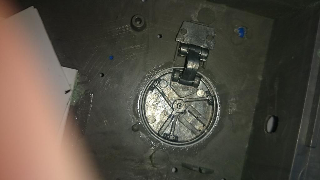

Added a thin surround to the hull aperture for the two forward hatches...not sure you can really see it here
Better here
Am I right in thinking that on a grey tank all hatch internal faces on the tank will be grey too?
Better here

Good Morning, Depending on year, the inside of the hatches will be either elfenbein ( an off white, ivory color ) or primer red. Following along!

The insides of crew hatches were normally painted in the external base colour.
