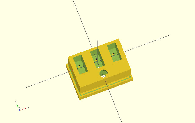

I have now designed a box to hold three HL crystals, and a 3 way switch, so once I have all the bits I need I will be good to go with the experiment. I might be raiding Dave's store in Manchester. :shh: I have two RX18's, so need a third, plus RX boards and three sets of crystals. Just need some wire to hook it all up and I will find out whether the idea works.

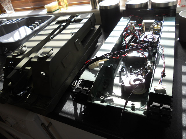

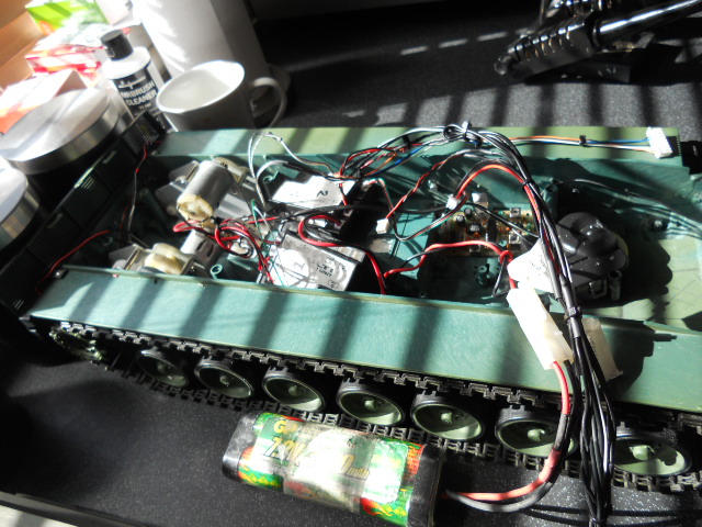

I have finally got around to doing the wiring job from hell, it's all been tested and it works, but I can't finish it off properly as I need one more RX18, plus 3 sets of HL crystals. The RX18 just needs plugging in, likewise the crystals.
I puzzled over how I would know that all three boards were active, and then realised that the Leopard has two pairs of rear lights. I left the bottom pair attached to board one, one of the upper ones goes to board two, and the other upper one goes to board three. They all flash when turned on, and the RX18 stays live when the crystal is removed. So all I need to do is make the crystal switching box work and I can make each RX18 active in turn.
If I can't make the crystal switch work, then I can pop crystals in and out of the tx depending on which RX18 I want to use to control various functions. It will be a lot more clumsy, but at least I know that I have a fall back plan.
Crappy pics, but spring is here and the sun is blasting through the kitchen blinds.

A standard HL tx has one crystal socket. I have designed a new mount that allows me to insert three crystals, each on a seperate circuit to the original HL one. So I have three crystals all linked to the one tx crystal socket via a 3 way switch. It is the same as having three tx's each with a different crystal/channel.
