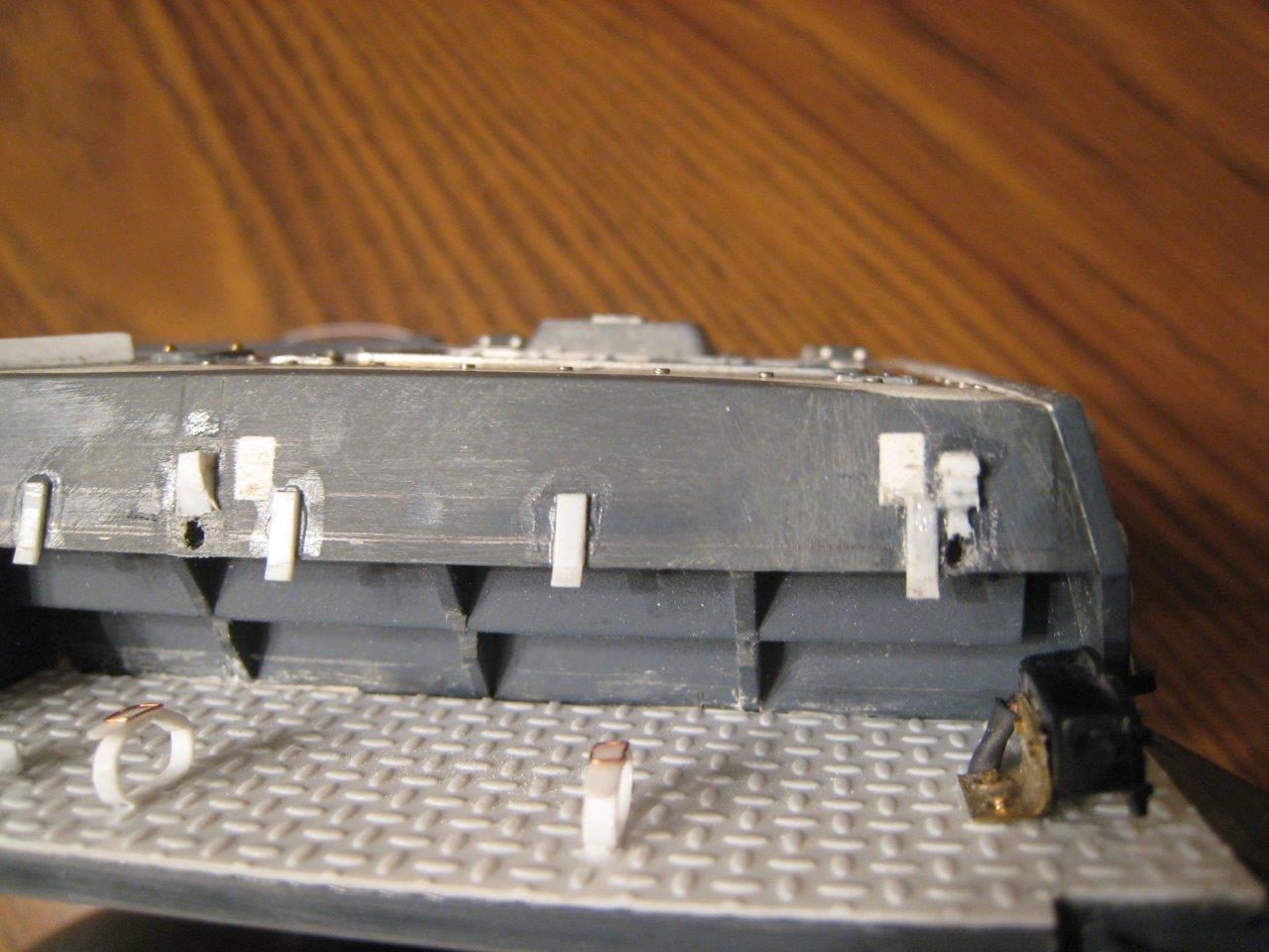

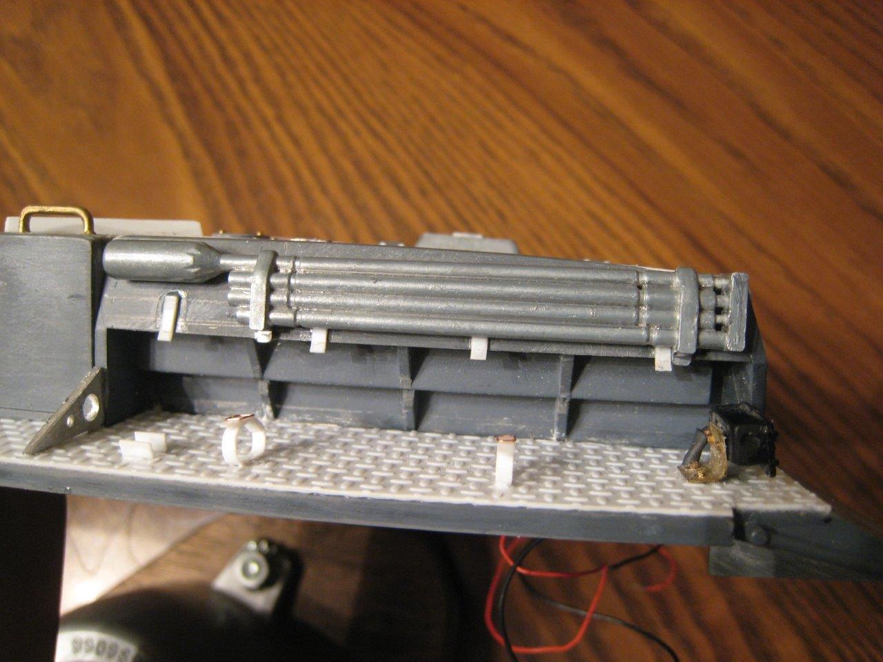

I realized that I had forgotten to prep the space for one set of tools, the gun cleaning rods. The Ausf G and later started to have all four rods on the left, rear fan vents. Most of the Ausf Gs appeared to have them in a configuration with the swab rod on the bottom, a few photos show it on top of the other 3 rods. The Taigen metal tools set is a really nice set that even comes two sets of 4 cleaning rods clustered together. The drawback is that they are both the exact same set with the swab or rammer segment on the top. It also pushes out some from the rest. So, I had to install some small styrene spacers that would allow it to install correctly.

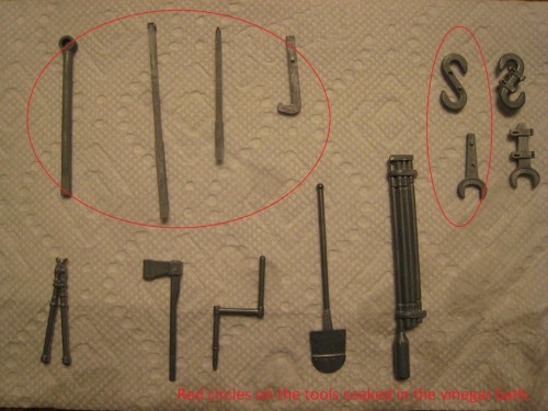

I also figured that I’d try to blacken some of the tools so that I could avoid painting them, or at least the portions that would be bare metal anyways. After 7 hours in vinegar, I’ve determined that they don’t blacken. They got a little whiter, or duller, but pretty much stayed the same color as before. I think that I’ll skip blackening any of them and just include them in the washes to try to give them some age. Although, being in the desert, they’d probably just be dirty.

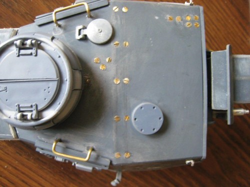

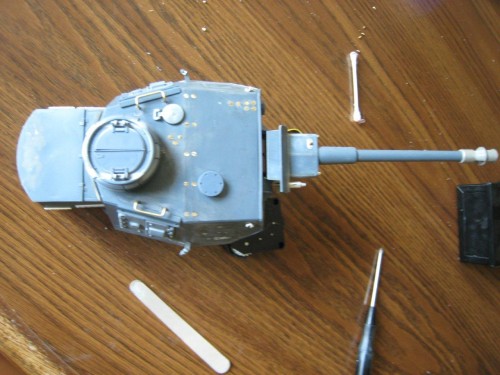

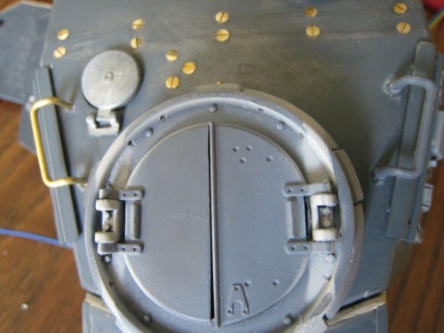

So, after redoing all of the molded bolts and screws on the upper hull, I decided that I couldn’t leave the turret with molded screws. So, I used some 0-80 brass screws to replace the flush-mounted turret bolts that HL had molded into place.
At the same time, I decided that the grab handles had to be tweaked with some 1.4-mm brass wire.
Now, I’m finished detailing the turret. :thumbup:

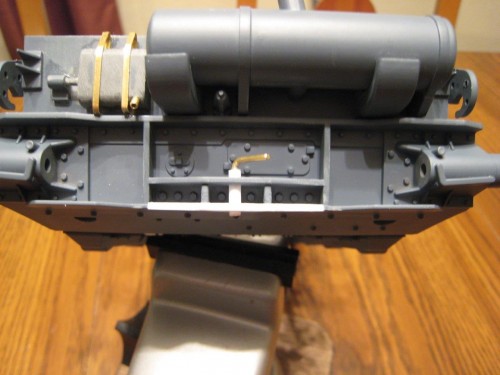

Started work on the lower hull. The battery box has been removed and the most of the switch holes have been filled with Milliput.

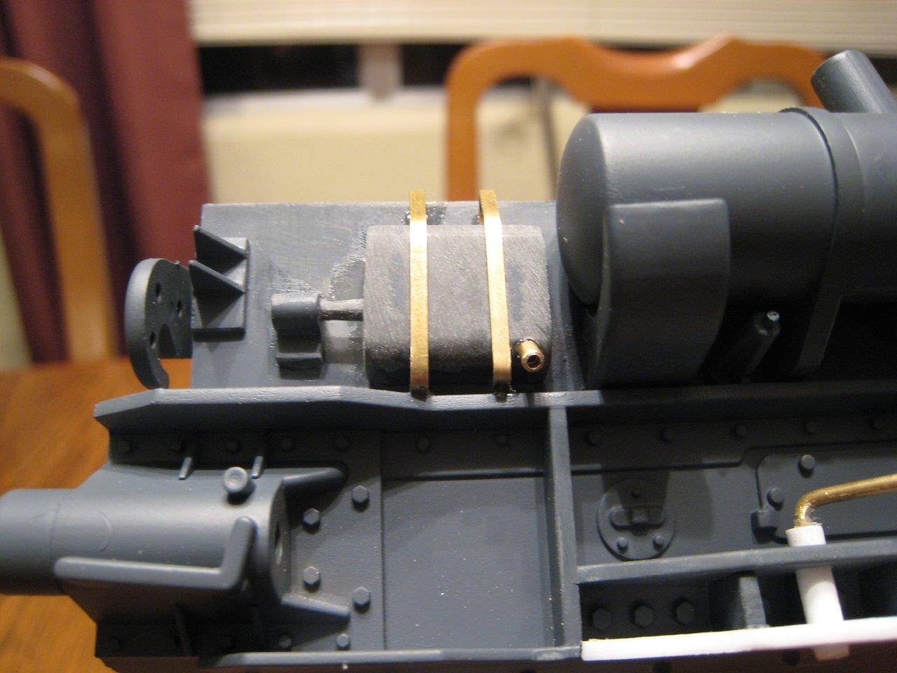

Detailing on the rear is finished. The auxiliary muffler is held in place with metal straps. The moldings needed to be replaced. The attachment isn’t perfect but close. I also added the small exhaust pipe using 2-mm brass tube.
I also added the lower shelf of the center brackets (don’t know what it’s called...but the obvious white styrene shows it :/ ).

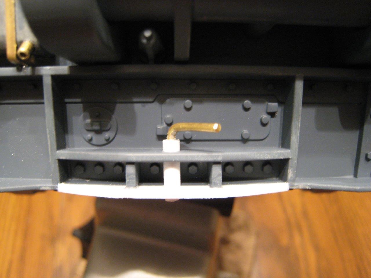

I added the tow hitch lug. That was made with 1/8" (3.2-mm) styrene tube. The handle uses 1.4-mm brass rod. Its length was checked against the TC’s hand. So, it extends about 1-mm on either side of his hand. After epoxying the handle into the tube, I filled the tube with styrene rod. Left as a tube, the styrene was too weak to hold its shape if squeezed. I sanded the end of the lug to about 3-mm diameter while leaving the end near the handle a little thicker, like the collar that was on the real thing. The hold was drilled using a #31 bit, which is about 3.05-mm. The lug isn’t glued in place yet. It will be eventually. I wanted to try to add the securing chain, but I don’t have the skills to drill a tiny hole into a round surface. So, I’ll skip that detail.
I also decided to leave the molded bolt heads. I’d like to replace them with brass or styrene rods. But, I’m afraid that removing the molded heads would cause more damage than I can repair because of the tight spaces. So, I’ll leave those as they are. They’ll mostly be in the shadows anyways.
Posts: 8501
Re: DAK Pz IV Ausf G Build
Hi, If you own a "PIN VISE" just lightly file a flat into the handle of the towing pin (PINTLE) then using a small bit in your PIN VISE drill through then follow through with a bit big enough to allow the chain through, I am assuming you have a PIN VISE, if you do not I urge you to get one ASAP, It will change your build for the better, E-BAY or AMAZON are the places I would look for one, they often are accompanied by the offer of a pack of drill bits, this is an offer worth taking, I would make one important point, once you have a PIN VISE then PE inevitably follows, if you do feel that urge I have found that "VOYAGER" is a little easier and cheaper than "ABER". :haha: shaun
