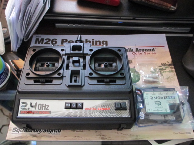

Post got in from Murphy Ma at Mato Mart. I'm curious to see how this HL 2.4 unit does. I am already happy to note that the smoker can be switched on and the sound can be adjusted from the TX. Manual binding with a button is different from Taigen but I see that I will be able to again add a working spot light, to the Pershing now. Pic:
2.4 HL TX and MFU from Mato Mart and Murphy Ma

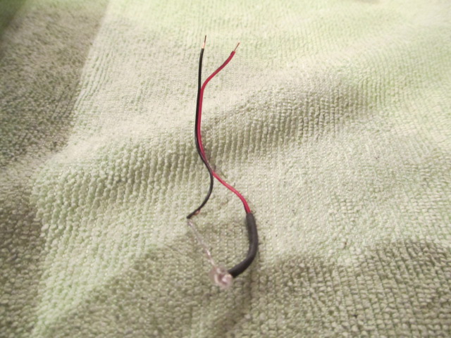

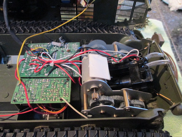

Alpha, I am sure that it will be put to use. A solid metal barreled airsoft Pershing is a grand thing to be sure! ;o) Nothing in the post today but I put the time to good use opening the tank and seeing what could be salvaged. I looked mostly at the lower hull since the upper and turret are slated for replacement already. The bow mg led will be salvaged and moved to the new upper hull. Ditto for the speaker and the running gear. The tracks and gear boxes were new last year and will be fine to reuse. I will need to source a couple of new idlers and I have seen a pair of metal ones with removable caps for sale in Oz. They would add some needed weight at the bow. A new On\Off switch and power connector with a pin plugin will be needed as well as the double ended eight pin plug mentioned earlier. All in all, not bad for a very old Heng Long tank. ;o) Pics:
Closeup of the tail light wiring.  I had to mark positive and ground from the length of the led legs as it was all white wires.

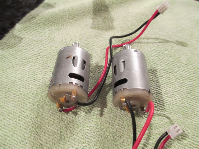

A new set of motors with proper two pin plugs set back from last year's gearbox swap out.

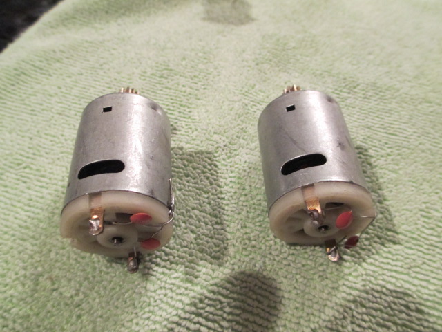

The original motors that were hardwired onto the board.

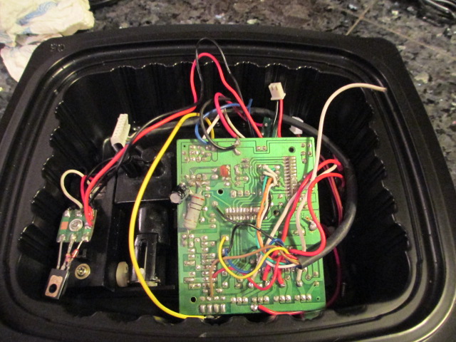

A working RX-13 and receiver for possible simplistic  future builds.

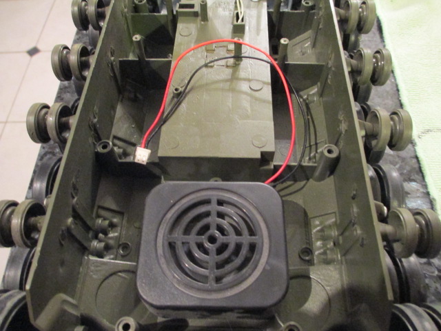

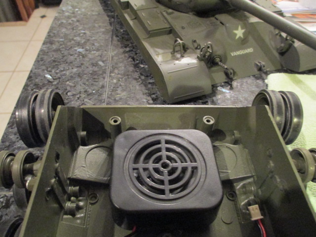

Surprisingly, the speaker was a two pin plug in type like those used today.  It still sounds fine so can be reused.

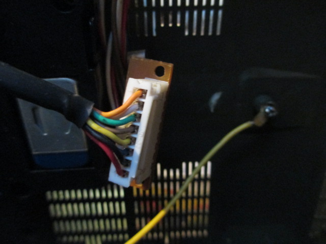

Eight pin hardwired plug from the main board
Eight pin hardwired plug from the main board.JPG (85.96 KiB) Viewed 4109 times

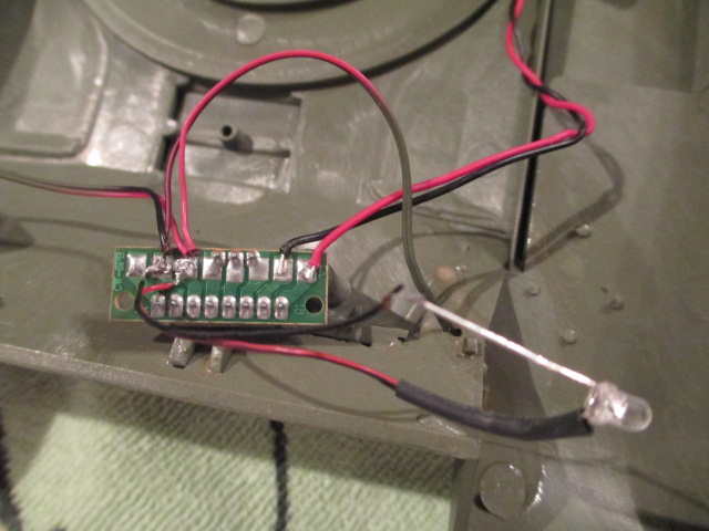

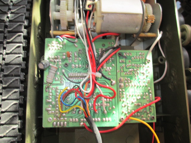

Small board which powers the headlights and bow mg.  The replacement wiring scheme will be much easier.
Small board which powers the headlights and bow mg. The replacement wiring scheme will be much easier..JPG (87.75 KiB) Viewed 4109 times

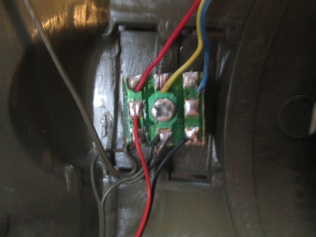

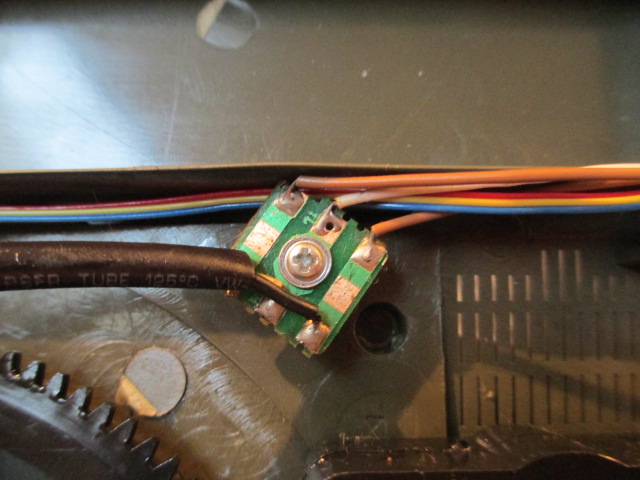

Small board that the turret connections run to.
The old RX-13 board and receiver which to my surprise had a couple of pin plug-ins on the bottom of it.

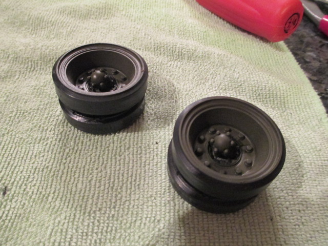

Alpha, it certainly does. ;o) Nothing in the post today so it turned into a soldering repair and reconnect day. I also managed to remove the worn idlers but due to a young and vigorous HL Glue Monkey from back in the day, I was unable to save them or one of the plastic idler mounts. Fortunately, I had already ordered the metal idlers with rubber tires and removable caps and metal suspensions arms to match this morning. Looking at the interconnected layout that the idler shares with the first road wheel in line, I may be ordering a couple more metal wheels but we'll see how easy it is to drift out those metal rivets that hold the arms in place. Pics:

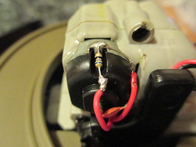

Lastly, resoldered a broken connection found on the new airsoft gun.
Lastly, resoldered a broken connection found on the new airsoft gun..JPG (90.52 KiB) Viewed 4095 times

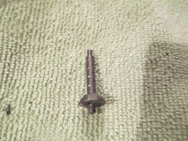

This plastic piece will figure in setting up a Tamiya type bow mg for this tank.
...and soldered it back on the eight pin board on the new upper.
...and soldered it back on the eight pin board on the new upper..JPG (98.27 KiB) Viewed 4095 times

Smashed idlers, too much Glue Monkey...

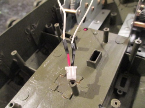

Added a two pin plug to the rear lights after verifying which was hot and which was ground.
