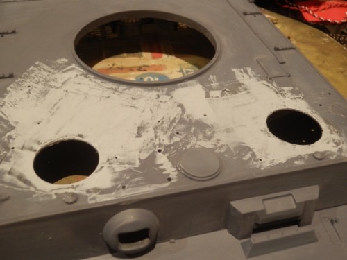

Got back into it as soon as the time allowed. Had a win on the hatch removal & got the MG port back to a point it will take a bead mg port without to much evidence of the die -grinder carnage. Just need to put a coat of tamiya putty across the drivers roof to reduce the craft knife gouge & imperfections left by getting that glue off. :|

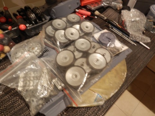

Steel roadwheels with removable tyres, steel suspension arms, replacement steel idler wheels, a new cupola(prety sure the HL glue loony will ensure that was a good call)metal spare hull track section, and the JagdKatze black steel gearboxes.

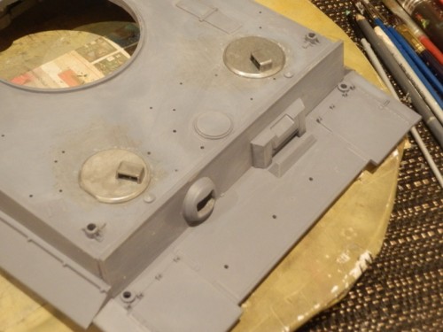

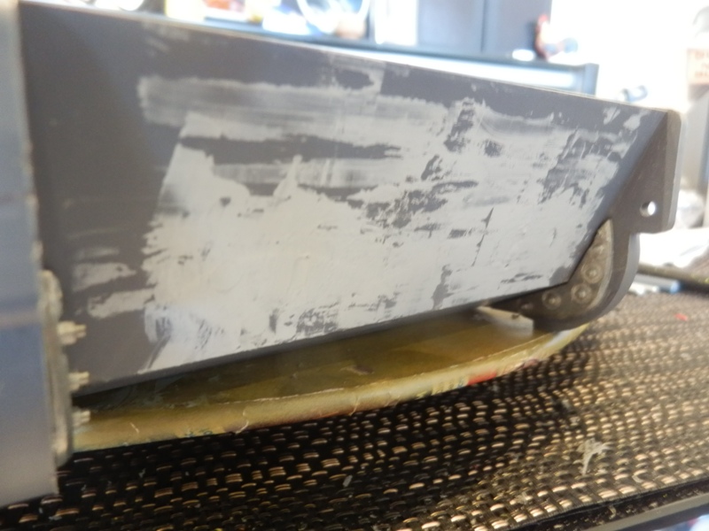

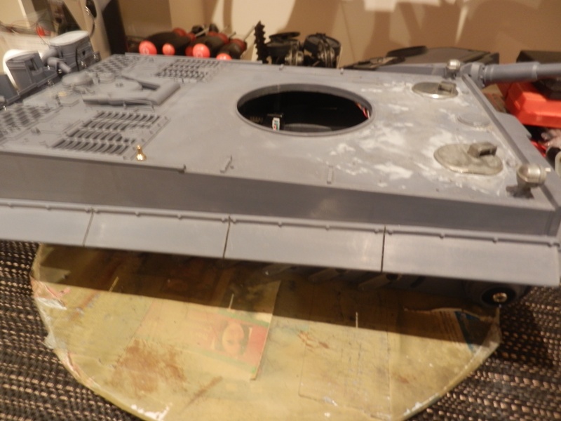

Got the putty on the roof section to reduce the hatch removal impact. "she will drill" as its said in my business.

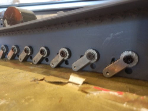

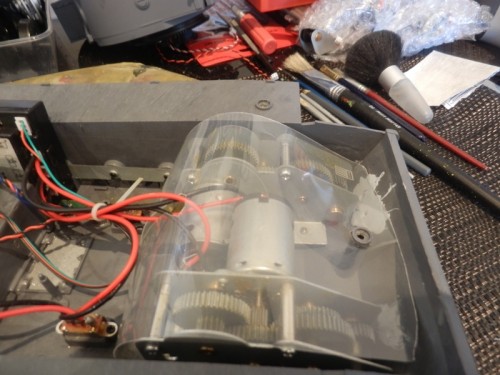

Got the steel suspension arms on, set up the oil splash cover over the transmission with holes for ongoing lubrication through the front hatches.
Removed the stock spare track links from the hull and filled in the holes.

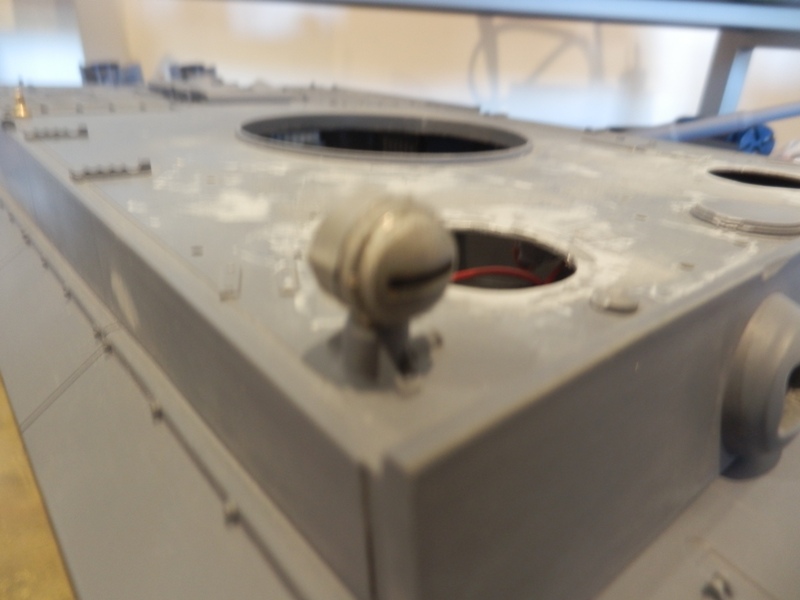

Drilled the MG ball and set in the weapon. 'Gin'd" around with the concept of making it fully oscillating , but just ran out of good ideas to see it through. This time its going to be set firm.
Fitted the metal headlights & soldered all connections.
Fitted the new aerial base, but I still have to remove the stock one from the rear hull.
Spent a while filing the mould release dots off the metal spare track links for the hull. They will be weathered I'm sure so no need to be too fussy.
Set the new aerial base in with super glue & putty over the top.
Metal trans covers fitted up spot on and will accept weld lines without to much hassle.

Cheers mate.............believe it or not the cover is made out of a chinese takeaway container lid !!
Cut a clearance slot for the motor cables to run, and a hole for the front upper hull locator to secure it once all the sections are reinstated. I put small holes in each over the main drive gears at the highest point so the gear sets can be lubricate as required from the hatches.
I think the benefit of reducing the oil spray area inside the tank will outweigh the possible heat increase, but I will be paying close attention to both once he starts rolling in anger so to speak.
Using the right compund will of course make a huge difference.

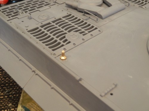

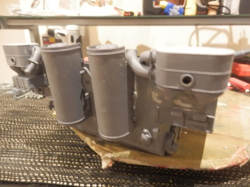

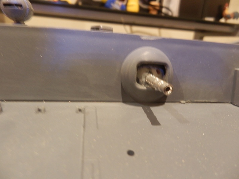

Basically sanded off all the putty, and tidied up the feifal canisters. Set the MG in place - fixed unfortunately, and secured the new metal hatches. Drilled out the filter bungs as per picture. Will add chains later as despite not being clear in the picture, would most likely have been in place.
The smoker pipe work turned into a hassle as the stock exhausts and cyano-glued tube fittings on the smoke unit combined to make it just not worth the fight.
