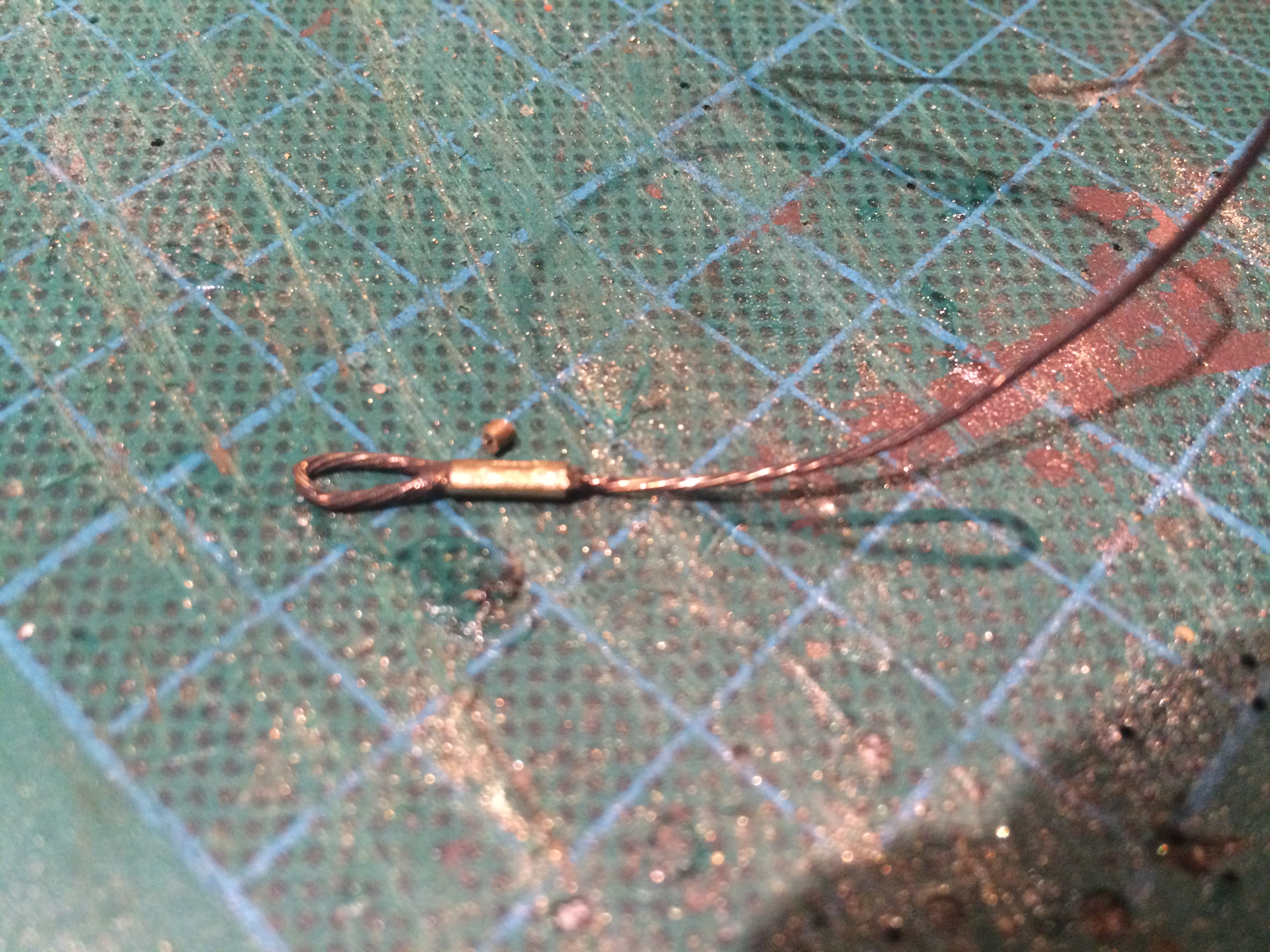

For now its rear MG mount and track pull cable .

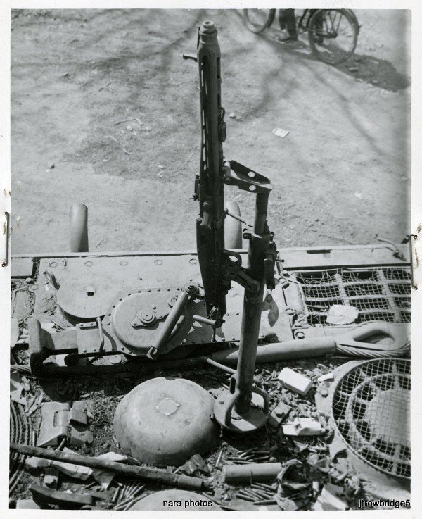

The MG mount will go on the engine access plate as per this picture from X7.

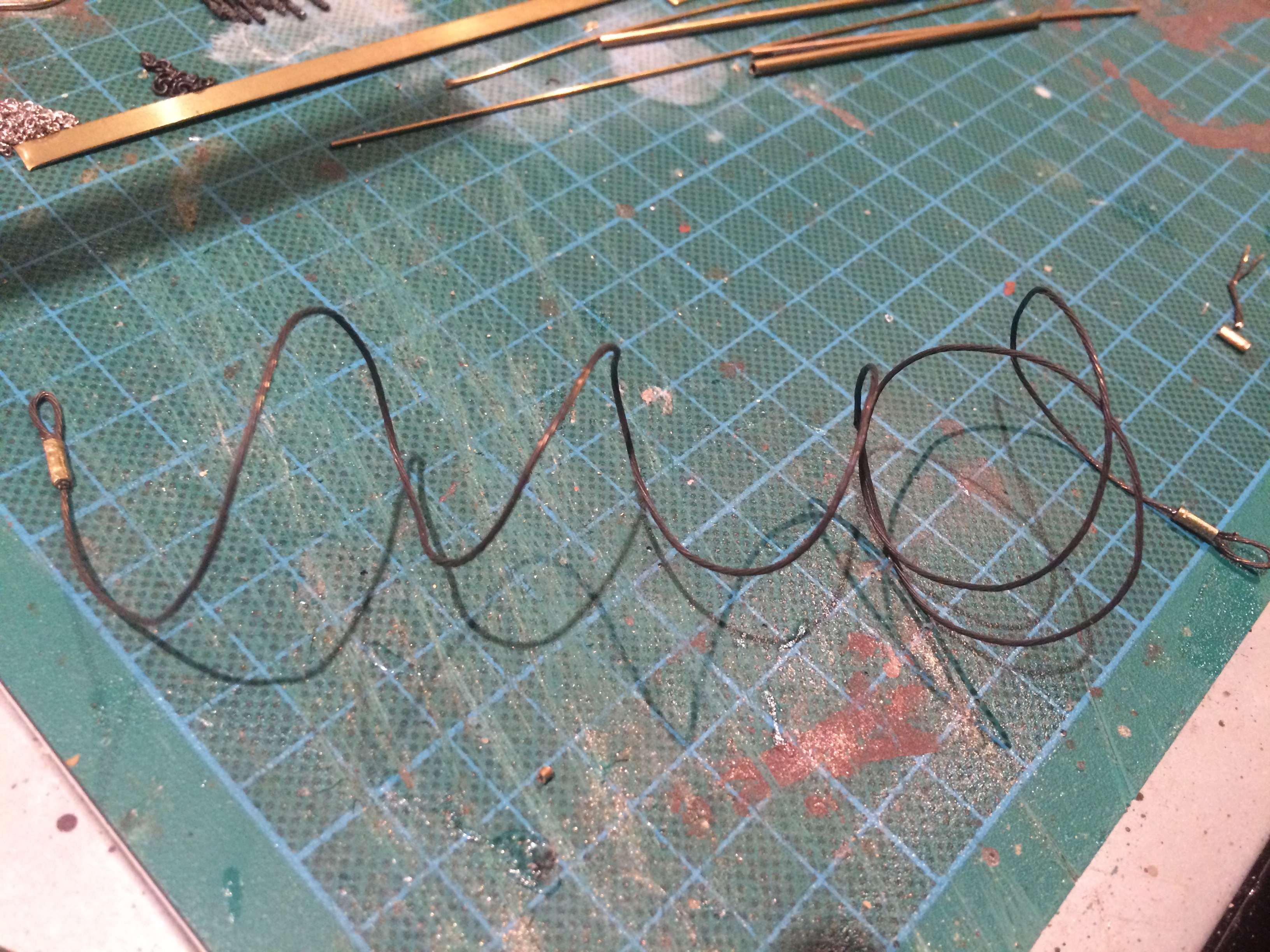

I have a Tamiya MG42 that Ive made fit onto a brass mount and the track pull cable is made from brass picture hanging wire with brass ferrules crushed with pliers.

I have to look up this picture hanging wire. What did you use for the tow cabels? Are those from ABER?

The tow cables are stock units I got from Tank Army Australia, but Im sure the usual suppliers up there will stock the same ones.Soeren wrote:I have to look up this picture hanging wire. What did you use for the tow cabels? Are those from ABER?
Picture hanging kits are cheap, and have handy brass bits including the wire. I have 3 kits on hand just for the wire !

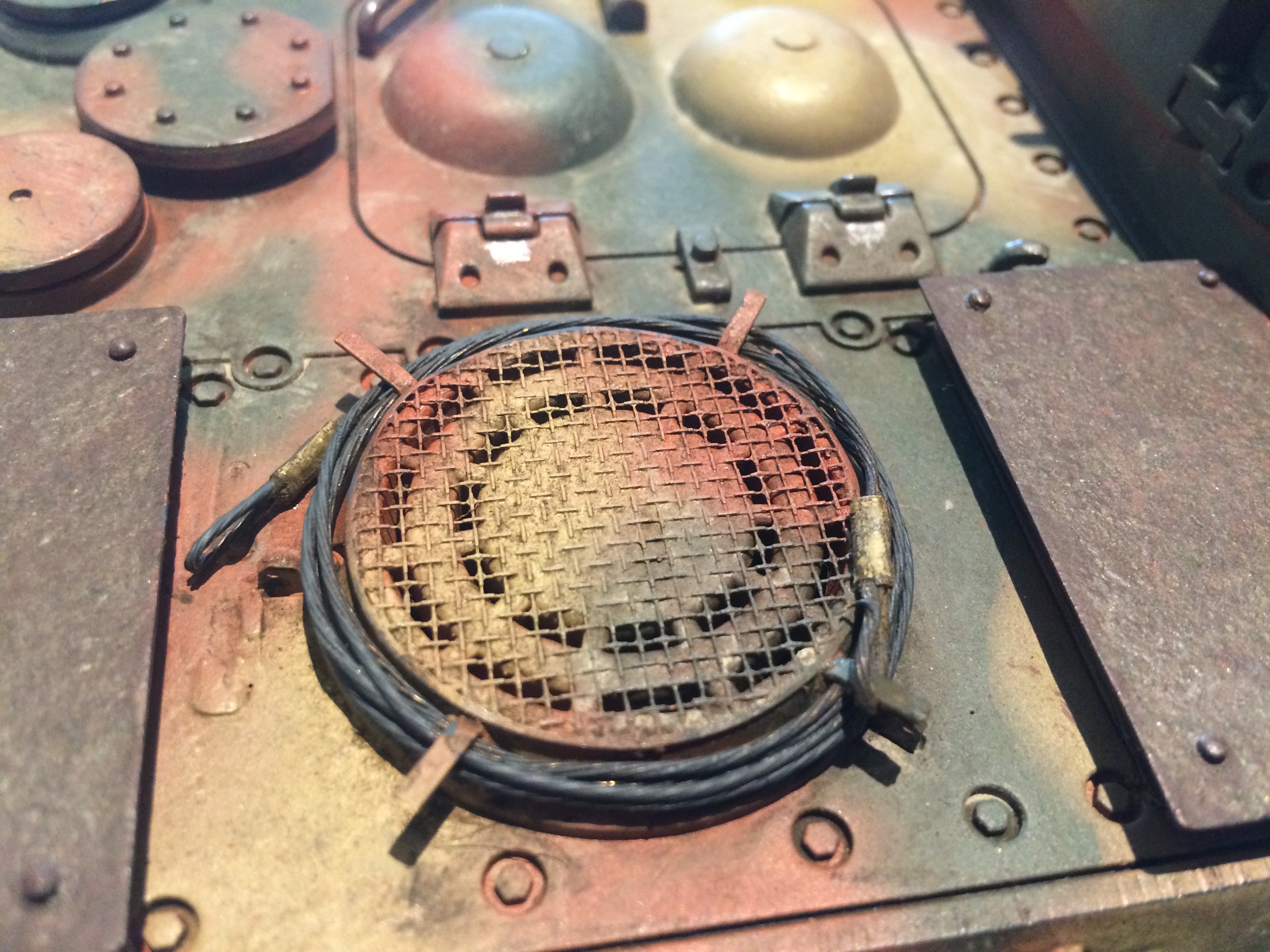

The track pull cable ;looks better now its wrapped around the vent.

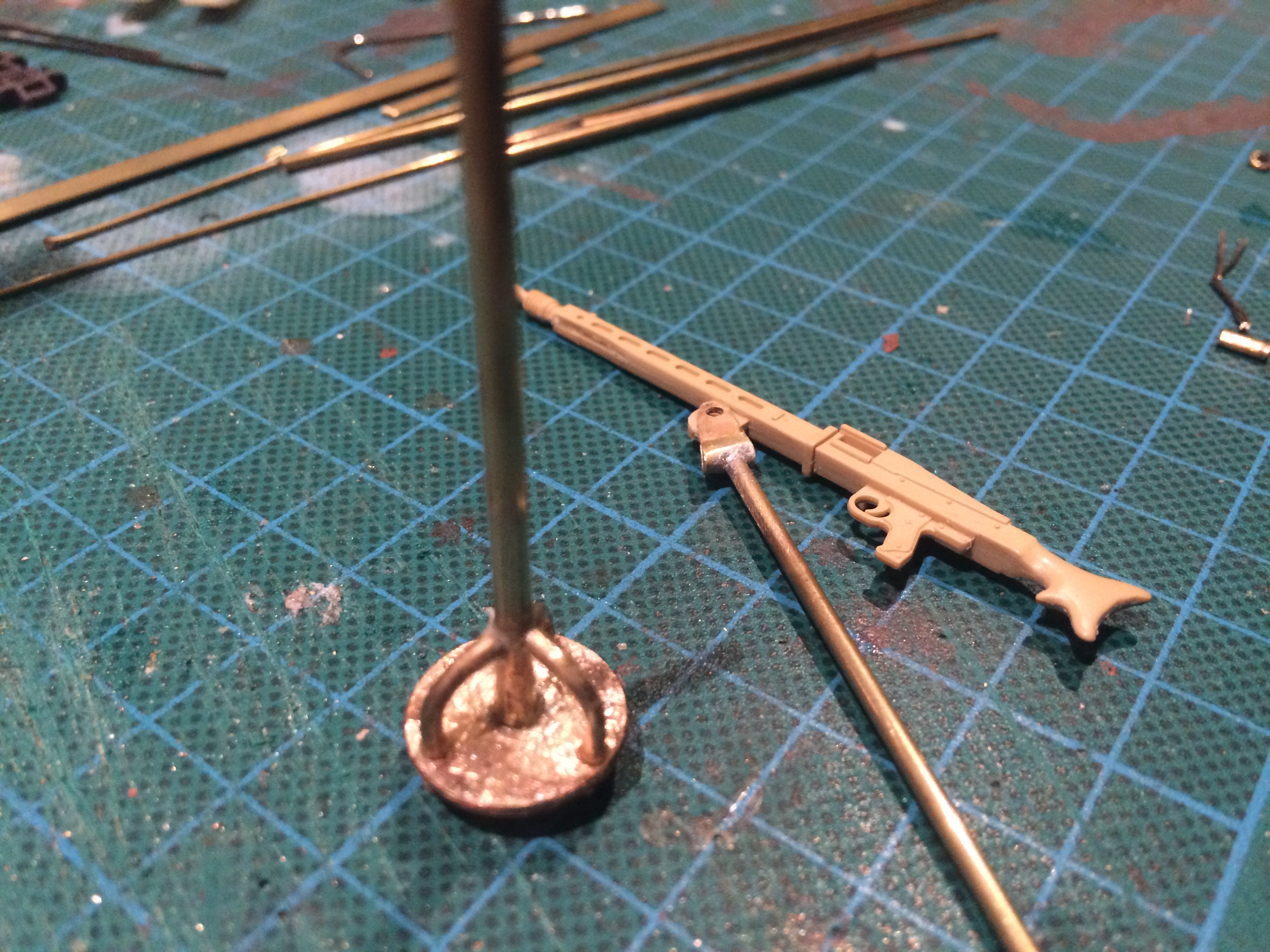

Mg mount soldered together,
Track pull cables look much better in position around the vent.
Secured with super glue gel, a light wash with dusting mig filter & that's it for the cable.
I primed the '42 in rubber black XF-85 , mainly because I had run out of XF-1 & forgotten to restock
Once it's rubbed over with pencil it should look ok.

Herman I'm really liking your tank. That one black and white image of the machine gun on the engine deck with all the spent cartridges is very cool. Maybe you can reproduce some spent brass on your engine deck? It just speaks of the conflict when you see it!
