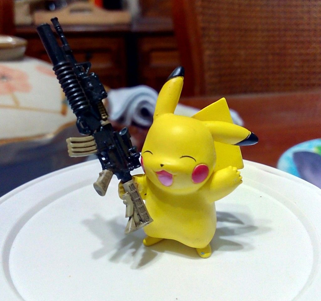

Another useless update on the tank crew. I always tell myself to do the vision blocks but I end up either playing with the tank or improving the crew....
Anyhow, the crew just had a new member and it is PERFECT for the loader's M240:
Meanwhile, one of the crew realized that tambourines aren't really needed in war, so he happily exchanged it with a broomstick:
I promise (yeah right...) to really finish this tank. Although at the rate things are going Uncarina and BarryC will finish ahead of me hahahhahhahahahahaa!!!!!!

Looking very smart - pikachu made me rofl

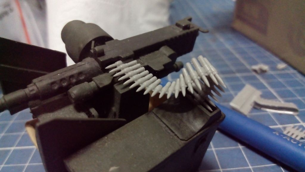

Finally done building the .50-cal ammo chute.

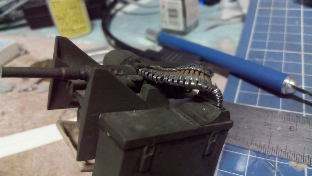

First, I bent a 1/16 resin .50-cal ammo belt to shape by dipping it in very hot water then bending it while soft. Pictured was my first successful attempt which I then accidentally stepped on, so I had to make another one.
I then painted the ammo belt gold. After painting it gold, I sliced a thin strip of lead foil and cut it into two strips which I glued on the ammo belt to give additional surface for the chute components.

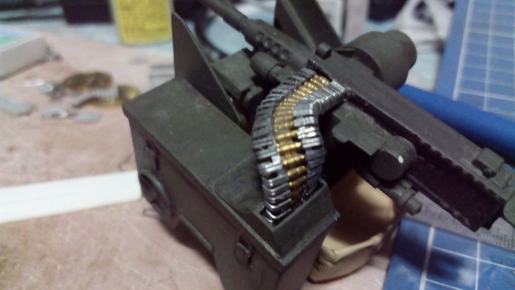

The chute was made of 5mm staples, cut in twos, around 20 pairs or so. These were then folded to shape using a plastic jig as a size guide. I placed glue on the lead foil strips then placed each pair of staple to the ammo belt.
The result is more-or-less like the real ammo chute. It's good enough for me.
Now all we have to do is paint the details by hand and glue the entire thing to the gun and ammo box.
I'll be modifying the CROWS-2 further. As you can see, the barrel is broken off. I'll replace it with a brass tube with a 3mm orange LED in the gun, in preparation for the IBU3 which can use two machine guns, a feature that's perfect for tanks with remote weapons systems like the M1A2 SEP v2 with its CROWS-2.

Ingenious solution! Looks fantastic
Is the belt from Live Resin?
