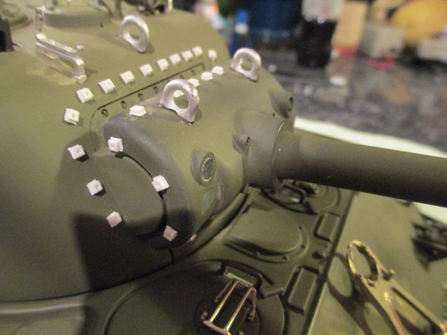

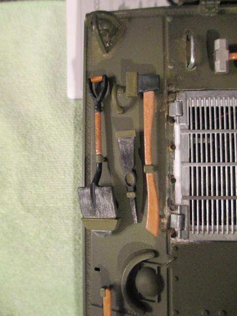

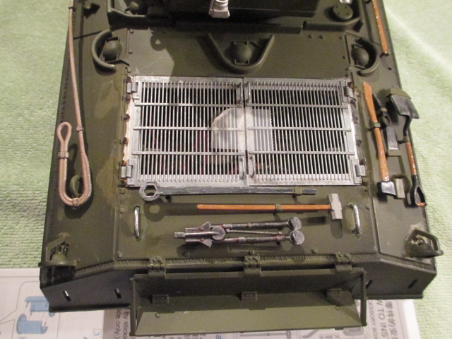

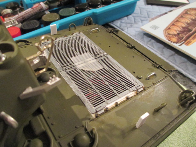

66th Day: Alpha, everyday is an adventure with a complex Build. I notice that your Sherman is looking grand in a fresh coat of O.D. tonight. ;o) Got a little research material for my next build in the mail today. It will prove useful and instructive reading. Sherman-wise, tonight was a cruise night compared to the tough going the last couple of days. I added the tools temporarily to see how the Engine Door rests would fit. I finally found a picture on the Sherman Minutia site to verify that HL did indeed place the tools correctly. I ground down flat the LED that forms the warning light for the gun firing in the Gun Shield Telescope aperture. I was going to make the neat armored slide cover for that scope then noticed that this part did not get added to the shield until late 1945. The LED in the scope mount is smooth and black looking now so I was pleased to get that much done to it. I finished up the night by doing some wire management under the rear deck. I also painted the tail light leads under there O.D. since they are exposed behind the rear bulkhead. I put a piece of clear acetate tape over them as well on each side to help hold them securely in place and add another layer of protection. The last thing I did was remove the black devil eyebrows my tank commander had been given by some tired Chinese fellow. I gave him a pair of regulation flat brown ones. A canteen for his empty hand was added until I can source a nice 1/16 map for him to be perusing. Pics:
- Warning LED filed flat then sanded smooth
- Warning LED filed flat then sanded smooth.JPG (97.9 KiB) Viewed 2303 times
