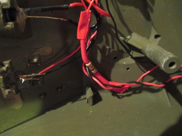

Just opened up my sherman and taken a pic of the resistor I added. You will have to excuse my scrappy soldering :{
Sorry it is not a very clear picture. The resistor is fitted in the red cable which leads from the front light to the rear lights. I soldered one end to the front led leg, and the other end to the red lead to the rear lights. The cable in the pic looks black because I put a bit of heat shrink on it to protect the connection. The resistor is a 120 ohm (brown, red brown), as I mentioned before i played about with a few resistor values and settled on this as the best balance.
Hope this helps, and of course if you need more info just let me know :thumbup:

Good Morning, Scalawag,
Thank you for the picture. I'll run out to Radio Shack and pick up a resistor of the 120ohm type and solder it into the hot cable that leads from the front lights to the rear lights. It is a well defined hot\ground pair leading from the bow to rear of the tank underneath the driver's side upper hull so I should be able to do this easily (easier than soldering in the LEDs at the rear of the tank were yesterday) I'll report on the results this evening.

I opened up the Sherman for another look see on my break and the wires, hot\ground, run from both headlights into the mini-board at the front of the tank. From the board, the separate hot\ground goes to the rear tail lights. Any preference for which hot wire gets the resistor? Red into the mini-board from a headlight or Red from the mini-board going to the tail lights?

Hi Painless,
It should be ok if you put the resistor between the mini board and the hot (red) to the rear lights. That would effectively be the same as mine then. :thumbup:

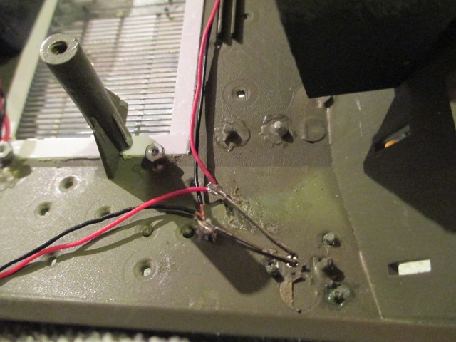

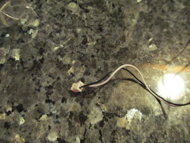

65th Day: Alpha, I was still working on it. I salvaged a mini 2 pin connector from a spare 1/24 Sherman M4A3(105mm) turret (oddly enough) and plugged it into the port Taigen provided and tested it on the rear LEDs. Success! For a brief moment, I had four flashing LEDs, front and back and when the tank was turned on, putting it into reverse lit up the rear tail lights. I shut everything down and soldered the connections and turned it back on to test.....No lights, front or back... Thinking that I had mistakenly switched the hot and ground, I unsoldered, resoldered and retried. Still, no lights, front or back. I tried another battery, still no lights. No knowing what else to do, I unsoldered the plug leads and cut the tail lights free from the miniboard. Tested and I had front lights again. I tested the mini port with an LED and it was still working as the 3mm LED lit up when the tank was in reverse. Not wanting to call it a night when I knew I was very close, I decided to try one more time. First, I cut the remaining wire from the miniboard even shorter, salvaged the 100ohm resistor and sealed the hot and ground off. Never know, might need them again one day. Then, I removed the mini 2 pin plug and cut the hot and ground shorter then soldered the wires on it to the hot and ground wires I had cut free from the miniboard and that were still soldered to the tail lights. Crossing my fingers, I plugged everything back in including the mini 2 pin in the Back Up Lamp port. I turned on the tank, flashing front lights and lit searchlight. Very Good. Then I started the tank with the Radio and hit reverse. YES!!!, I had tail lights! Taigen is an odd bird in this respect but now, I can go forward tomorrow with this nasty issue resolved. Here's wishing you luck with your electric build tonight, Alpha. Pics:

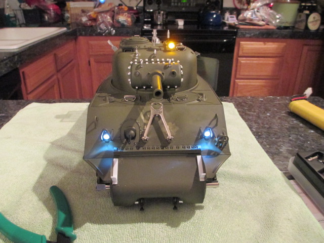

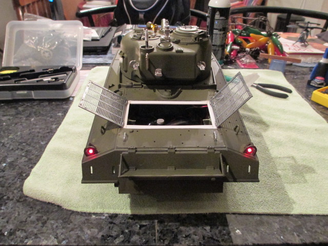

Finally, WORKING TAIL LIGHTS!
Working headlights and searchlight
Miniature 2 pin plug was a perfect fit for Taigen's Tank Back Up Lamp port

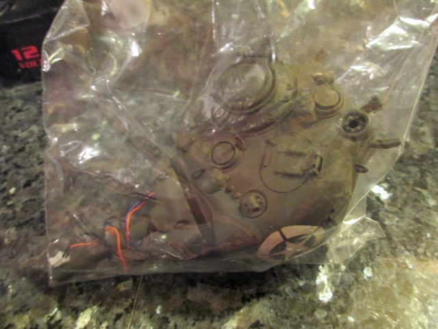

Spare 1 24th scale Sherman M4A3 105mm turret donates a mini pin plug
Despite clean solder jobs, no love and no tail lights
100ohm resistor inline to attempt a tail light repair
100ohm resistor inline to attempt a tail light repair.JPG (89.34 KiB) Viewed 2798 times

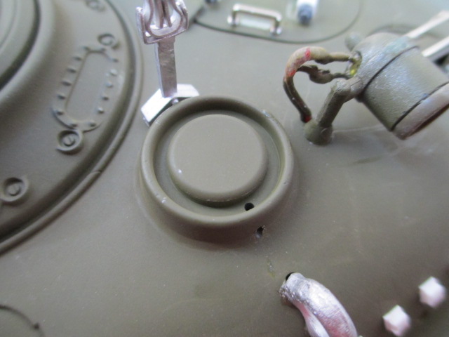

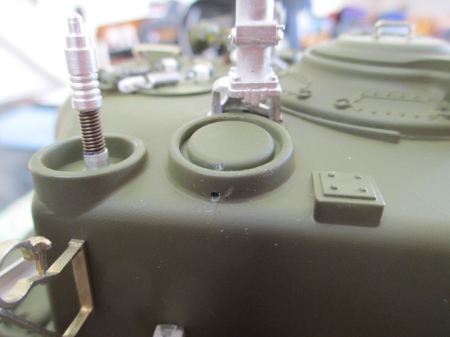

Front ventilator fan housing weep hole
Front ventilator fan housing weep hole.JPG (81.02 KiB) Viewed 2798 times
Rear ventilator fan housing weep hole
Rear ventilator fan housing weep hole.JPG (80.62 KiB) Viewed 2798 times
