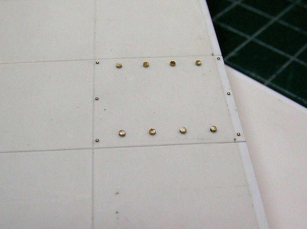

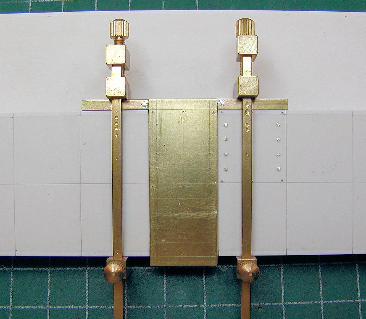

Here are a few pics of the first of 496 bolts and 372 rivets and their holes!
Bolts and rivets, finished look.
Clamped in place, you can see the bolts and rivets in the ART next to it.
Drill template/guide.

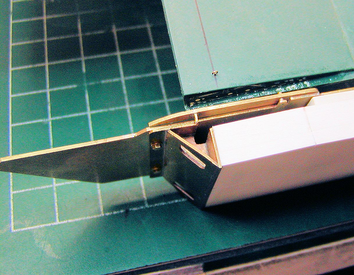

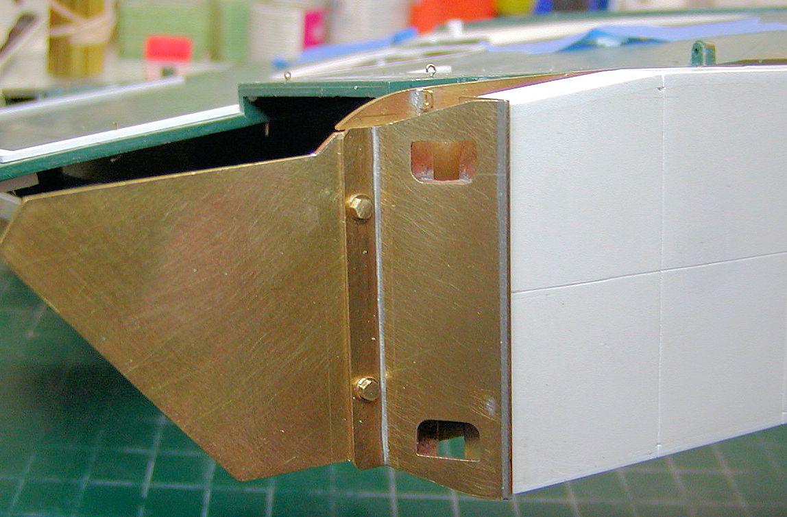

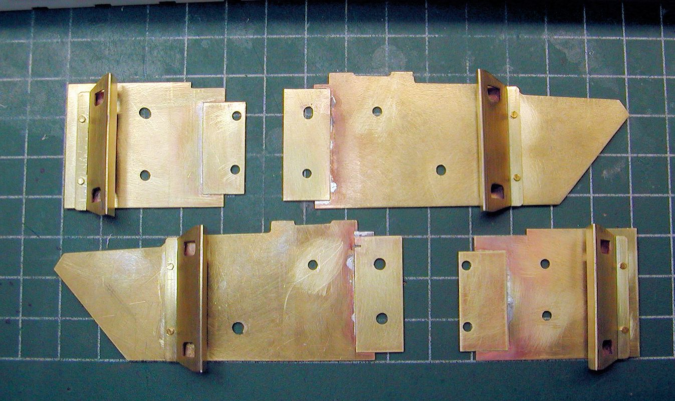

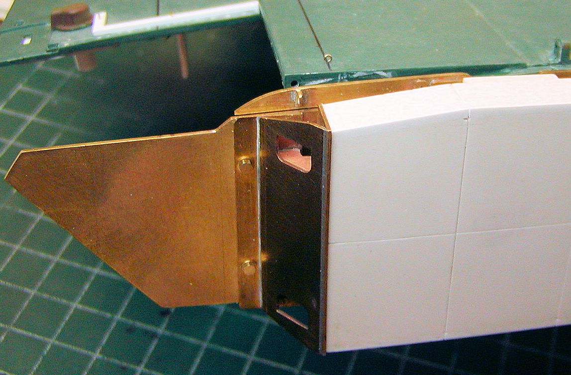

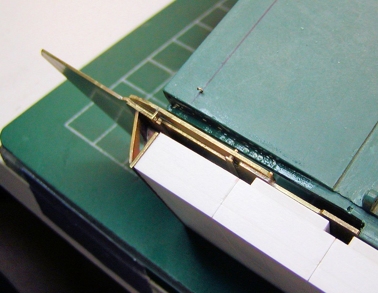

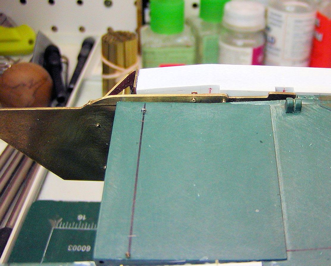

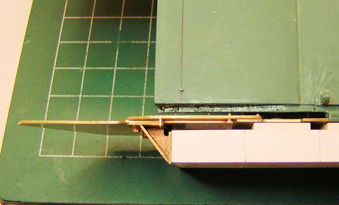

Here are the "nearly" finished fwd and aft mounting plates and fenders.

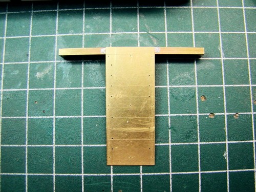

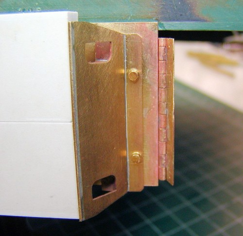

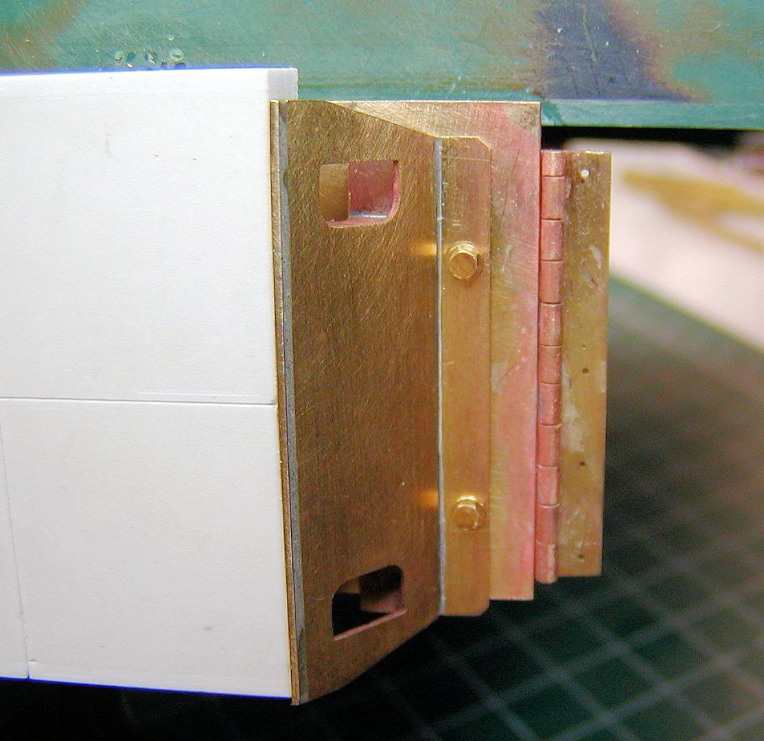

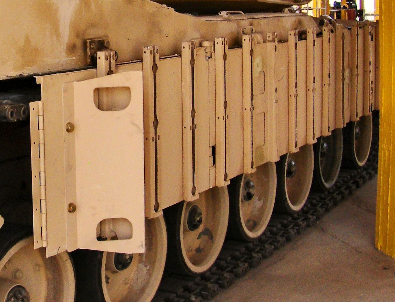

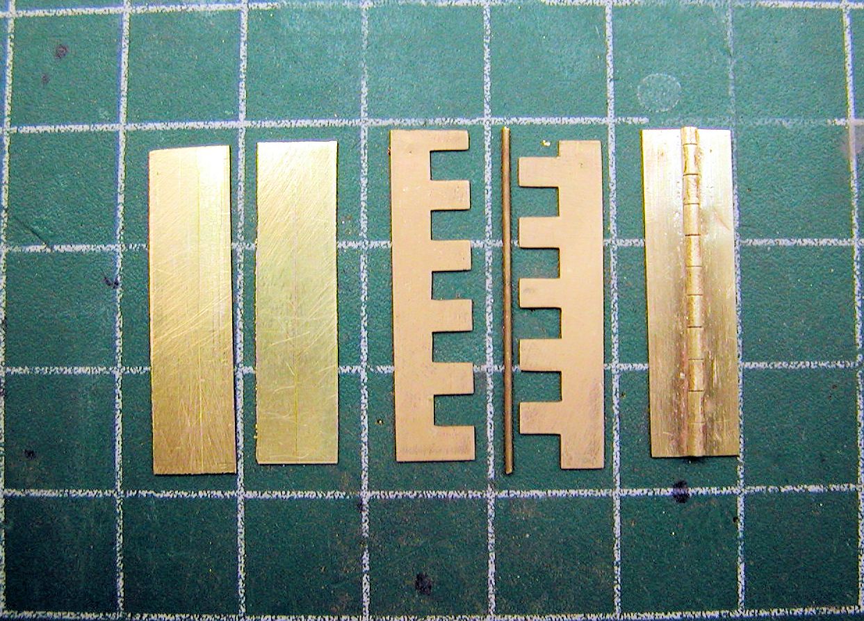

Quick update, The specific tank I am modeling does not have the rear most side skirts installed. This leaves the hinge where it mounts to the shirt exposed.
After looking all over I found hinges that were either too small or too large. I finally found one made by Dumas Boats that looked pretty much to scale but had the incorrect number of knuckles. I need 10 full knuckles plus one 1/2 length knuckle and it 7 + 1/2 when cut to needed length.
Sooooooo....I made my own!

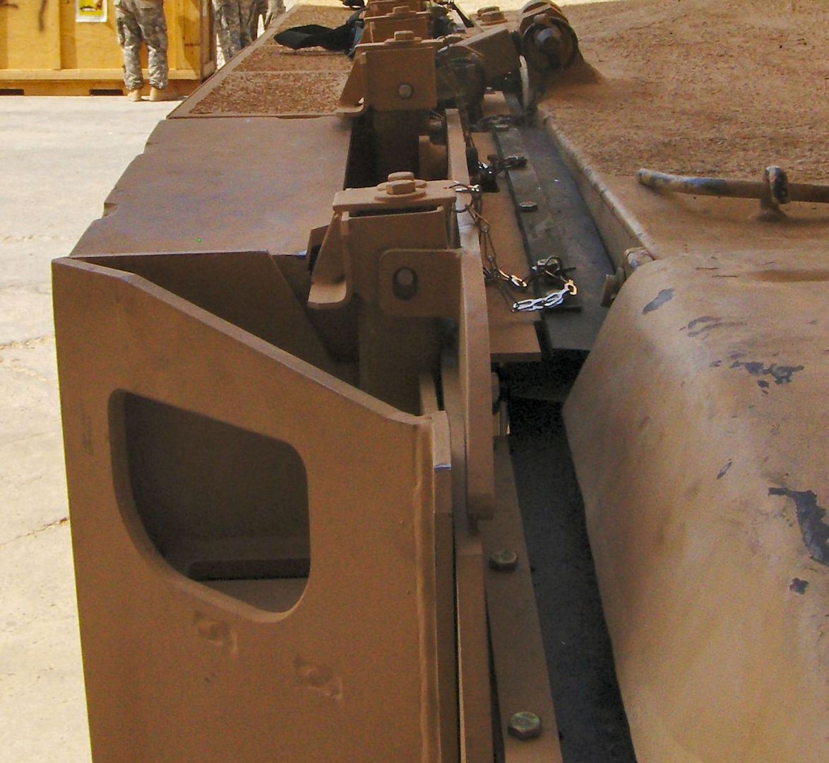

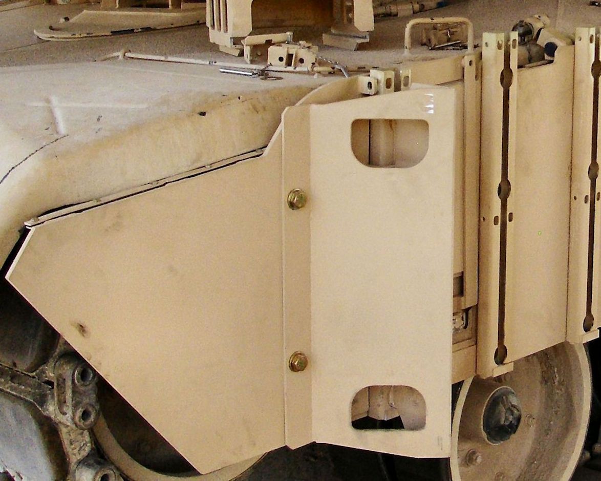

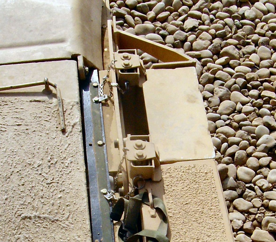

Here are some pics of the details on the ART mounting plates on the Abrams and mt attempt to model them.
