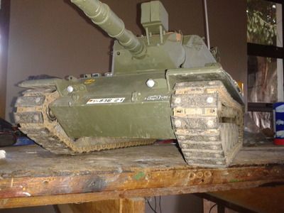

Hi Hein,
wow your tank looks superb...now i'm digesting the pics.. hmmmmmmmm

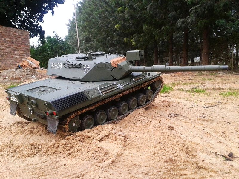

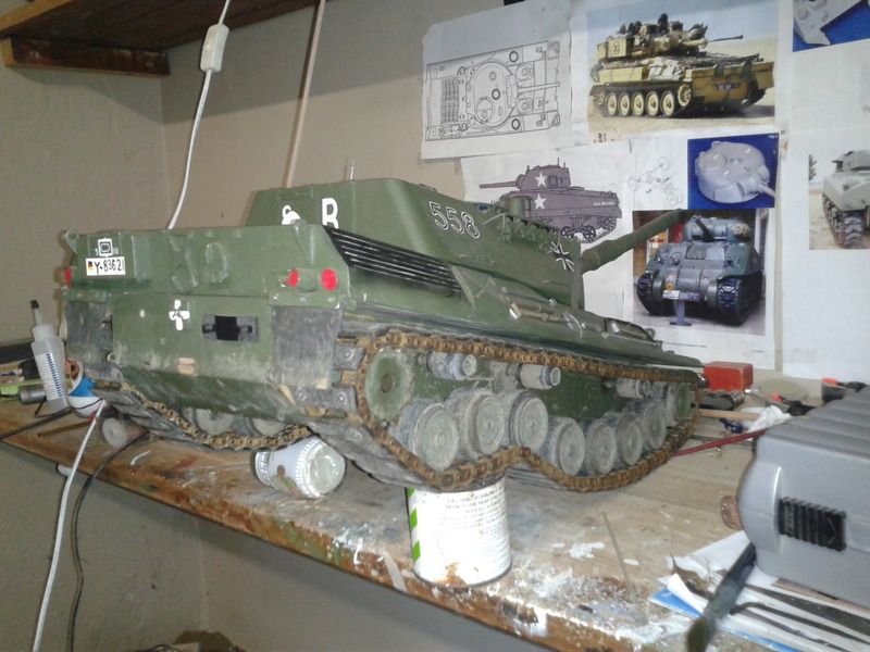

Thank you Crazark
Here are some more..

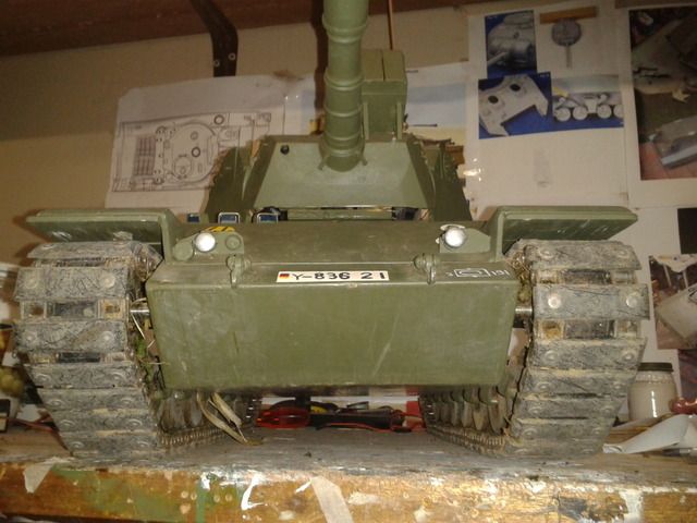

What was your total cost? It looks great.
Re: Leopard 1 A4 R/C Tank 1/12 scale scratch build
Hi Andy!
It was around R3500.. Thats about 265 pounds
(paint, wood, 2x drills, chain, 36 bearings(some salvaged), glue, 4x servos and reseiver(without the radio) and a generous neighbour suplied the plastics

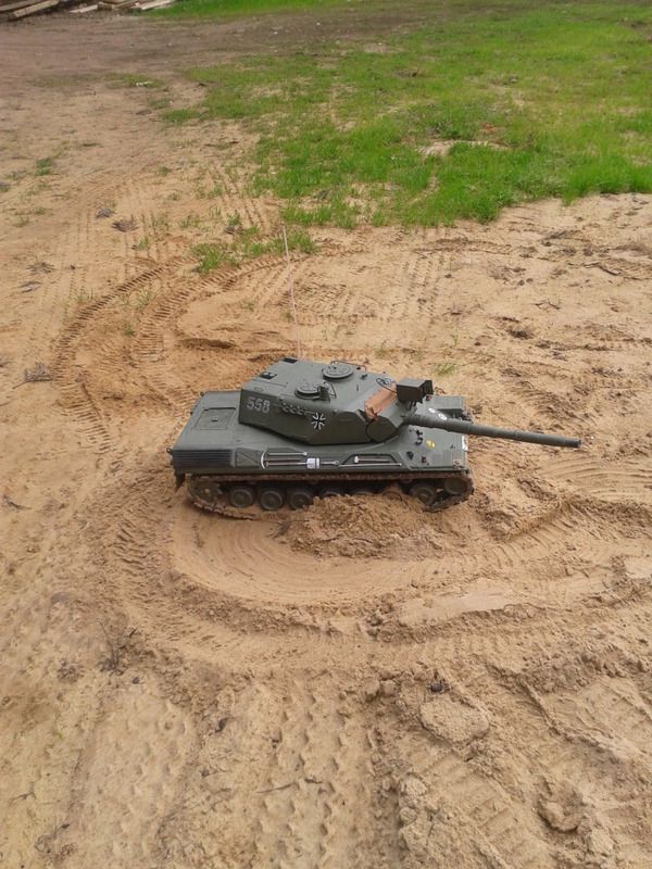

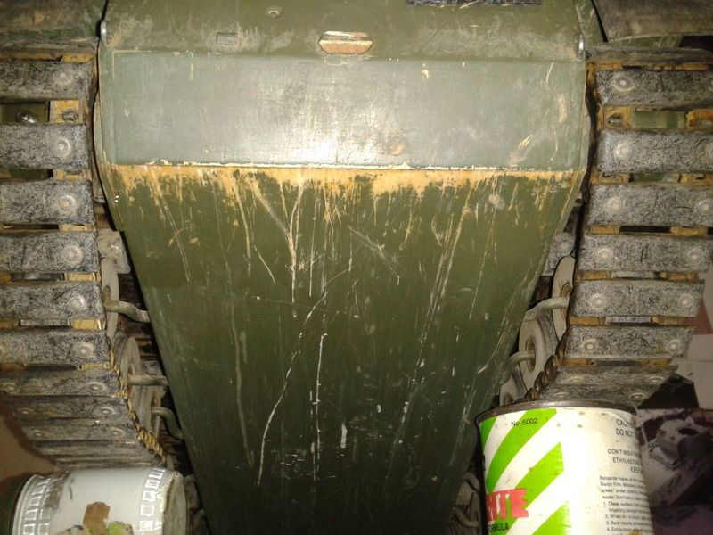

After some rough miles

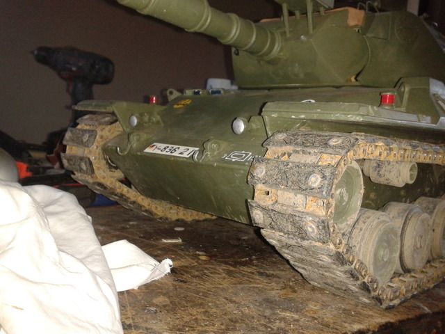

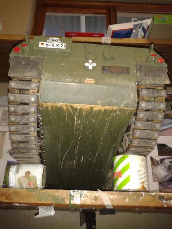

Hi Hein SA
That is a magnificent tank that you made. Are the screws that are holding the track pads on countersunk? If not, you should give it a try so the screws don't get grinded down from long use. Just be sure to not countersink the pads to far or you will have to start a new one.
Hi Tiny Tank
Thanx
! I did not countersink the pads, the allen key bolts are just screwed on tight that they pull into the plastic quite a bit. I have tried to countersink the pads but the drill or cuontersink bit tends to "bite" into the plastic resulting in a cuontersink that is too beep so didnt bother... The screws do get grinded down but only when neutral turning on abrasive surfaces
