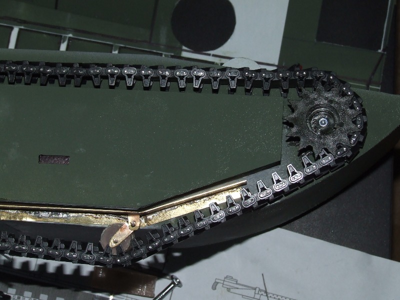

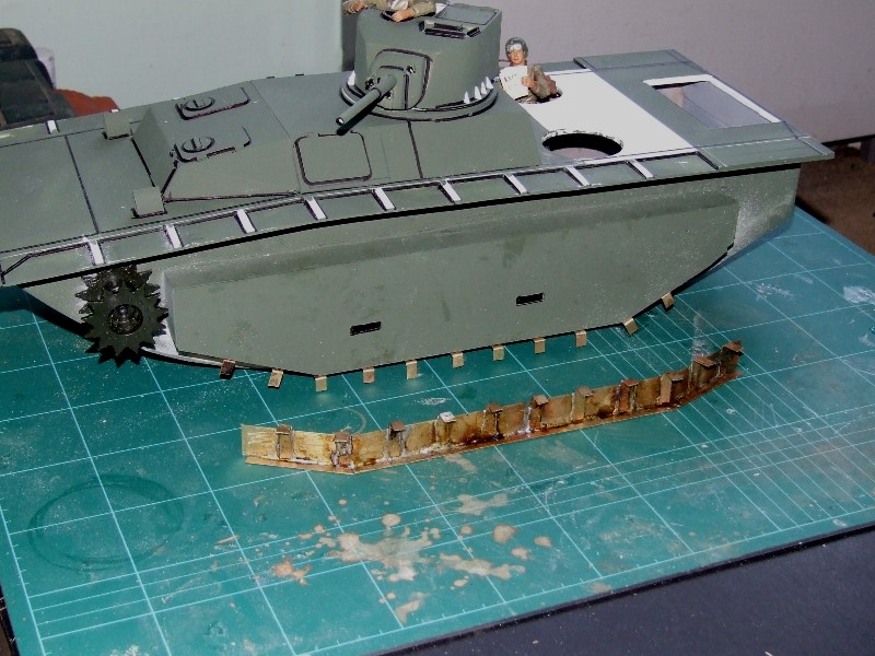

Ok progress again. I finished fabricating the Brass suspension mounting brackets. Just waiting for wheels to arrive then it'll be drop a gear and get going. You can see in the first picture how I intend to mount the wheels with a Hardenend and tempered steel wire for suspension. Hard thing is working out how much tension to put on it. Also refering to HL models and the like the front and rear road wheels all seem to have a stronger spring so may double up the wire.

Hi Nick , looking very good mate

Herman I traded some panzer spares with 'scrap hunter' off the forum, he's sending me a bag of 'multi rollers' I havnt seen them yet. Original idea was to use Pnz 3 or 4 return rollers. Or I tried 10 ml syringes filled with resin, as in the picutre above. Basically anything cylindrical about 15 - 16 mm would do it. Even thought of dowel but I don't think that would be durable enough. Not sure where the rollers are sourced but be happy to share once I do.
