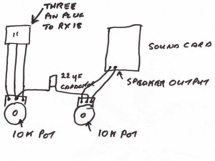

Have also found a way of stopping the whine noise on Darkiths boards when using the RX18 have sent you and e-mail Rob with a sketch have also sent one to Darkith to see if is O.K. (Im Not that good with elecronics )Basicly have tried to copy the setup that RCCommaned uses ,As soon as Darkith gives me the all clear that what Ive done is O.K. will post the sketch on here.

Hi Bubbajoexx Thanks for the heads up about the voltage, will try the with 2AAA batteries powering the sound card,and let you know what happens.Did have a bad conection on the card the solder point had broken away from the track ,traced it and resoldered it it worked but very intermittent ,have been looking for another bad joint but if it is power voltage will try the above.
As for the feedback sound to the speaker,this happens on Darkiths units as well ,have tried rewiring the sound card on a Darkith unit using 2 10K volume pots and a 22ufcapacitor like Buubajoexx uses on the Rccommaned sound cards ,see sketch .it has stopped the feedback (but not being an electromagian)dont know if its safe to use long term(will it blow something)Have been told by Darkith that its caused by the fets used to drive the motors being a higher frequency so basicly its RF interferance (this can be a nightmare to get rid of)cant cover the RX18 with foil or mesh need air to flow around it, even if you could cover it could then feed down the wires.
Cant blame anyone but Heng long for this the RX18 fets give more power to the motors but they are causing problems(have also seen it happen on Tamiyas)they should have used higher frequency fets then we wouldnt have been able to hear them (but would drive dogs mad).
Dont think there is a problem with the sound cards or Battle systems they work fine with RX13&14 boards its the Rx18 ,we have been asking for more power for the motors we have it ,but they should have taken a major step and given us a 20amp esc instead of a 7amp.
Maybe some one should look into changing the fets on the board to give us 20 amps if its posible
regards pete

Hi Have tested the sound card using 2AAA batteries,it is working (good sound from card and RX18 )and still no feed back .So I will test this on a Darkith system Powering the sound card from batteries and conecting with 2 volume controls and a capacitor as per my sketch.Hopfully might have found a cure for the feedback nosie.watch this space for update.
regards pete

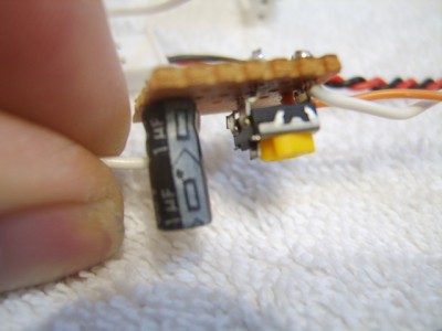

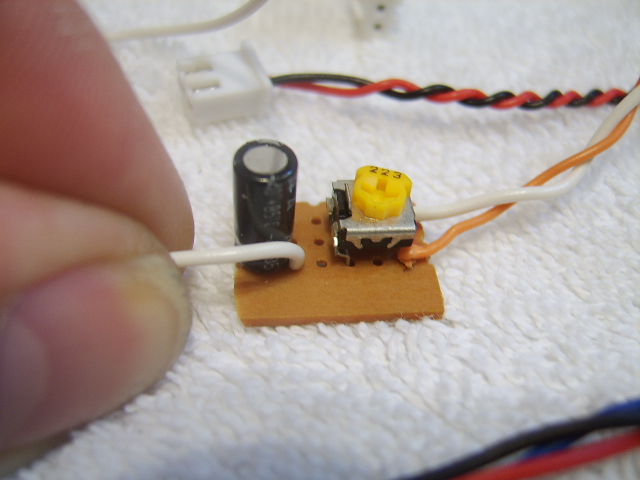

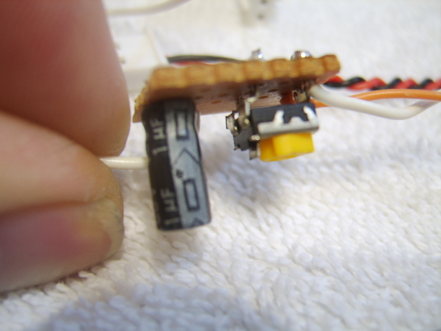

pete heres a pic of the pot arrangement now on my it uses a 22k pot
