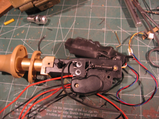

Did some wiring...got the gearboxes squared up a little better. Built the recoil/flash unit.

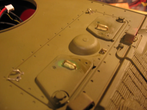

Been outside as of late and not done too much on the Tiger B, but i did manage a little work over the last few evenings as it has been raining here. Sax's PM's got me going again!!

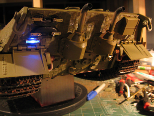

Some more detail to rear end. 2000 ohm on a blue led...probably need another 1000.
Can't have too many tow shackles!

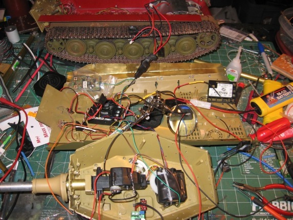

Almost done the wiring. Some PITA stuff converting from Matorro to HL wiring harness. MAto is 10pin HL is 8pin. You just need to know the output of the 8 pins and no real problem. Added metal machine gun w/led. And then did my usual recoil wiring mod with voltage regulator and 3 diodes. works like a champ...although the recoil length is somewhat limited by the HL recoil mechanism.

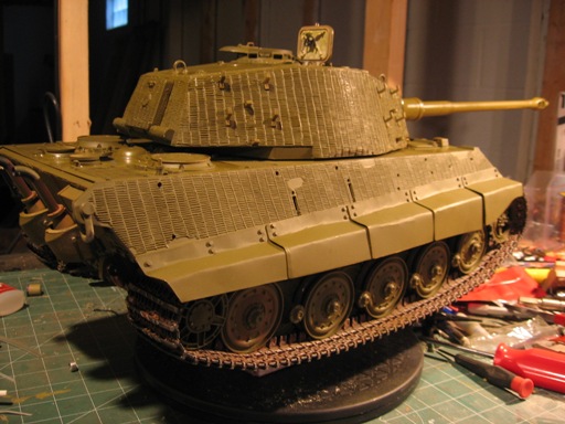

started some detail work. electrics pretty much done....
just takes a large amount of effort to get this together.
