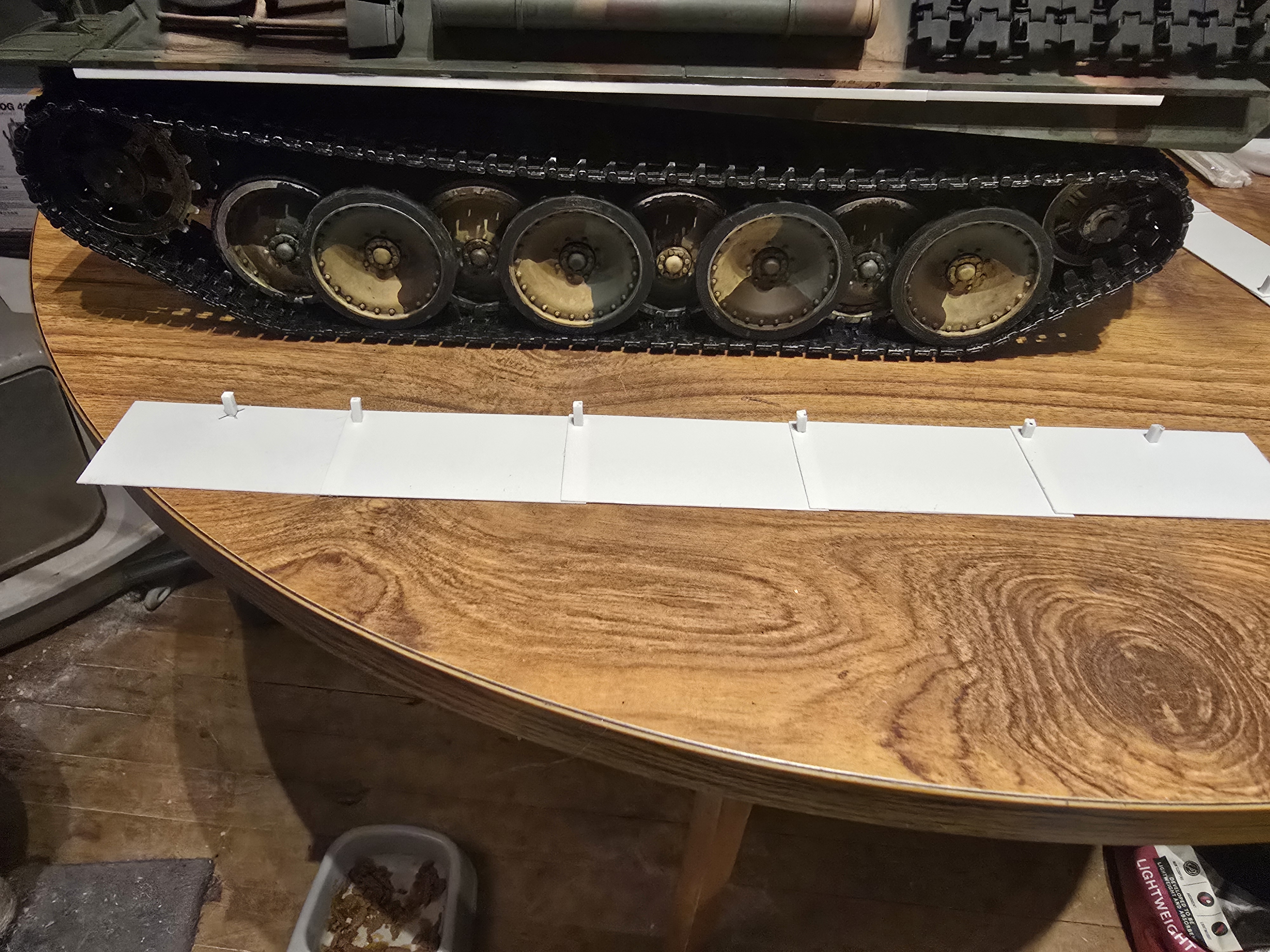

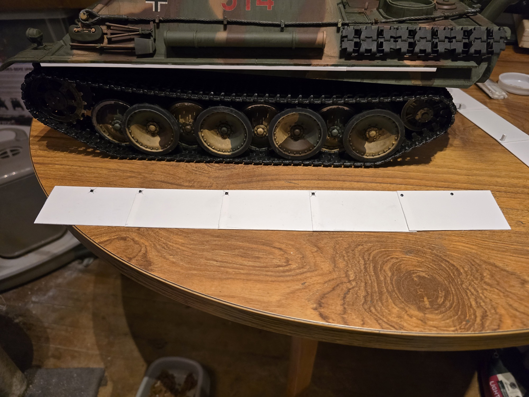

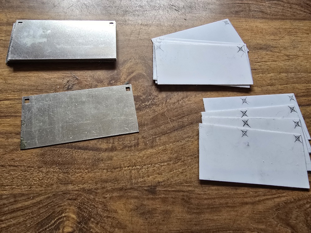

Ok I decided to fit schurzen to it so i purchased these which duly arrived
About your JaPa, any plans adding Schürzen?
I did saw them out of aluminum with brackets out of brass.
But….if you want the easy way, on Ali Cool Bank offers a complete set of very thin, aluminum Schürzen with plastic hangers.
I do have another set from Cool Bank Schürzen on one of my Panzer IV‘s.
Nice alternative to home made stuff.
[/quote]

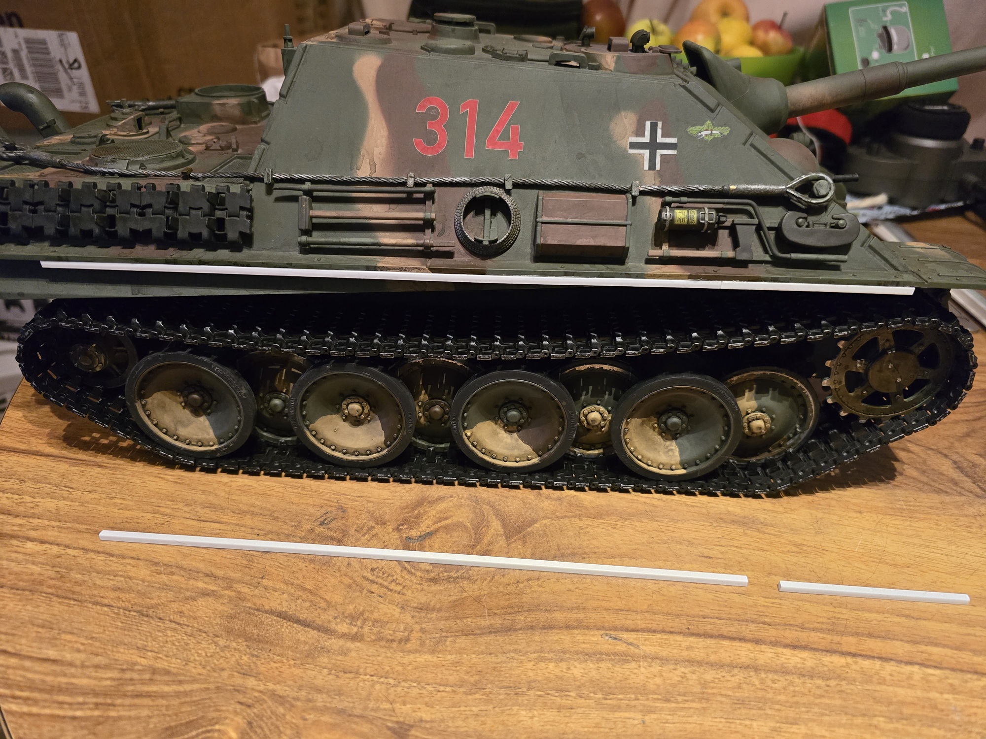

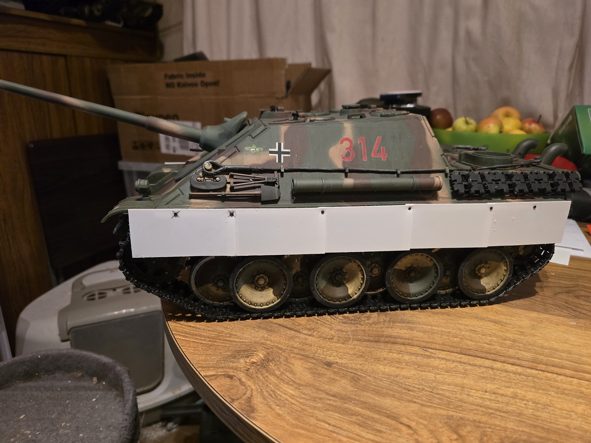

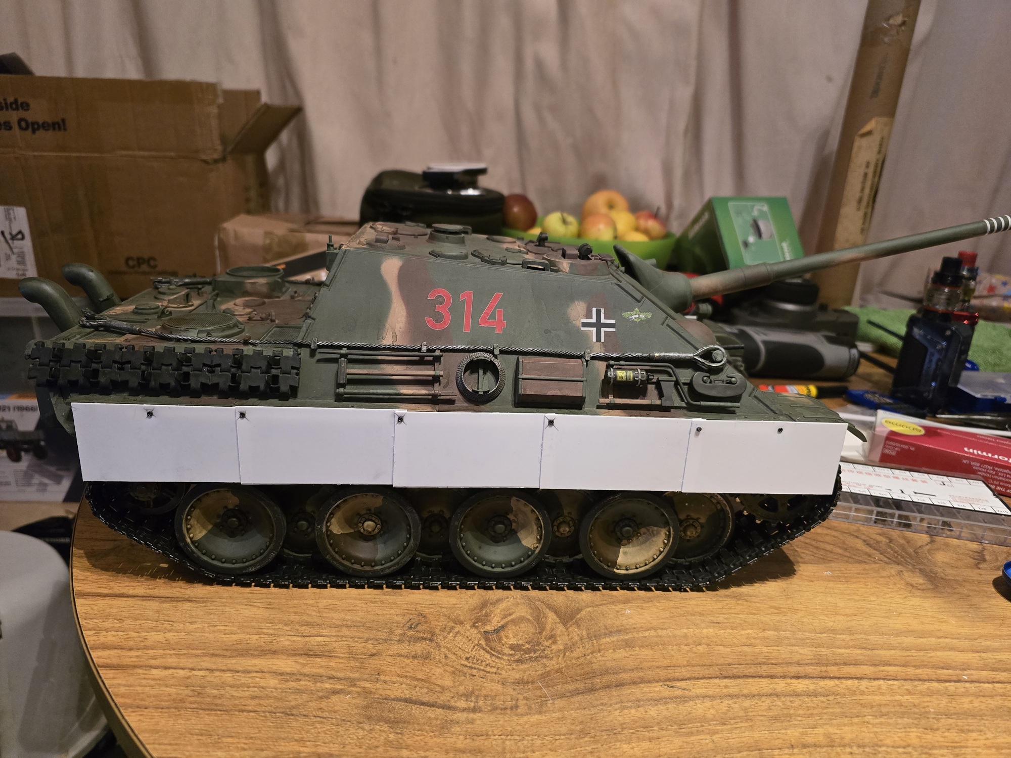

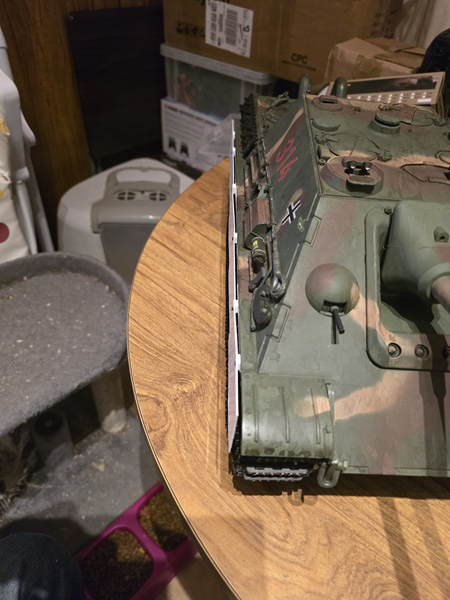

But wasnt happy how they just hung on the runners
so i used the aluminium bits to make templates
then thought how to mount them
i cut some 3mm square section then drilled them and temp fitted the schurzen but it was kind of skew wiff
so abandoned that and tried 3mm square section glued to hull lengthwise
i added little bits of 1.5mm plasticard to behind the screwholes as standoffs then drilled holes in the square section and screwed the shuzren on
I wanted a fairly robust way of mounting them but removable if needed and not falling off when run outside
so a tidy up and paint is next step
