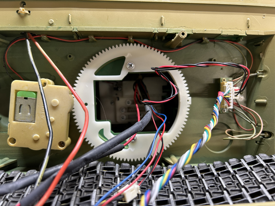

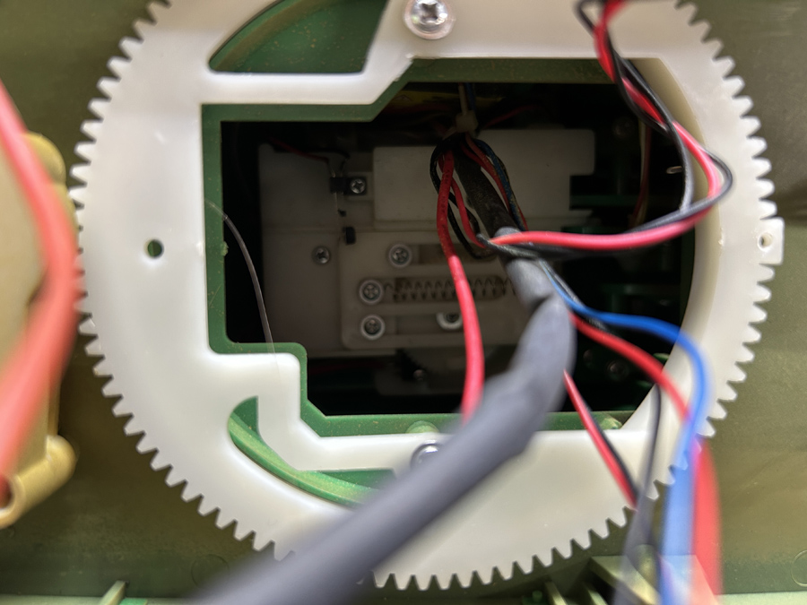

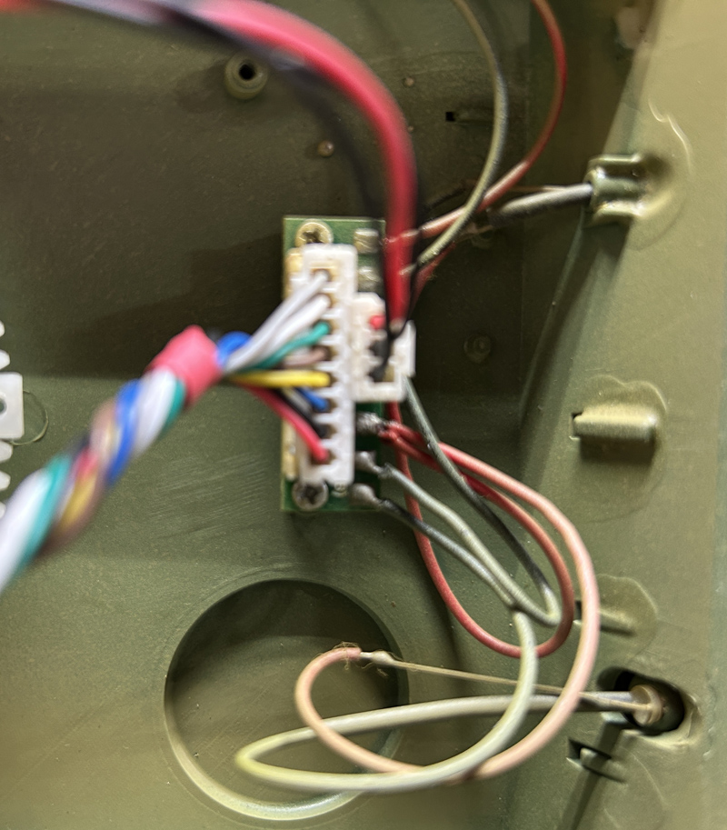

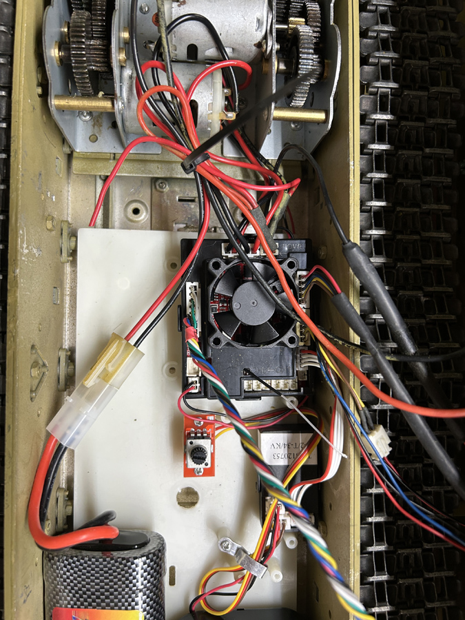

I recently unearthed a Taigen/Torro KV-2 Beutepanzer I bought some years ago (a widower now, I still make a point of not keeping hobby receipts. >:< ). It has LED flash and recoil. It has a Taigen V3 installed, and I cannot recall (CRS disease) if I installed the electronics or these are original. Everything works--except the cannon firing: no sound, no flash, no recoil. I have had the turret open, checked writing connections, re-read the instructions (hey, I do have CRS, so maybe I forgot...). No luck.
Here's an interesting symptom: moving the left stick of the transmitter downward alternately elevates and depresses the cannon elevation. That's just as it should be. But moving the right stick of the transmitter upward also alternately elevates and depresses the cannon elevation. Hmm...
I don't want to spend more moola just now. (Sure, HengLong TK7.0 would give me better control, but for my minimal uses, the Taigen/Torro is good enough and in the case of the Russian engine, a bit better sound.)
Does anyone have any ideas of how to diagnose the problem?

Sometimes the micro switches on the Asiatam recoil units go bad. When that happens, nothing "triggers". I think we would need to see the recoil wiring as it has a bunch of wires going to it.
