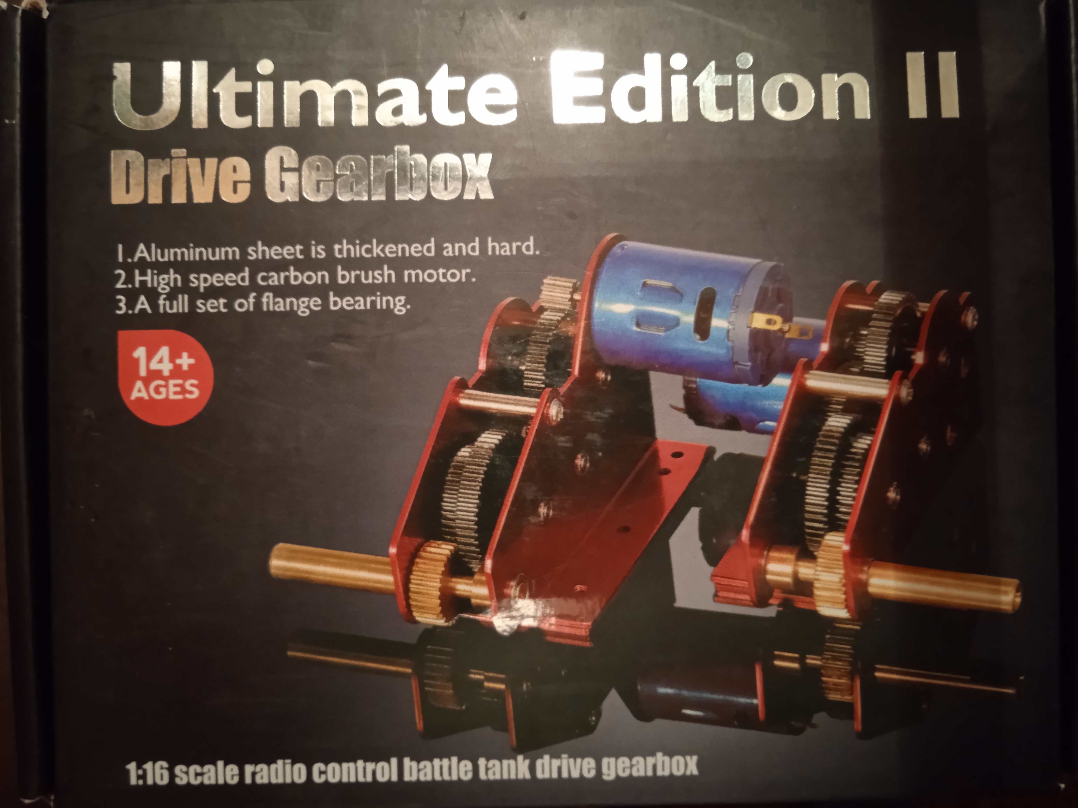

I have such gearboxes... I installed them in the place where I thought it was necessary, made my own mounting points, for installation accuracy, used a shaft with a diameter of 8 mm, so I got precise alignment.

I didn't know that there was any need to make new mounting positions when installing any Heng Long Gearbox into a Heng Long tank (assuming it was the correct type of gearbox for the model it is being fitted into).
Using the longer RED motors need's a little 'adjustment" to stop the lower motor shorting-out against the gearbox side it is touching, but the blue motors than come with the Ultimate Edition 11 gearbox are shorter and should be a straight "drop-in" fit?
zooma
Posts: 775
Joined: Thu Feb 08, 2024 4:20 pm
Location: Rossendale, Lancs.
Re: Heng Long Challenger 2. Red Gearbox Wanted to fit Challenger 2.
Post by zooma »
I want to find one of these to fit my Challenger 2.
Does anyone know where I can buy one of these to fit a Challenger 2 ?
Apart from liking the red colour (!), I like the hardened alloy gearbox frame and the bearings, but I would want to remove the shorter BLUE motors and replace them with the longer RED motors so - I would still need to modify the mountings slightly to prevent the risk of the lower motor shorting against the opposing gearbox frame.
Pavel
Posts: 506
Location: Москва Россия
Re: Heng Long Challenger 2. Sprocket Problems.
Post by Pavel »
They sell (expensive) a block there are no problems with installation.....
It was specifically developed for Challenger 2
All videos are about this.
https://www.rctank.de/Challenger-PDSGB- ... -Heng-Long
zooma
Posts: 775
Post by zooma »

Pavel wrote: Thu Jan 09, 2025 12:28 pm They sell (expensive) a block there are no problems with installation.....
That looks interesting Pavel - I wonder how the power output of the 480 motors that they use in this gearbox compare with the RED motors that I am using now?
