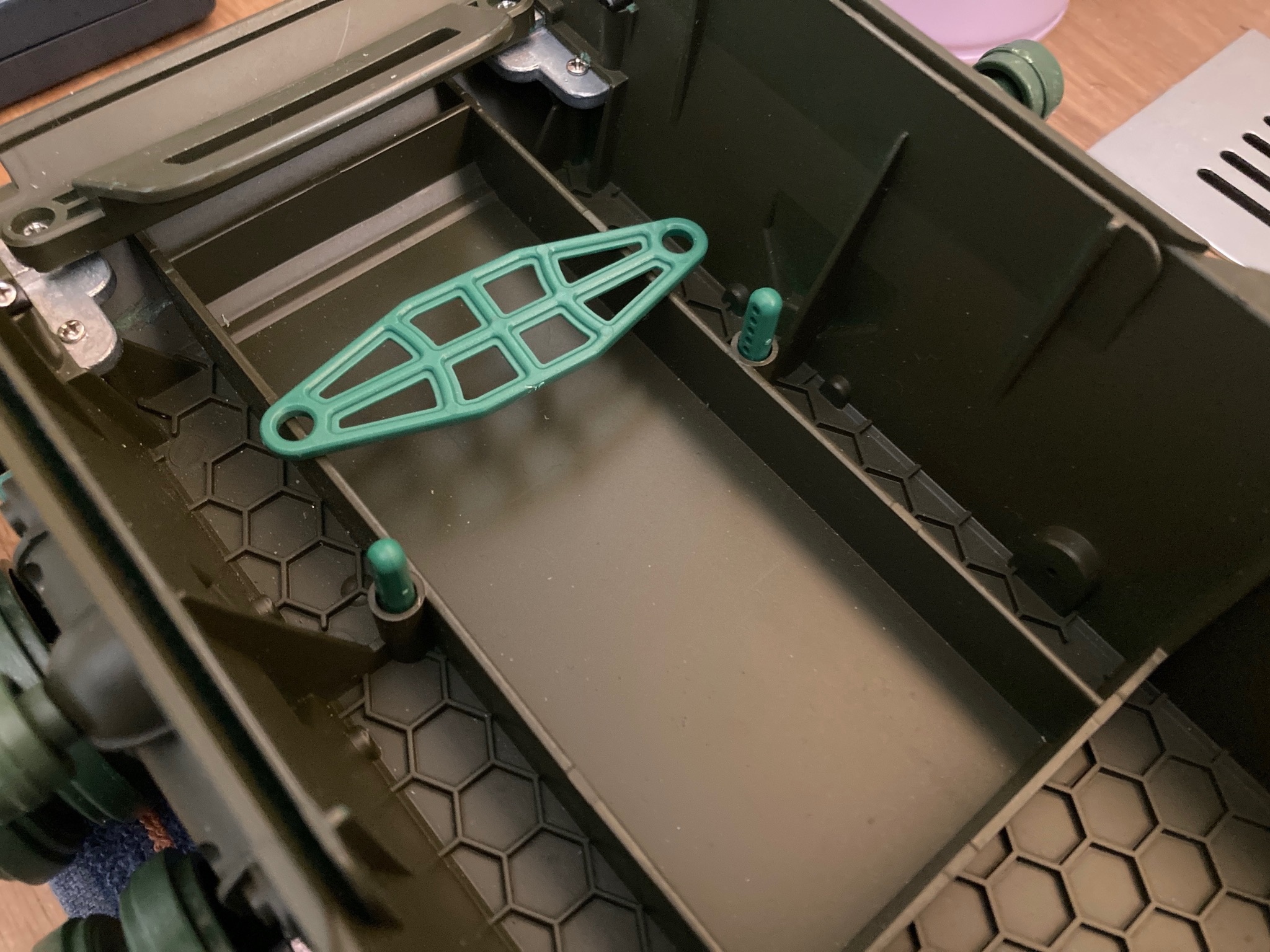

While waiting for the two metal return roller axles to be delivered, I have started sifting through the moulded sprue's to see what shapes I recognise that can be fitted to the hull.
The first things that I have found are what looks like two body posts (in model car talk). These are the posts that the battery retaining strap fit onto, so I have cut them off of the sprue and super-glued them into the sockets that hold them inside the hull.
No clips to hold the battery retaining moulding onto these straps are included in the kit, but I have some spare "body clips" that I use to hold the bodies onto my r/c cars, so I have used a pair of them - and they fit perfectly.
- Posts to hold the batttery retainer super-glued in place

I personally have velcro mounted on my batteries so I just added velcro in the battery tray and ditched the whole battery strap/clips. I buy the 2" velcro on the big roll and it lasts me a long time.

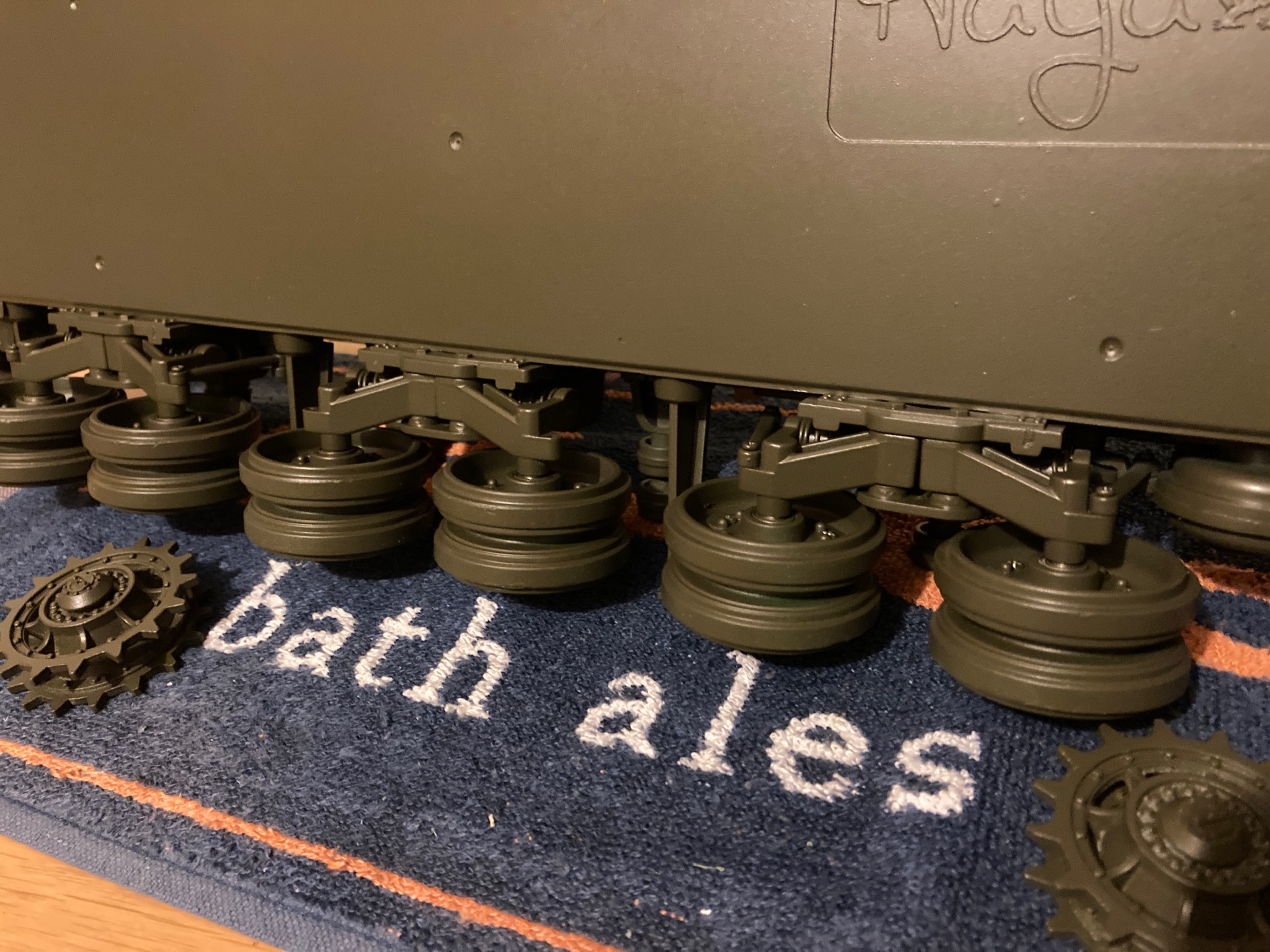

HAYA Centurion KIT - Chassis Painting
I have just about used up all of my original 3 tins of old stock TS-5 Tamiya Olive Drab "rattle cans" on the lower chassis parts and it has done a decent job of hiding most signs of the bright Kermit Green coloured plastic!
I actually sprayed the wheels while they were still mounted on the chassis. This allowed me to turn the wheels as I painted them, but the area between the front and rear halves of the joined wheels are not covered as well as they would have been if I had pre-spayed them before screwing the two halves together. Does it matter?...I do intend weathering the tank and I can get a brush in-between the inner and outer drive wheels if I feel the need....
Spaying with the wheels fitted also shielded some small areas from the paint spray (parts of the suspension springs etc) - but again - they are in an area that will probably never be seen that will be weathered in any case, and can be reached with small brush if needs be.
I am guessing that the above comment about spray coverage would apply to anyone that prefers to spray their tanks after assembly and is easily dealt with afterwards?
Any small areas that were not covered by the spray can paint will be touched-up later by hand or air brush, but for now it is "good enough" and I am looking forward to fitting the tyres to the drive wheels and rollers as soon as the paint is hard enough to stay on.
Hopefully the two missing return roller axles will arrive shortly so I can fit them to complete the running gear and the lower chassis build assembly.
I am look forward to fitting the tracks and connecting each motor in turn to a battery just to make sure that everything is lined-up OK and that the tracks will stay on and run true.

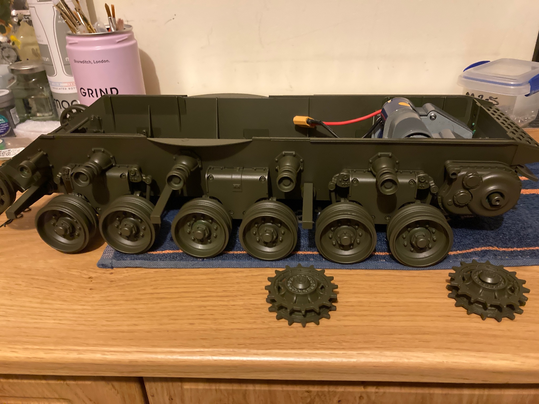

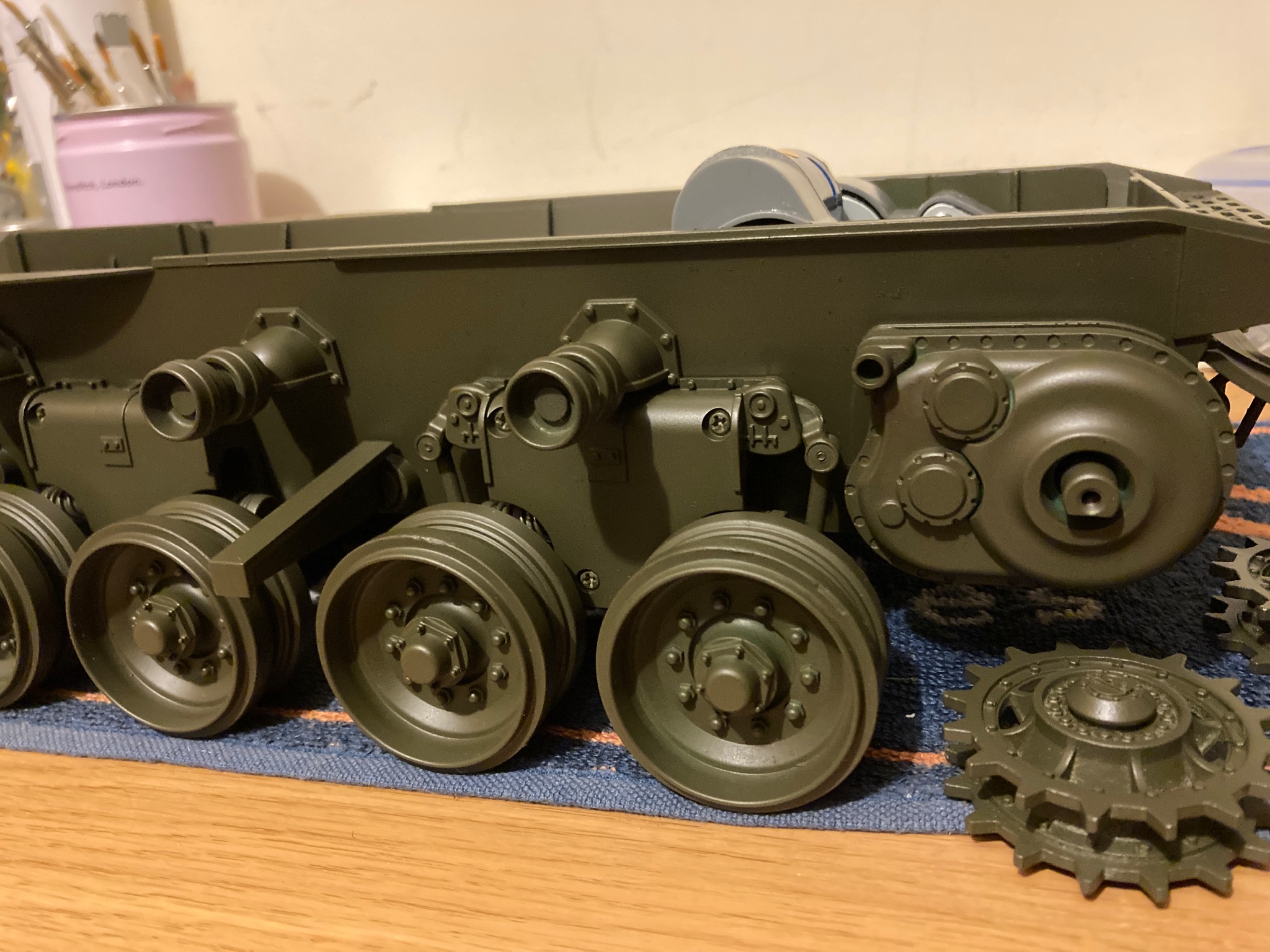

HAYA Centurion KIT. Chassis painting finished?
the Areas not fully covered with paint....
.....maybe another dash of the rattle can in a few small areas ......but it is going to be weathered....so maybe not?
- DEE2DDB5-358F-4C50-B026-76D7A72DECB5.jpeg (711.44 KiB) Viewed 975 times
- 2EB19958-4276-4117-BA69-16B79ACC0E04.jpeg (691.26 KiB) Viewed 975 times

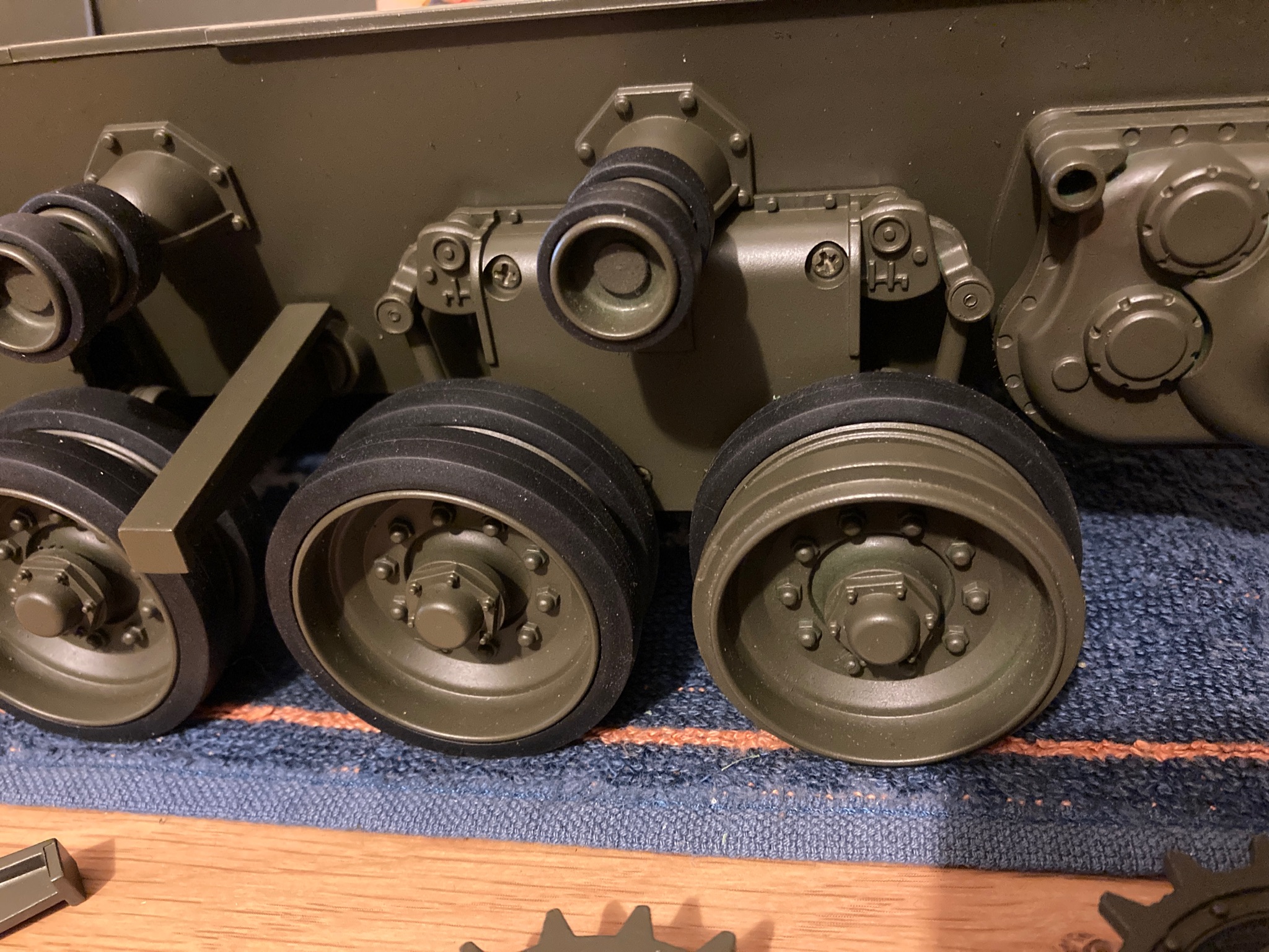

HAYA Centurion KIT. Fitting the tyres.
With the paint dry on the wheels and rollers I was able to fit the tyres.
The roller tyres are a very simple straight fit - just gently push them on and check that they are equal on each side and give each roller a spin to see if they spin without any wobble - if any do wobble, just manipulate the tyre until it is "square" and central and spin it again to double check.
The main road wheel tyres are just as easy to fit BUT they do have two different heights of tyre wall to look out for. The higher wall goes to the outside of the outer wheels and the inside of the inner wheels, so in each case the higher tyre wall is on the outside of the rim (the inner wheels face inwards - but the higher tyre wall is fitted to the outside edge of the rim so it is facing inwards towards the middle of the tank).
Spinning each wheel as the tyre is fitted soon identifies any tyre that is not sat squarely on the rim and can be easily corrected with a bit of gentle manipulation.

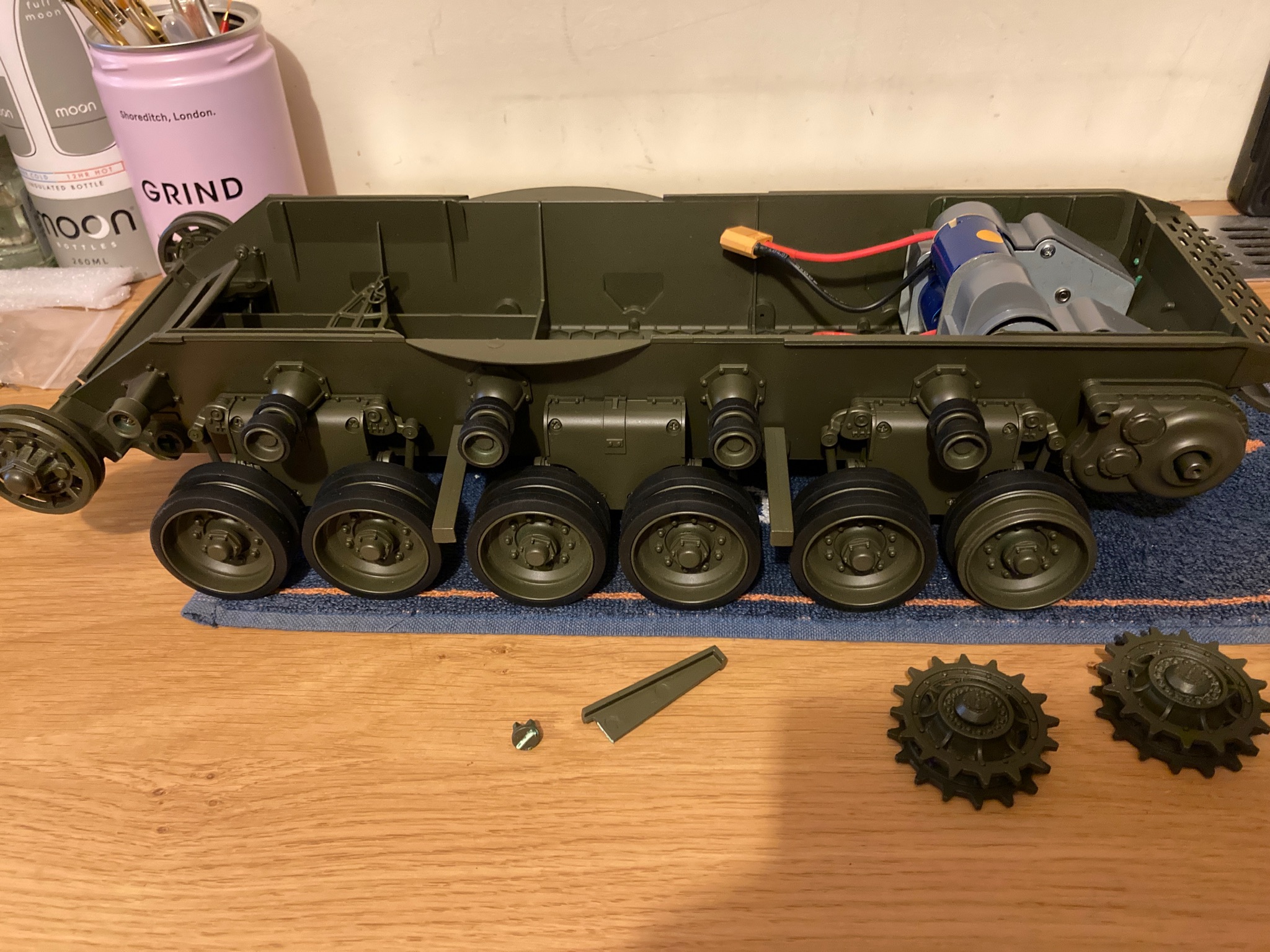

Unfortunately I had one large tyre MISSING! I was working on my desk from the sealed plastic bag so there is no chance of dropping one and not seeing it - but in any case I only took one tyre out of the bag at a time, so it is definitely MISSING. This is a shame as progress on the lower hull is now stopped as I wait for a new tyre and the two missing rear roller axles to arrive.

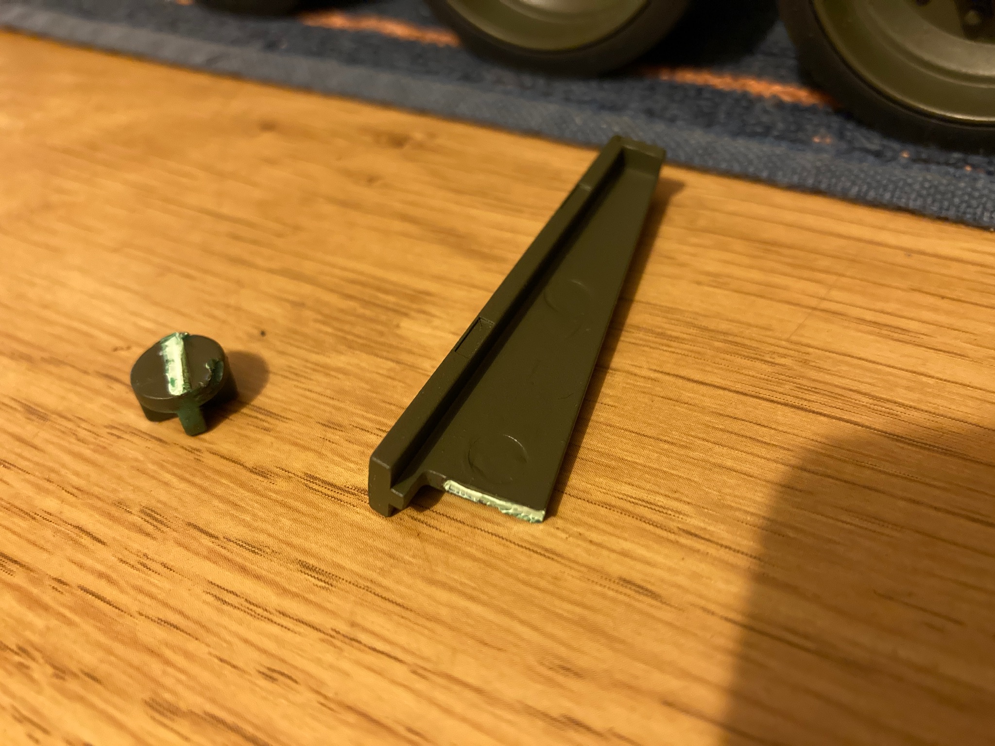

I also have a broken Bazooka Plate Support. I am not at all sure what happened, but one of these strong looking supports has "sheared-off" at its root. I have given all the others a god solid "tweak" to make sure they are OK and every one is "as solid as a rock" so this is a real mystery as the tank has not seen any action yet! Maybe this particular moulding had a slight flaw (?) but either way I need to ask for a replacement part.
This Bazooka Plate Support (like every other moulded part in this kit!) is moulded in a bright KERMIT GREEN colour - but where it has sheared off the plastic is WHITE. The chassis has not fallen off of my desk or been dropped or bumped (yet!) so maybe it was stressed when being pulled out of the mould? .....who knows, but I don't want to glue it back together as I don't think it will be strong enough, so I have asked Andrew at HAYA to send me a replacement part together with the missing tyre and one pair of the missing steel return roller axles.
Work has now stopped on this build until the missing parts (x2 steel axles and x1 tyre) and requested replacement part (Bazooka Plate Support) arrives, as I have no more work to do on the lower chassis and I don't want to start working on the next stage of this kit build until this main area is competed and tested, but I may take a look at weathering the metal tracks a little so they are ready to fit as soon as the lower chassis tub build can be completed.
