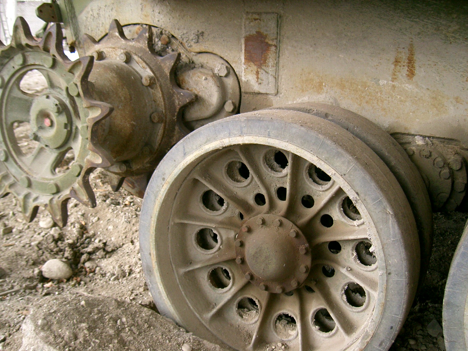

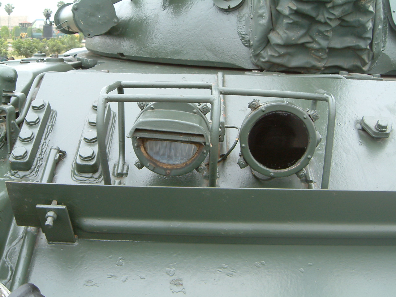

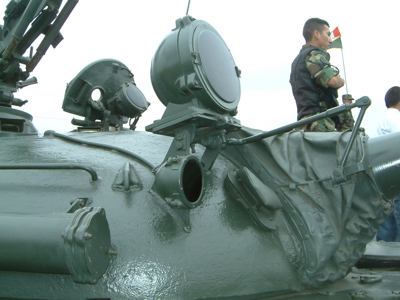

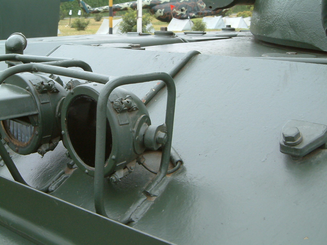

Here you can see on the side lamps the Russian abbreviation of the word GST-64, State Standard of 1964.
The Chinese comrades, copying their Type 59, made inscriptions in their own language.....

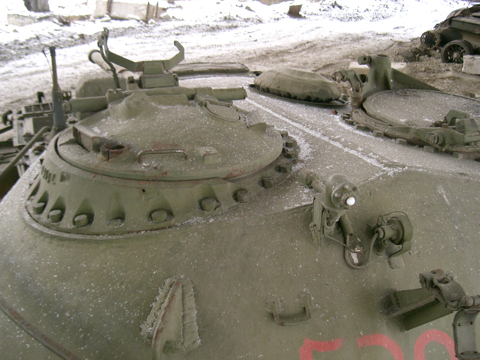

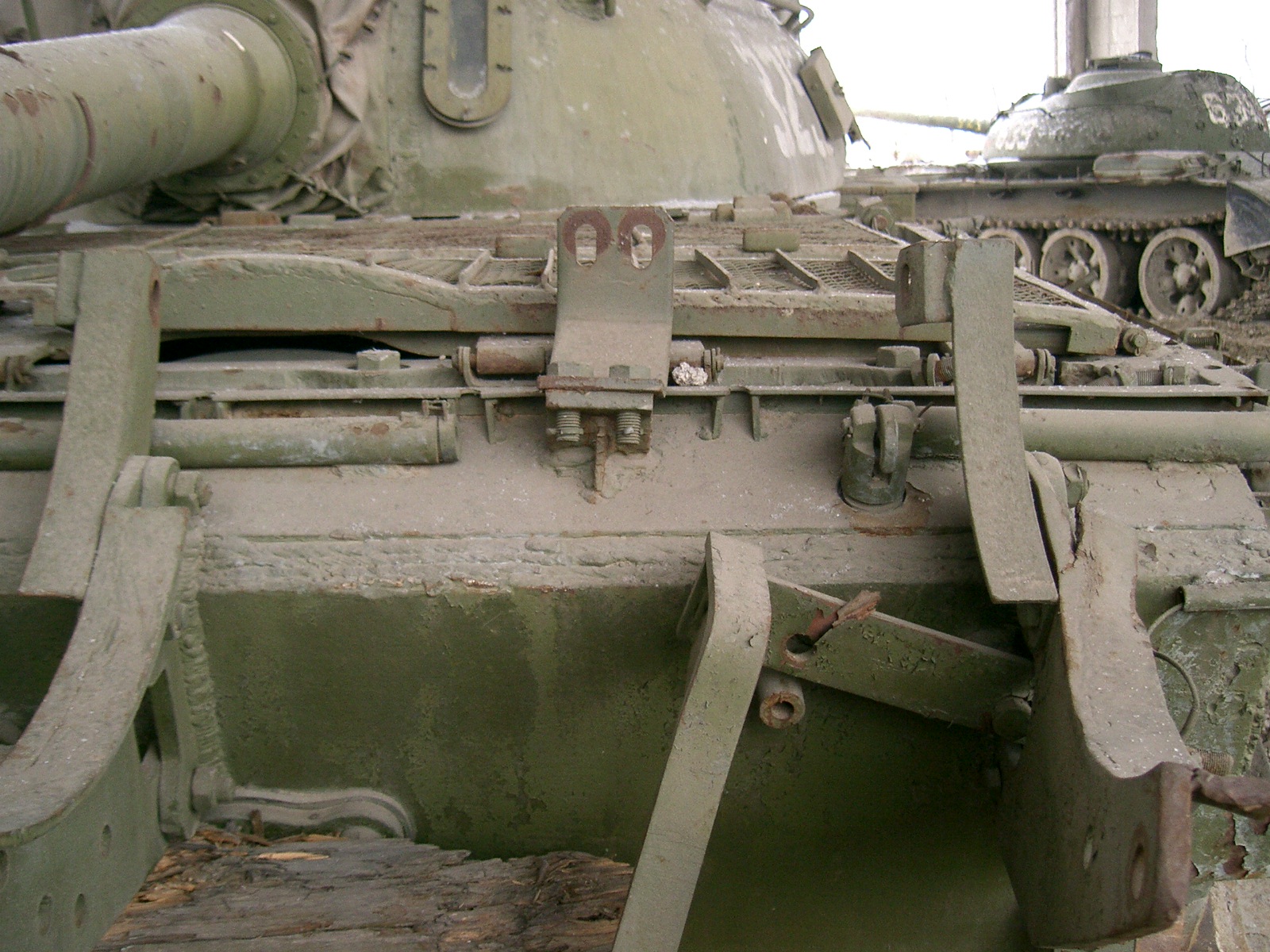

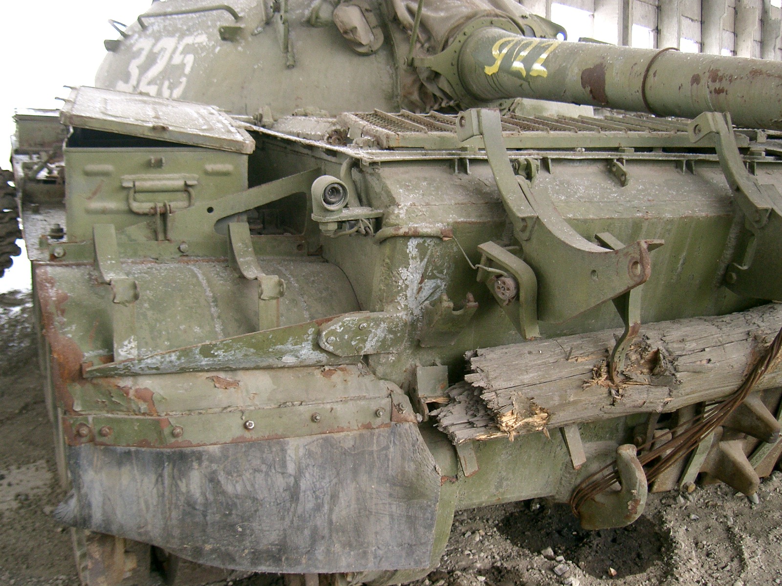

Even a broken tank can provide some information...

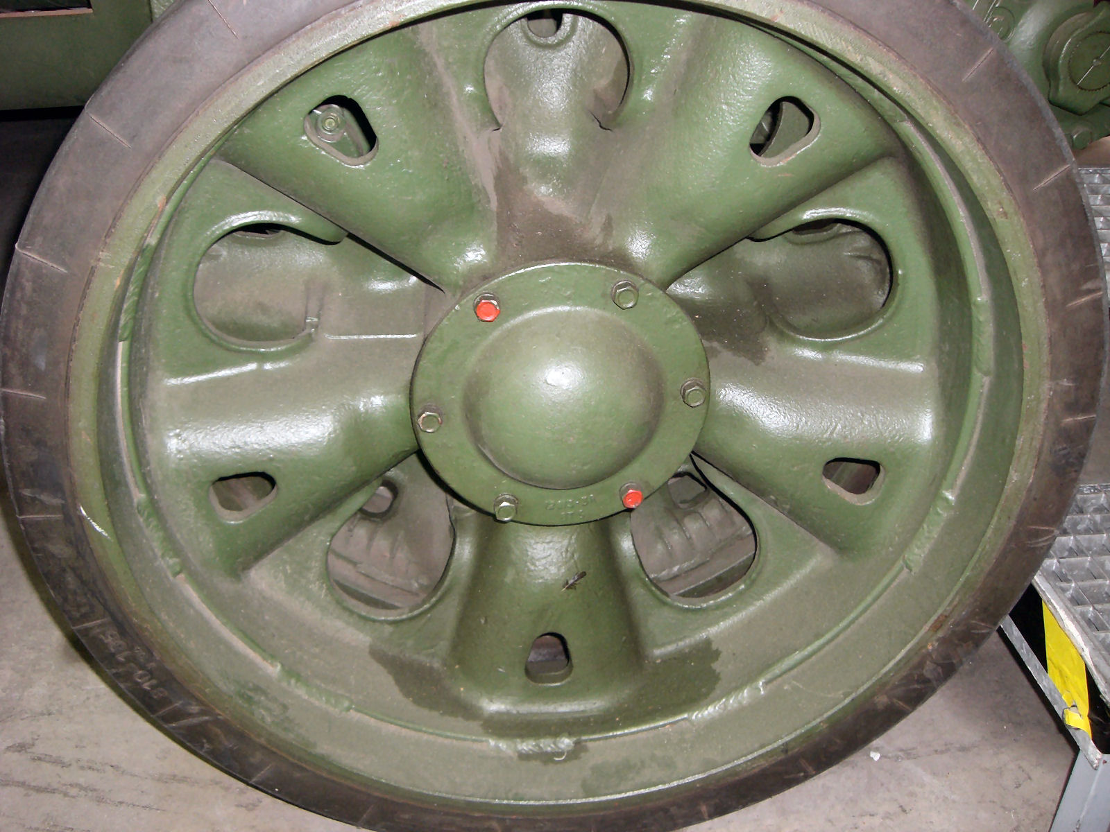

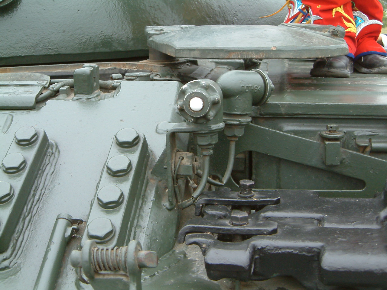

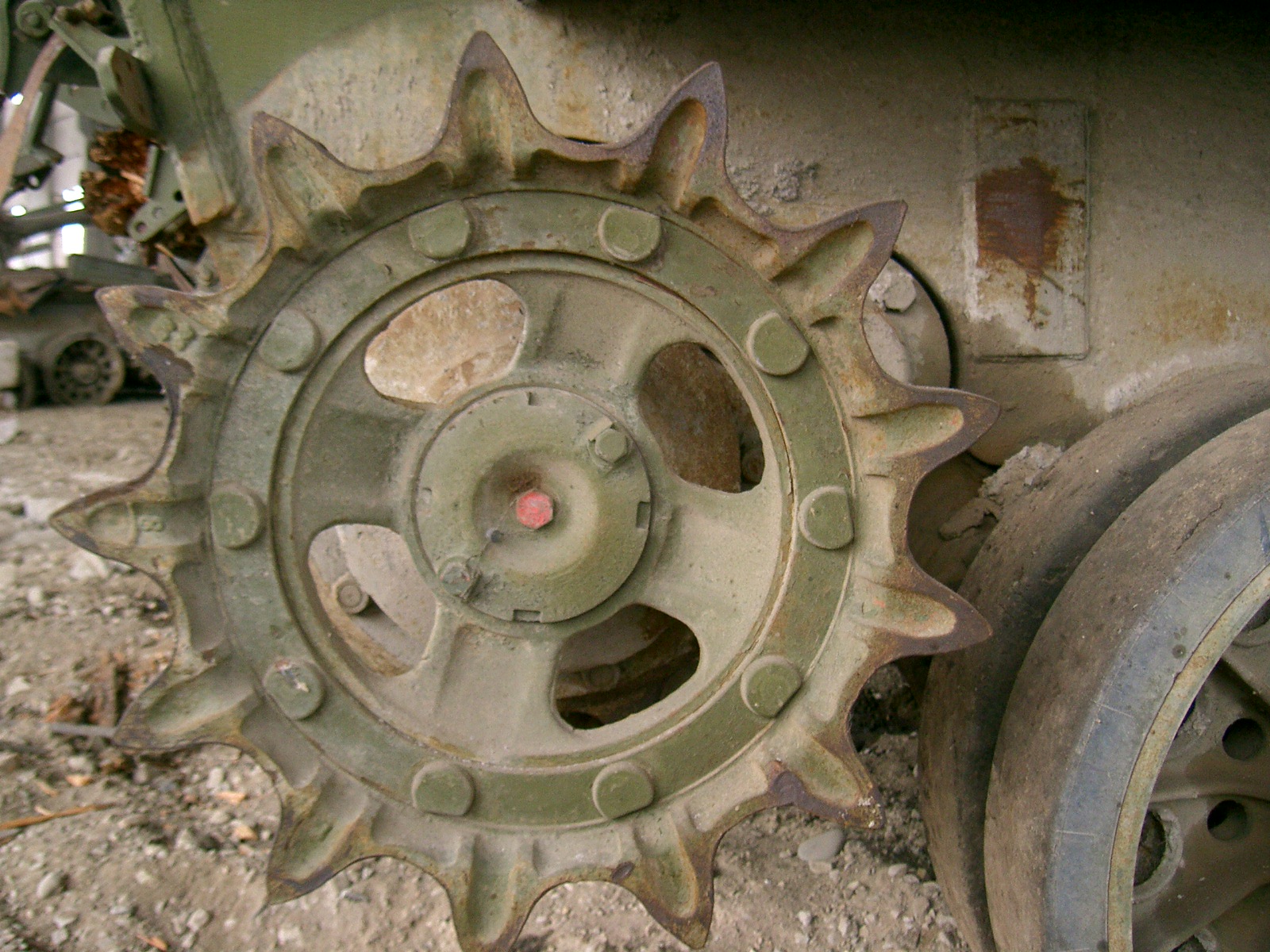

On the tank, red paint is used to mark the bolts that are unscrewed to fill the oil.
Pavel
Posts: 506
Location: Москва Россия
Re: Hooben T-55A Build
Post by Pavel »
Now you know what's underneath the dirt.....
And this is the rule!
The lubrication point is indicated in red.
Posts: 5780
Pavel, would the same use of red bolt heads apply for the T72, T90?

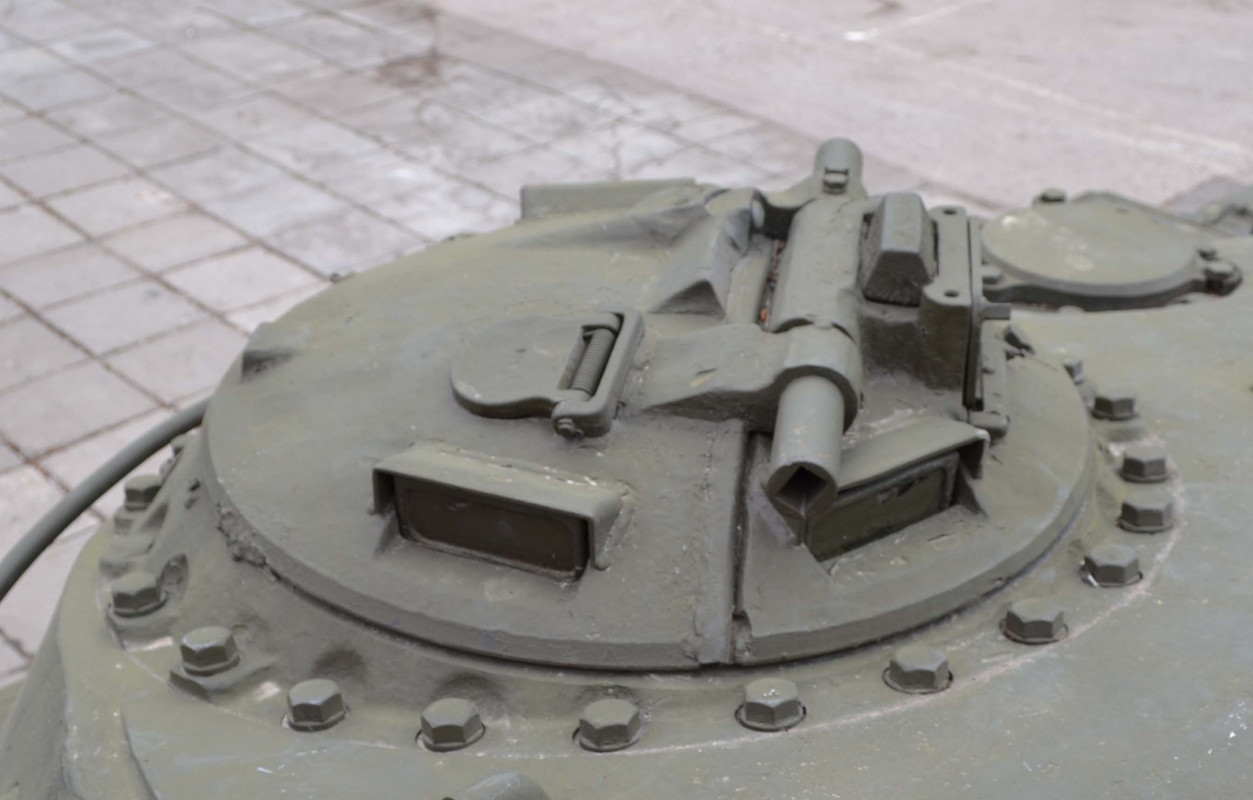

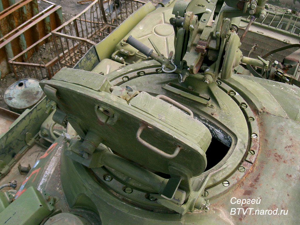

Do you have any photos of the top of the turret & turret hatches?
Pavel
Posts: 506
Post by Pavel »

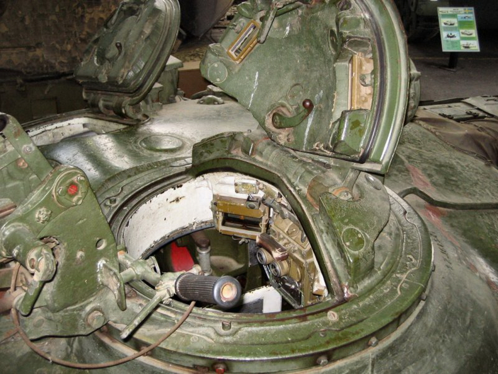

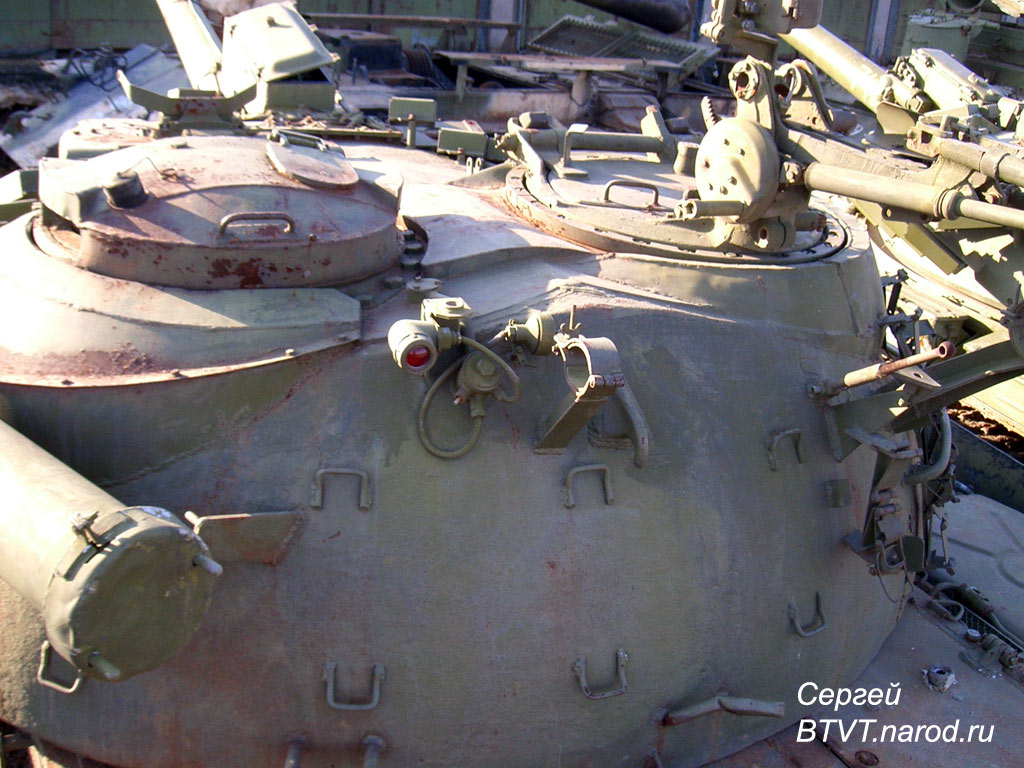

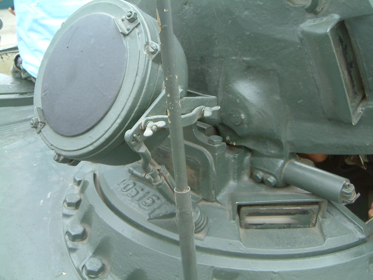

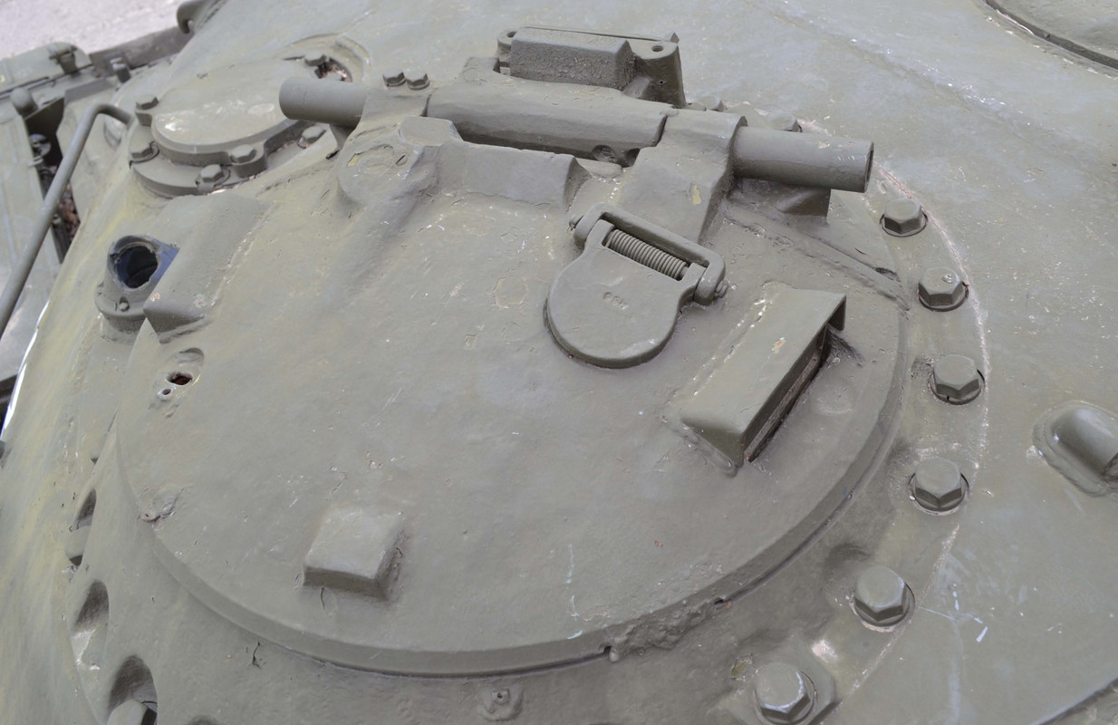

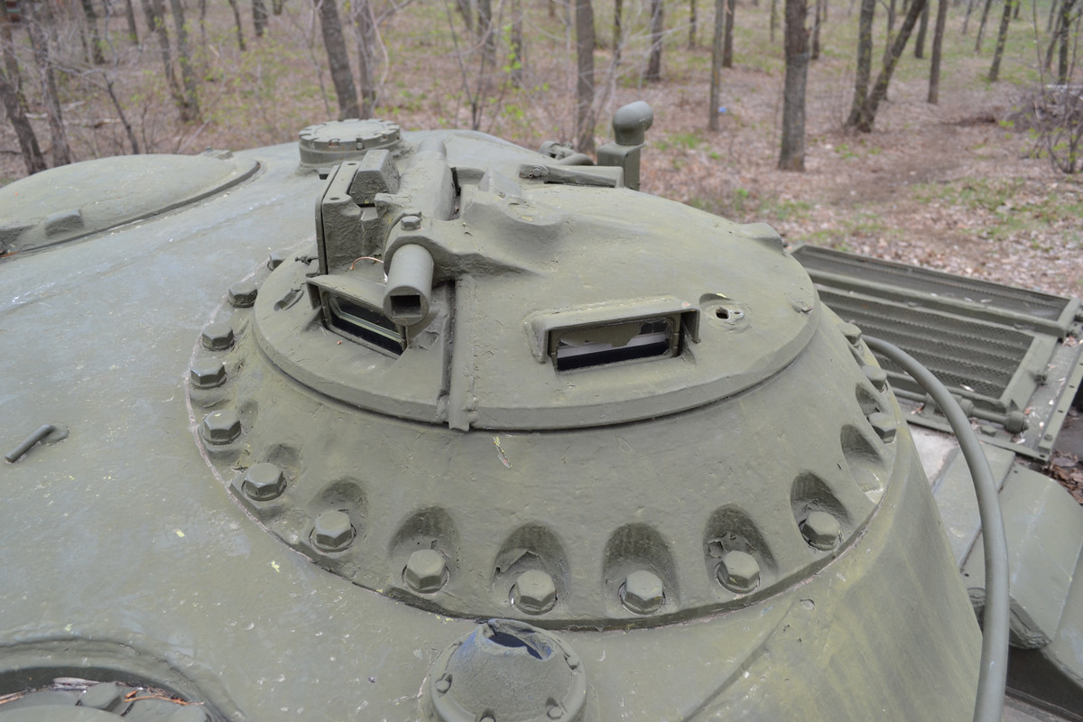

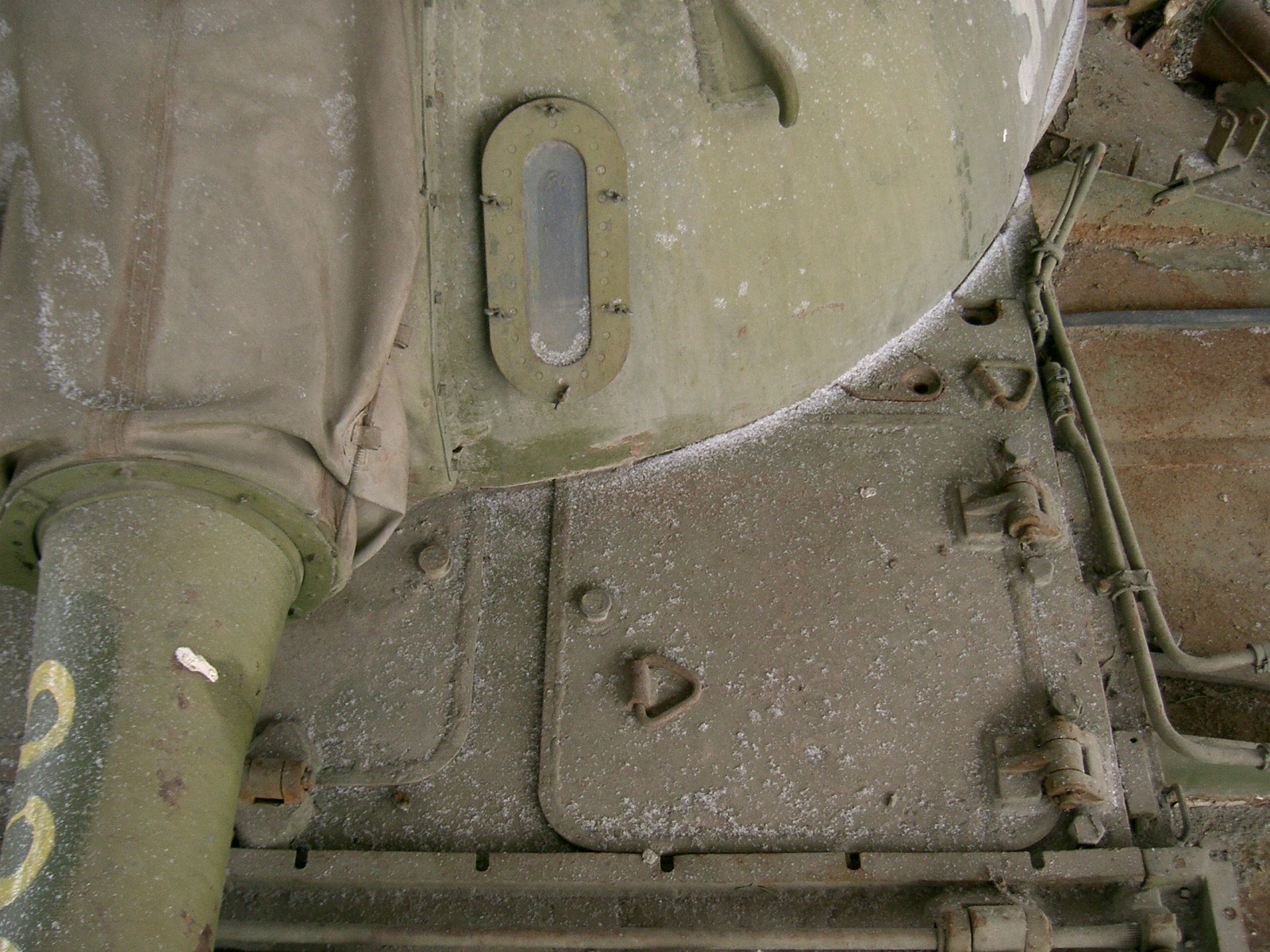

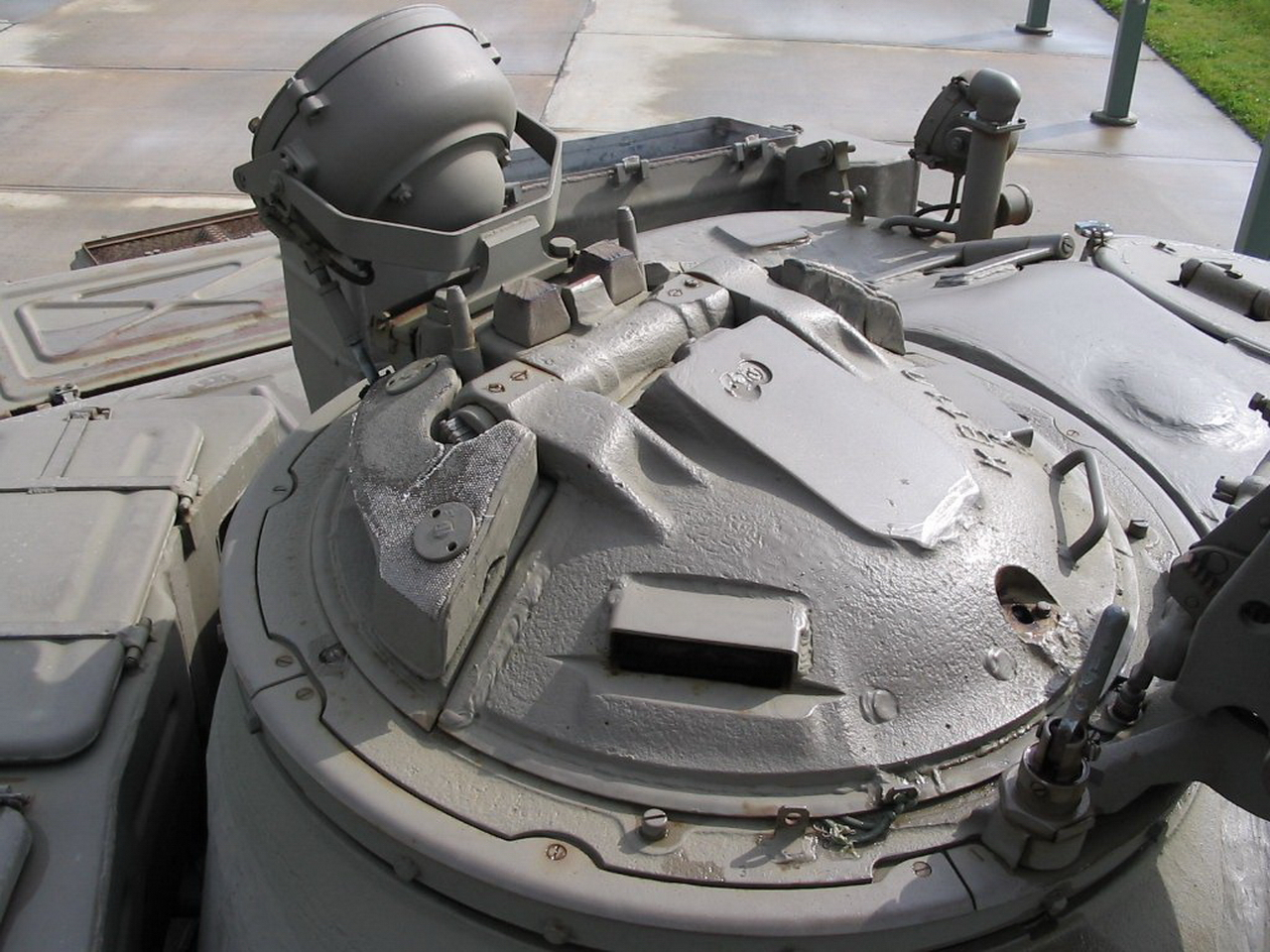

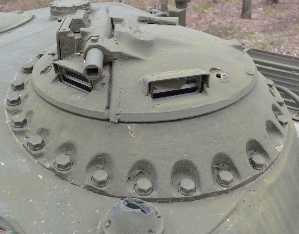

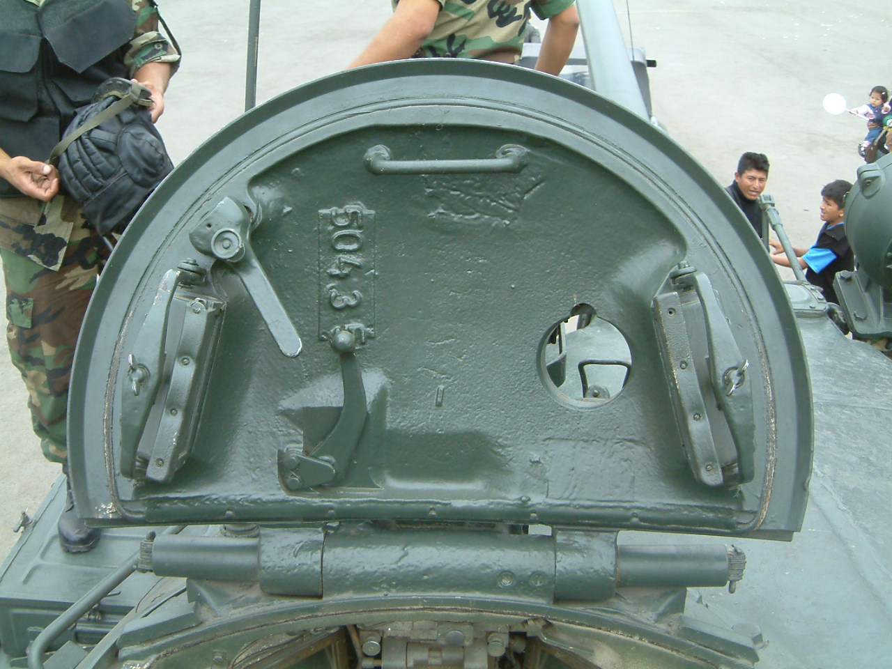

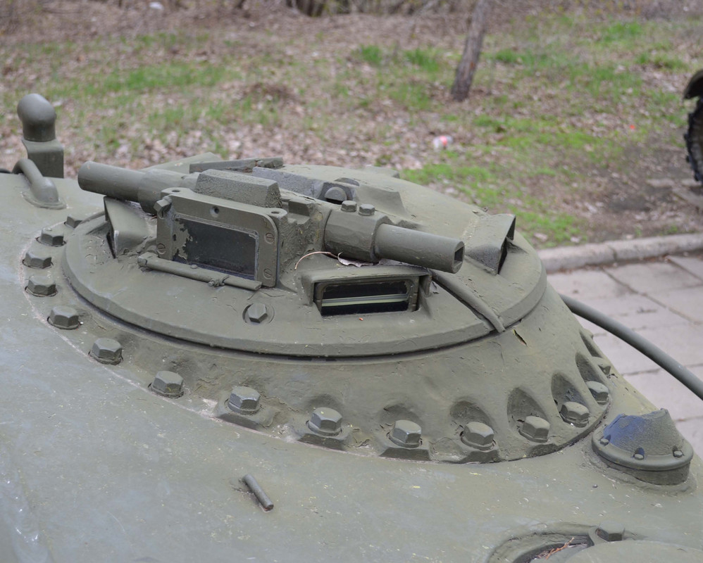

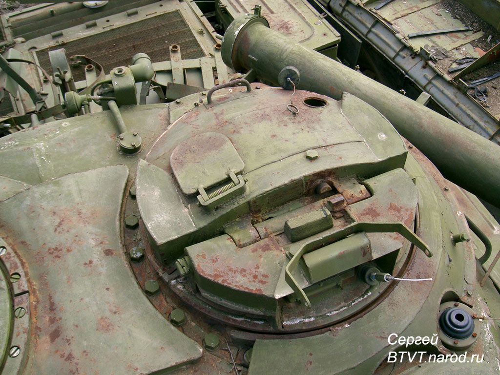

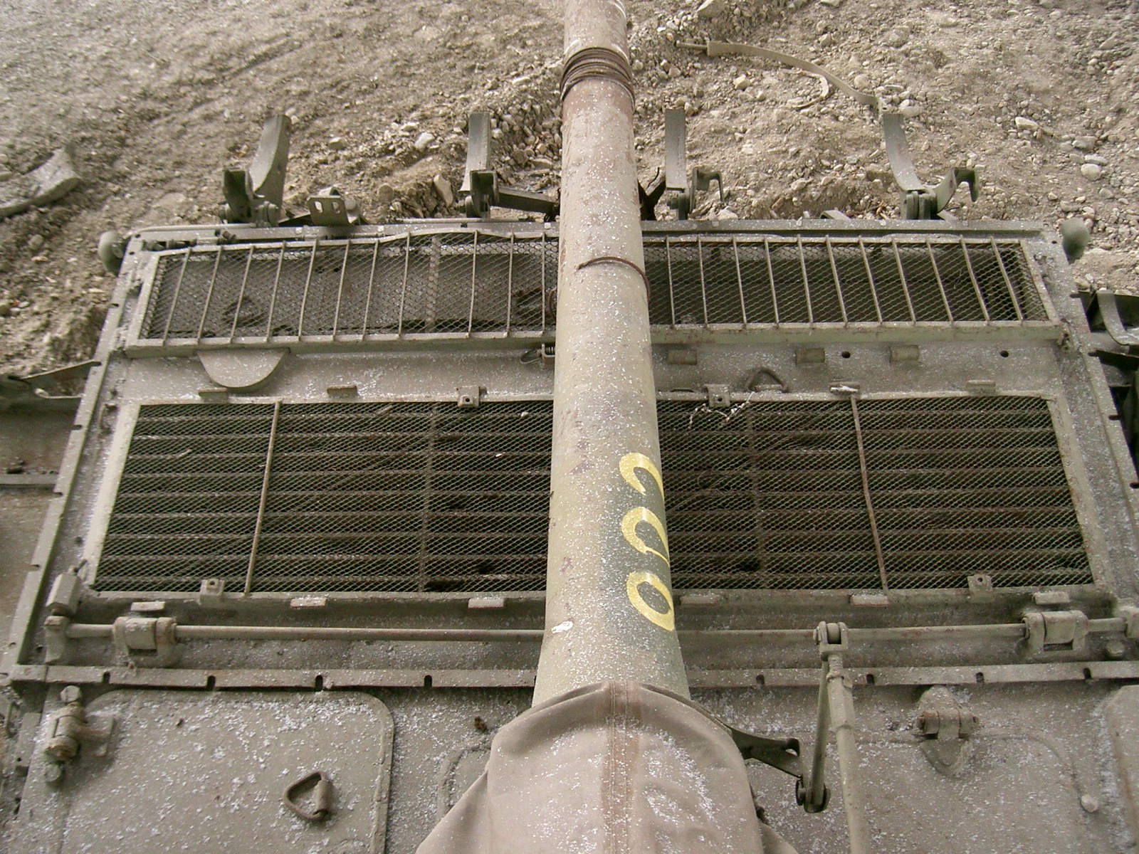

There are different modifications here, pay attention to this, I was also confused, but.... to be frank, such differences cannot specifically determine the modification, because... these parts could be on ANY model....they did not adhere to a certain standard in parts..
image (4).jpg (183.13 KiB) Viewed 1682 times
image (3).jpg (187.89 KiB) Viewed 1682 times
image (2).jpg (160.17 KiB) Viewed 1682 times
image (1).jpg (142.66 KiB) Viewed 1682 times

In the pipe where you see the square hole there is a spring for opening the hatch cover, when the spring is in it you see a latch....
