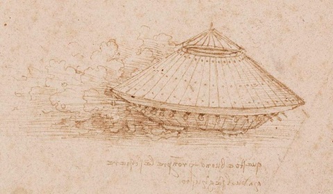

I didn't think about it at first, but my "bell" (or, as I prefer, "UFO") tank is actually not that far off from Leonardo da Vinci's early tank ideas:
Leonardo_tank resized.jpg (54.5 KiB) Viewed 4584 times

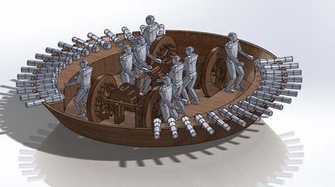

Leonardo Tank Drivetrain resized.jpg (43.96 KiB) Viewed 4584 times
His design has flat faces and four or five guys for propulsion, ... so, an "engine" of 0.5 horsepower :D , but hey, the guy did live like 500 years ago.
