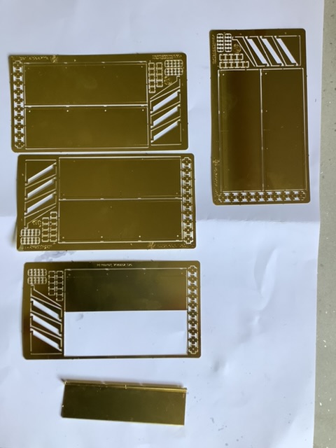

Photo etch mudguards have arrived for this. Now have to learn the best methods of assembling these. I would like to solder them for strength.

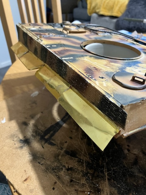

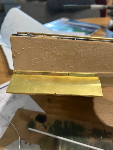

First side mudguards on.
Tinning the parts.
First section attached.
Lastly the first side is complete

That brass work is excellent! I was toying with doing that on my fender-less Tiger, but did not think I could pull it off!
Just curious, how thick is that stuff and how did you manage such perfect bends?

Once in place, run a good bead of straight PVA glue under them with the hull upside down.
It will add a bit of shock absorption to them and won’t be visible.

Ecam wrote: Sun Feb 25, 2024 7:09 pm That brass work is excellent! I was toying with doing that on my fender-less Tiger, but did not think I could pull it off!
According to my none too accurate micrometer 0.25mm. The bends to give the mudguards the shape were done in a vice. The damage was done just by manipulating them between my fingers. I am just trying to replicate what I see in the pictures I am working from. The tank was pushed out of the way, off the road with a Sherman, following capture.
Re: D-Day. A very British Tiger
Posted: Mon Feb 26, 2024 4:31 pm
by Ecam
They do look fabulous, but keeping them in that same shape will not be easy. I guess adding some thin card (pre-shaped) to the underside (as was mentioned) could help. But these are by far my favorite fenders I've seen to date.
