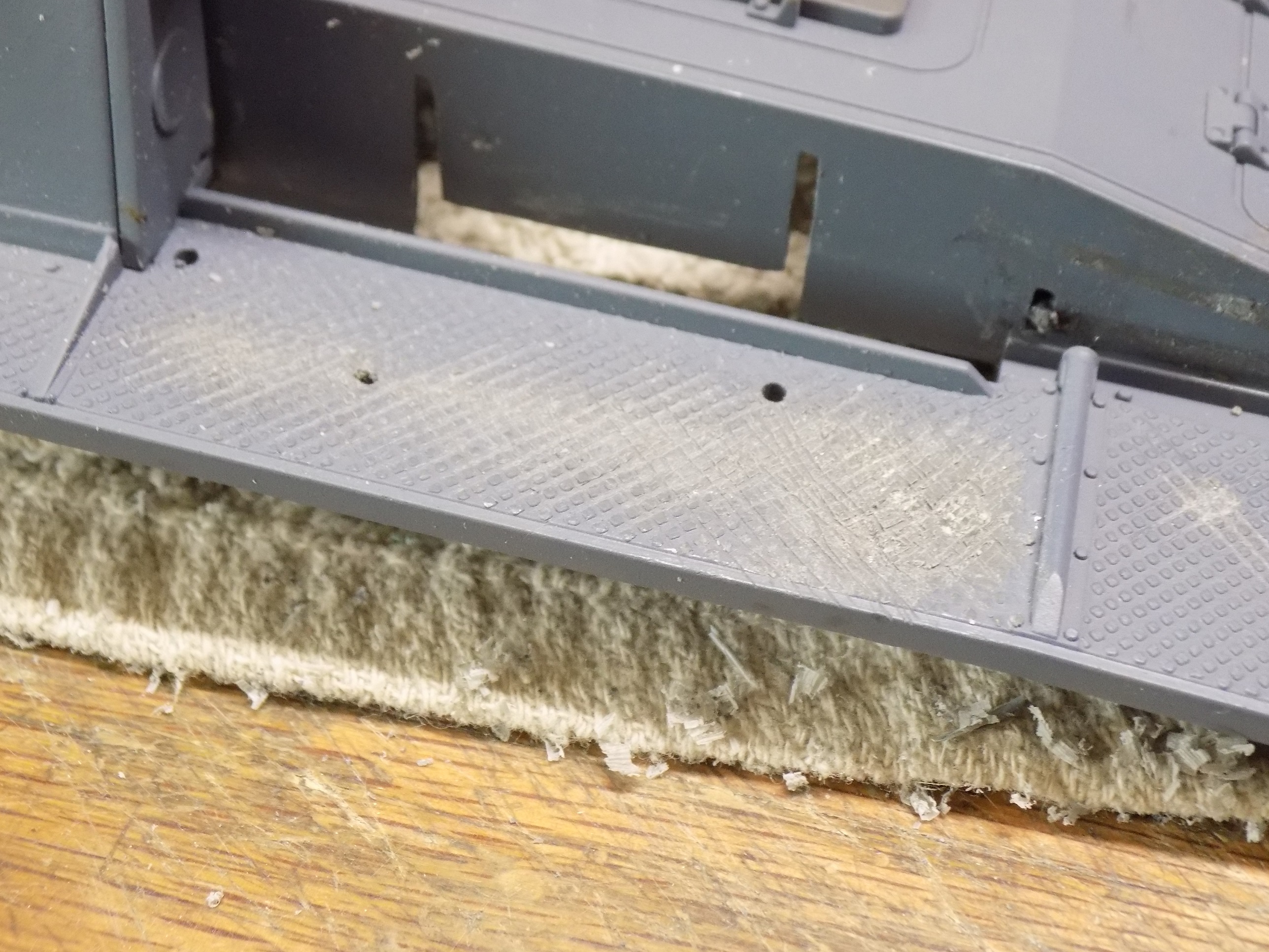

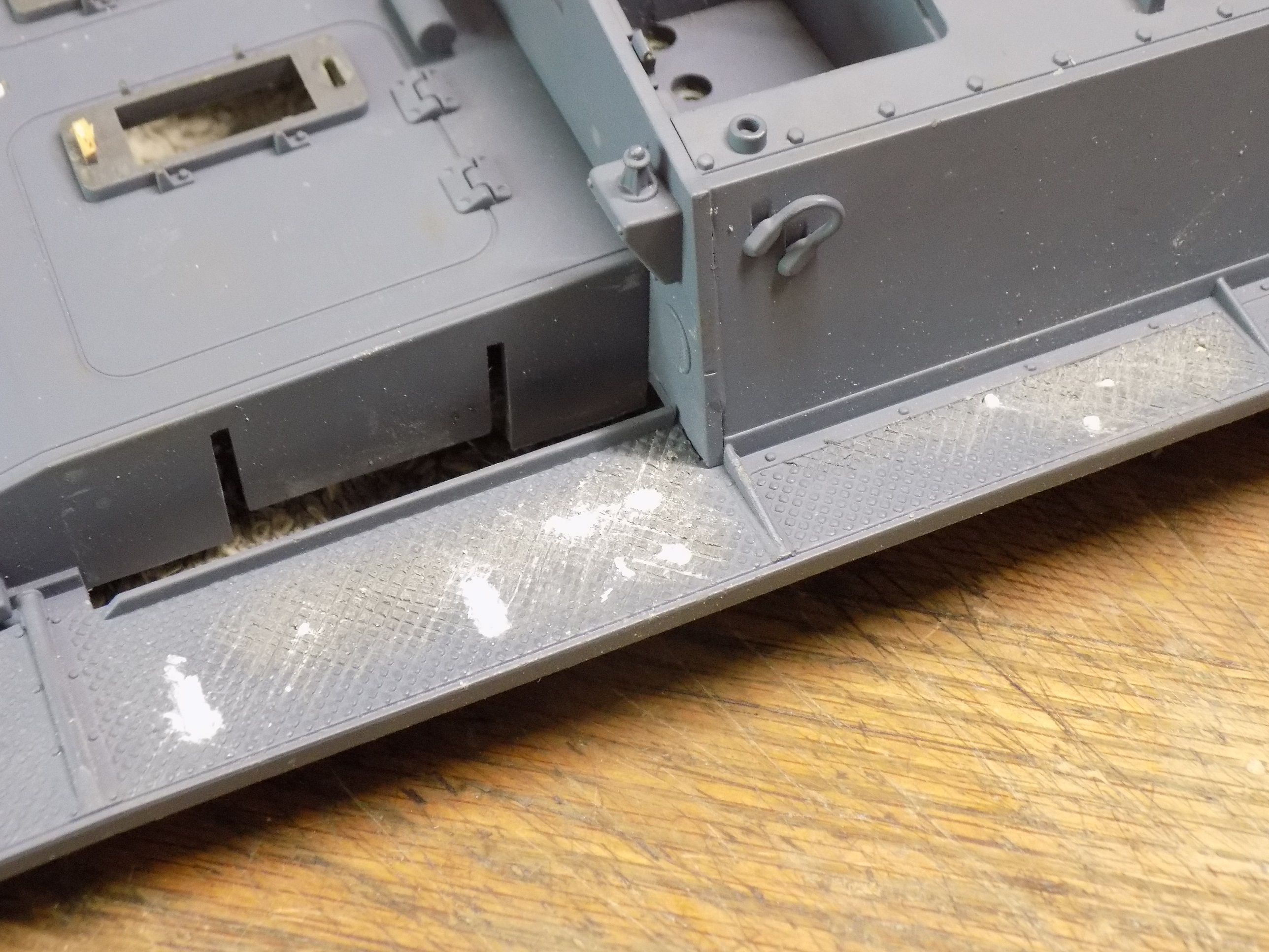

Spending time on tool removal on the pair of threes and the PzIV. I think I hate the molded in tools worse than the HL glue monkey. Used a broken tipped Exato blade and a few small screw drivers to rub/cut a fresh crosshatch in the bare plastic. Not perfect, and not sure what will be where yet on the fenders, so these may get finished better later.
The shovel is the worst.

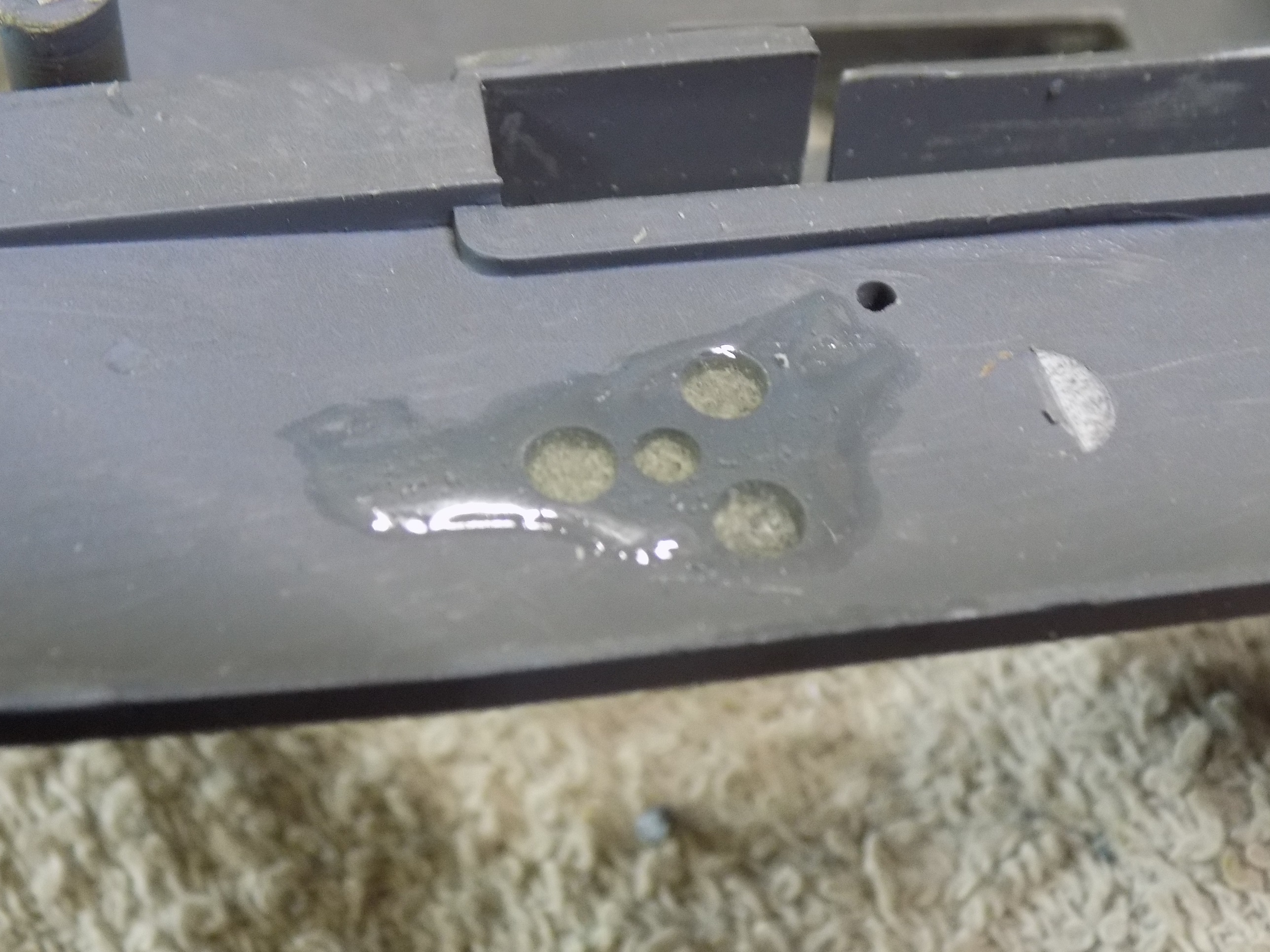

A trick I learned (a bit too late on the first one) is fill the cavities on the underside with epoxy.

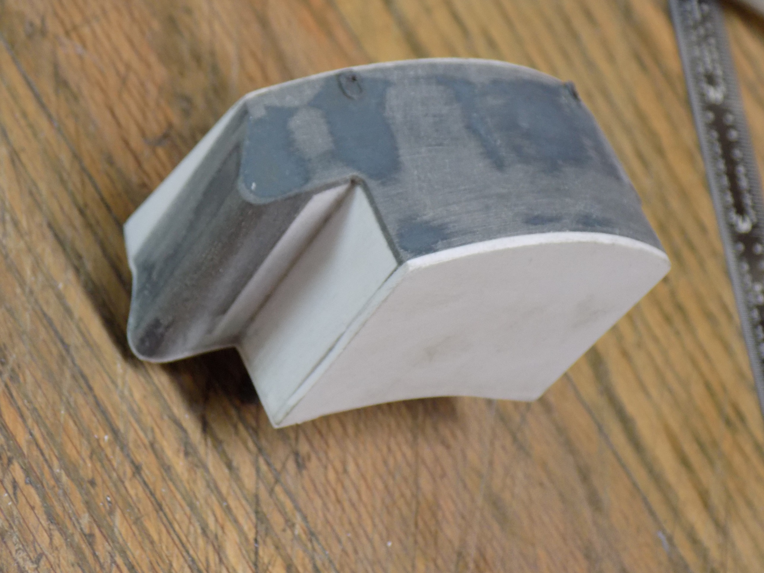

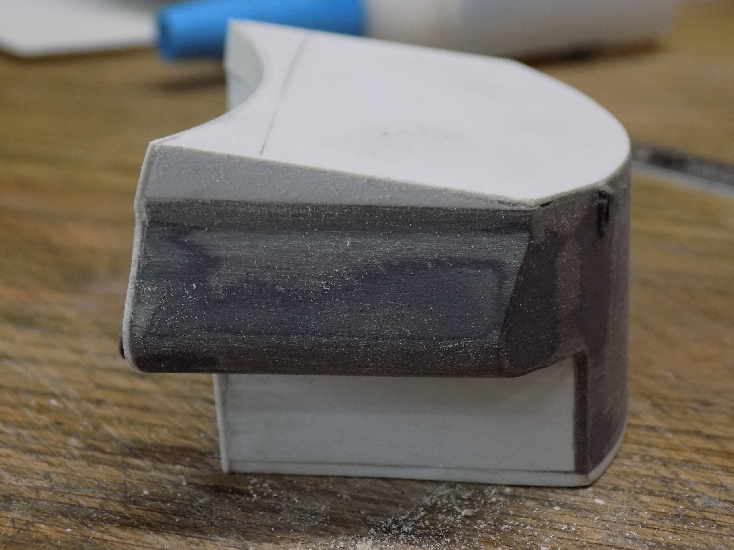

Since I will likely build the turret surround armor, and I've found zero pictures of the armor with a missing bin... I decided to rework the PZIII bin to look more like what I see in the pictures.
Trimmed the bottom a bit. Undercut the wings and added a wedge to the top. Also shortened the length a fair amount (sanding the bin to turret face). It also bolts on and will get some correct hangers soon (non weight bearing).

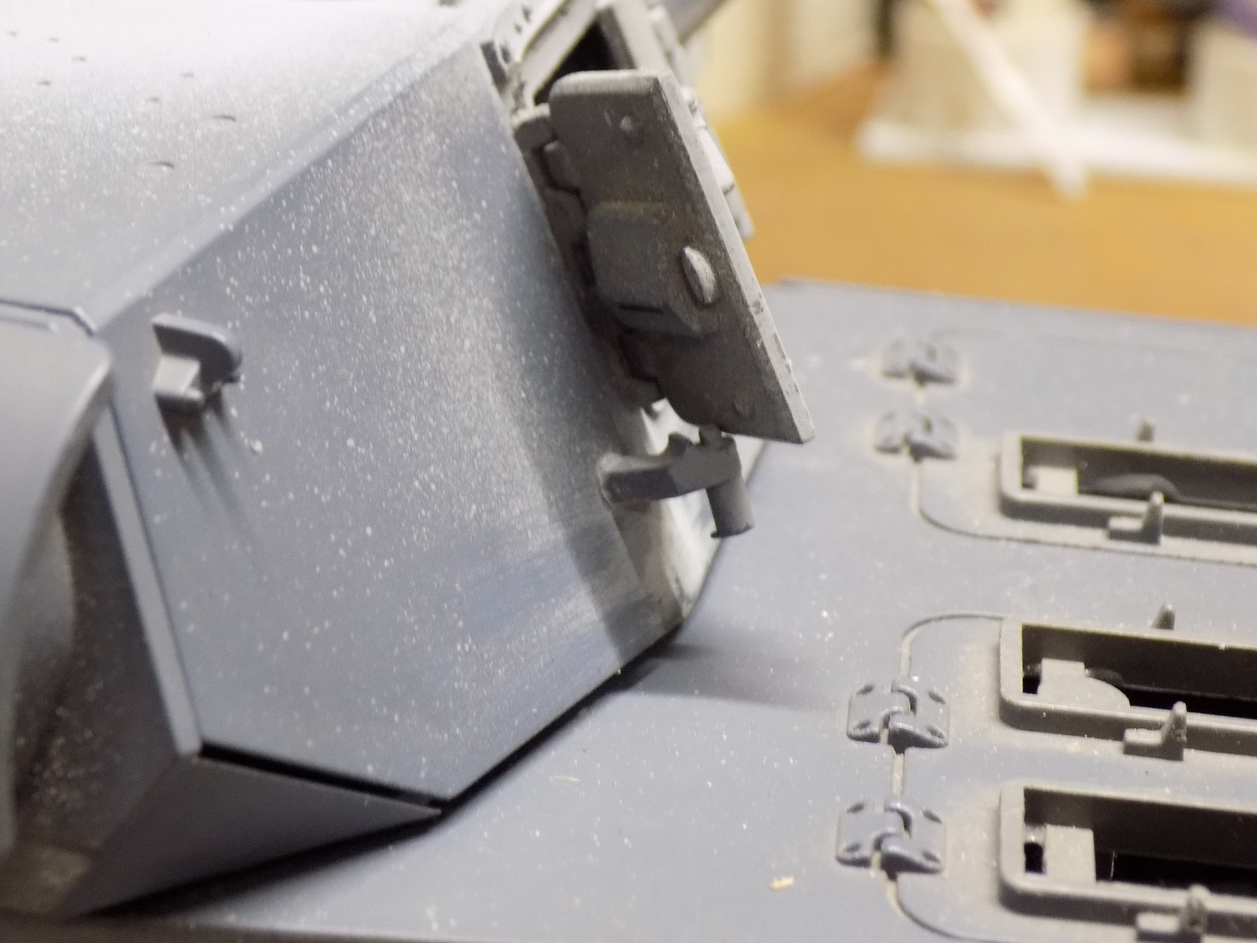

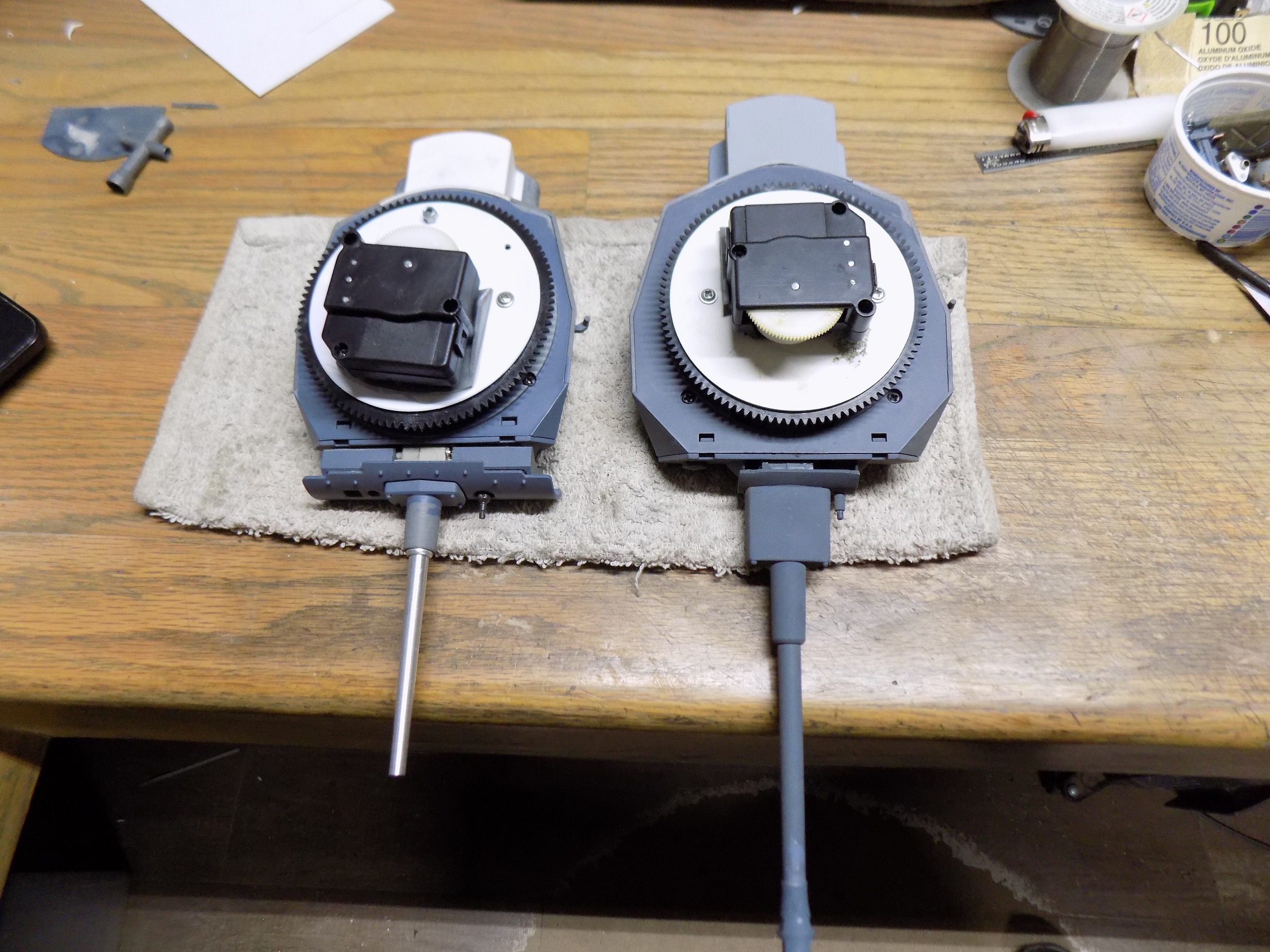

I liked how the lifter mech came out on the IV so I built another for the III. It is turned around to move the pushrod forward in the turret. With the open side hatches I tried to replicate a shorter breech to suit the 50mm gun. The pushrod in the IV's location would end up behind the breech.

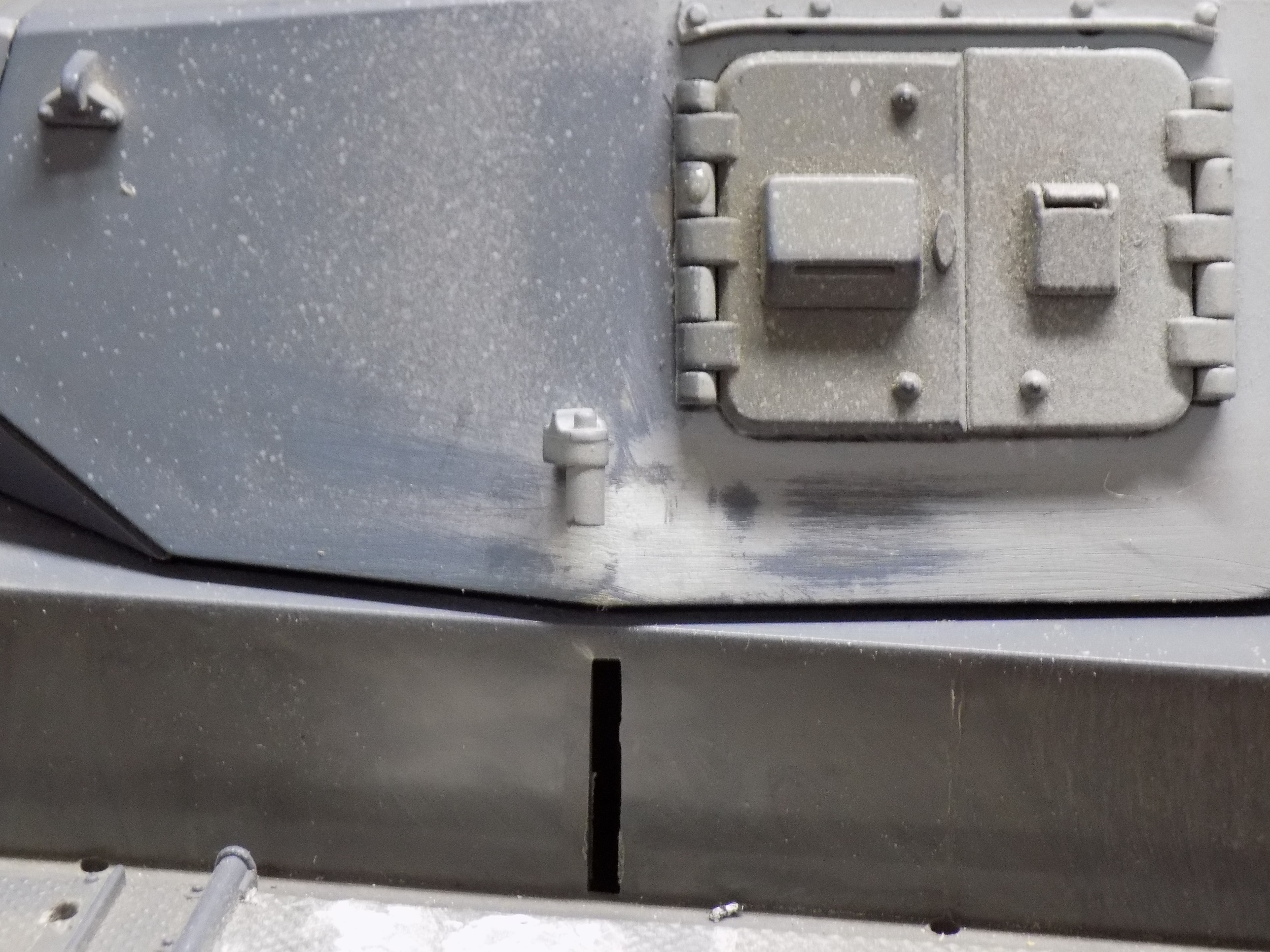

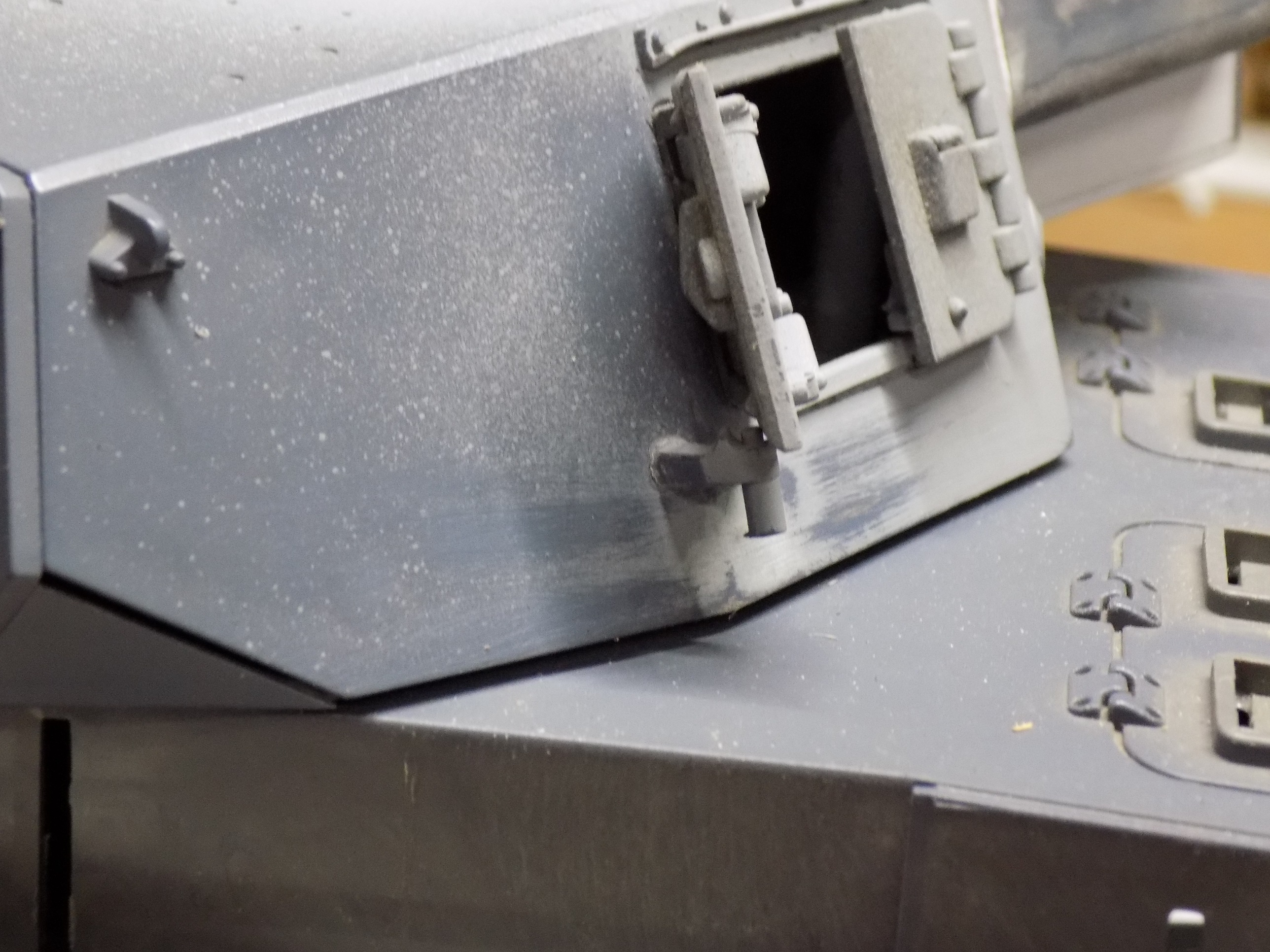

And finally, relocated the hatch latch/catch.

I still need to modify the front (turret face) of the bin. It sits at a funny angle when mounted. Did the same fix on the PzIV bin for the same reason. I am happy with the way both bins turned out compared to where they started (World War Photos is a great reference site https://www.worldwarphotos.info/) - thanks to Herman Bix.
