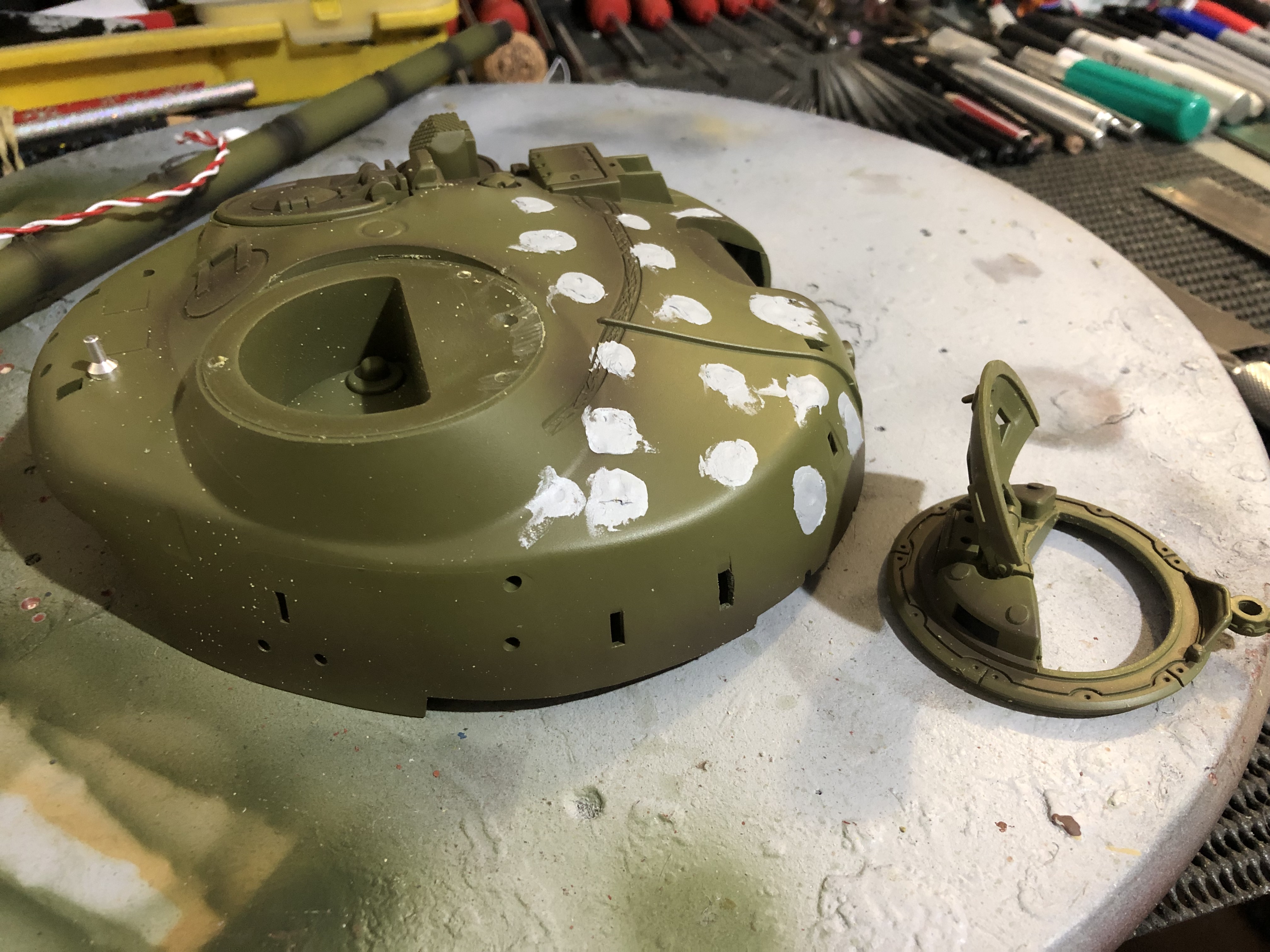

And now the turret has suffered from the measles

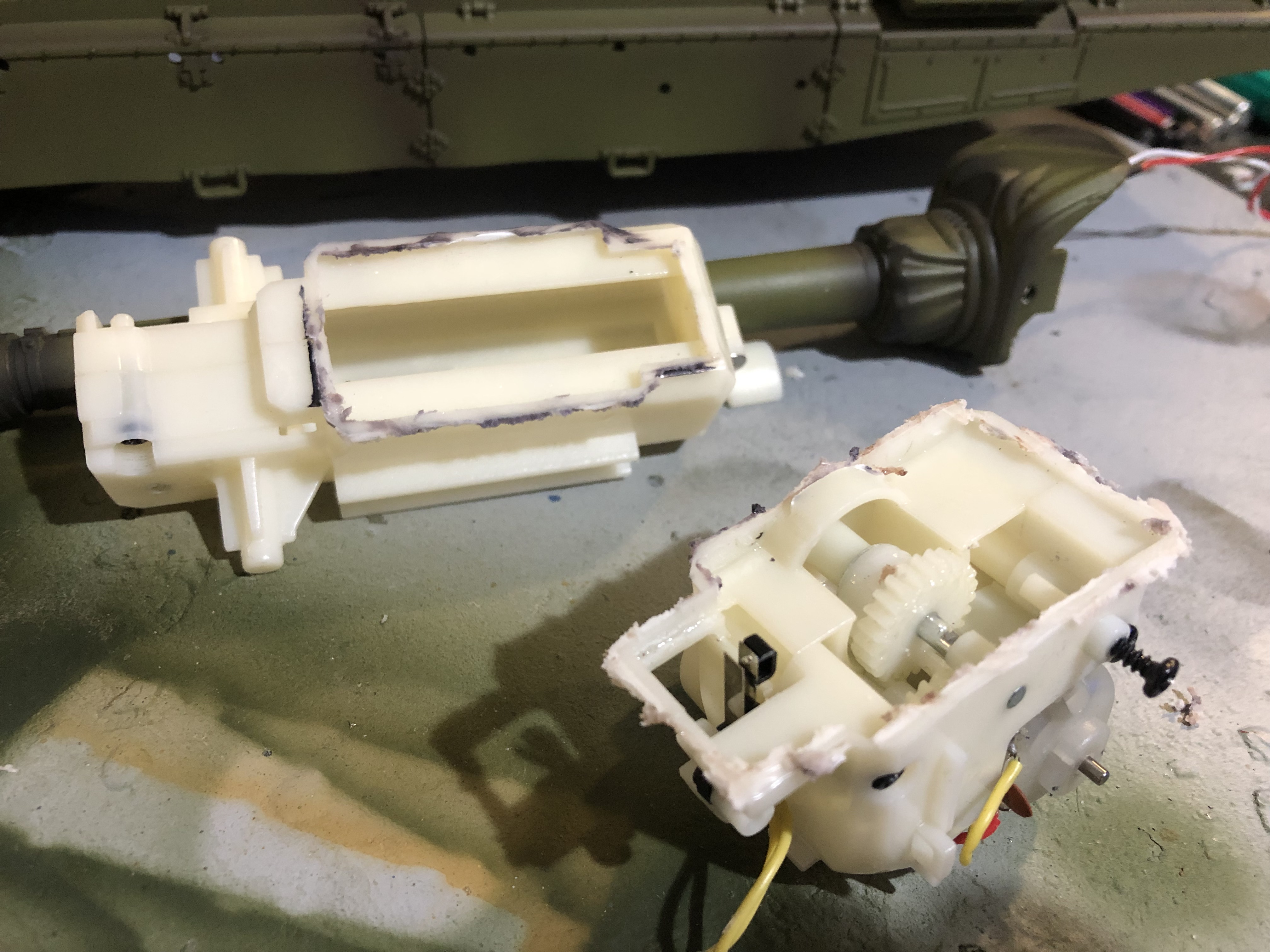

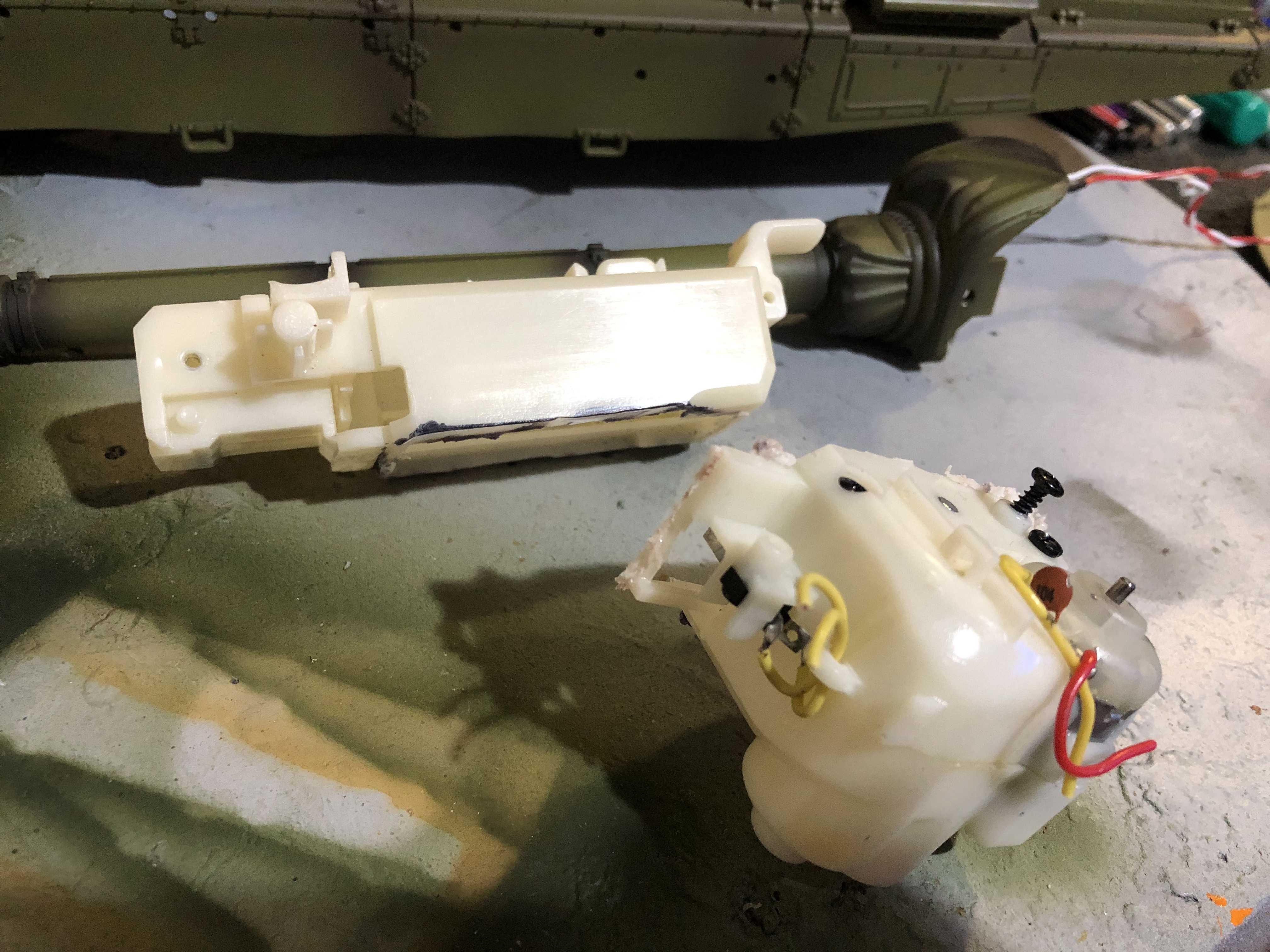

Well as I predicted, the hack & slash took place.
Hooked in with the cut off blade on my multi-tool & off went the BB unit.
That makes a clean path for the barrel smoker tube.

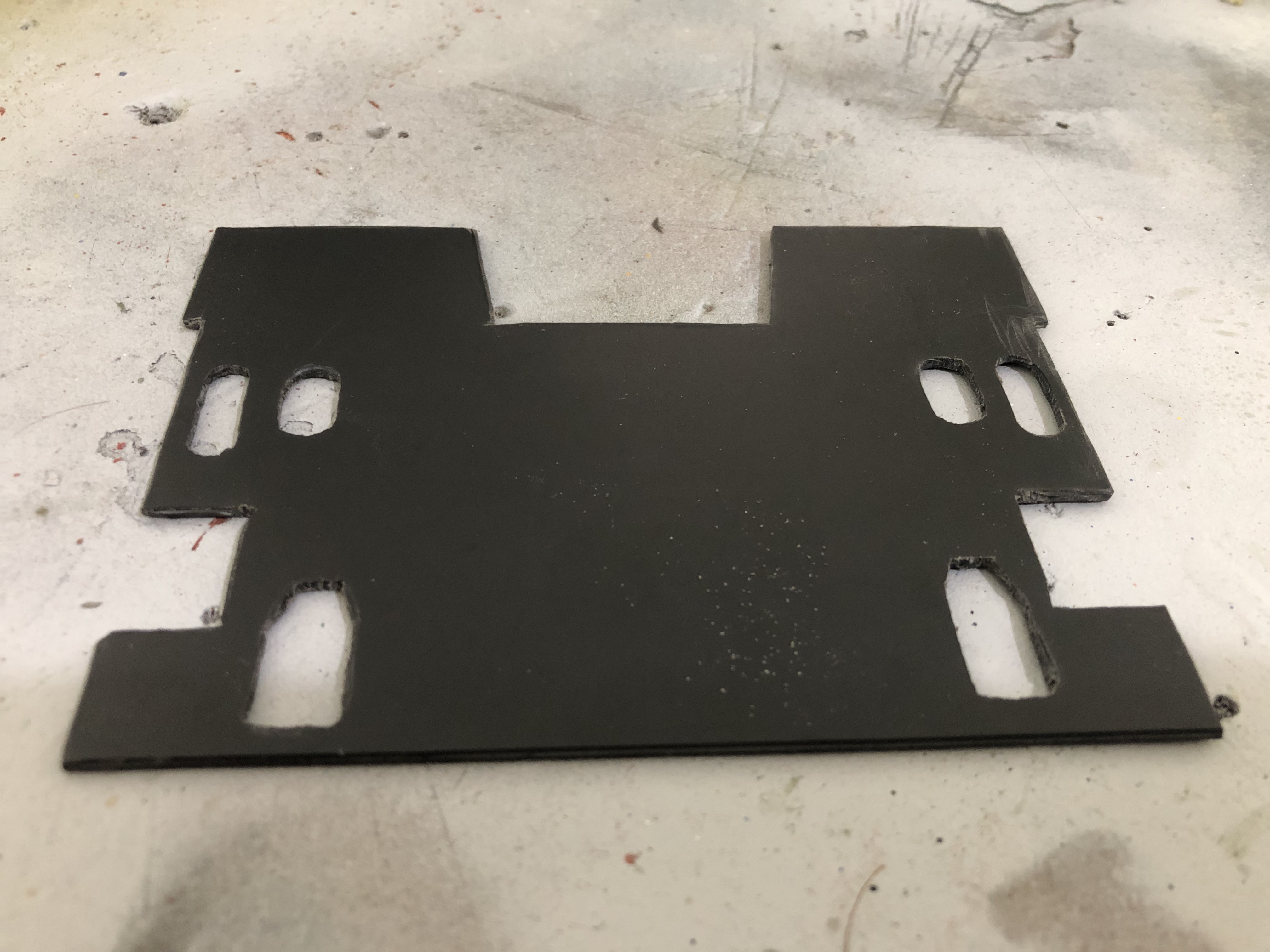

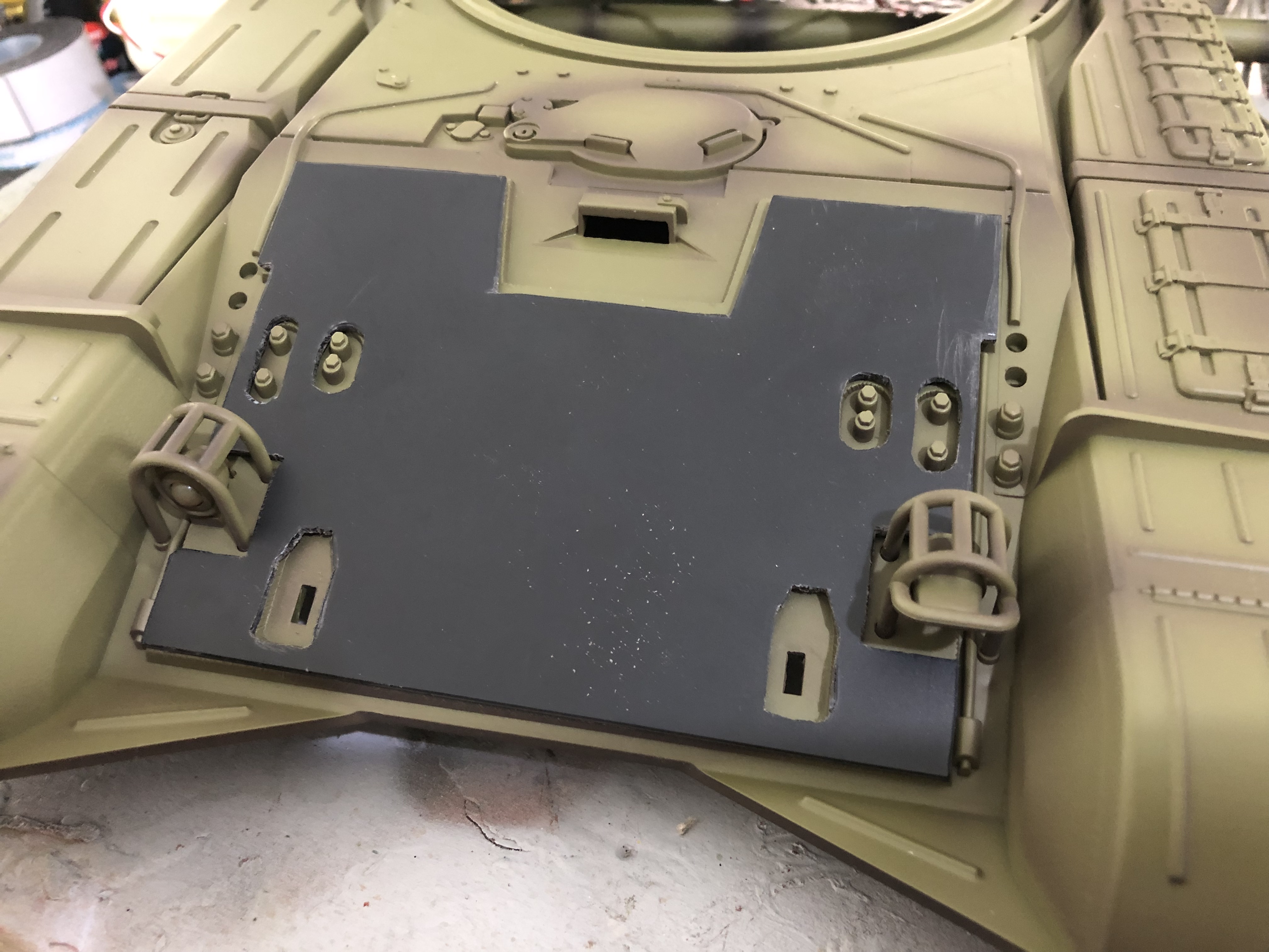

Also got on with the front glacis plate ersatz armour that was added to the Lions by the Iraqis.
Cardboard template to get a close rendition, then a 1.5mm black styrene sheet to get the live version.
Once it goes on Im sure the welds , spall bars, tow cable and famous wave break Vee will get the look right

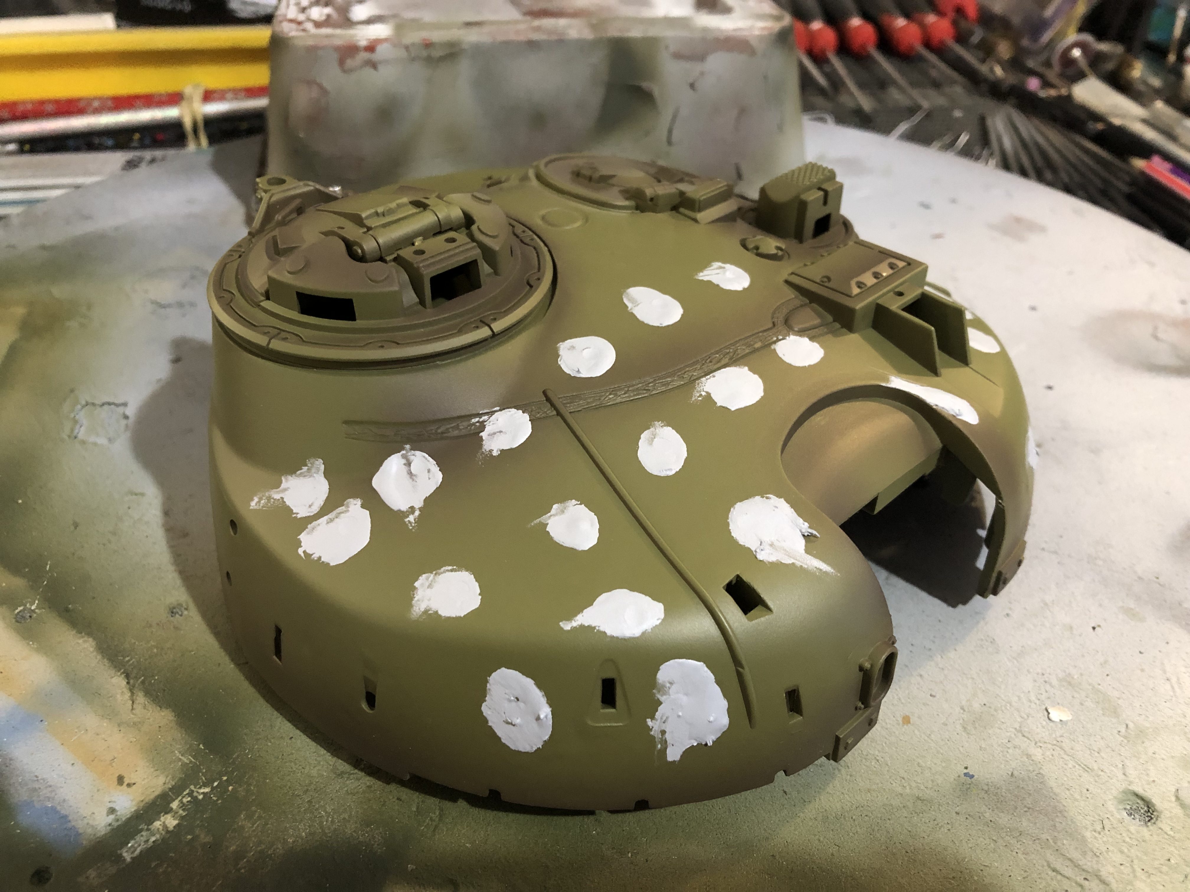

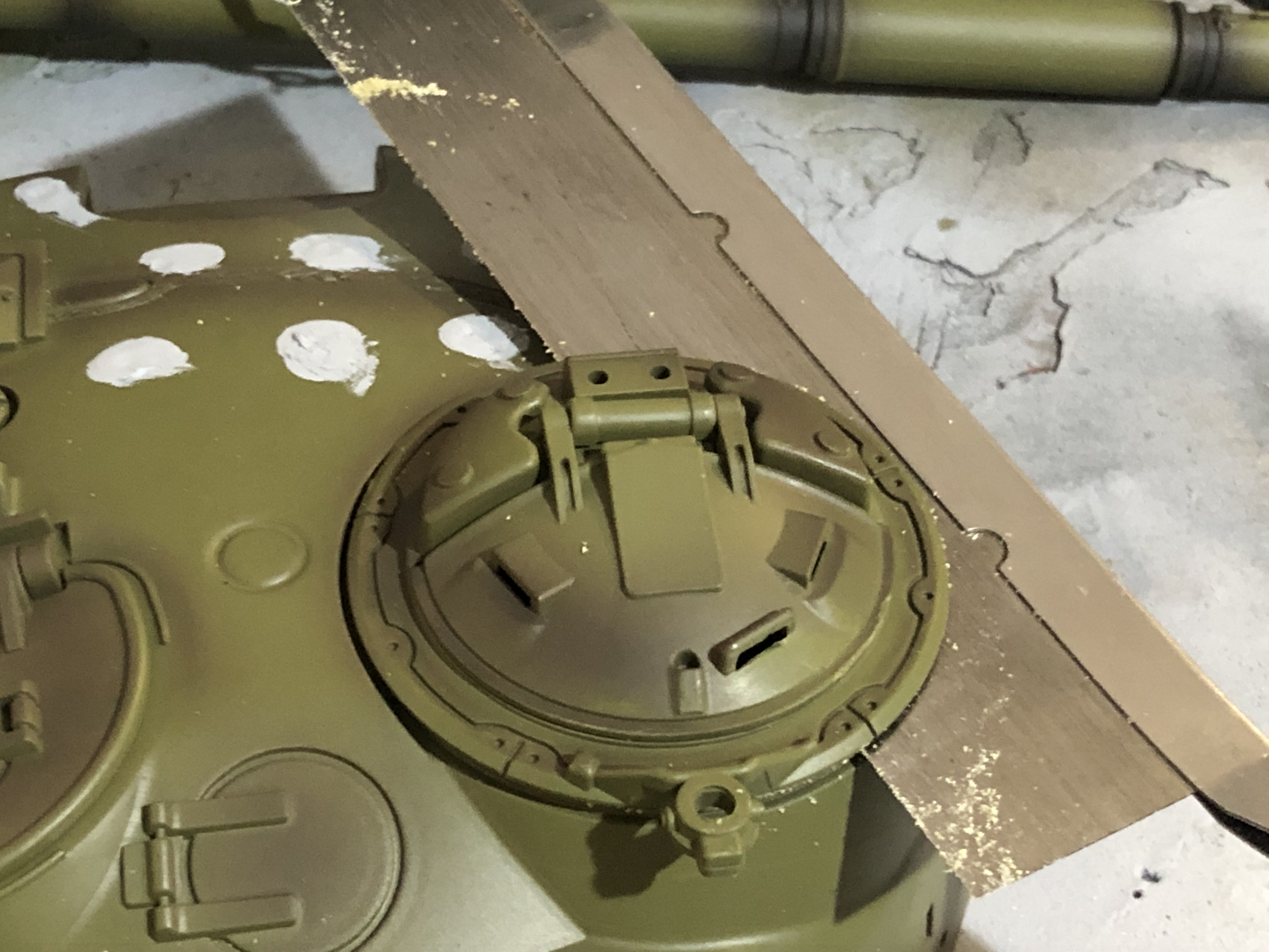

In order to get the right look of periscope lenses in the commanders station I had to slice the top of the cupola off
There’s no other way.
Once they are in I can mask them off for painting.
A lot of piss farting for a small detail but that’s what it is.
- IMG_3153.jpeg (1.25 MiB) Viewed 40883 times
- IMG_3154.jpeg (2.25 MiB) Viewed 40883 times
