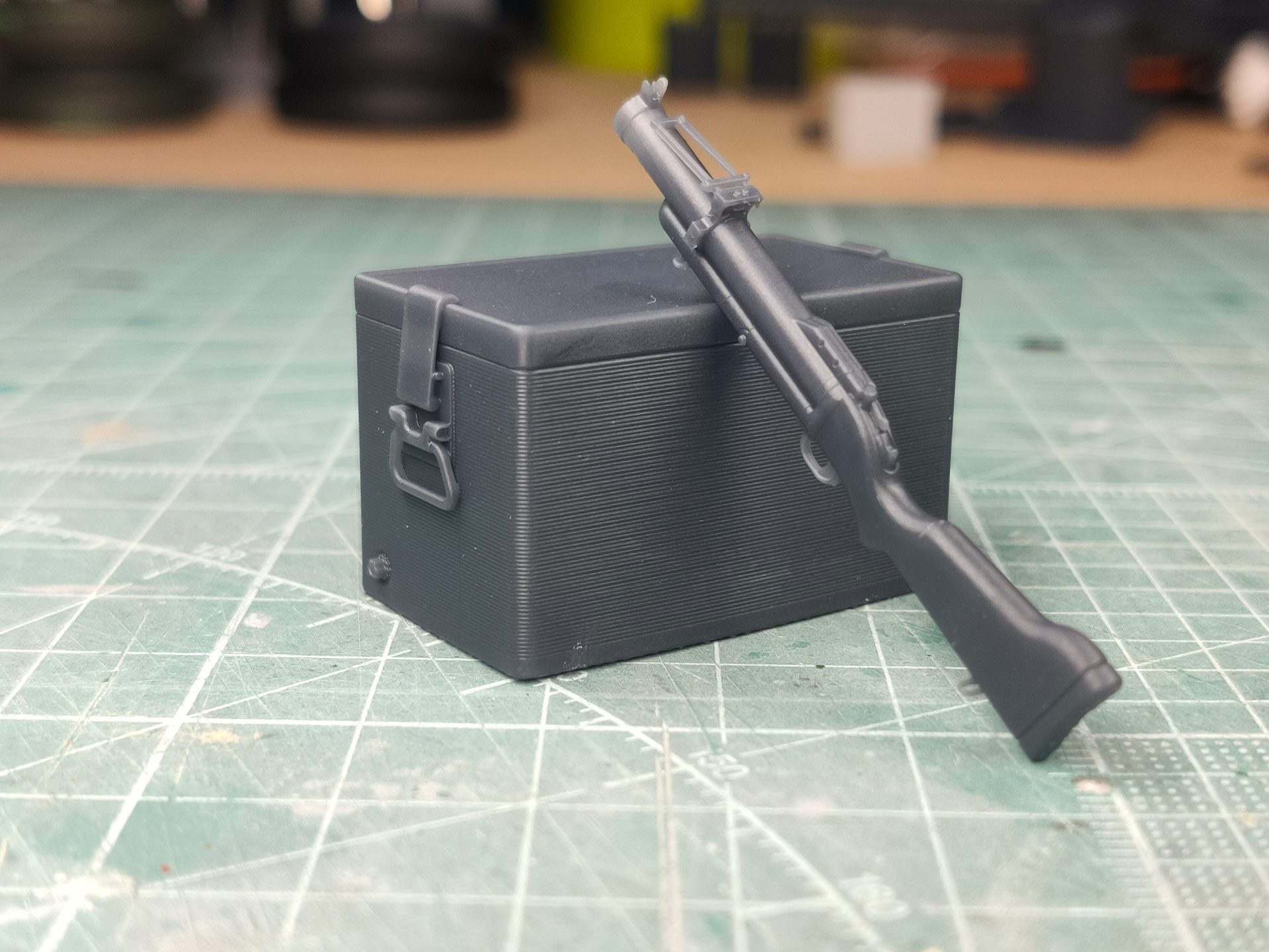

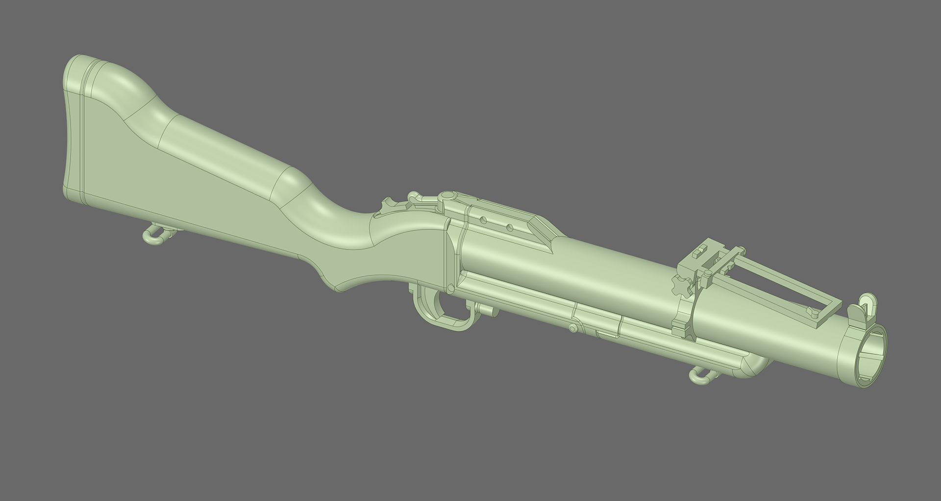

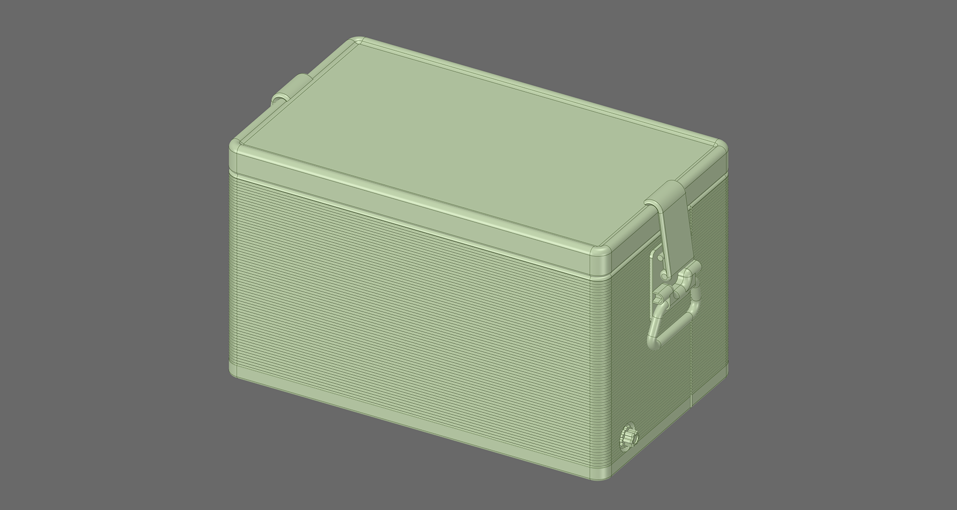

Got the drawings for the esky done after work yesterday and the M79 after lunch today, and I'll hopefully have some test prints ready tomorrow. I tried to add a little texture to the esky to stop it just being a featureless box; the old pressed-steel versions had a bit of a ribbed look to them. Not sure how (or even if) it'll turn out, but I thought it'd be worth a try! I couldn't find good references of the clasps that hold the lid on, I kind of mishmashed a few different versions to get something that'll look authentic in scale.
The M79 was surprisingly straightforward to draw, and I tried to keep some small grooves in between the different parts/materials to make it a little easier to paint. It has such a big bore I was even able to get some rifling detail in! It won't be very visible on the final print (the grooves are only ~0.1mm deep), but it'll be neat if it does work.
