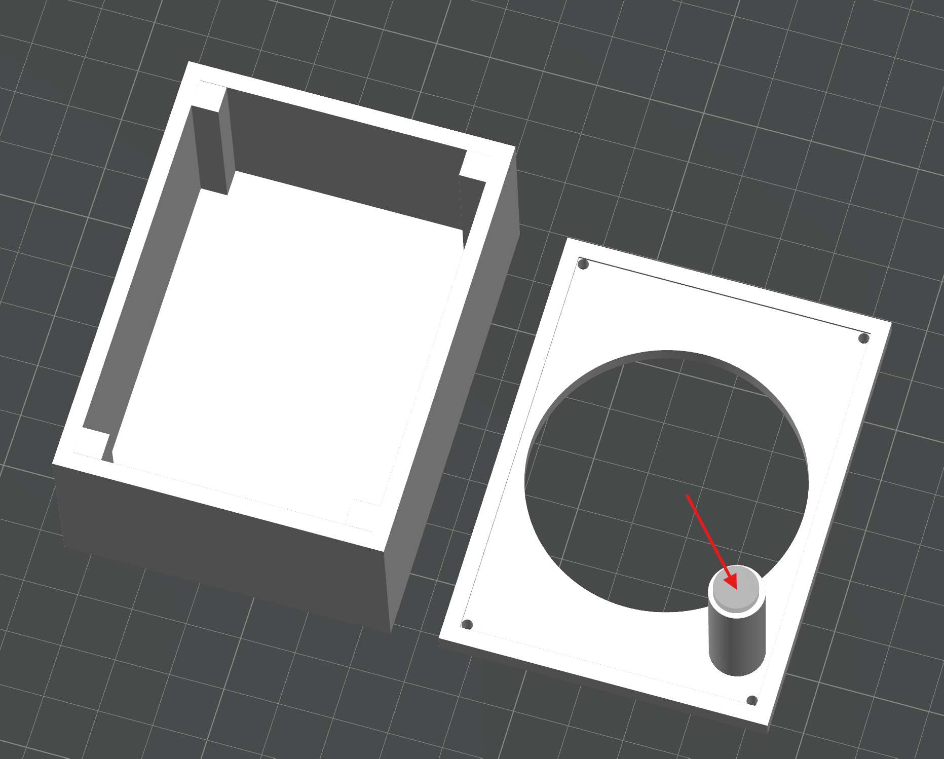

Sorry...I guess without knowing something about the way the slicer works it's probably Greek for some. :) The Bambu slicing software allows some pretty powerful functions where you can create shapes like boxes, cylinders, circles, discs, rounded rectangles, cones, etc. You can combine a lot of those things together and "merge" them into a single part. You can also draw "negatives" of all those items which basically cut holes instead of create solid objects. As an example, I needed a speaker box for the IS-4 as there isn't a lot of space in it. The Heng Long 7.1 seems to keep blowing my Taigen speakers so I grabbed a Visaton FRS 5X 2" speaker I had in the stash. That meant I needed a box that fit in the hull for that speaker so I ended up drawing one in the slicer that fit the space and the speaker. I also ported the box and integrated the porting tube into the lid. I didn't measure out the mounting holes for the speaker or draw the holes in the main box. I'll just use a drill for those. I printed it in a really fast draft mode so it's not the prettiest thing, but it doesn't have to be. The gray part the arrow is pointing to is a "negative" cylinder to make the port tube hollow when it prints.
As drawn in the slicer:

And with the speaker mounted and installed. The battery will be mounted in the nose of the tank.
