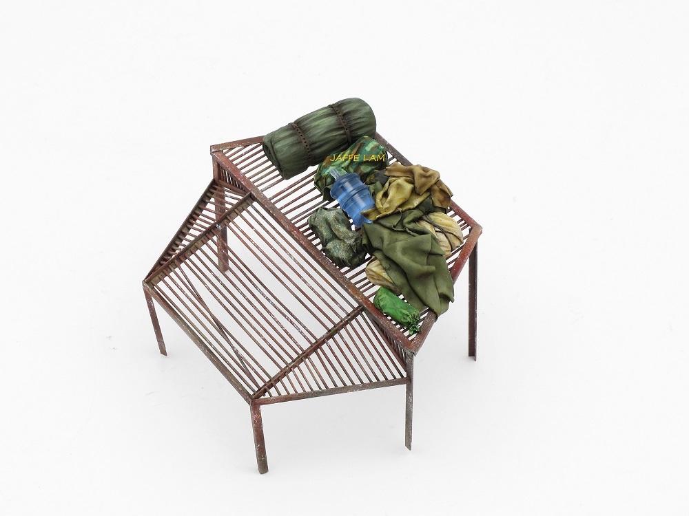

A modern take on the bedspring T-34, it'll be right at home in your collection!HERMAN BIX wrote:I’ve seen stairway handrails and farm gates also used as overhead protection on some vehicles!!

Raminator wrote:A modern take on the bedspring T-34, it'll be right at home in your collection!HERMAN BIX wrote:I’ve seen stairway handrails and farm gates also used as overhead protection on some vehicles!!
That it shall mate !!

Here's more to get creative...

That’s exactly the look I am going for!!
Ian looking around for small plastic bags that I can use for the often seen sandbags that seem to be on these things, blue ones are common.

Nice metal work, I like it!

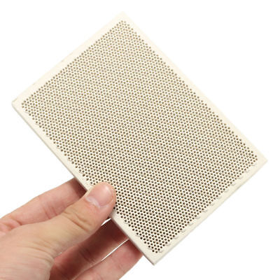

The second point would be to consider usage of ceramic soldering plate
something like this...
which prevents heat dissipation from the material. As an alternative approach I would try fixing all the pieces of the part to this plate using the right holes and then using paste to gradually work through the tin.

Do a Google search for, Ceramic Honeycomb Soldering Board/Block/Plate/Jewellers Heat Proof Board.
You are sure to find something with those search options within any country.
I have one for soldering slot car chassis. You should be able to find them in varying sizes.
Yes, it looks a little different to the one shown above, but the holes are very useful for inserting little wire pins (piano wire) to hold things in place.
For added interest, always check out jewellers tools for small metal working jobs, you're more likely to find the type of tools you need, or at least get ideas for alternative cheaper options.
For soldering chassis, I use a 60 watt Ungar soldering station, plus higher wattage single irons. I do have an old soldering pen somewhere, but can't remember where it is or who's make it is, sorry. I have also used a normal blow torch with a lowish flame to heat as one when all held together.
