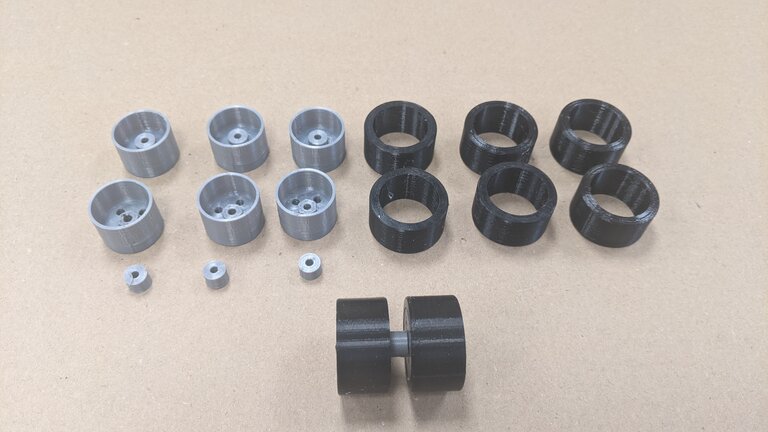

Printing with the TPU filament is going ok. Set up a new profile in Prusa Slicer - no heated bed and every speed set at 40mm/s. Printing each tyre separately to keep stringing down to a minimum. Rollers for one side complete.
- 025.jpg (63.09 KiB) Viewed 7175 times

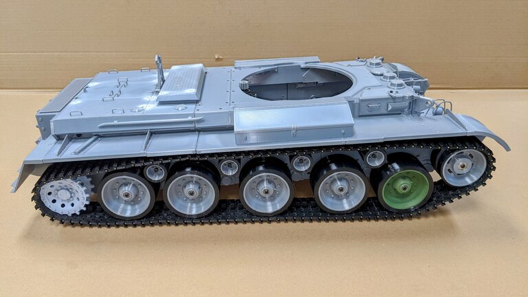

Tracks completed, 80 hours printing and 3 sore fingers assembling them.
A truly momentous day!
- 026.jpg (75.9 KiB) Viewed 7151 times

Wheels, tyres and tracks for one side complete. Fender side plates and wheel caps will be fitted after painting.
https://www.youtube.com/watch?v=Zo2zxTi ... =SteveStyx
- 027.jpg (65.63 KiB) Viewed 7076 times
