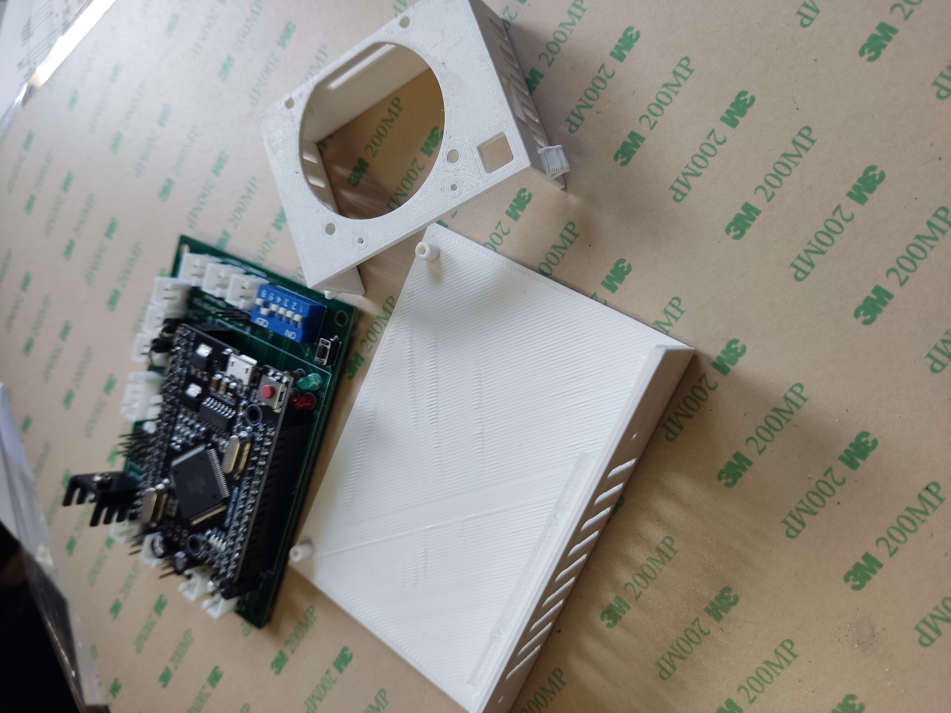

I made a 3d printed case for Baldrick board. I included a fan and has full access to all plugs and buttons. Is made of two parts easily printed, without suports. To attach to the tank, i'm gonna use double side tape but you can simply make holes and use screws. If you want stl i can supply for free
For the fan (5volts 40x40x10) you need 4 - M3 screwsx15 and to attatch the top and bottom of the case, 4 - M2.5 screws, or any other small screw. Hope you enjoy.
Note: the pics where taken after printing, to test. All OK, i'll screw it and put in the tank next week.

That looks really goodwebwolf wrote: ↑Fri Apr 21, 2023 6:45 pm I made a 3d printed case for Baldrick board. I included a fan and has full access to all plugs and buttons. Is made of two parts easily printed, without suports. To attach to the tank, i'm gonna use double side tape but you can simply make holes and use screws. If you want stl i can supply for freeFor the fan (5volts 40x40x10) you need 4 - M3 screwsx15 and to attatch the top and bottom of the case, 4 - M2.5 screws, or any other small screw. Hope you enjoy.
