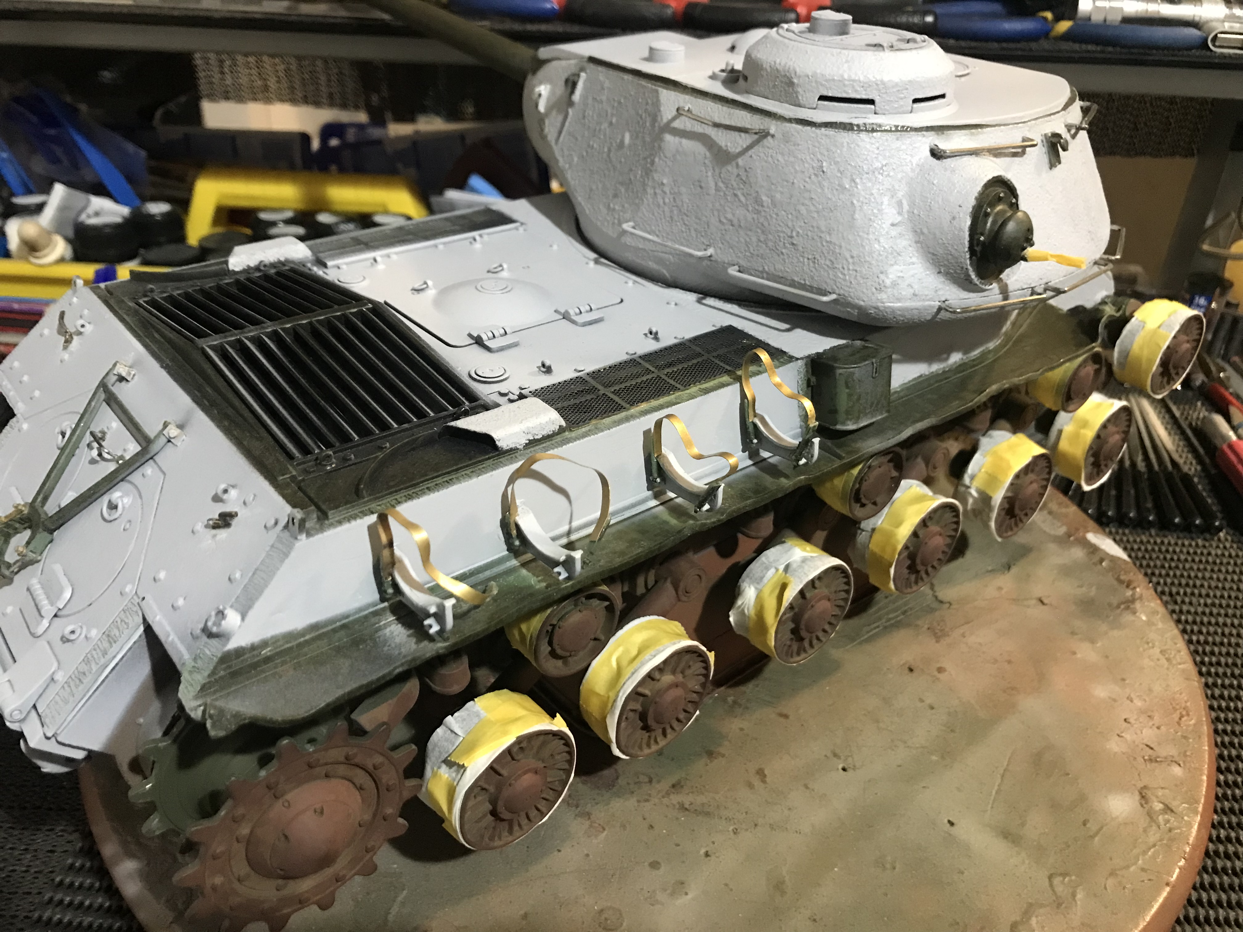

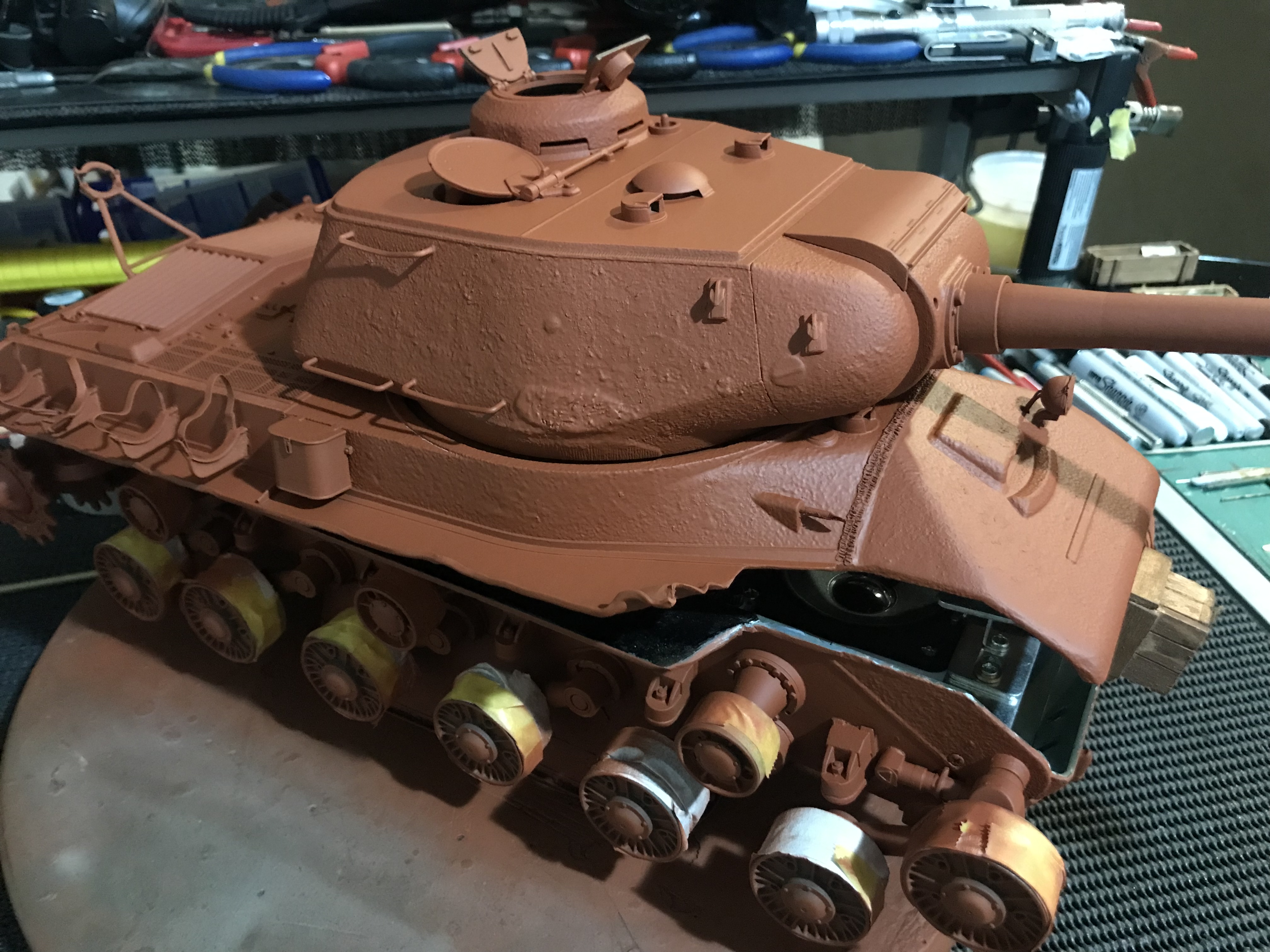

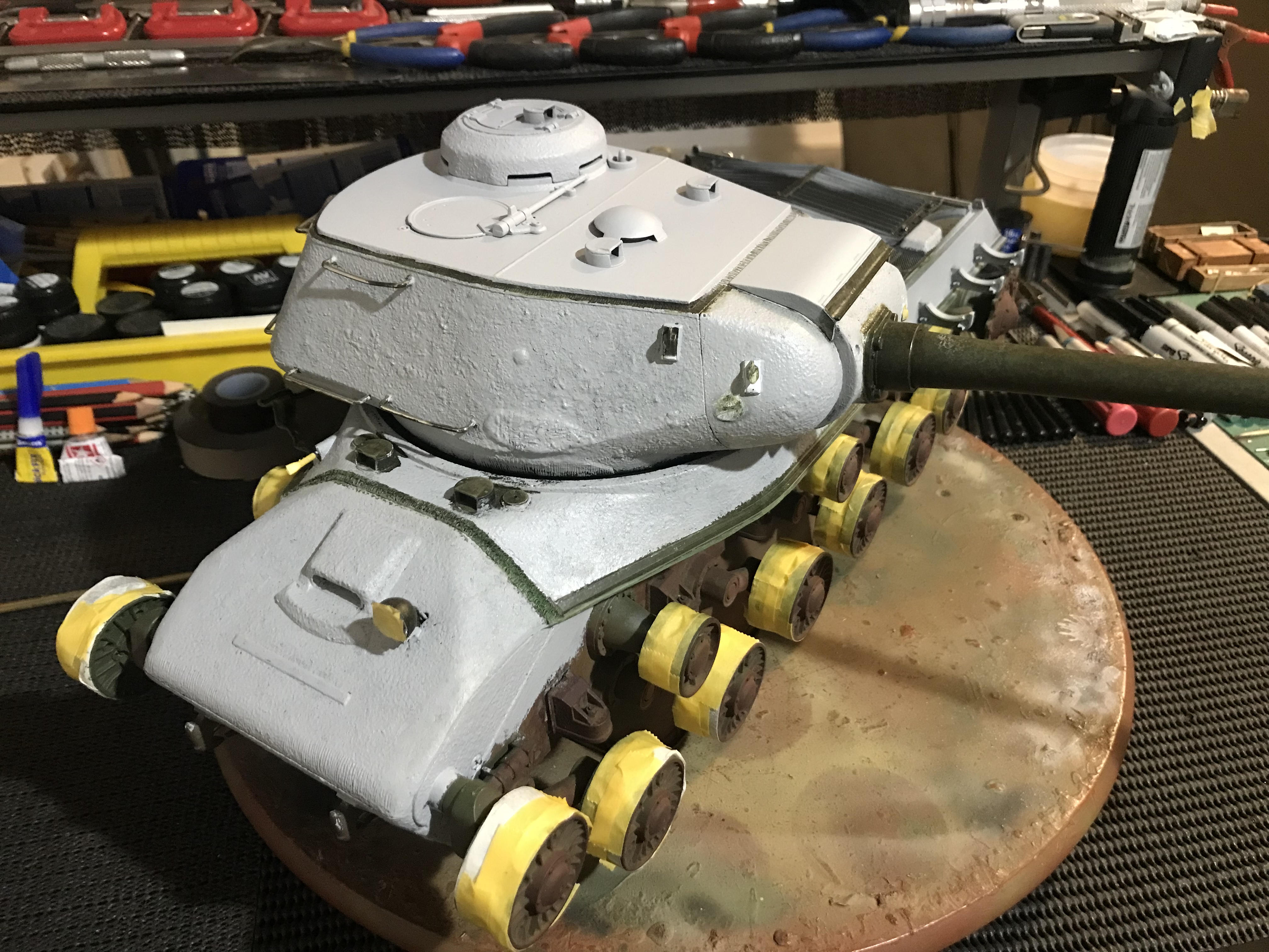

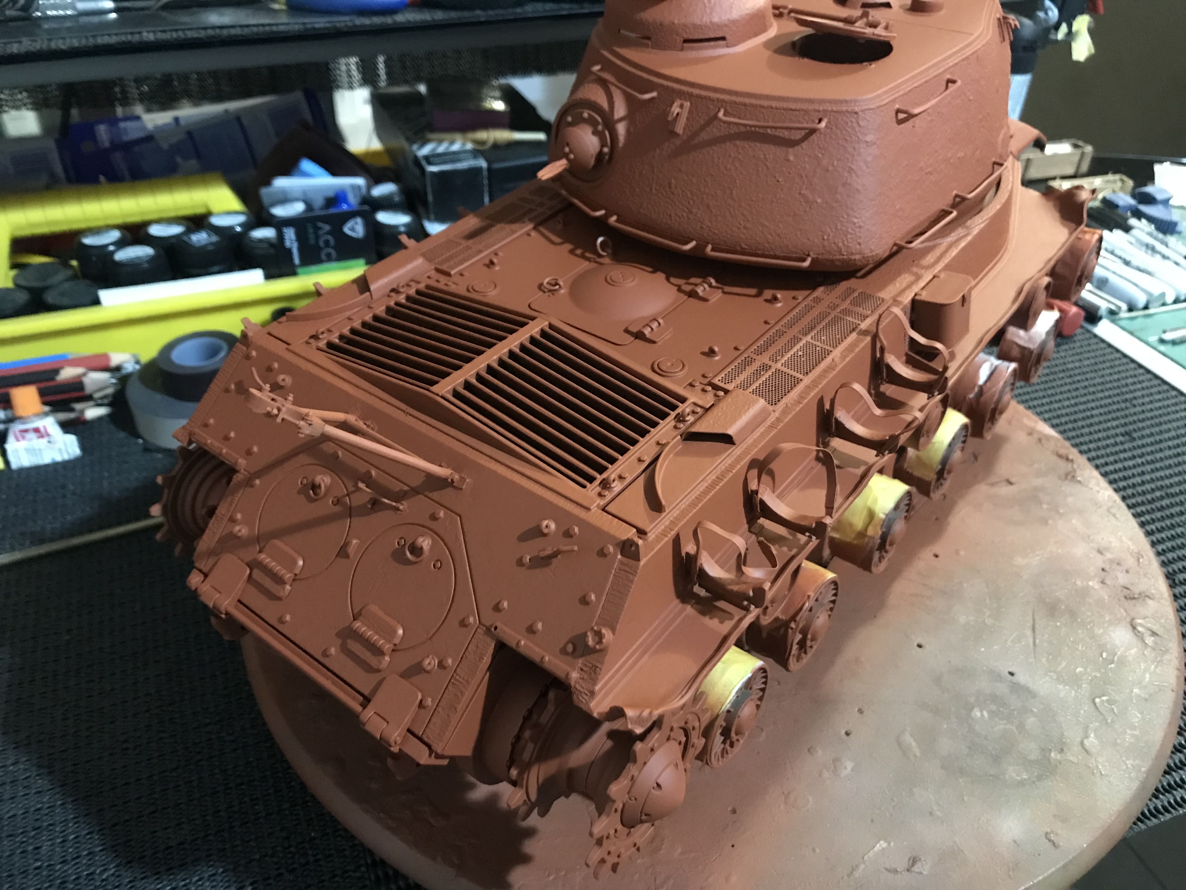

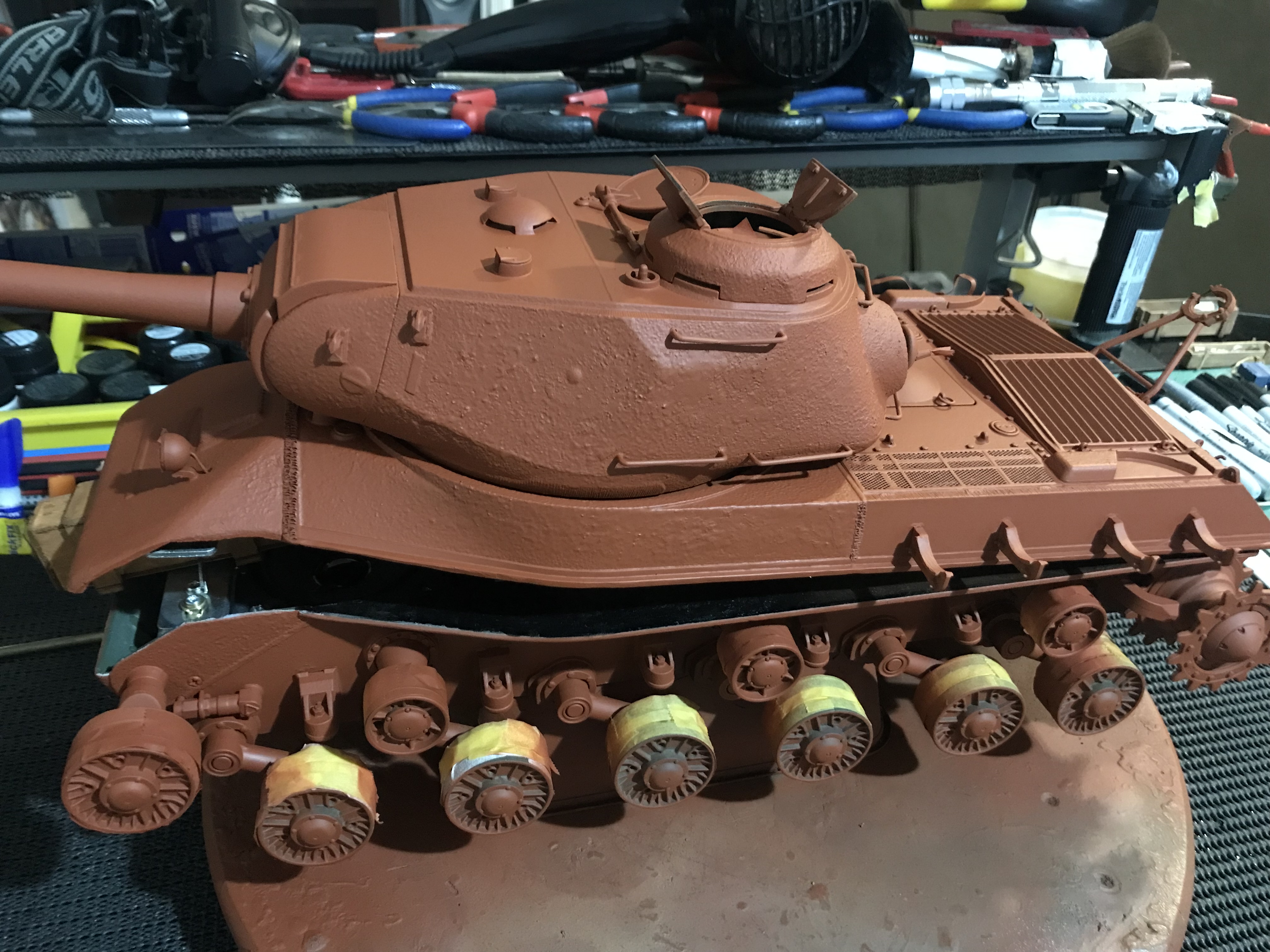

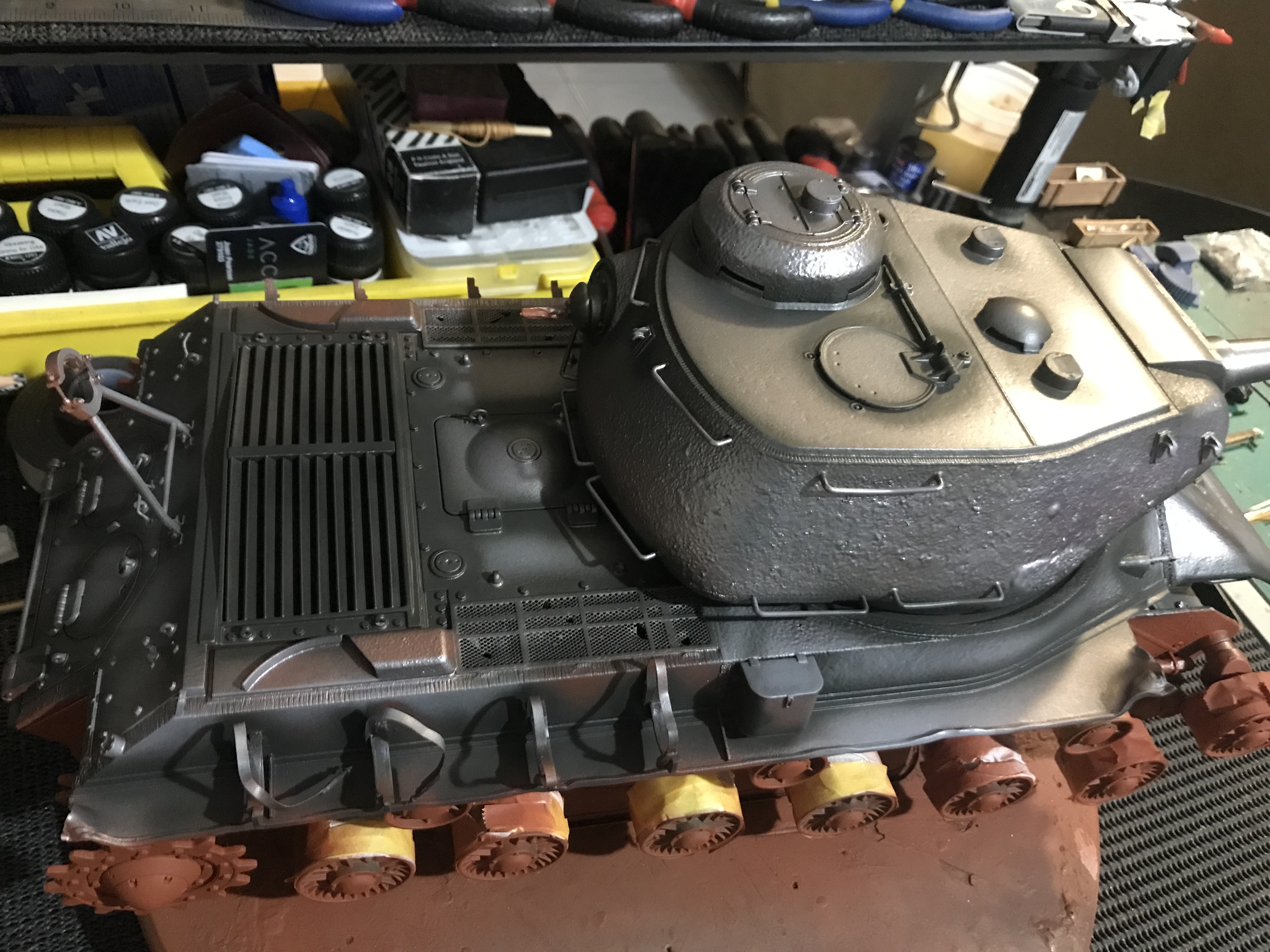

Having managed to fluke getting 3 tins of spray primer which I normally have to order in & wait for, I got a rush of blood happening & took the big fella outside :shifty: ;)
Its real soggy & hellish humid here at the moment so I hit it with the hair drier for a bit once I got out there.
God I "Love the smell of Primer In The Evening"................(ok so its not Napalm in the morning, but its the same desire!)
I had to shove bits of cardboard masking inside it to stop any red from dusting into the internals, & I hope to get the silver base on it tomorrow.
There is still the issue of mounting the spare from track links on the lower front plate, good & solid enough to be belted constantly, but also having to look right.
Im out tomorrow morning to scour the land for suitable material.
I will not waste my last 4 remaining spare metal links on what is basically cosmetics, so if I can use the robust plastic items that I got off it, they will do if necessary.

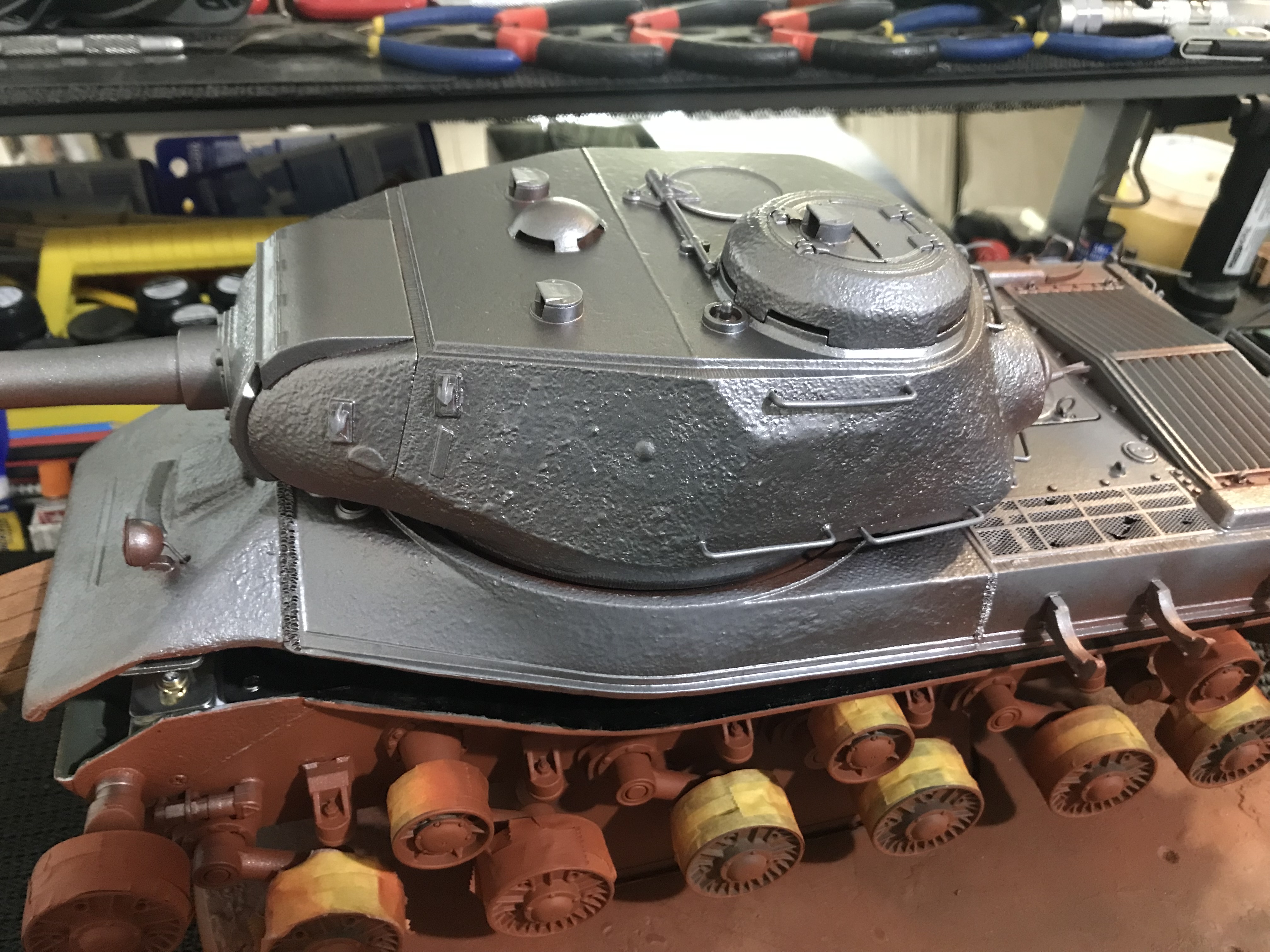

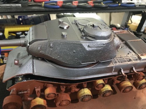

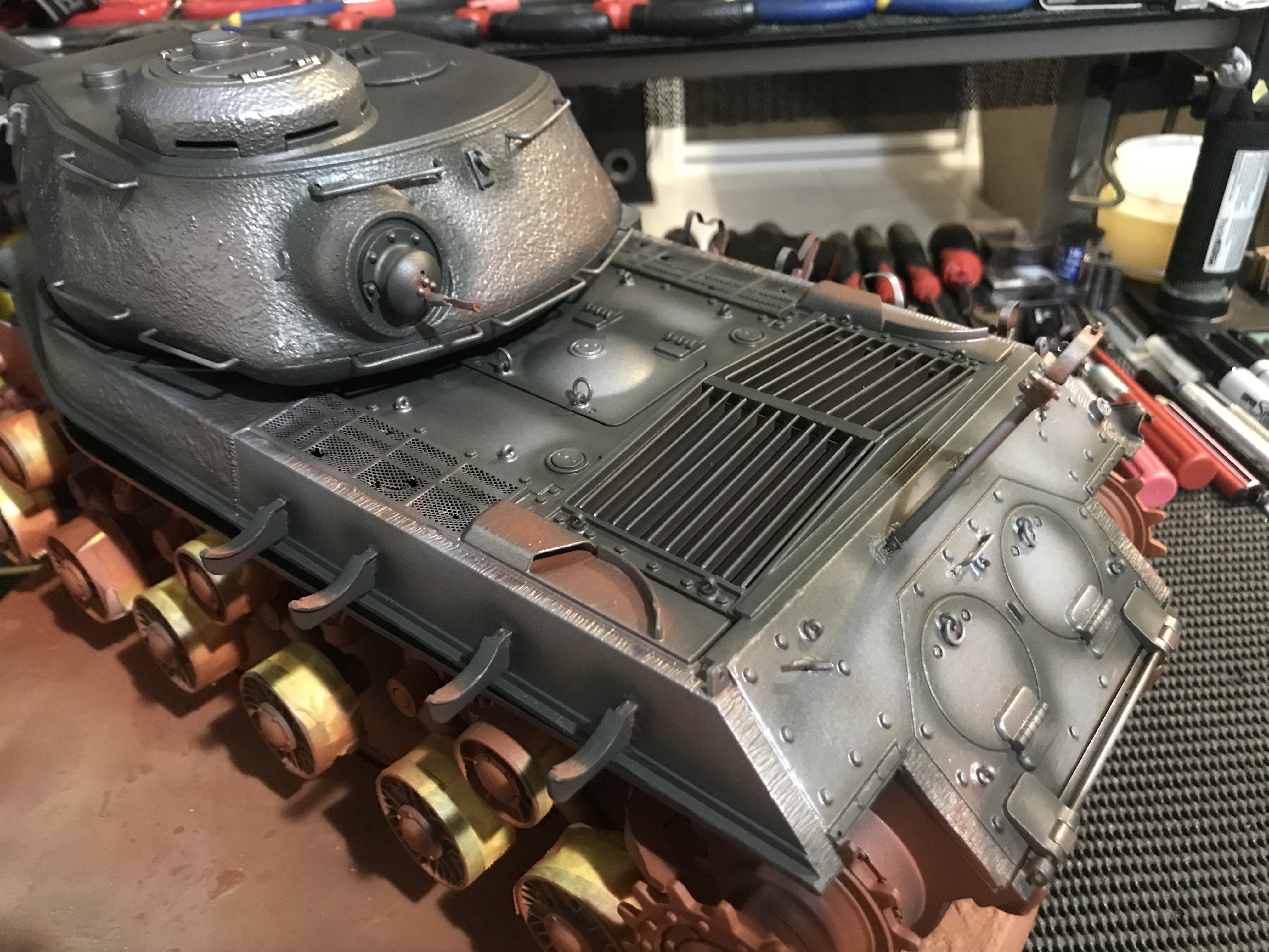

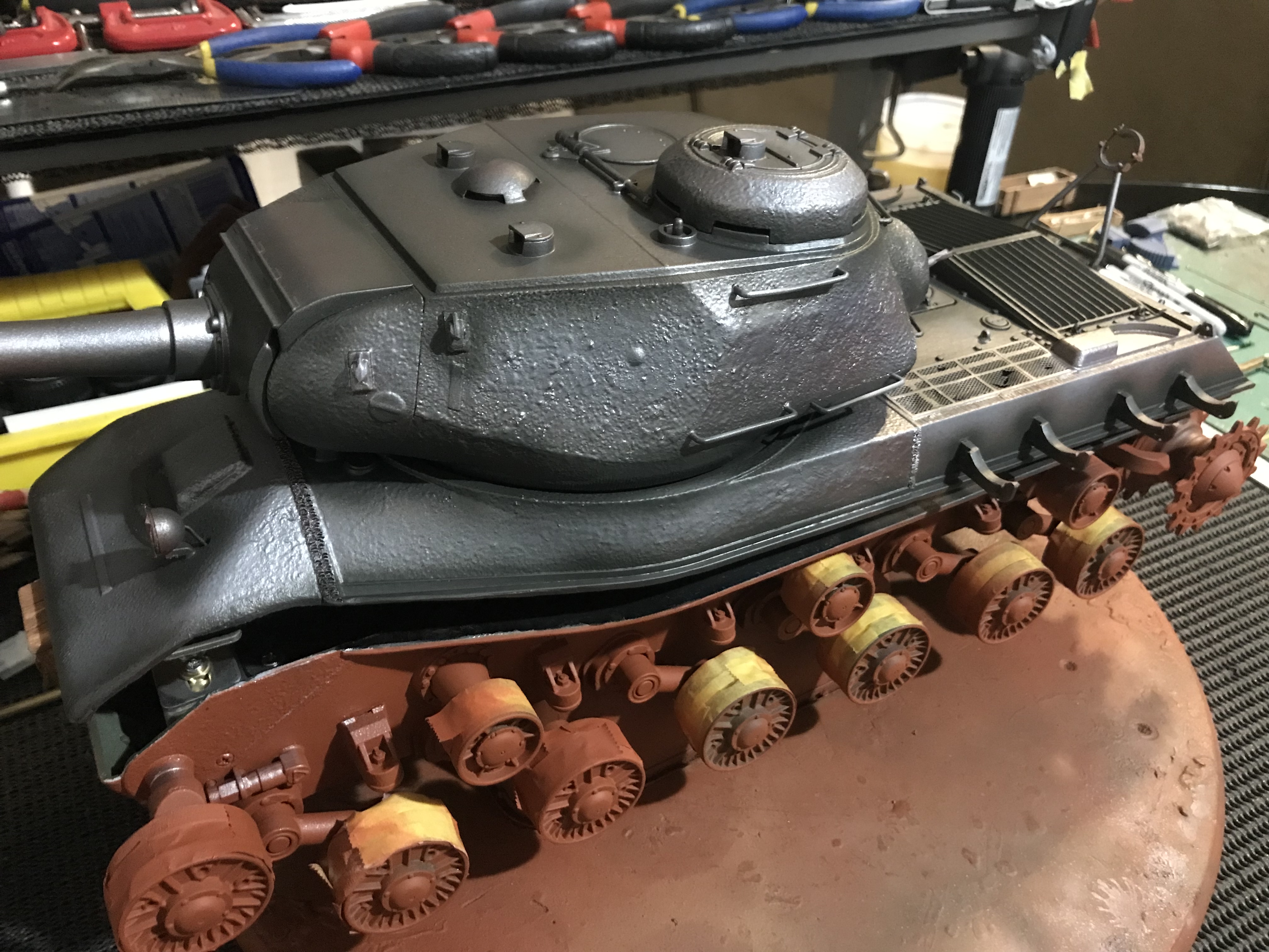

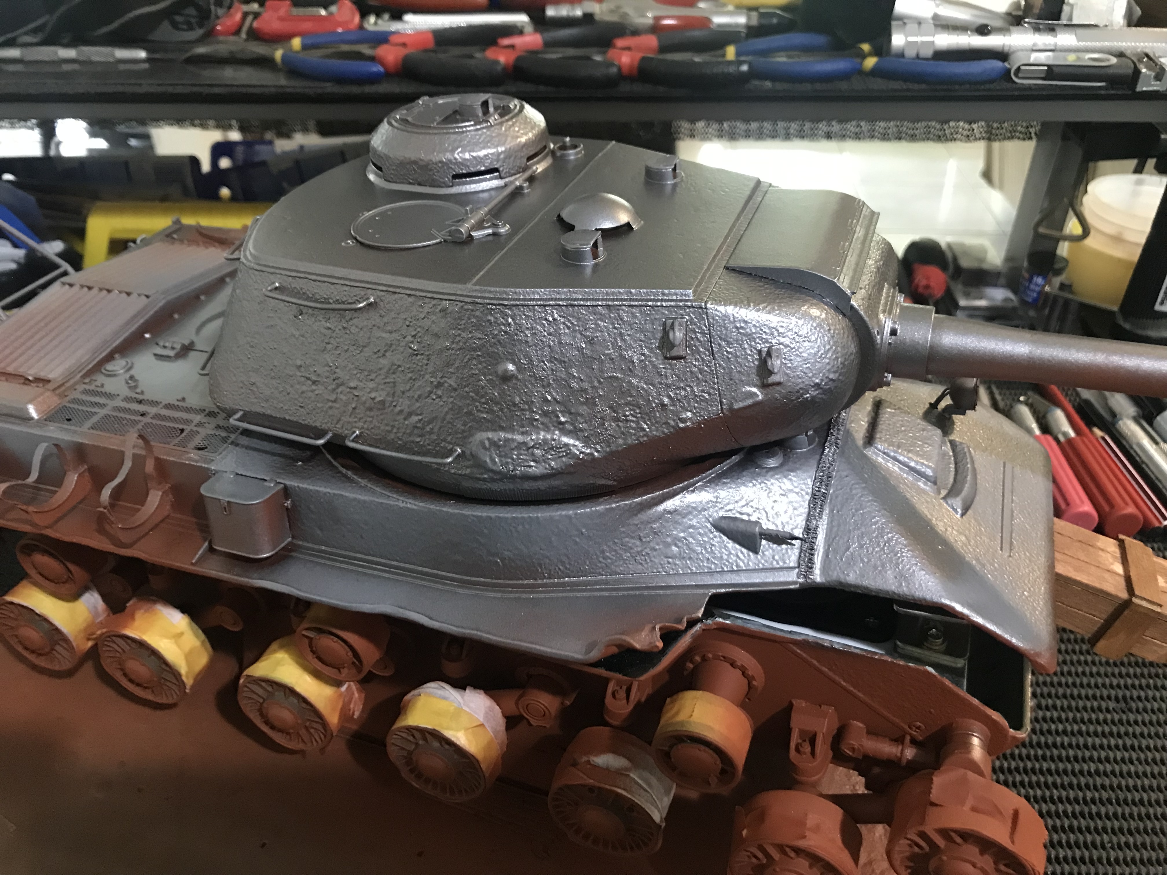

Gun metal silver shade is on, as is the shadowing around the usual areas.
I'm getting well used to using the silver as a foundation coat over primer on Soviet machines now, it helps with the 4BO topcoat modulation.....................(tell myself that enough times & I might actually believe it :shifty: )
I wasn't worried about shading the lower hull as I'm going to use wash & pigment down there to get the look I want.
Fair way to go yet but its getting there.

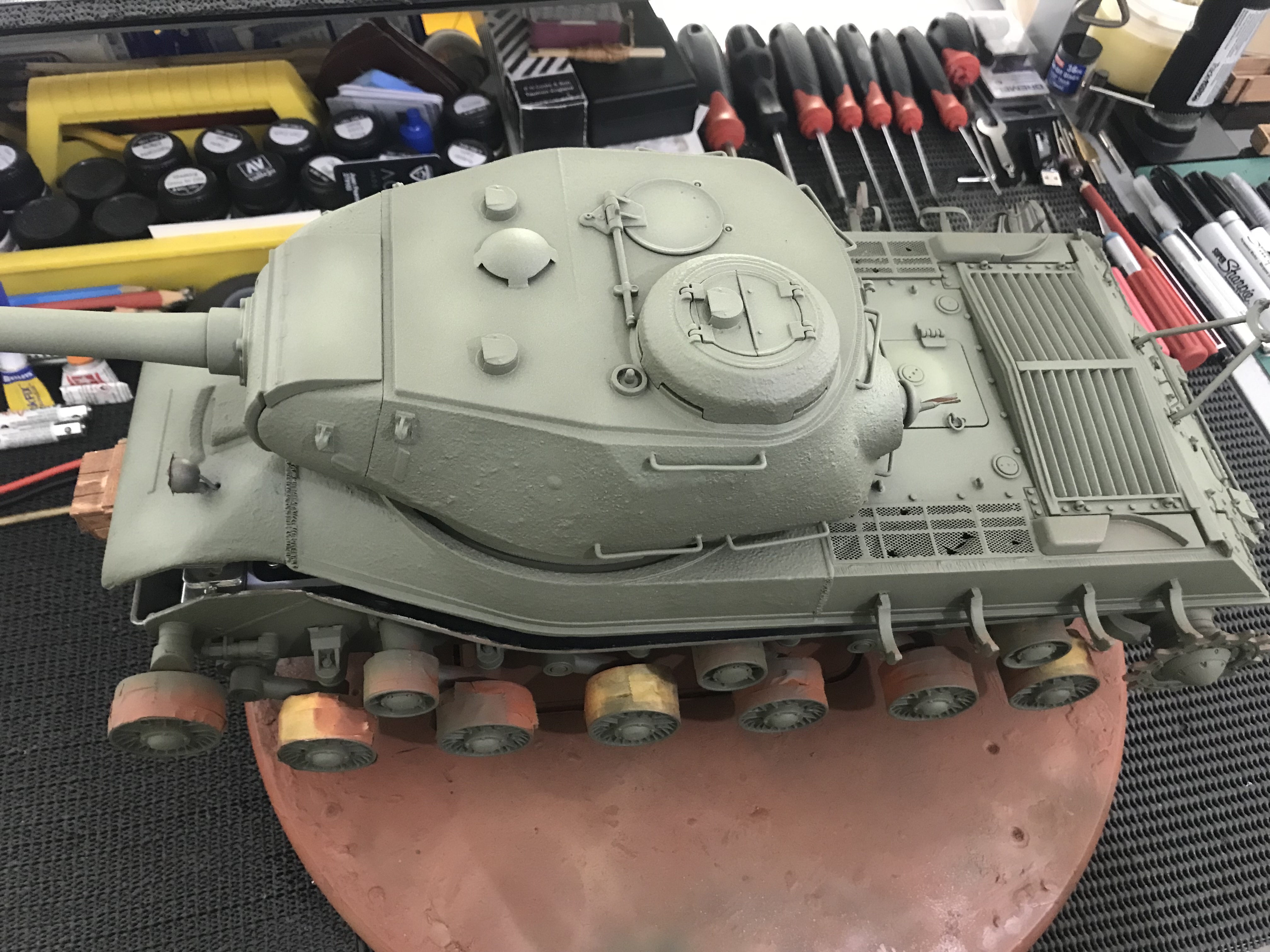

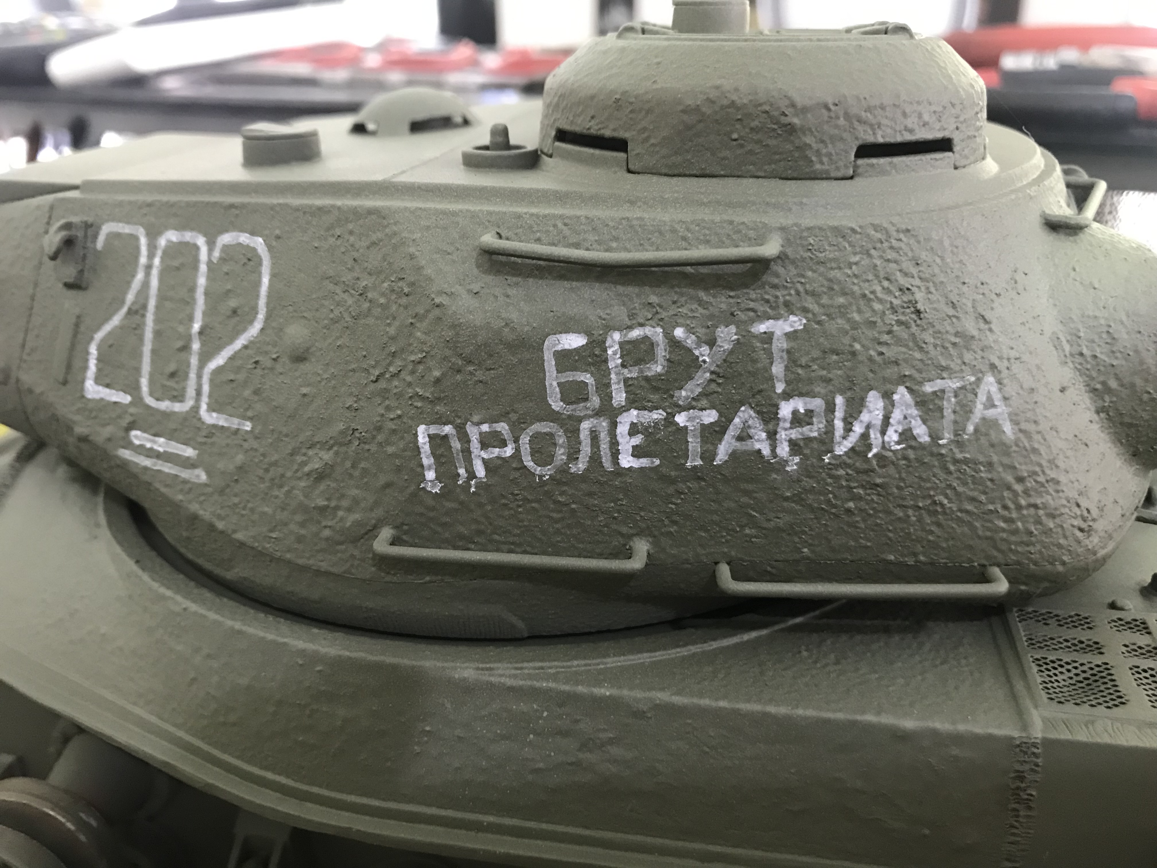

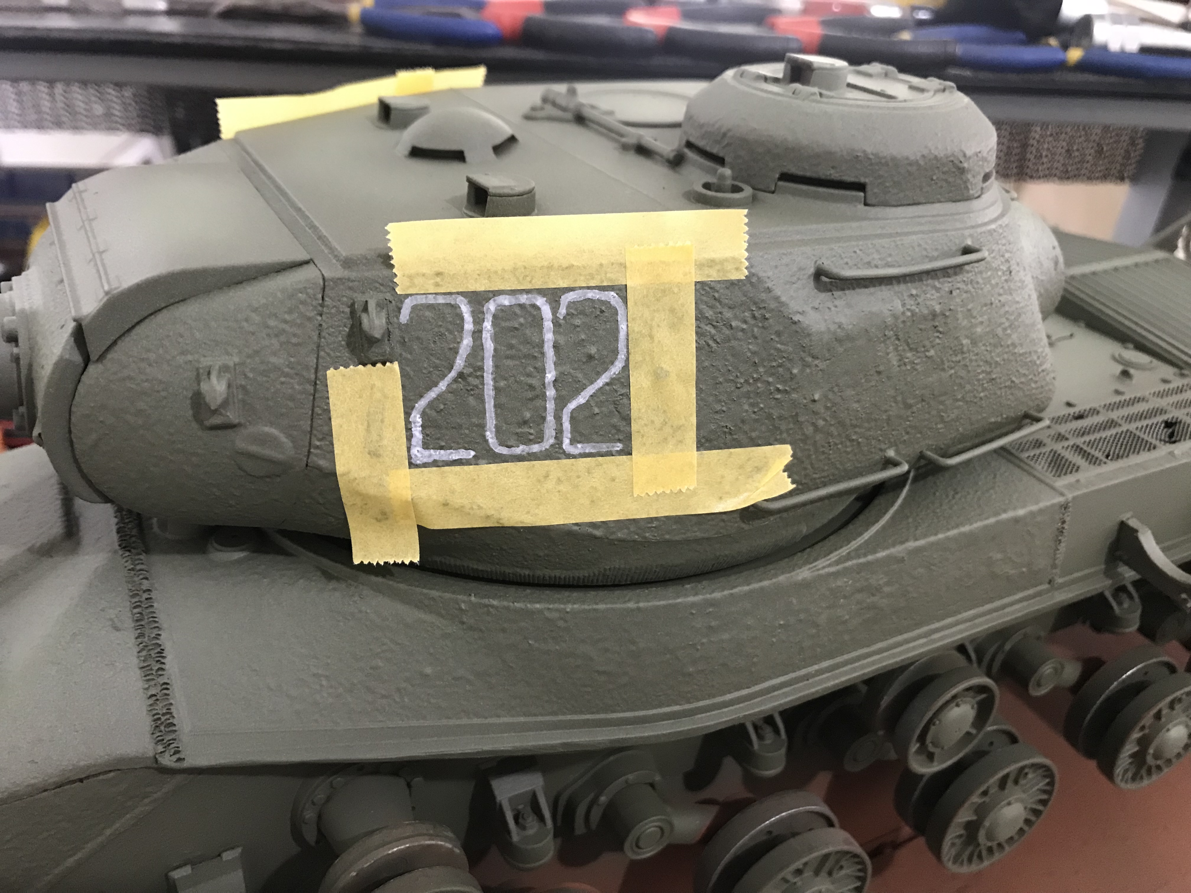

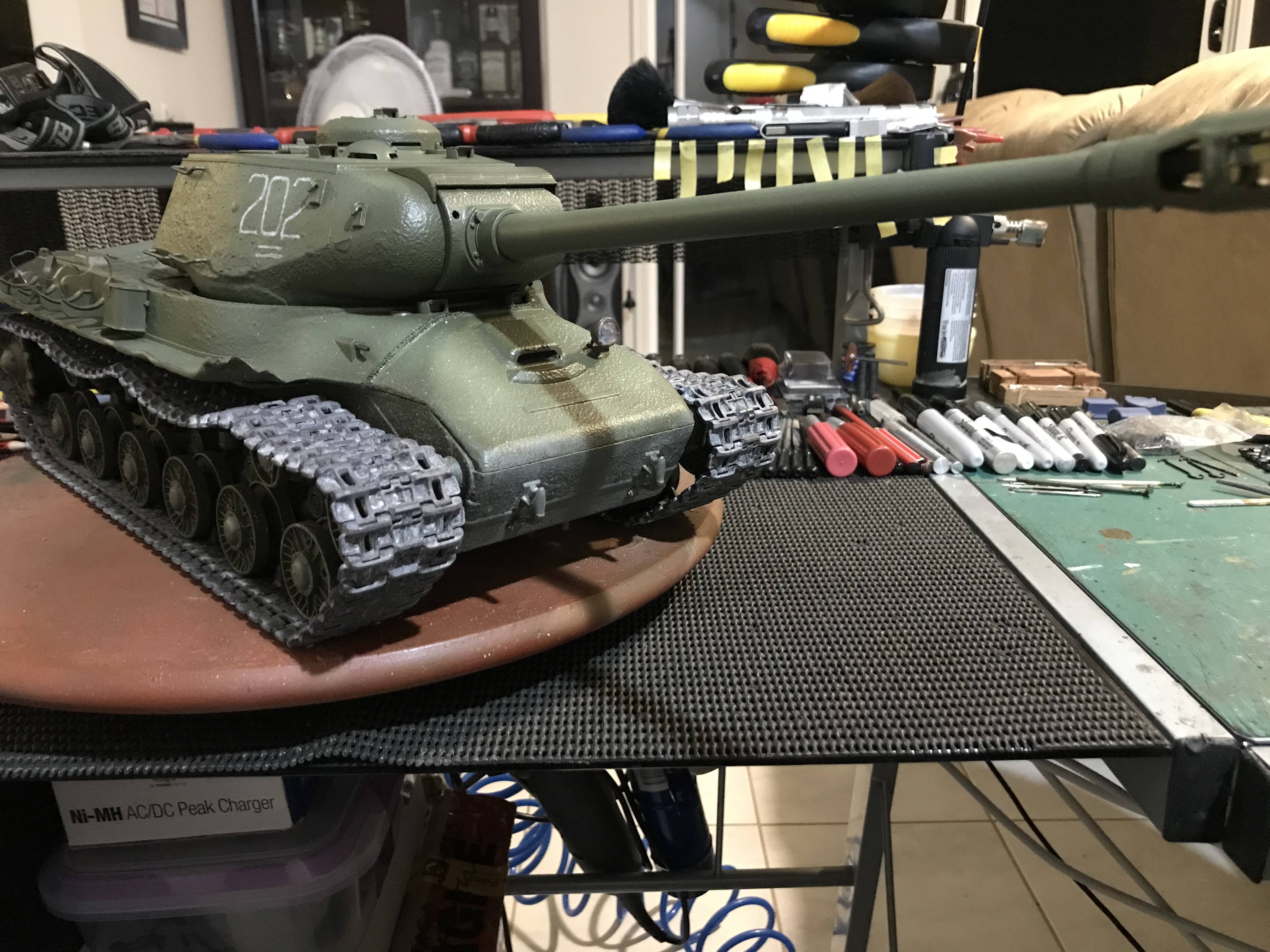

Green is on.
Sure is a big canvas with a lot more angles than a King Tiger.
Lightened the larger flat top surfaces and hand painted the turret numbers & slogan.
Got paint on the tracks and washed them in too.
Loads of wash & pigments to apply so still lots to do.
Chipping effect here & there, and some sort of stowage.
I adjusted the idlers and got the sag just about right.
If it gets too loose I can set them back to where they were ex-factory without using any new links.
