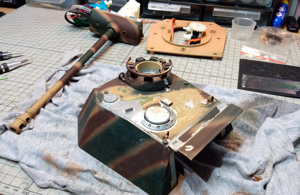

With this in mind, and joking aside, I began the process of rebuilding the turret to the correct specifications firstly removing the internals. The standard Taigen servo recoil and elevation unit, fitted to their upper tier Pro-metal offering is actually quite impressive I think. Having not opening up the turret previously I was pleasantly surprised at the layout and gear driven mechanism they had devised. On this account I reconsidered my plan to shoehorn in a Heng Long servo unit I had on standby and considered reutilising the Taigen unit instead;

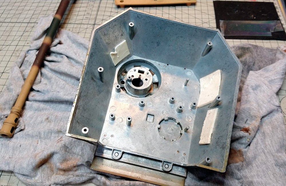

And with the internals removed, a nice clean start;
With the electricals removed I begun the again the process of removing all the old Taigen paint, which as I pointed out earlier, is actually quite good,, and a real pain to remove! :problem;

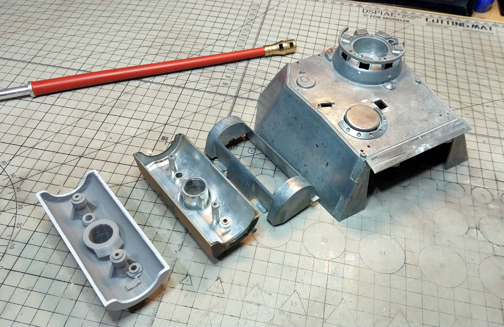

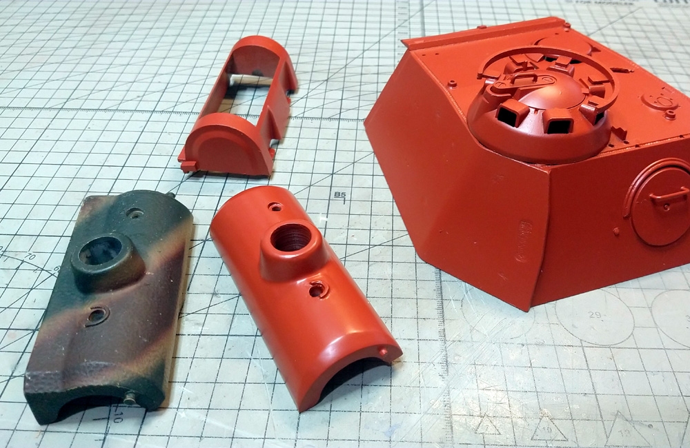

In the following picture is the (finally) cleaned up turret. In the bottom left of the picture is my newly designed and 3D printed 'chinless' mantlet. Sitting to the right of this is the metal Taigen mantlet with the chin. I had considered reworking the Taigen mantlet but this was likey to be problematic as quite lot of material would need to be ct away. Another option here is a replacement resin mantlet from Rctanks.de. The problem with this being it is made for the Tamiya RC tank, so I understand, and therefore would also need a fair amount of modification. The advantage of designing and printed the replacement myself is that I could make sure it dovetailed nicely with the Taigen mechanism - which it did thankfully :D ;

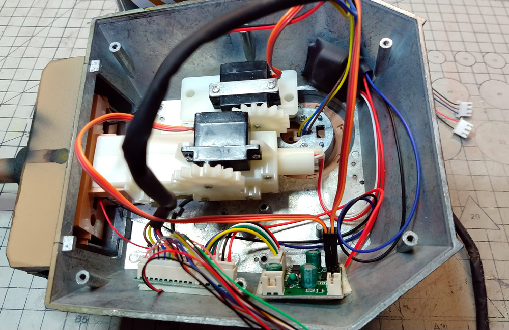

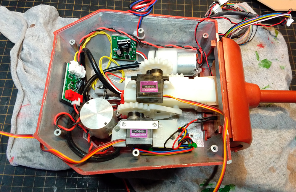

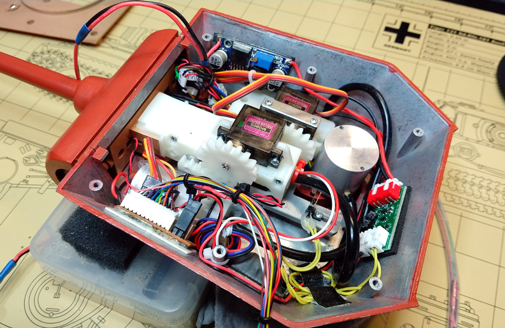

In the this picture below can be seen the installation of the Taigen mechanism body to which I have fitted better metal gear servos. These are still quite cheap servos but a lot better than the ones provided by Taigen which are plastic geared (a simple upgrade I would recommend to owners of servo equipped Taigen tanks). I have much stronger (and more expensive) servos but they are a little larger and using the MG90S was more or less a straightforward swap in (I love the path of least resistance :thumbup: ).
The other thing to notice here is the (rather tight) installation of the Heng Long Smoking Barrel system. This took a bit fiddling about to fitted because the heater needs to be easy to top up. Hence it is position over the copula base with the feed tube coming just beneath the copula hatch. In addition to this the Taigen Xenon flash unit is also installed at this time;

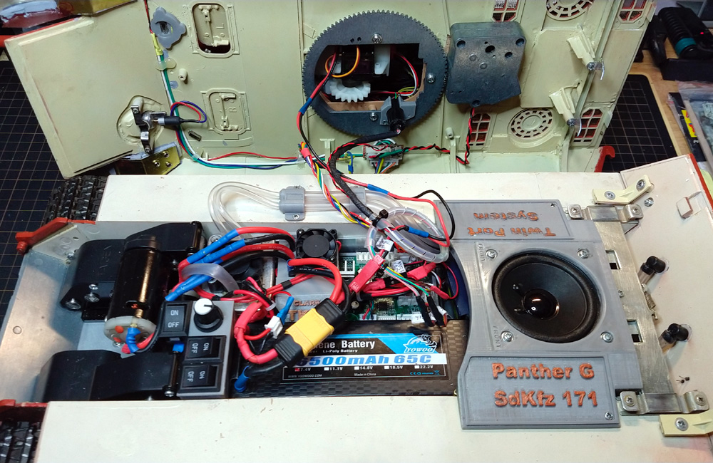

The final image of the turret internal installation shows this part more or less completed. Here it can be seen at the, as viewed, the voltage step-down unit to provide a steady 6 Volts for the smoking barrel system. At the bottom as viewed is the new electrical loom which I implemented to keep (almost) the 360 traverse turret. Also evident is the trigger switch mount I designed for attachment to top (bottom as viewed) of the Taigen breech body;

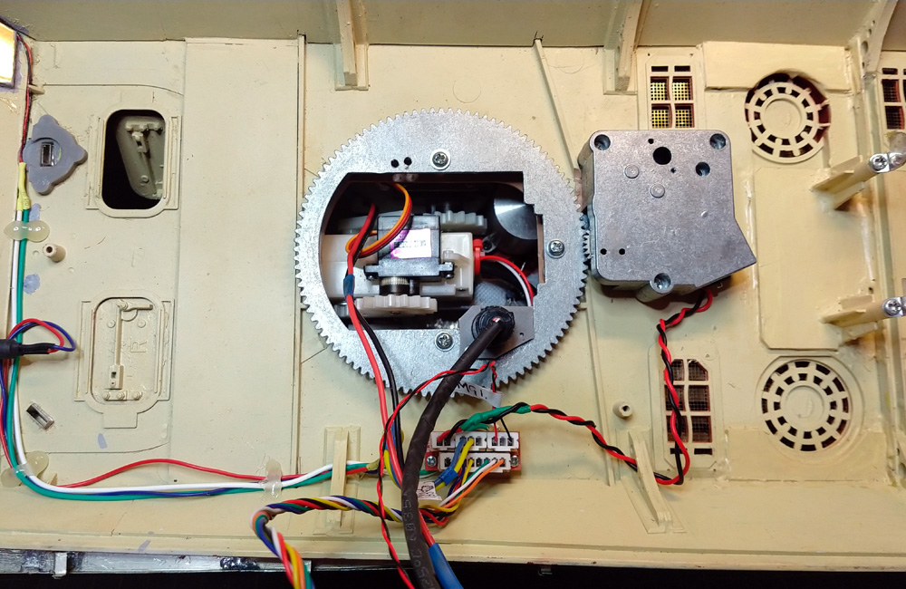

And lastly, the next couple of pictures show the turret reassembled back on the upper hull. This I have upgrade with both a metal turret ring and full metal traverse unit (I have these in other tank and really like them though the MFU board needs protecting with a low value resistor as if these jam they will not slip when matched to a metal traverse ring - the result of which will not be good! 8O );

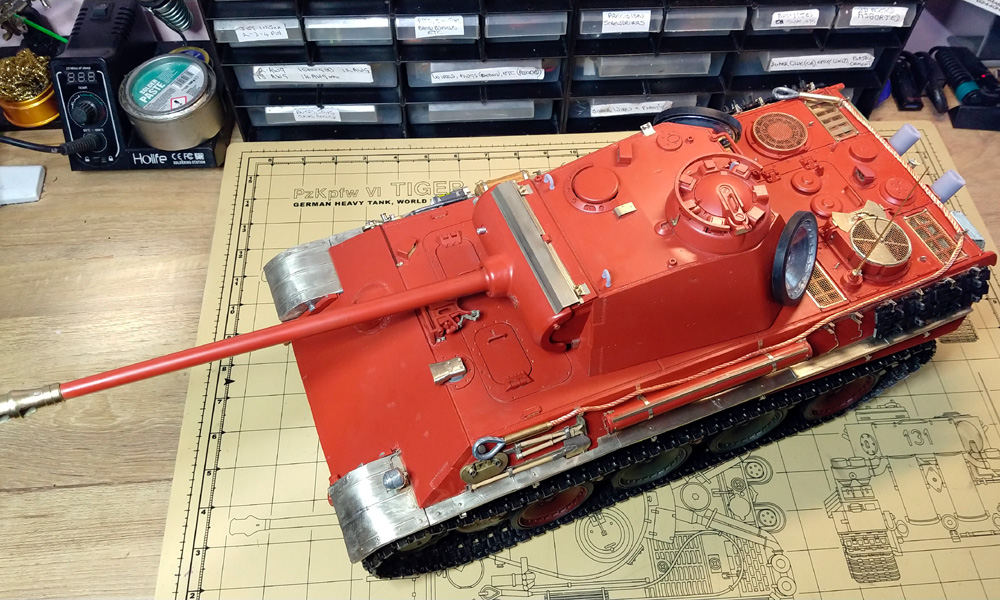

Well this is as good a time as any to add another update. Progress has been slower than I bargained on for two reasons, 1) I had not anticipated the amount of research I was in for when I decided to make this build a reasonable representation of an actual WW2 tanks - the Muncheberg Panther G No.122 and , 2) the sheer amount of fiddly detail I was about to become entangled with. This is, in many ways, a very complex tank in any case and attending to the specifics of this particular big cat presented challenges for sure.
Anyway, I eventually made headway and am about ready to move on to priming and painting, etc. I do still have some loose ends to tie up but the bulk of the upper hull detailing is now more or less complete (click on image);

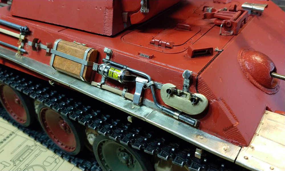

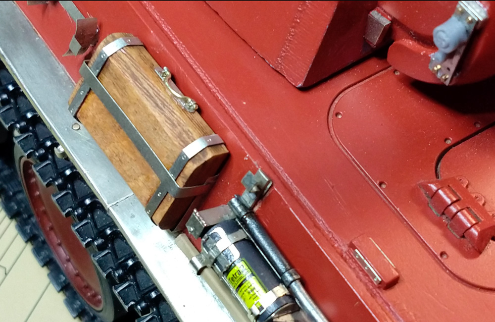

Following are closer looks at the right side tool rack and tools;

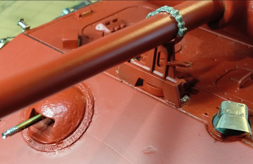

Here is one that really was a challenge, 44 links to this travel lock chain (as I recall) and once completed it works just like the original - a real test for old eyes for sure. The other thing of note in this picture is the drivers periscope hood that assume would have been fitted but not evidenced as such on the wreck. one thing of note is that this is actually quite a bit smaller than the one on the Taigen as it arrived. I'm guessing this was intentional because as working RC tank it would be more robust (click on image);

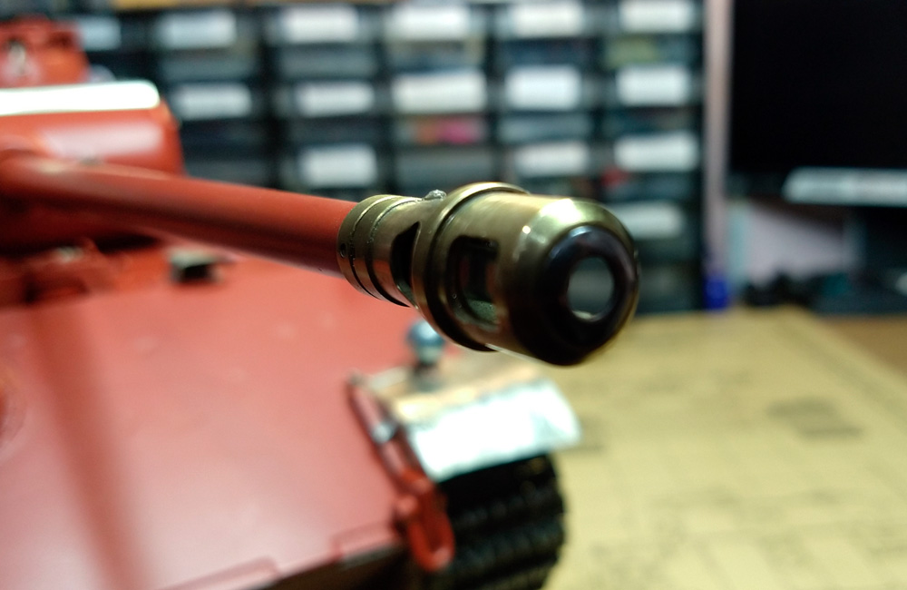

The next image is a close up of the muzzle brake the bore of which needed reducing since Taigen provided a nicely made but oversized one. This is probably due to being used on their BB firing version of the Panther and sharing the same muzzle brake. This still needs a little further work to finish;

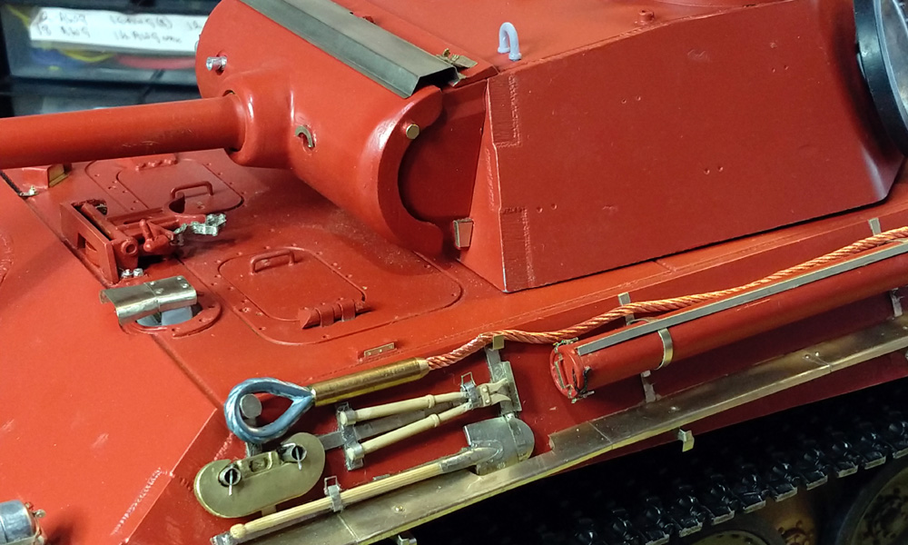

Tool rack and tools on the left side;

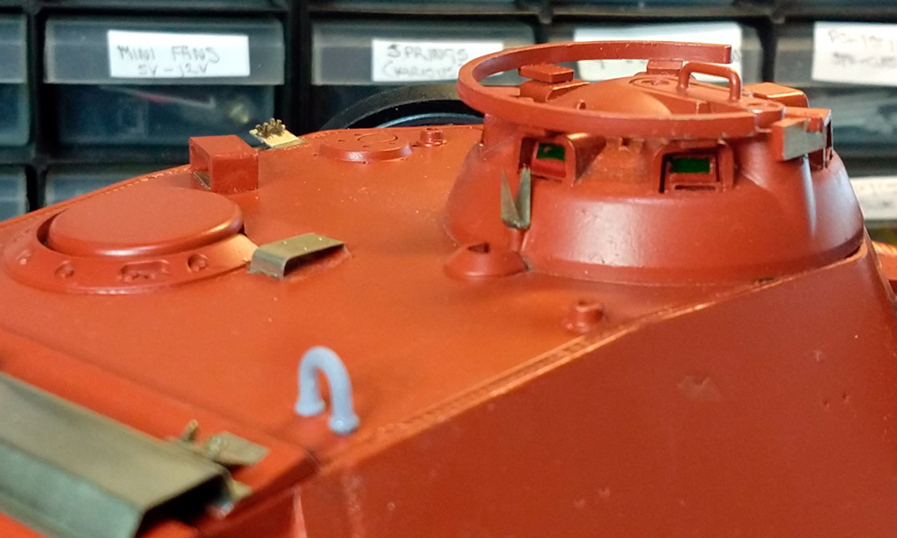

Turret roof and cupola details. In particular the difficulty here was in installing the six small cupola periscopes, each complete with glass, etc;

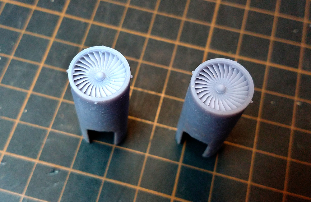

So, I was was never entirely happy with the Taigen supplied flame suppressors (Flammenvernichter), not that they are at all bad but that I just felt they needed a little more detail as they were, after all, quite prominent. Hence I designed and printed these replacements which have a more accurate vane count and appearance. Making these functional in terms of being able to pass the smoke through was the difficulty but in the end I am quite pleased with the outcome;

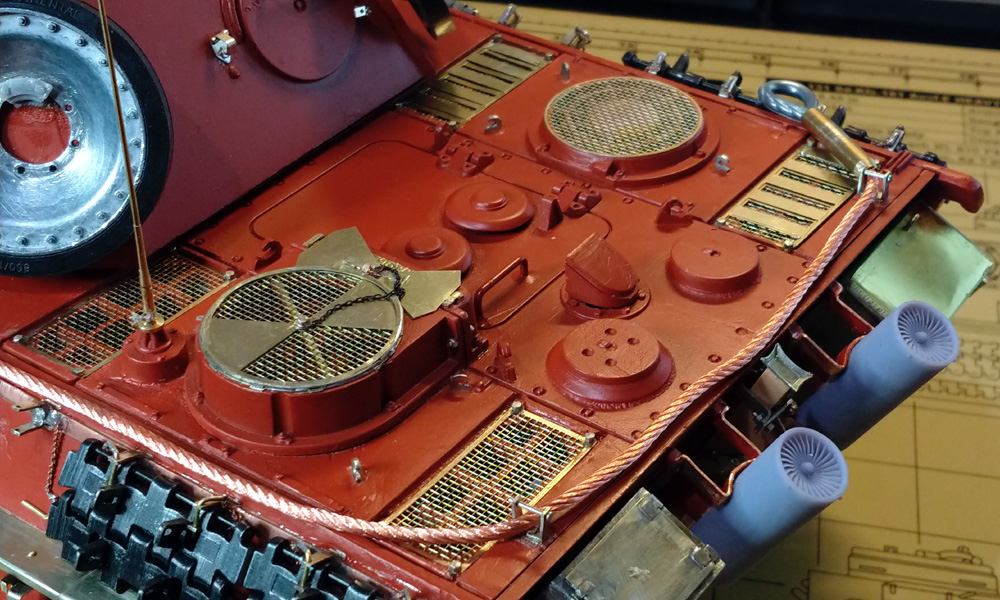

Here below are the various details on the engine deck, including the new version Flammenvernichter to the rear, and the tow cable. This cable is actually for a Tiger 1 (I have the Panther cables) but images of No.122 show this infrared equipped Panther with a single long cable that looks, to me, like a Tiger cable. It's entirely possible that this was added in operation, having lost one or more of the original cables. However, the fact that it is insitu and images of other Panther show other configurations as well, suggests to my mind it is also possible that a single, larger, cable was configured at the assembly simply because that was all that was available. Who knows? This tank was one of the last, knocked out sometime in April '45. Given it was rolled out some time between October '44 and March '45, when Germany's factory resources were at an all time low to say the least, it is entirely possible that this is how No.122 was initially equipped, but as I say, who knows? For now I'm sticking to what my eyes can see, and speculating for the rest!;

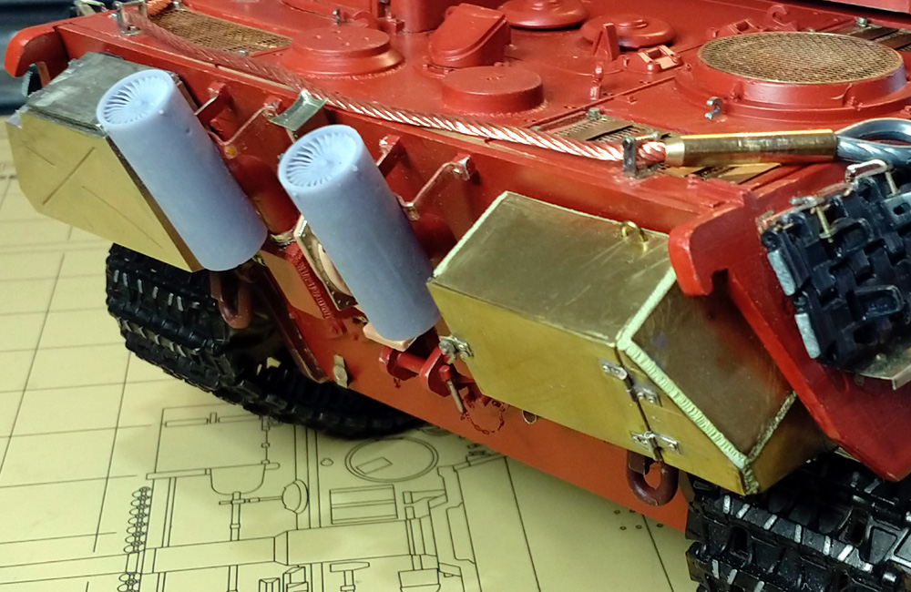

Another view of the new Flammenvernichter and the infrared storage box to the right rear;
