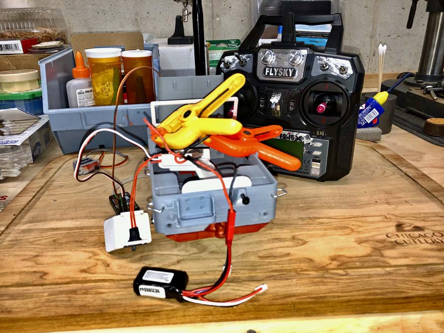

- Herr Dr. Professor
- Posts: 5986
Re: WCP Jeep-questions and simple build
I then tested the motors by clamping the tinned ends of the connectors together.
