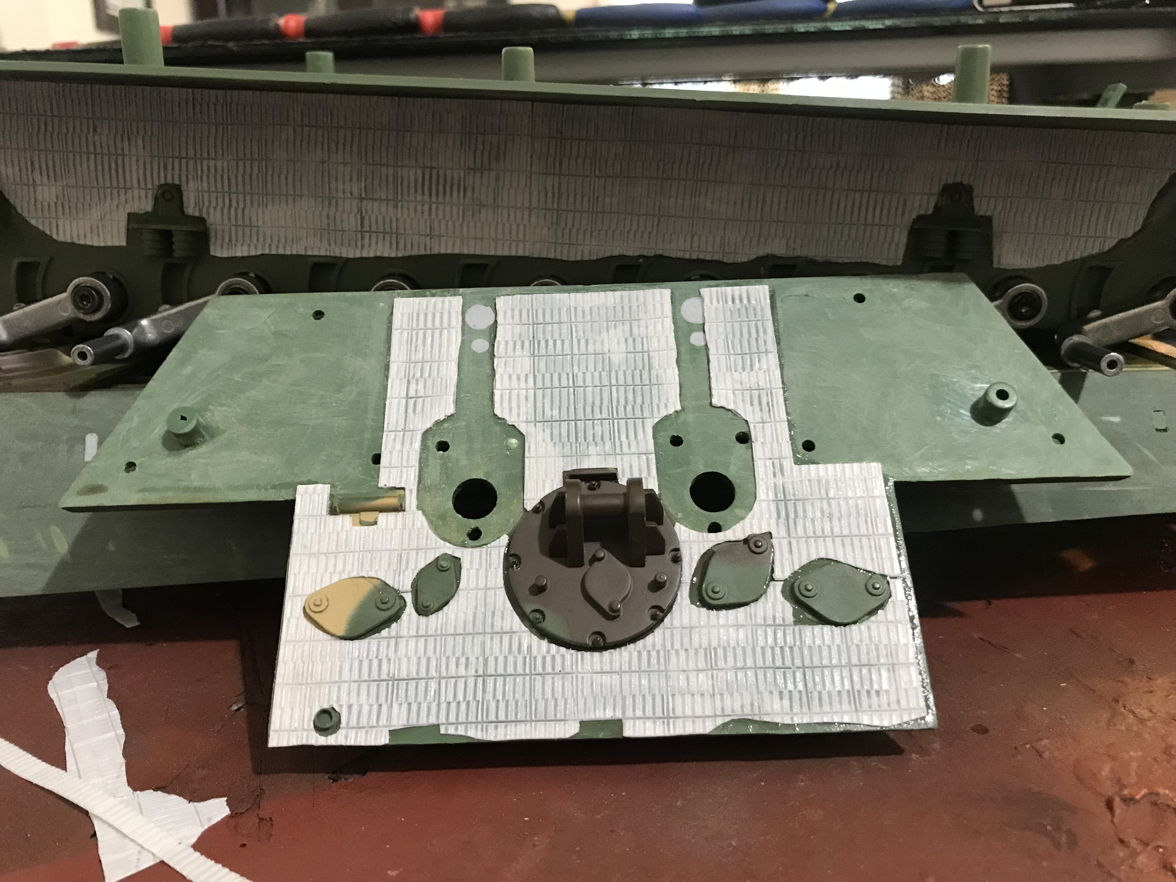

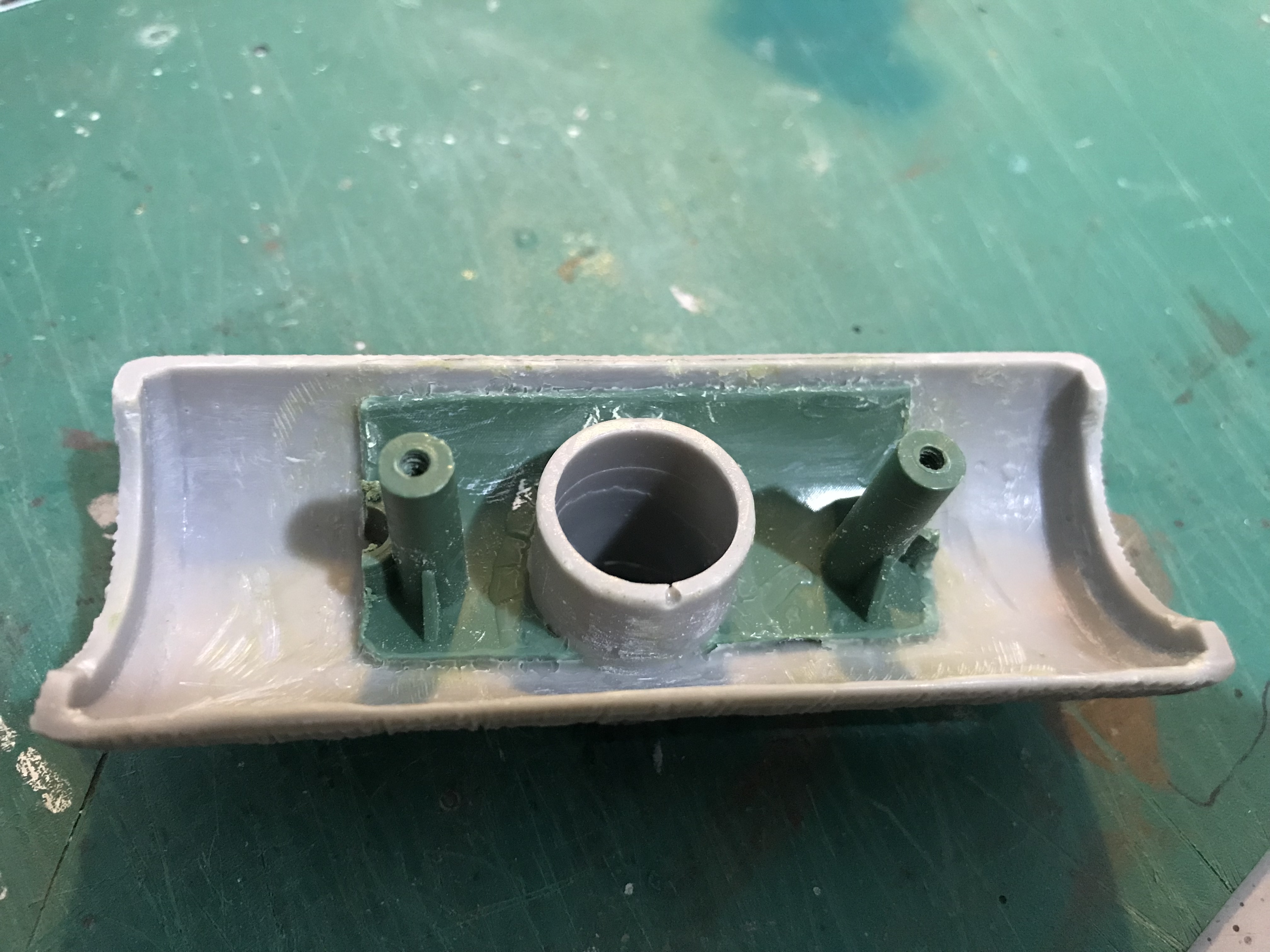

Got the Atak mantlet secured and dressed to suit the HL set up.
Cannibalised the H/L mantlet & fitted the remains inside the Atak and its rock solid.
Carefully sliced the nose seal off the front of the HL mantlet to fit in place once the barrel is in place.

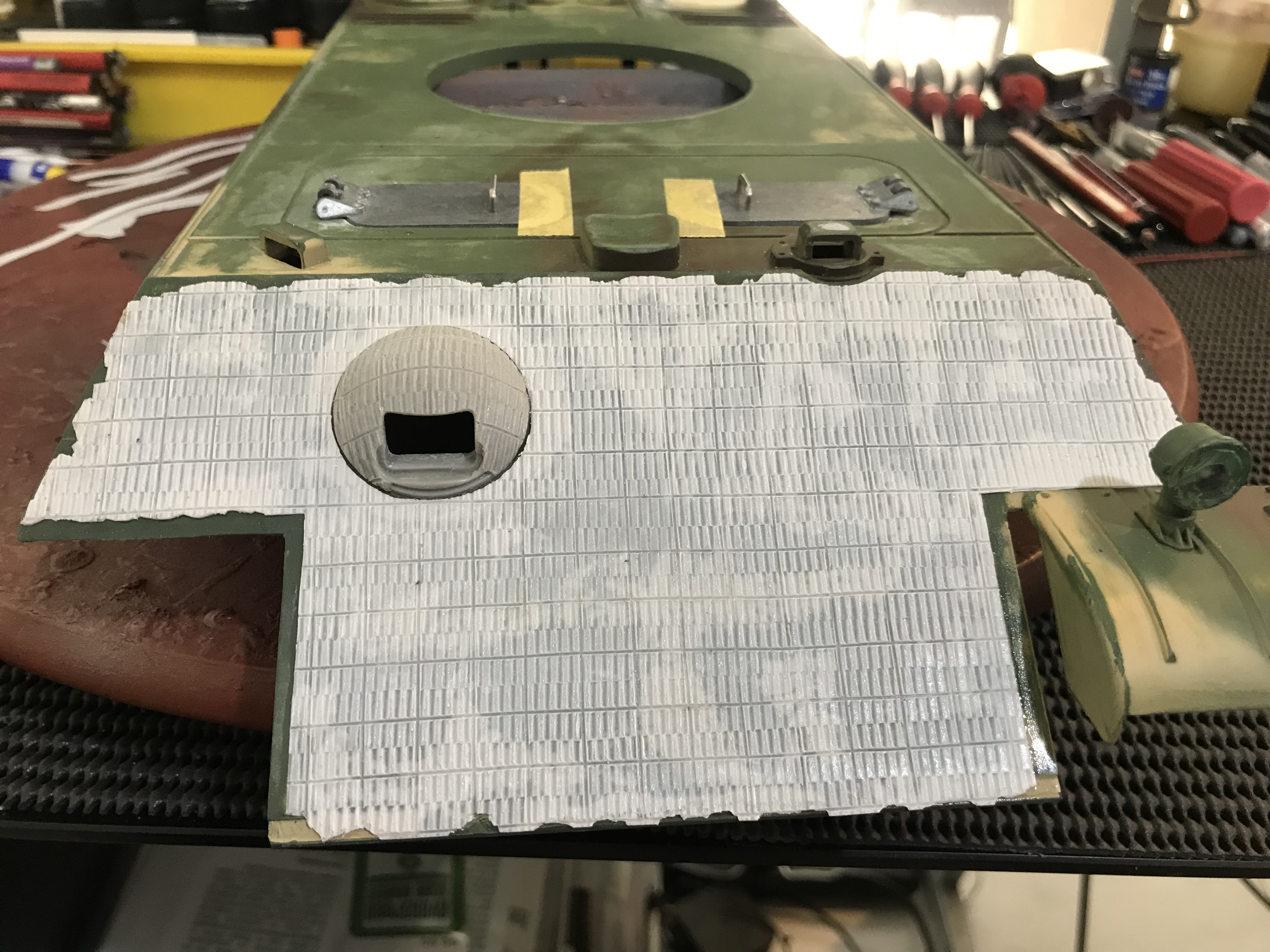

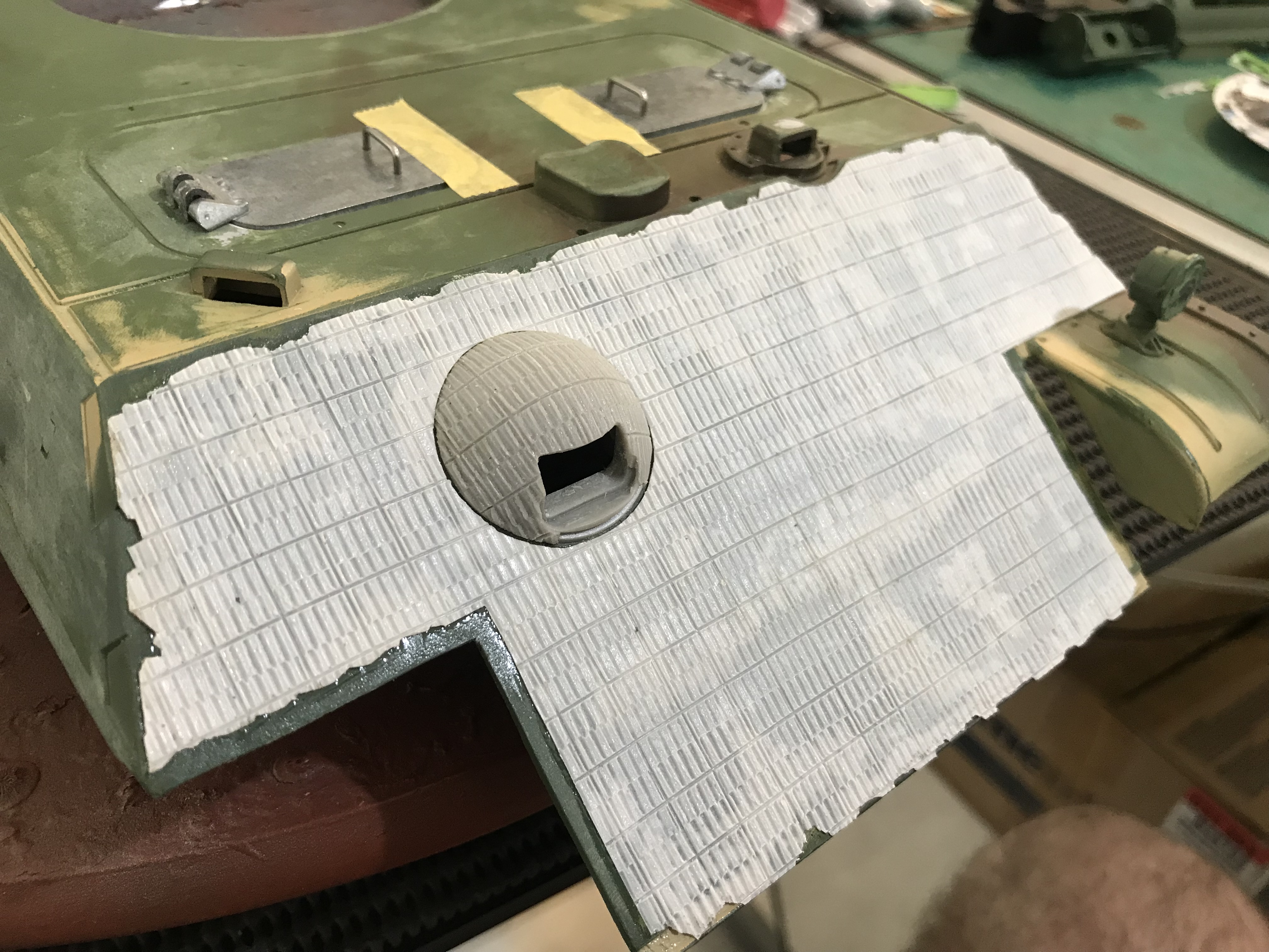

Been doing the Atak zimmerit now. It’s for a TAMIYA panther, but the dimensions are really close.
1mm difference in center lines on the rear plate, and 2mm on the front glacis plate due to the Kugelblend .
Freestyle under the sponsons, chipped the edges & im happy with the progress.
Still loads to fit, but I’m getting the hang of it now.
