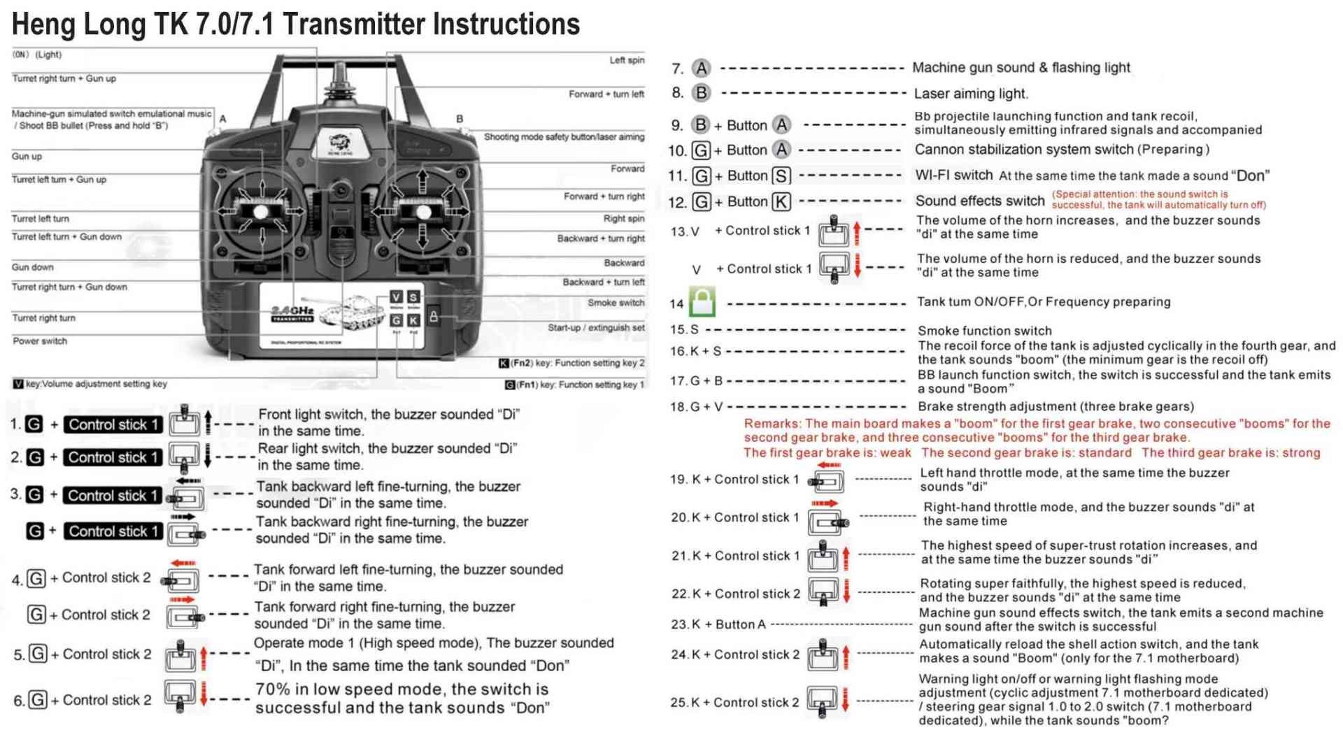

Hi All,
abramsky, thank you for the 7/7.1 instructions. I downloaded all of the images and made a composite 1 page instruction sheet (minus the chinese) and thought you all might find it handy.
I'm in the process of upgrading my very old 2.7mhz HL fleet to either 6.0 and now some are getting 7.0. I bought the 7.0's from Australian suppliers but they didnt come with any instructions for the Transmitter. So its much appreciated to have all the functions documented.
UPDATE: I found an error - to activate second MG and also change sound, the combination is buttons K and A not g&a. Updated image attached

DeathWarmedUp wrote:Hi All,
NOTE number 22 should say Stick 1....number 25 K + Stick 2 down activates "Independant LED control" on connector L10 giving an extra control channel onTK7.0..
