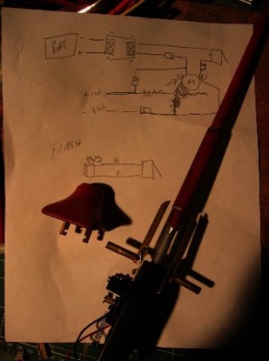

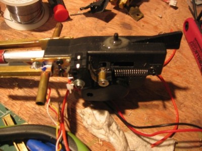

Gun retraction mechanism. Building with modification of the RCCommand build
Also, got the flash to work. Flash fires and carriage jumps slightly now (due to reduced gear ratio)..Looks good.

Just have to get some micro switches to run the flash and track recoil motion (brown / yellow trigger wire on flash cable...found out by saying to myself....'hmmm...wonder what happens when I cross the brown and yellow wires")
HAve to post the vid...
