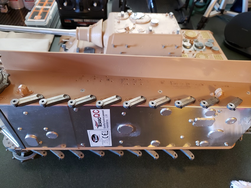

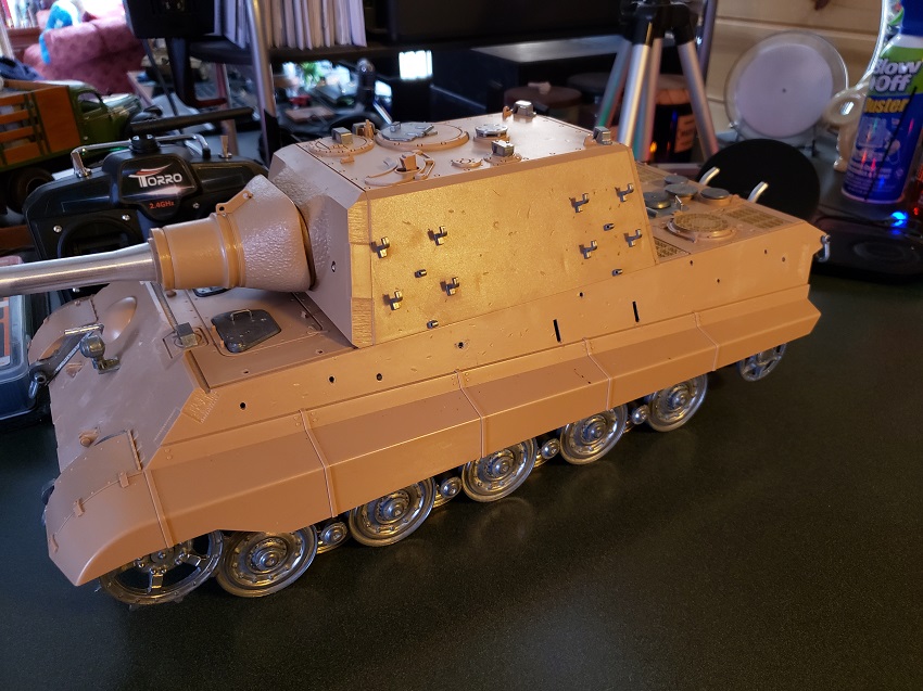

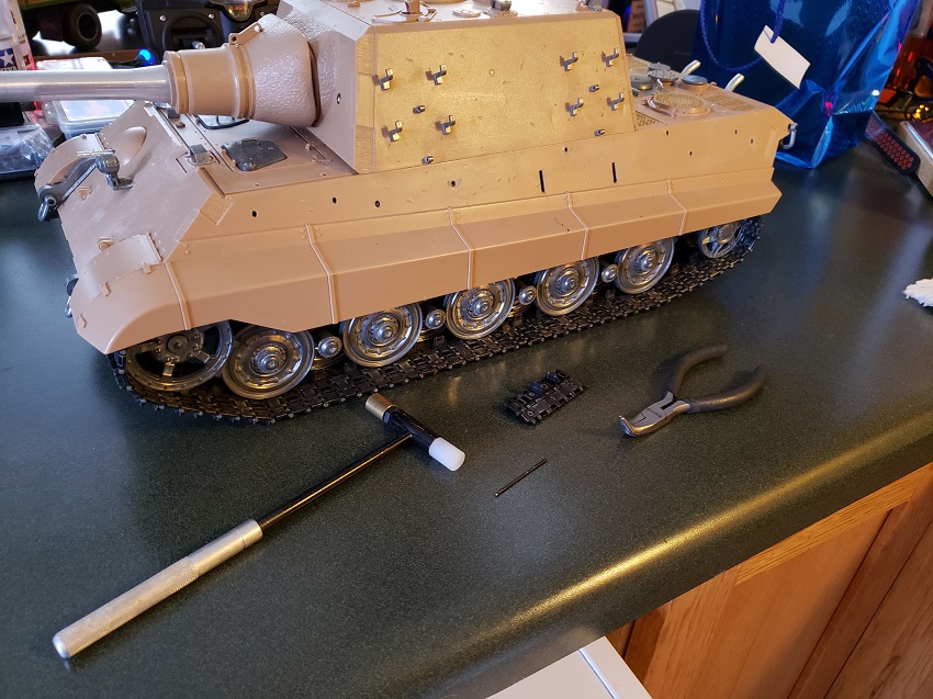

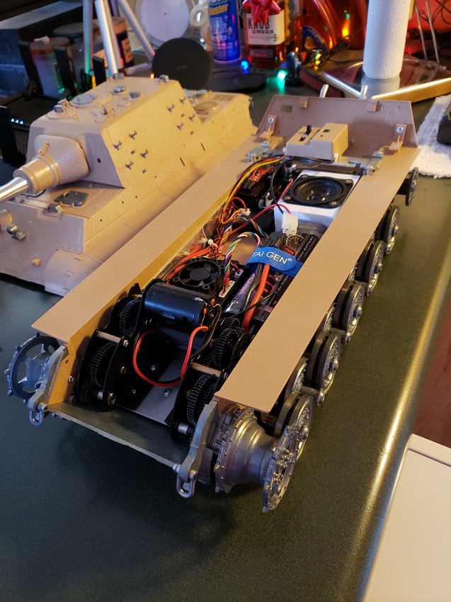

A little more time spent today removing more detail and finally the tracks. Next up will be pulling the road wheels and tightening up the adjustable rear idlers. I am still on the fence about painting the belly plate. Since this was a used vehicle ( apparently...bought, broken and returned then shipped to me as new ) ( I have perma repaired the break and the reason it occurred since ) there are some scuffs on the steel plate under there so primer and paint will probably be used. At any rate, Pics: ( Click to Enlarge )

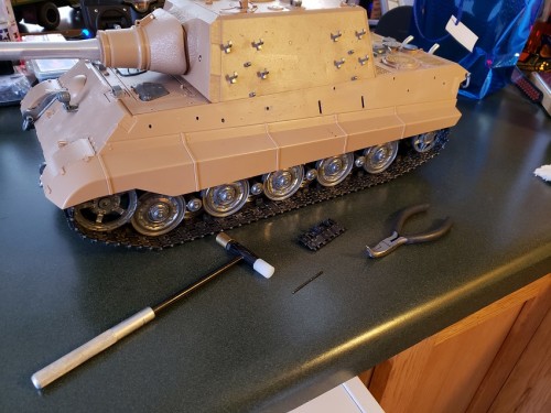

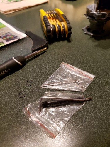

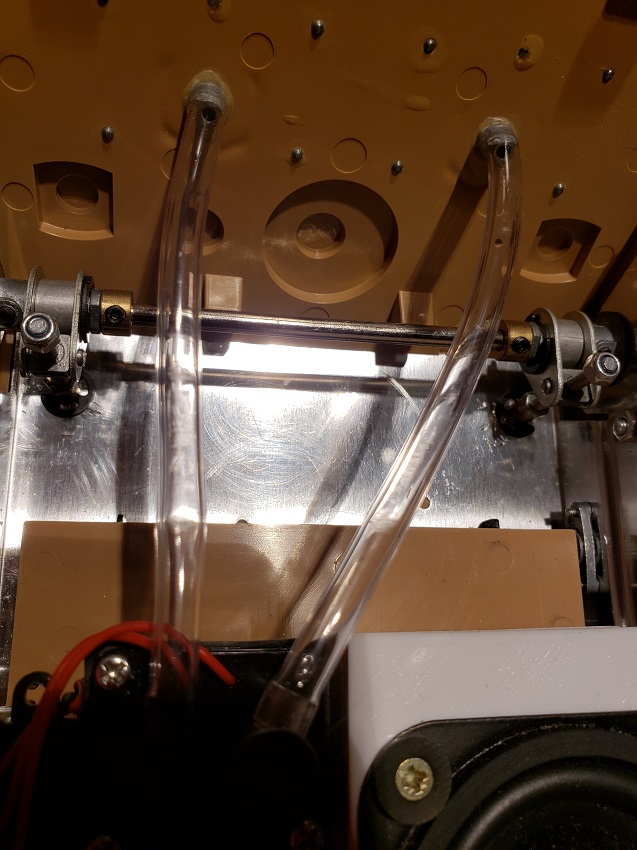

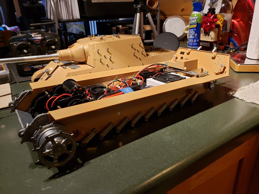

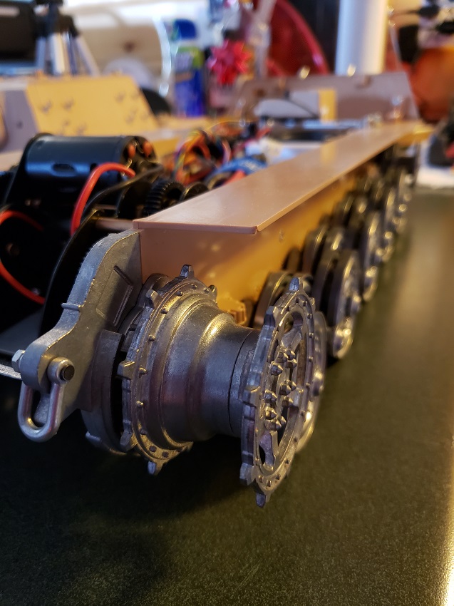

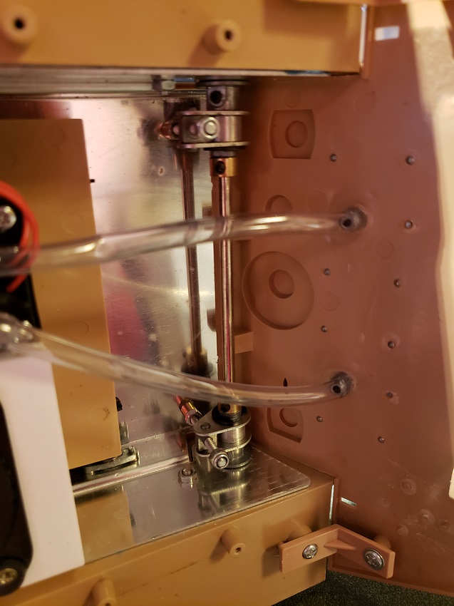

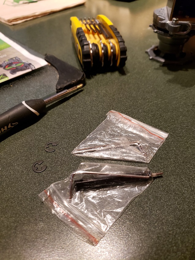

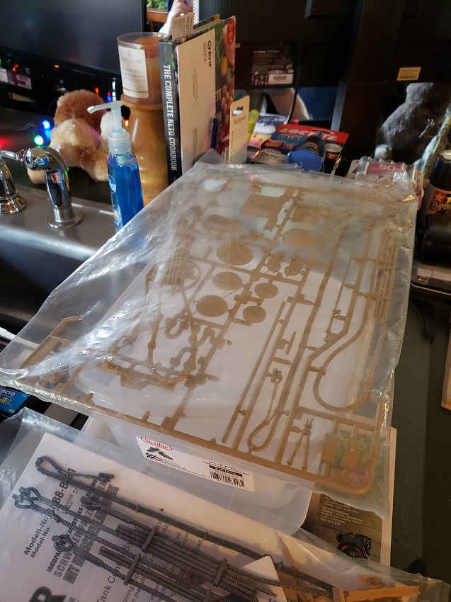

Thanks to a couple of German sites and the Aid of the Omnipresent Grip of Forgebear, said bits have been located and ordered. While the Mate streamed this afternoon, I took time to remove the road wheels and idlers. Not so simple as it sounds. I will use Loctite as well when I screw those tiny grub screws back in. I think I will file a flat in the axle stubs to provide a better grip tho' . I should not have to crank down on them like the factory did to tighten them. Using a couple of circlips from spares, I took 95% of the slack out of the idler mount brace \ adjuster. Very pleased with that and a useful sprue of Tamiya King Tiger parts ;o)
Pics: Click to Enlarge:

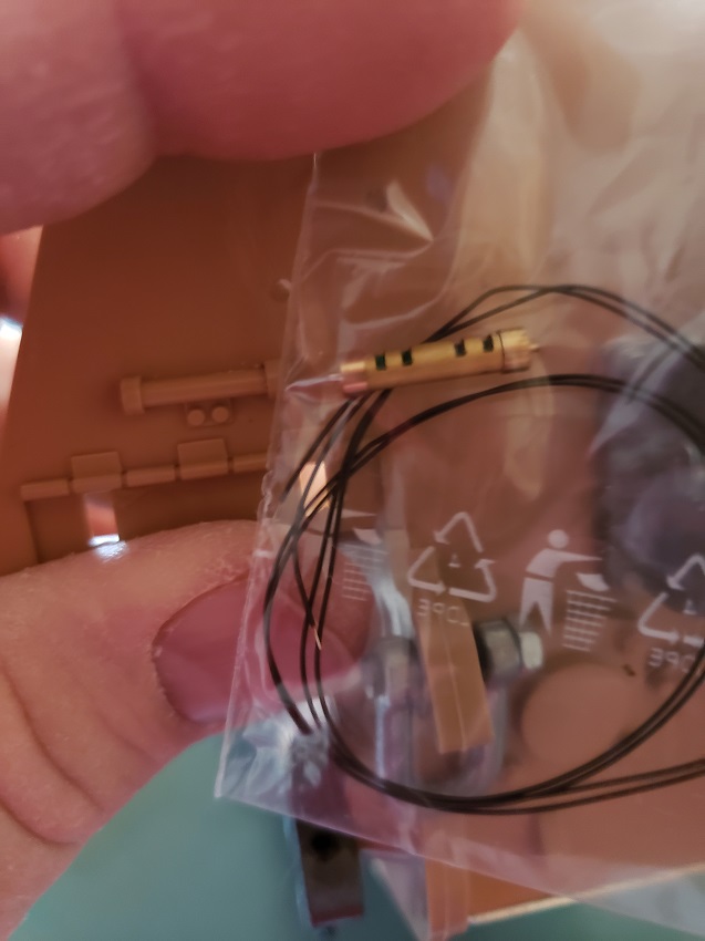

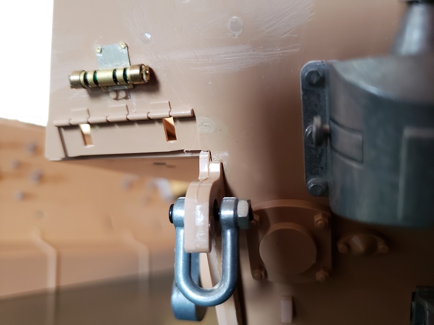

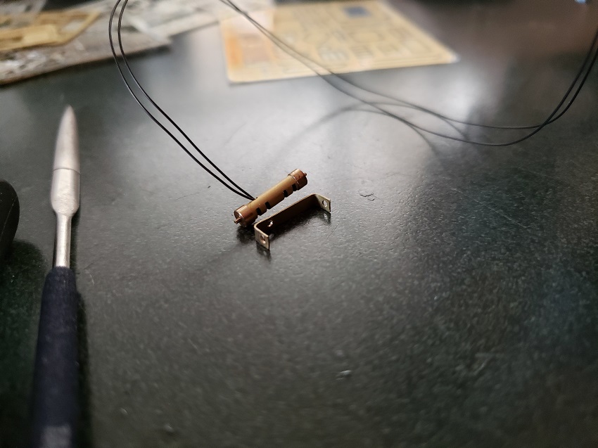

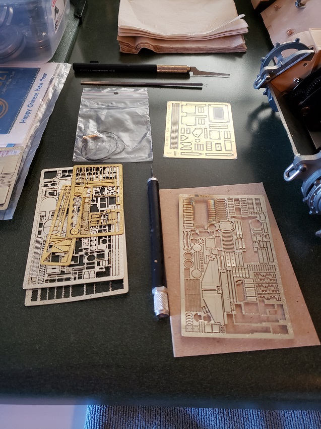

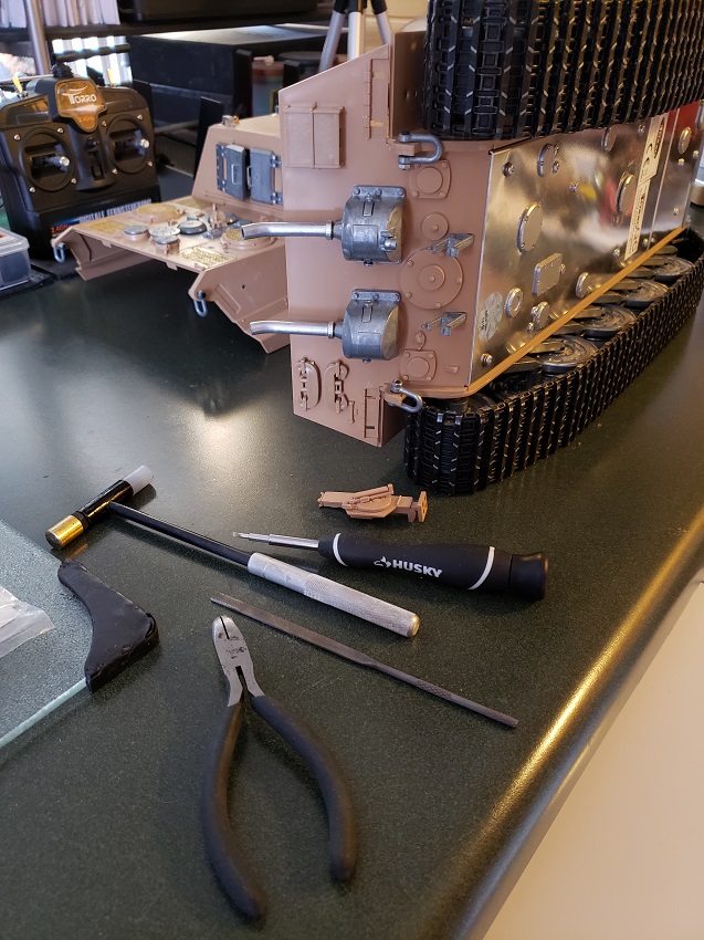

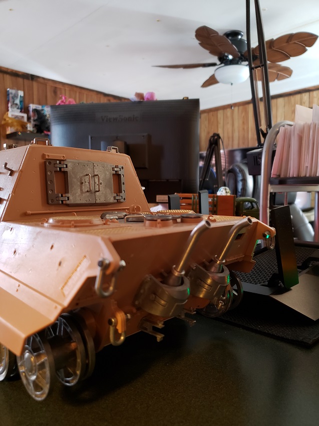

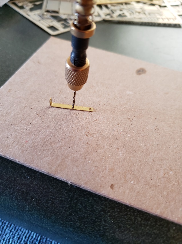

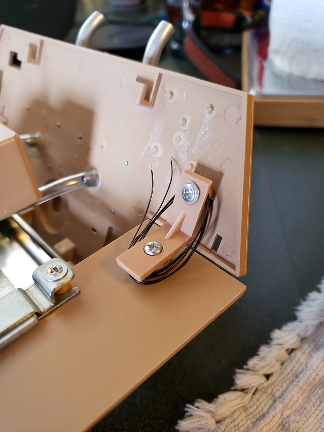

Working on the Lower today with files and various grits of sandpaper. I got the road wheel mounts smoothed out ( went into town and picked up some new 3M Blue tape for masking the road wheels ) and made up a brass mount for the rear convoy light. I will need to find a micro plug in Spares to solder an extension on to get it working. I am pleased with the mount that I made up. Looks like the Aber brass mount ( which I have and was going to use but decided at the last moment was a little flimsy for a Runner ) and is _Solid_!
