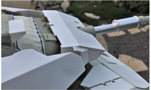

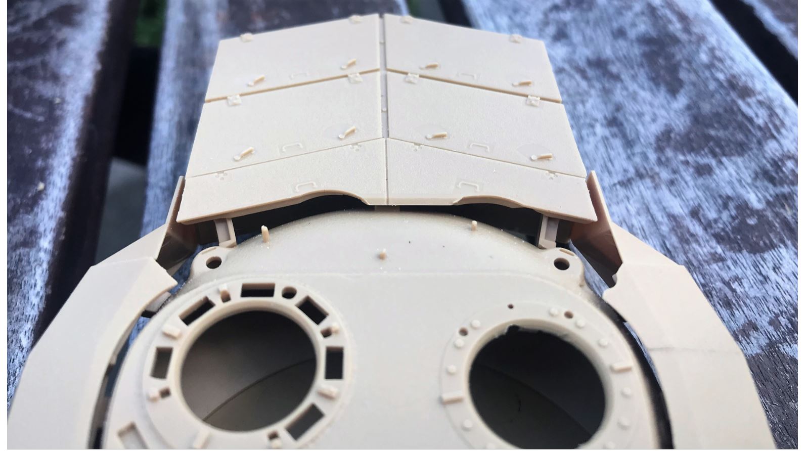

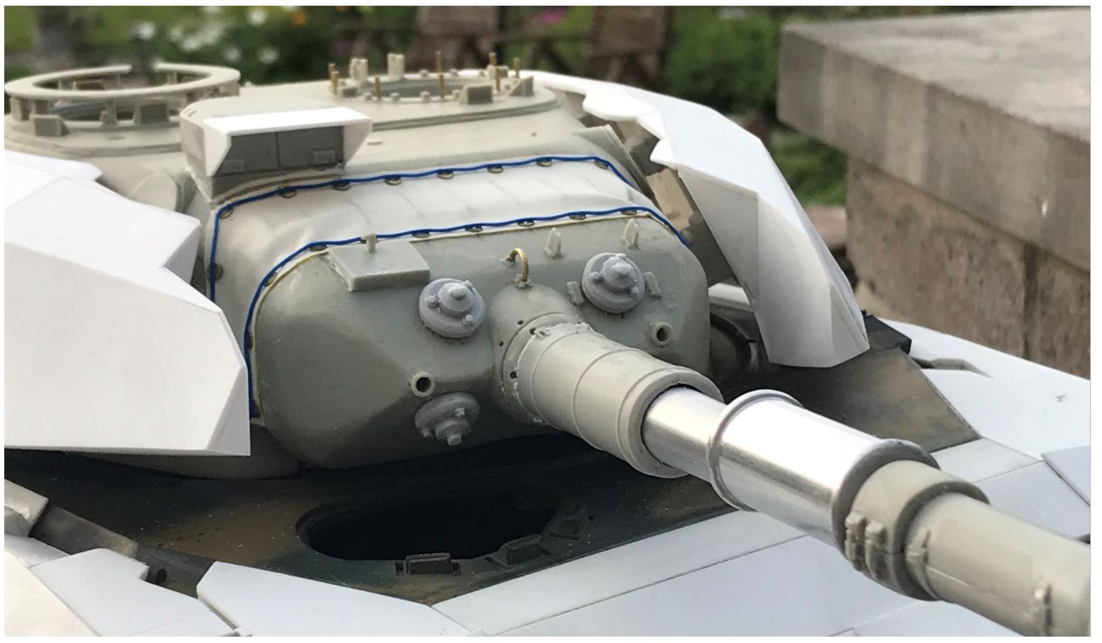

This post is for the add-on mantlet armored module.

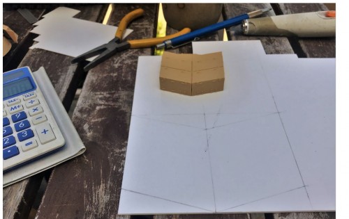

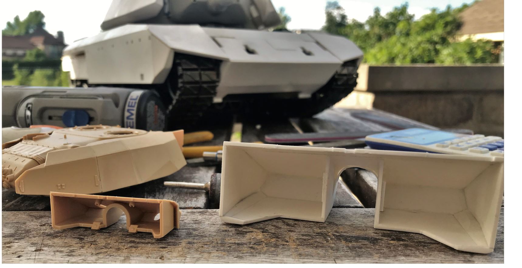

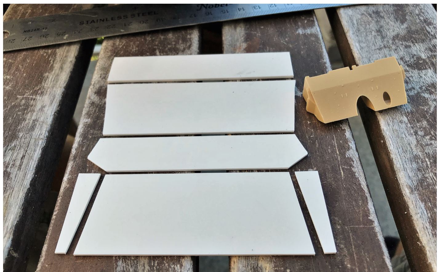

The Meng mantlet is studied, dimensions extrapolated, core parts are designed and cut.
RC 1/16 Canadian tank Leopard C2 Mexas - Afghanistan - build
As done with the Mexas, all angles are captured directly from the Meng model part by positioning it over the 1/16 joints when gluing. This is the best method of ensuring the parts will look good, and it's fast. Trying to eyeball the asymmetrical parts and their angles of assembly would certainly create questionable results when left to luck and a few fuzzy pictures.

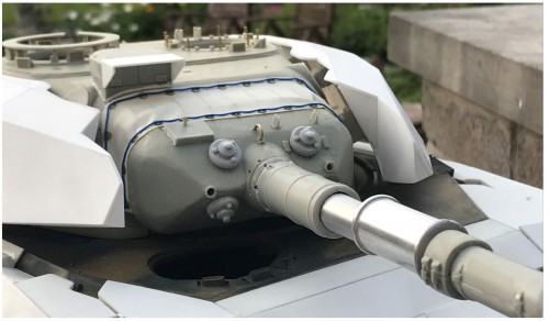

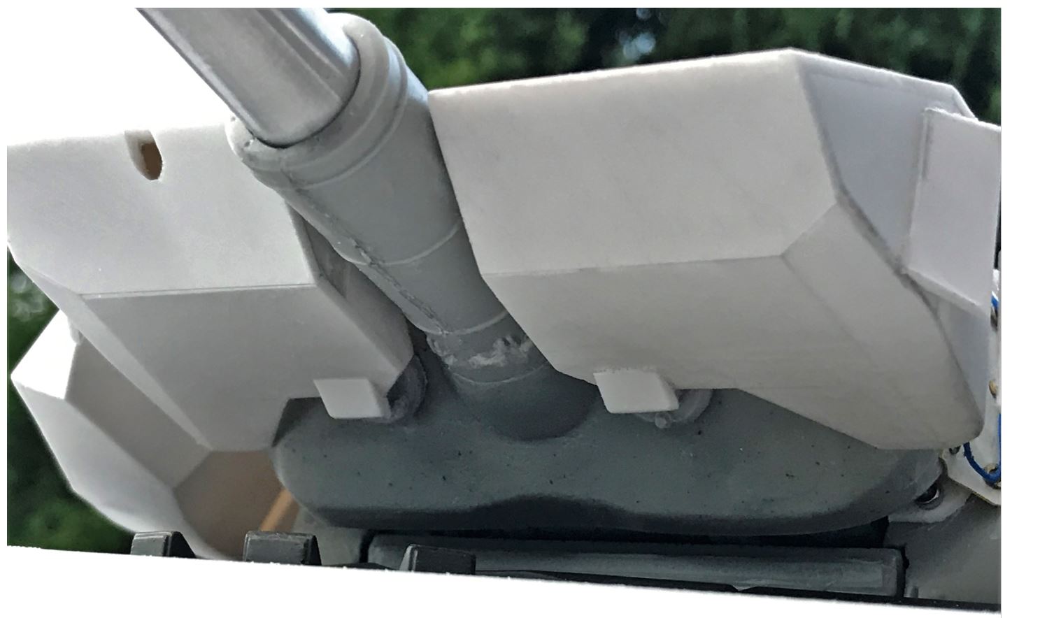

After having reinforced the interior, a tricky step is to create the hole for the gun barrel. This needs precision and no screw ups. Done mostly with the Dremel at first and then slowly with a rounded metal hand file for the last millimeters.
Because the mount points are partially visible under the mantlet, i reused the resin mounts for the 1A5 turret kit flat armor, and positioned as shown on the Meng kit for the C2 mantlet.

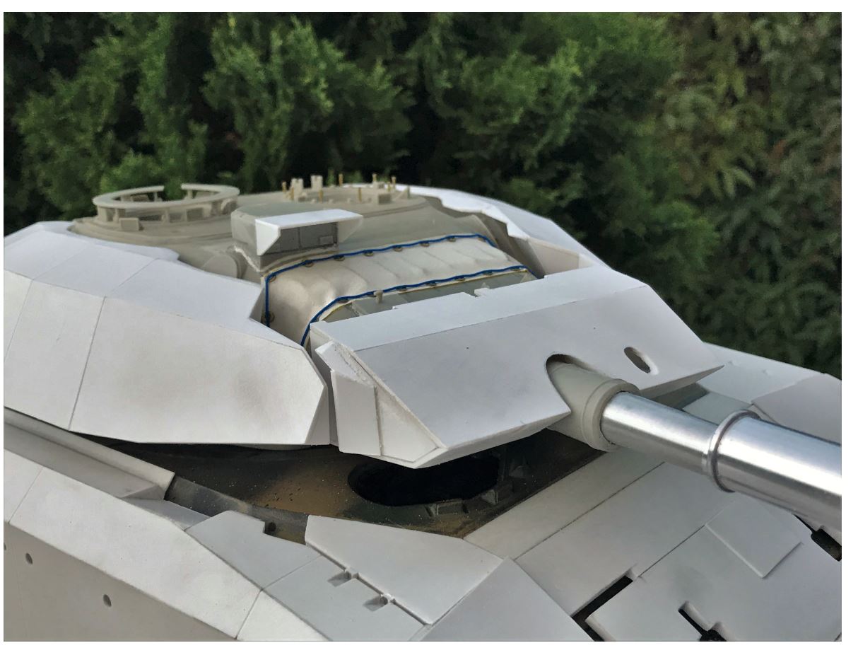

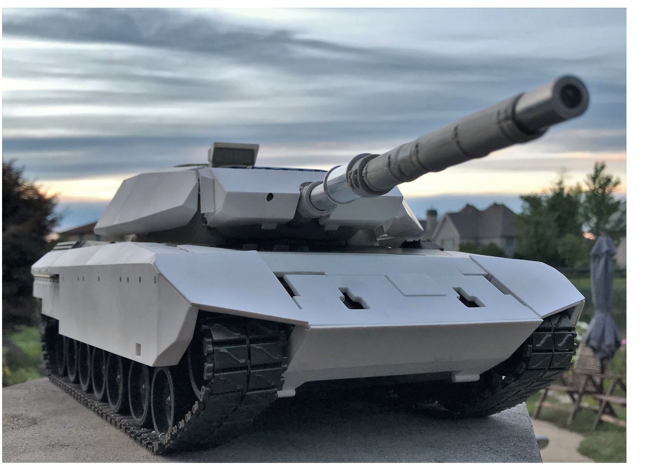

And here we have the C2 mantlet Mexas armor installed, minus the finer details (mostly bolt heads...) that will be added at the end of the build.

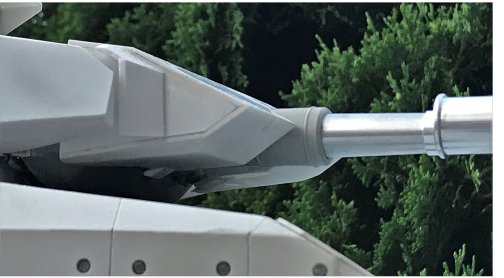

Viewed under the mantlet at maximum elevation.

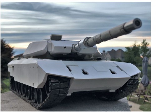

Man, that last photo is most awesome. You have many talents.

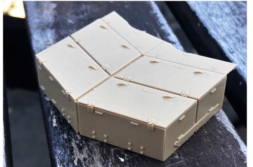

With this post, the heavy scratch building is done. Presenting here the Leopard C2 turret rear bins.
Again, the Meng 1/35 parts are summarily assembled for measurements and shapes. Whoever designed these bins did not have the modeler in mind.

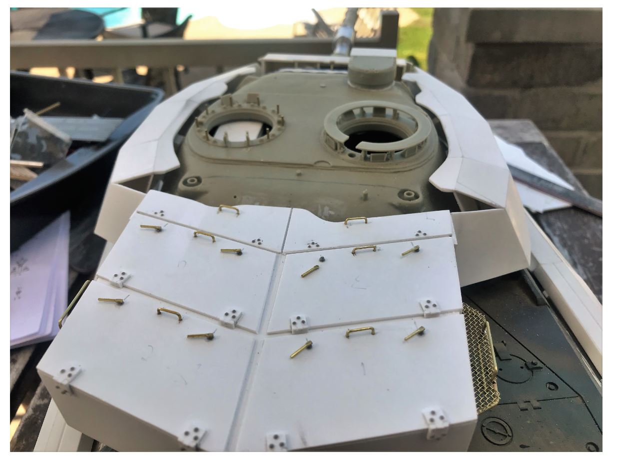

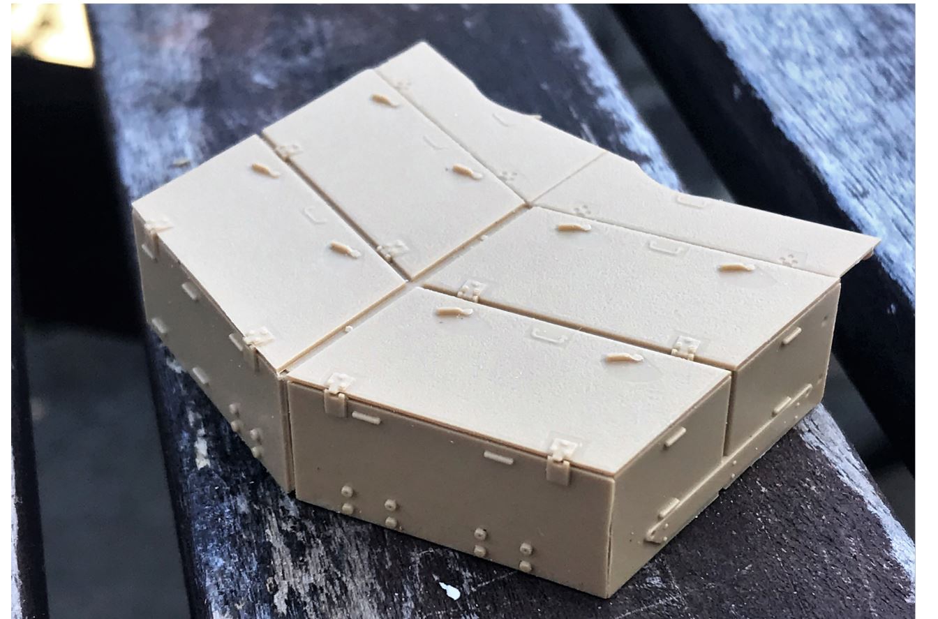

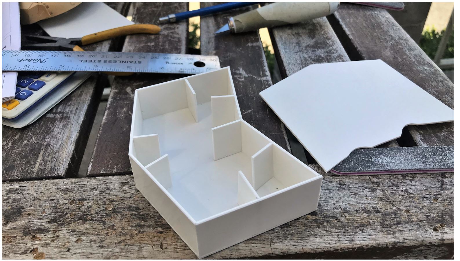

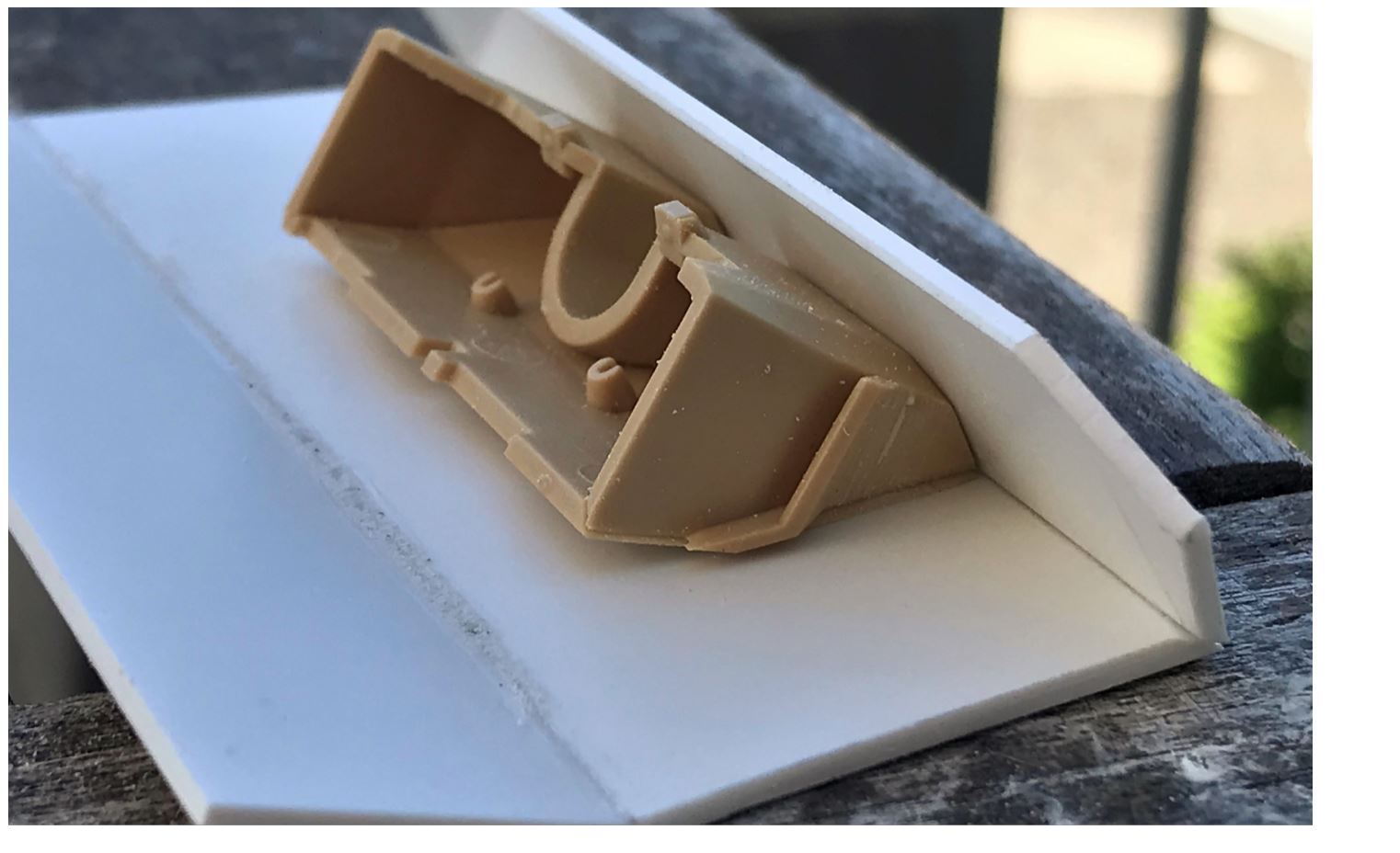

The core is scratch build in 1.5mm polystyrene plates, extrapolating the 1/35 kit to 1/16 without the need to be too creative.

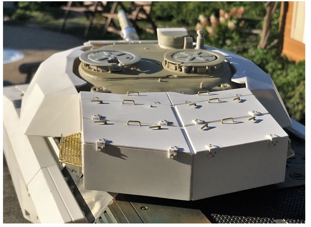

The core is built, to which the lids of the bins will be added in 1mm plasticard.

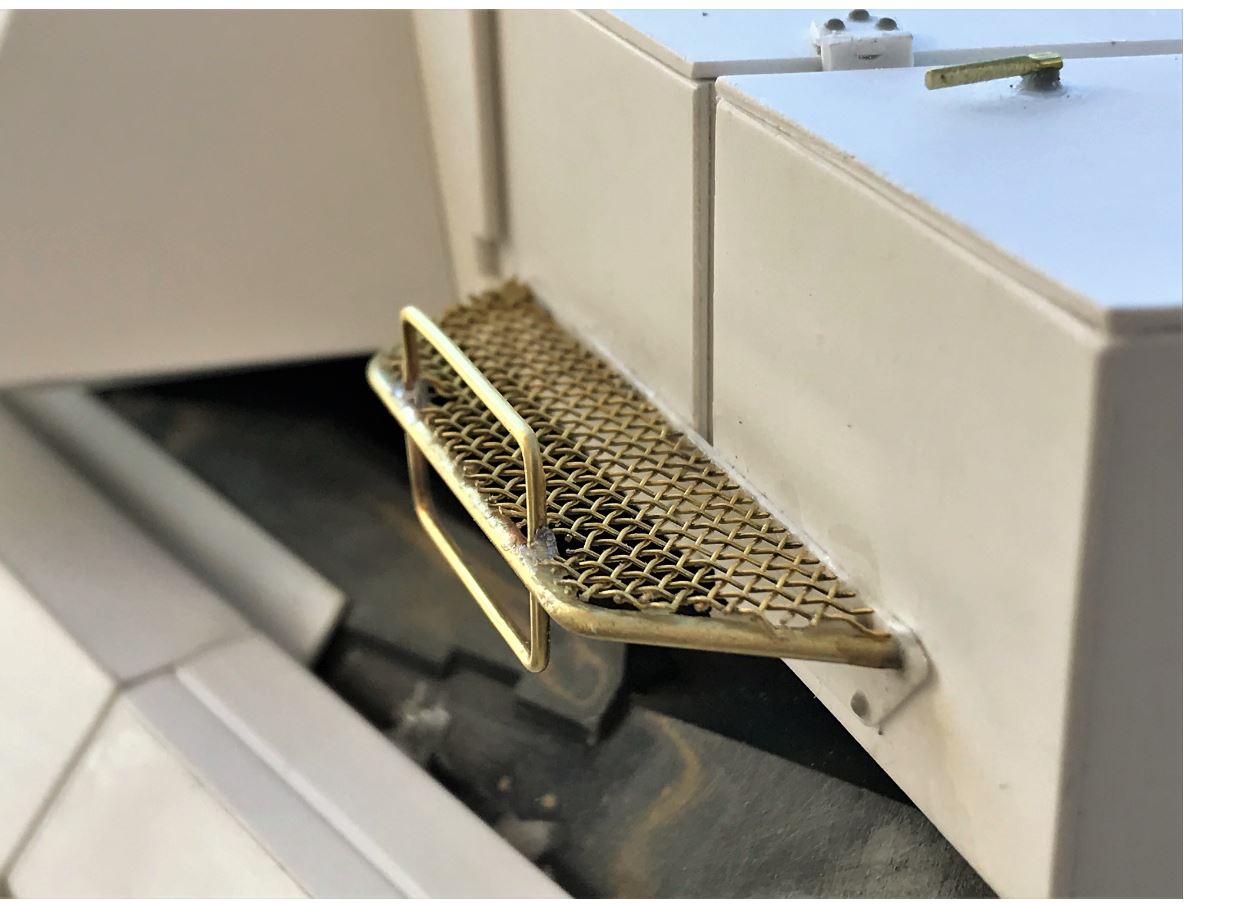

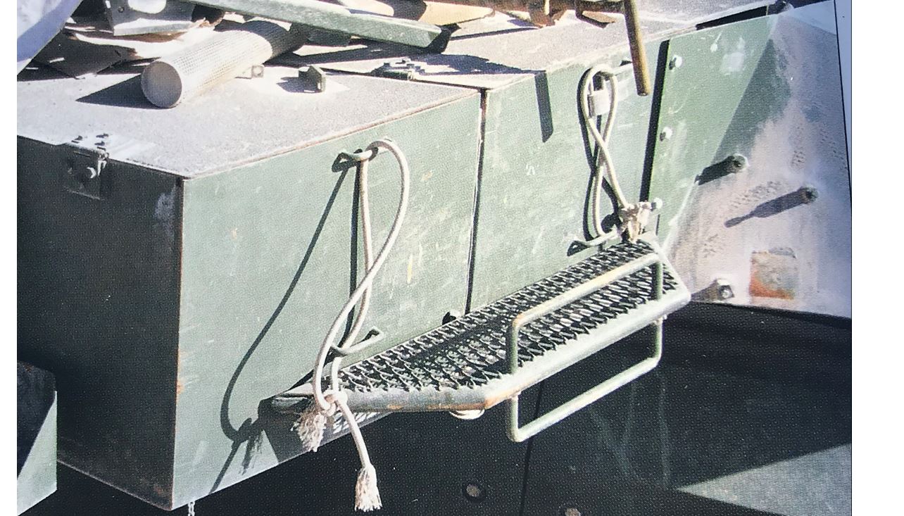

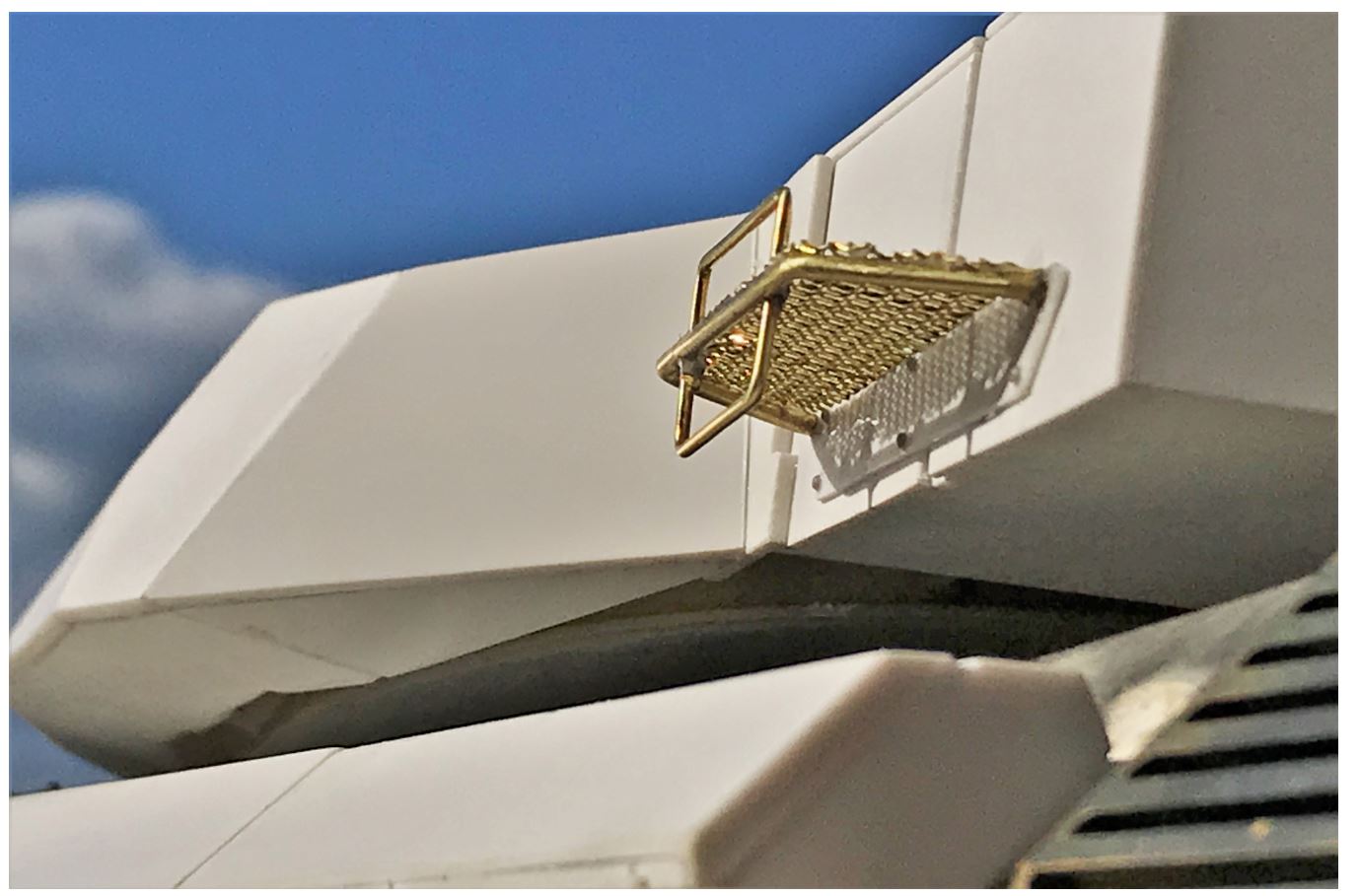

The is an intricate rack on each sides of the bins that need to be reproduced.

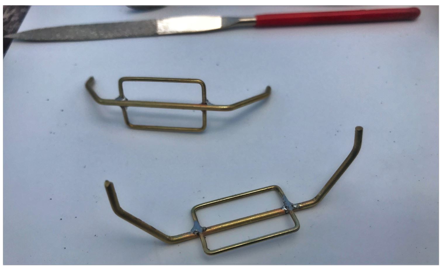

I have chosen to totally reproduce them in brass with strong anchors going into the turret. These are the frames being soldered.

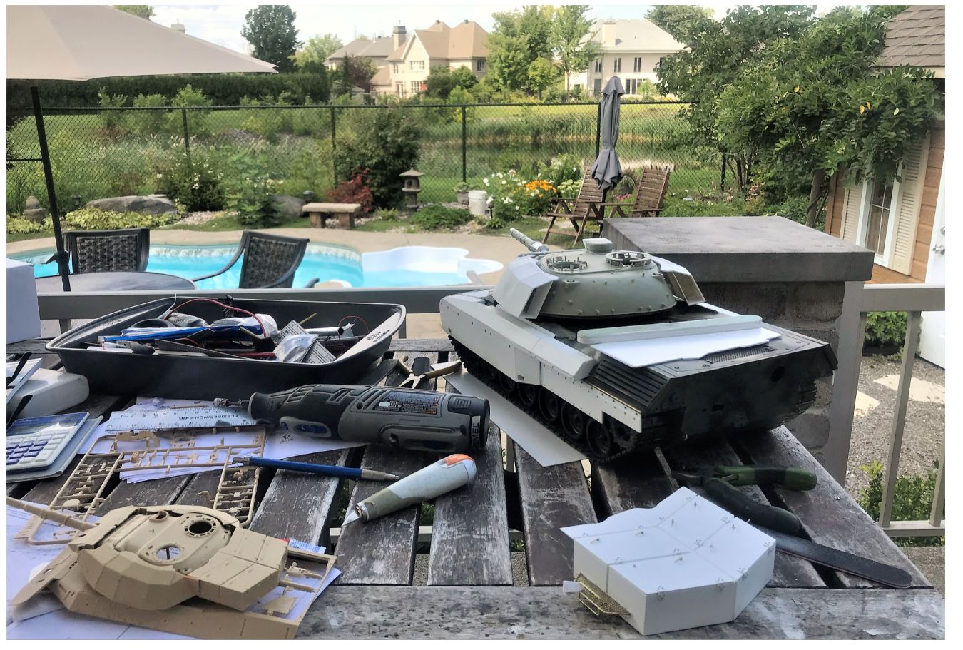

The Canadian weather this summer allowed for all the dirty scratch building to be done outside on all my builds, with the sanding done in a nice warm breeze, and cleaning the deck with the water hose. However, the wife complained that her gardens are full of white plasticard strips residues, superglue tubes and melted plastic balls. I had to establish some garbage management process.

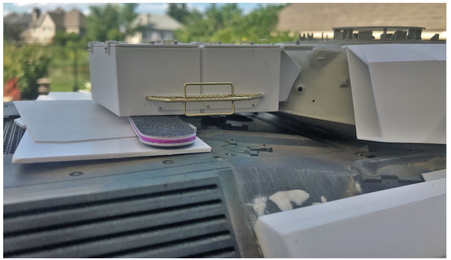

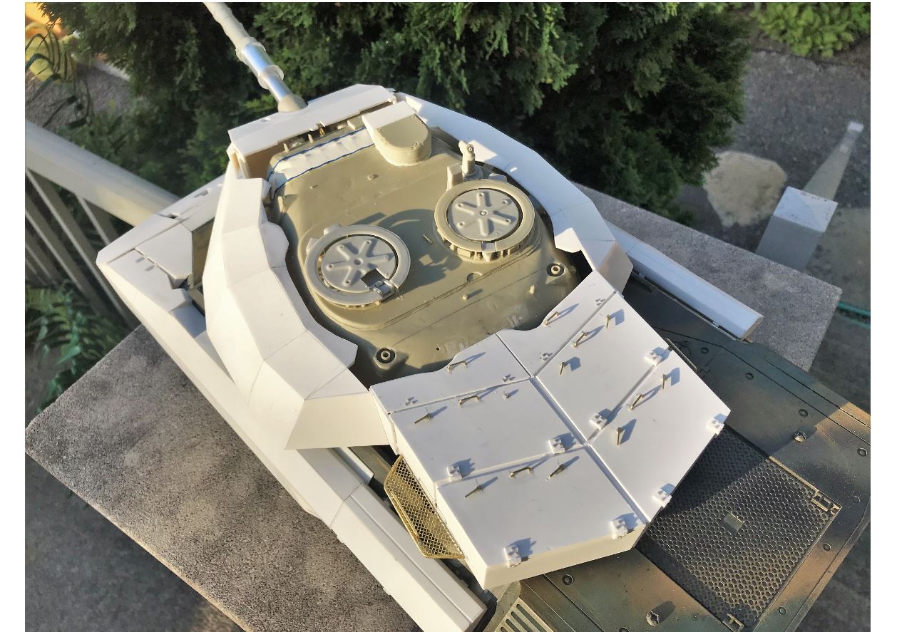

The mounting of the rear bins is tricky. It needs to be at the right height and position.

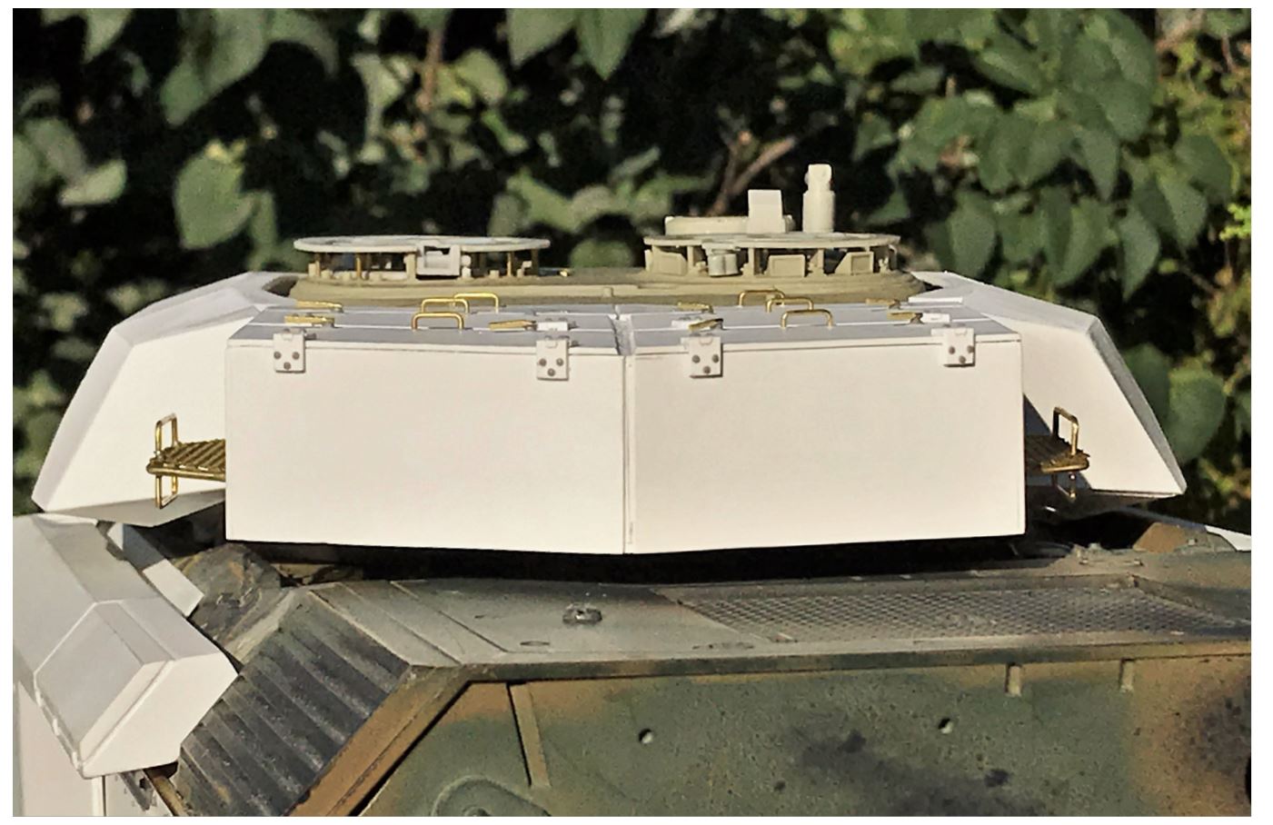

Thanks to the Meng kit and some ability on my part, a miracle occurs and the rear bin module is integrated very easily with the Mexas side armor. The linking is perfect, as per specs. The parts that bridges the two bins and Mexas are created and installed.

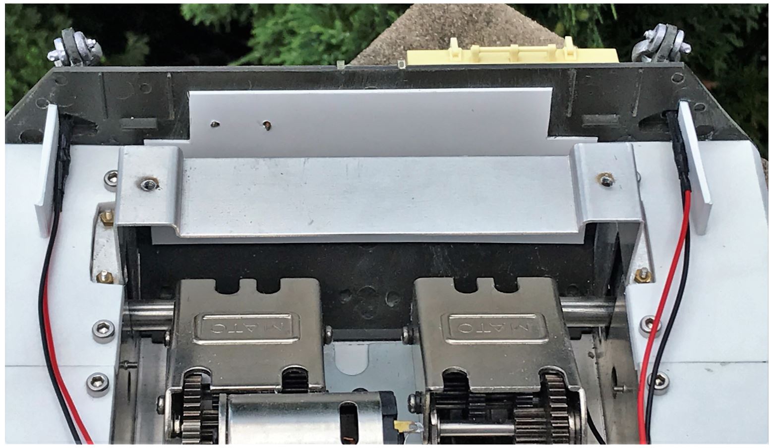

View of the 3 attachment points. They were made in solid 3mm polystyrene for RC purposes. The underside of the bins was not detailed, not worth it.

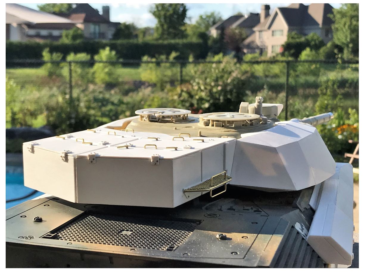

Close ups on those side racks

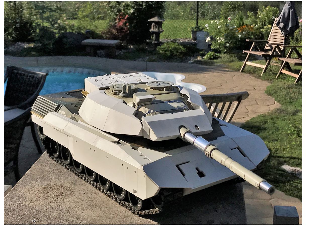

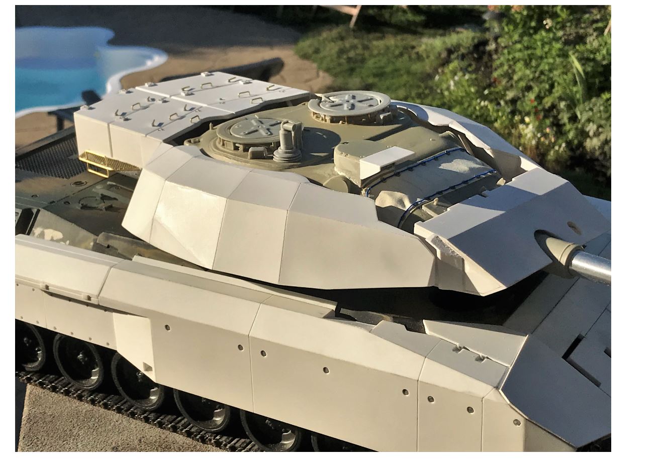

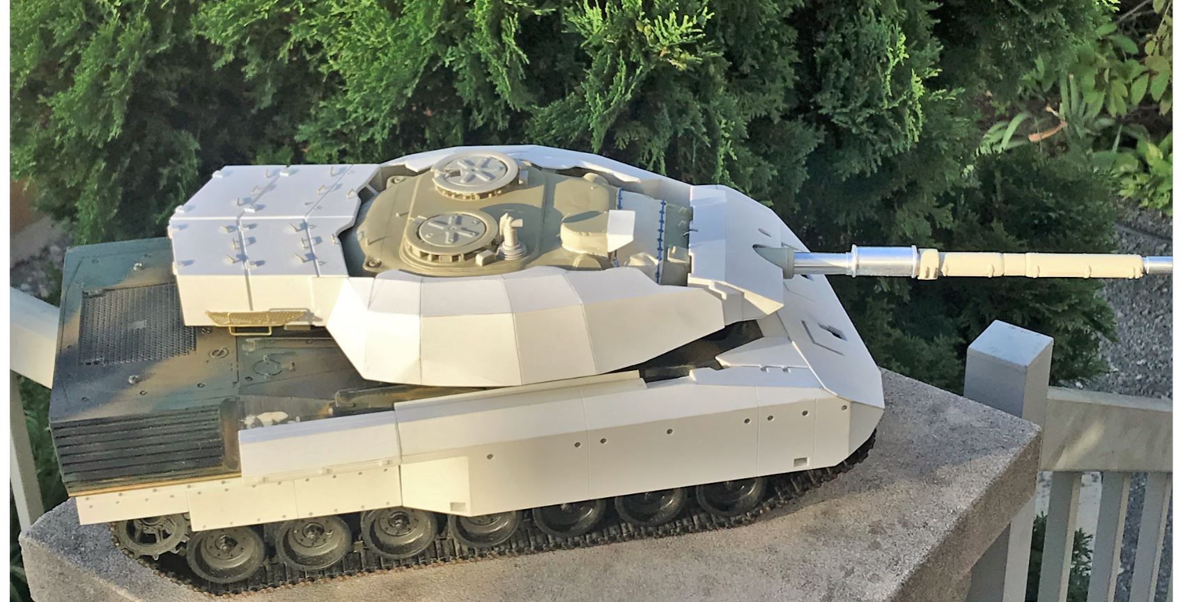

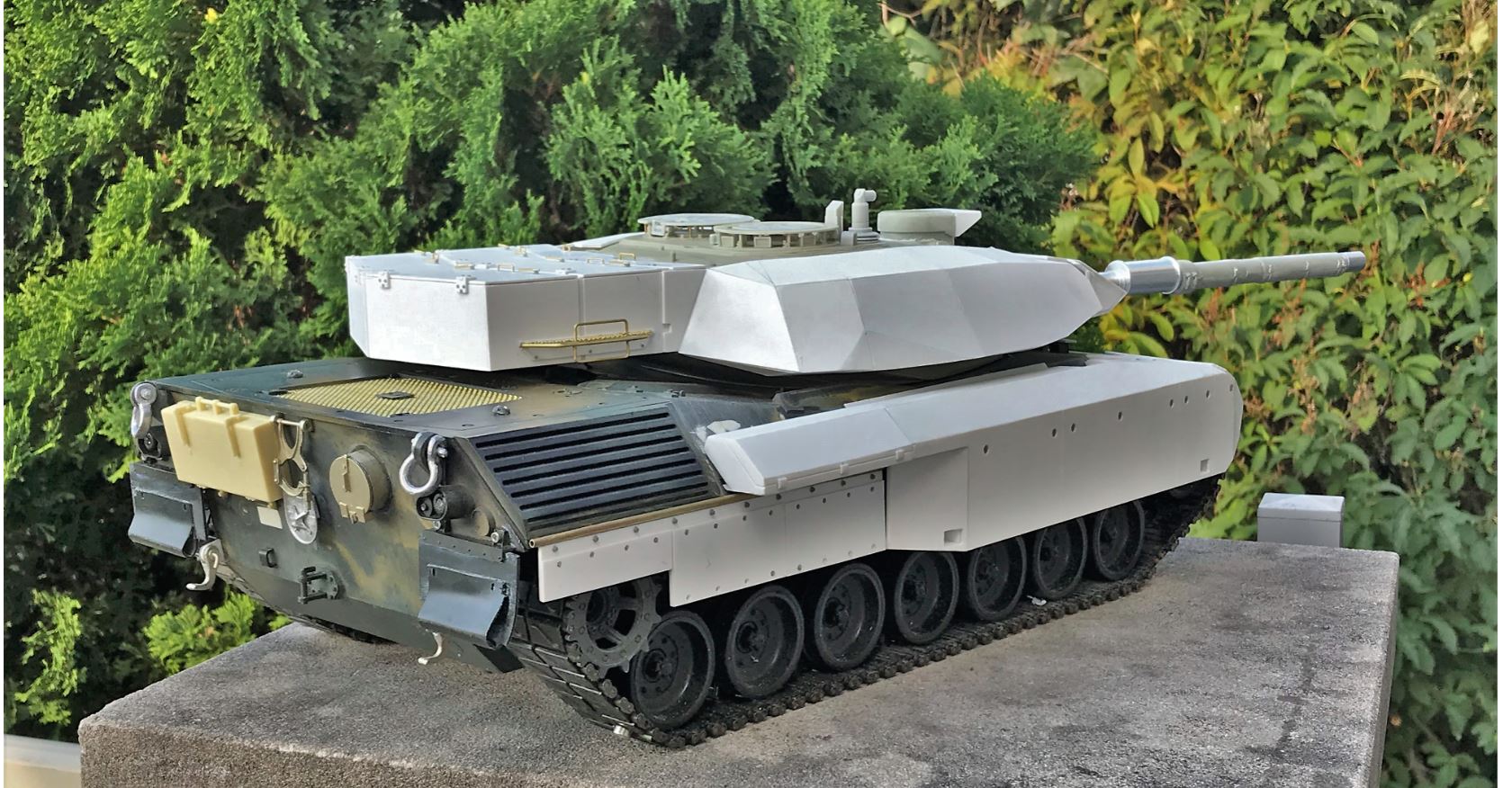

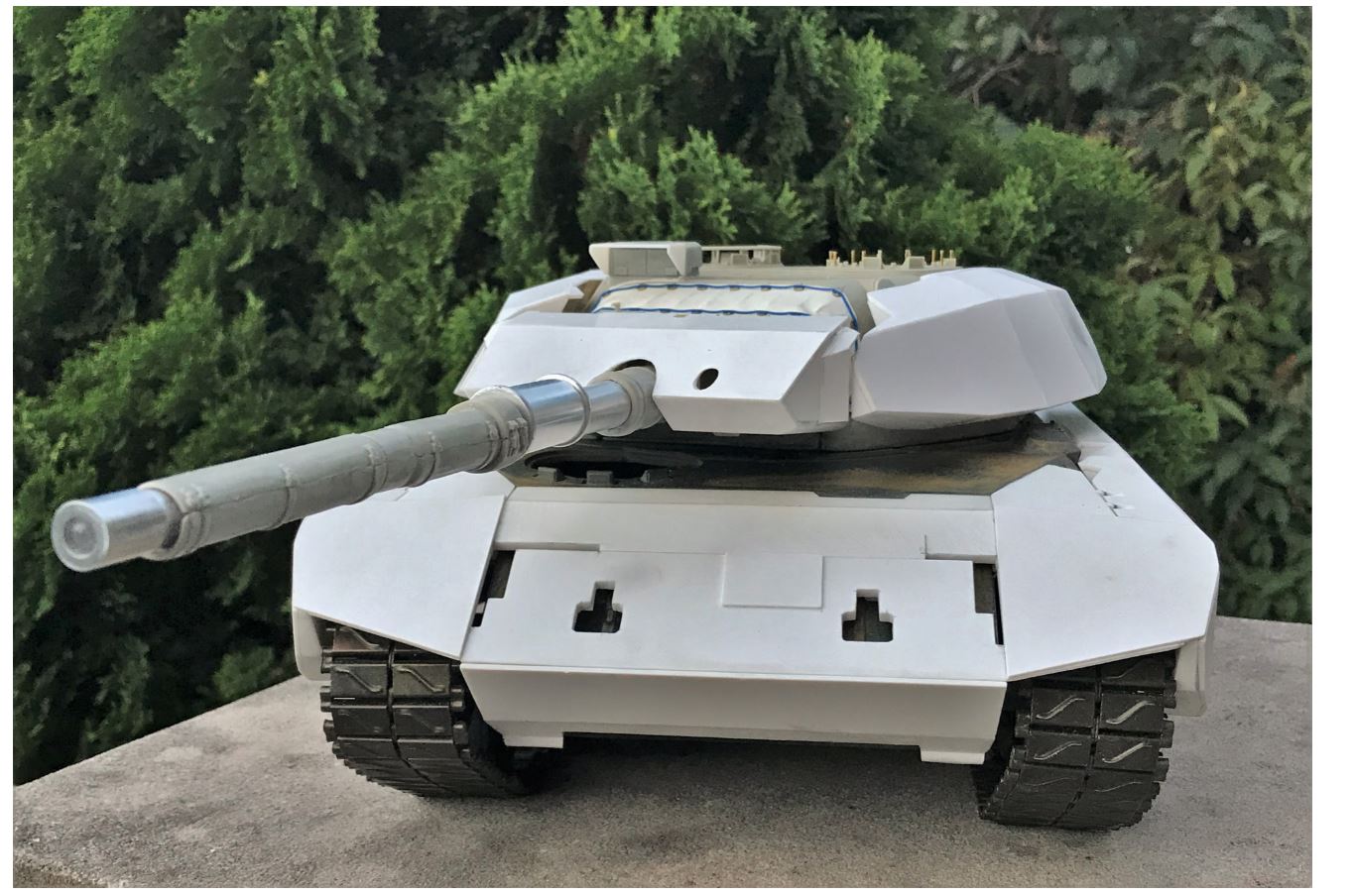

Overview of the model as it stands today. I have added some of the turret details. I am pretty sure a Leopard C2 with its completed Mexas core is a rare sight.

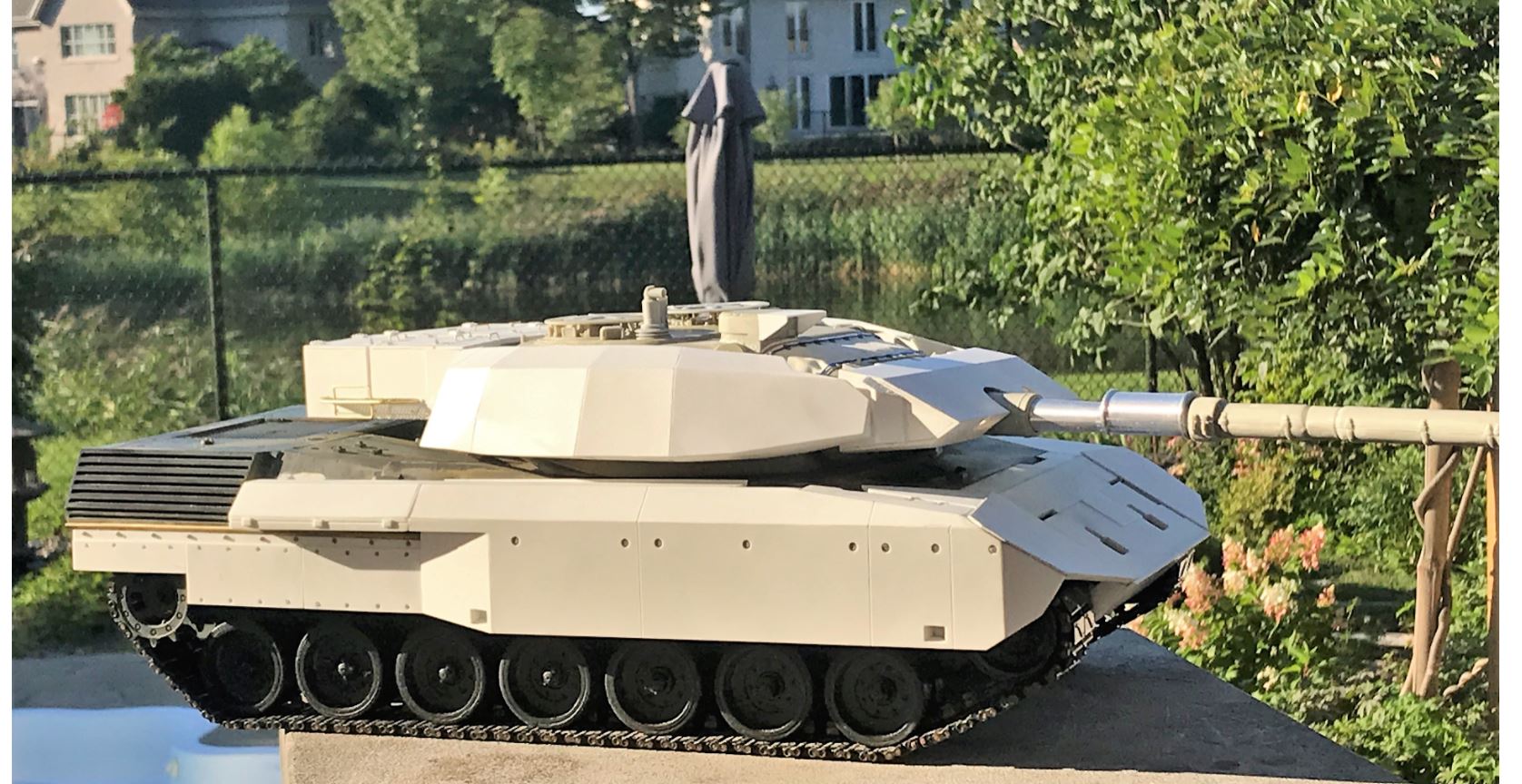

It hard to believe there is a Leopard 1A5 underneath. It would be a shock to the previous owner of the 1A4 to see his tank now.

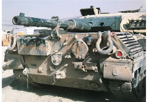

This post is for the rear plate.
As seen in the book Leopard C2 Mexas in Afghanistan, this is the typical configuration with folded mud guards, greatly oversized tow shackles and lots of dust. Those shackle are so huge. The rear hull mount will probably give in before that shackles breaks.

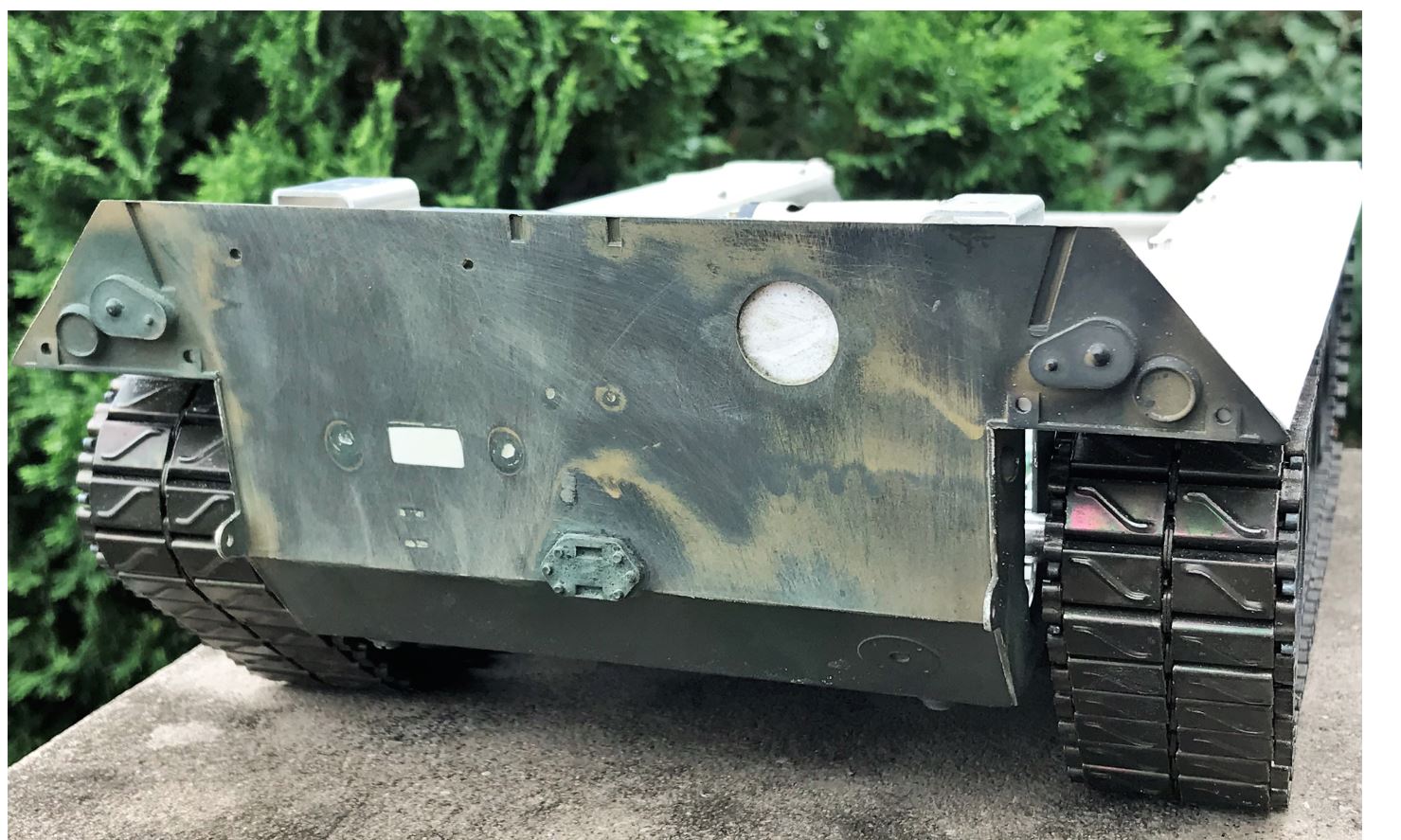

The previous owner did not install any items on the rear plate. Its better like that. I found the Tamiya plate to be a bit thin so i reinforced it with another 1mm layer inside. I also plugged the holes for the switch.

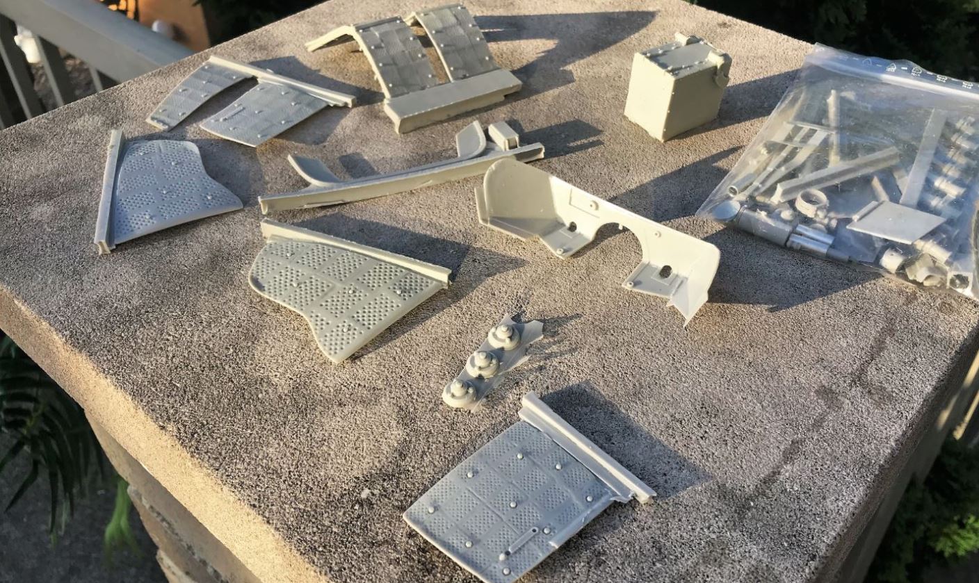

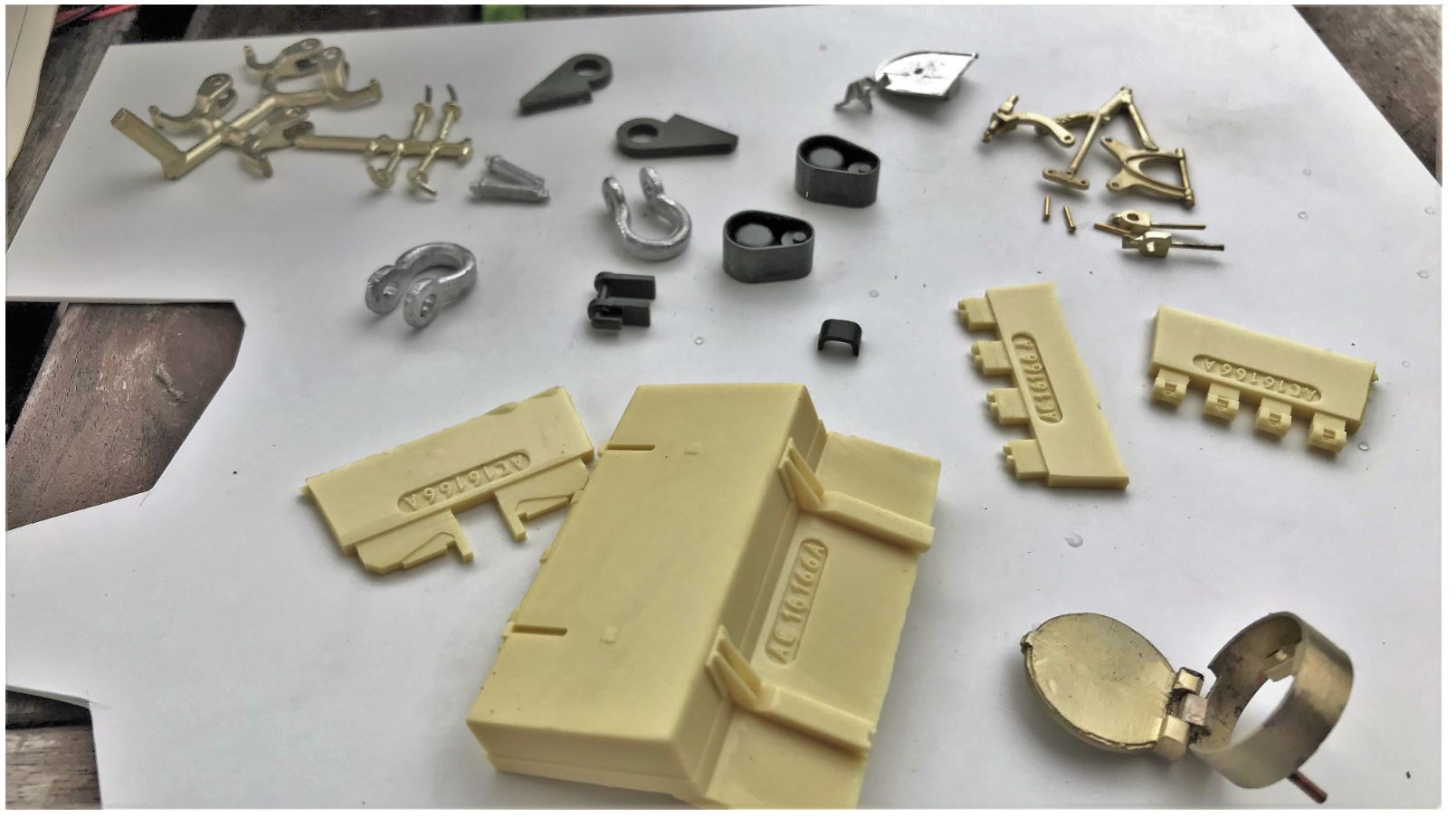

These are the parts gathered for the rear plate. It include AFV-Model items for the tow hooks, gun travel lock, resin tool box and telephone box, with some Tamiya originals that were available on the sprues, and shackles from Dioramaparts.

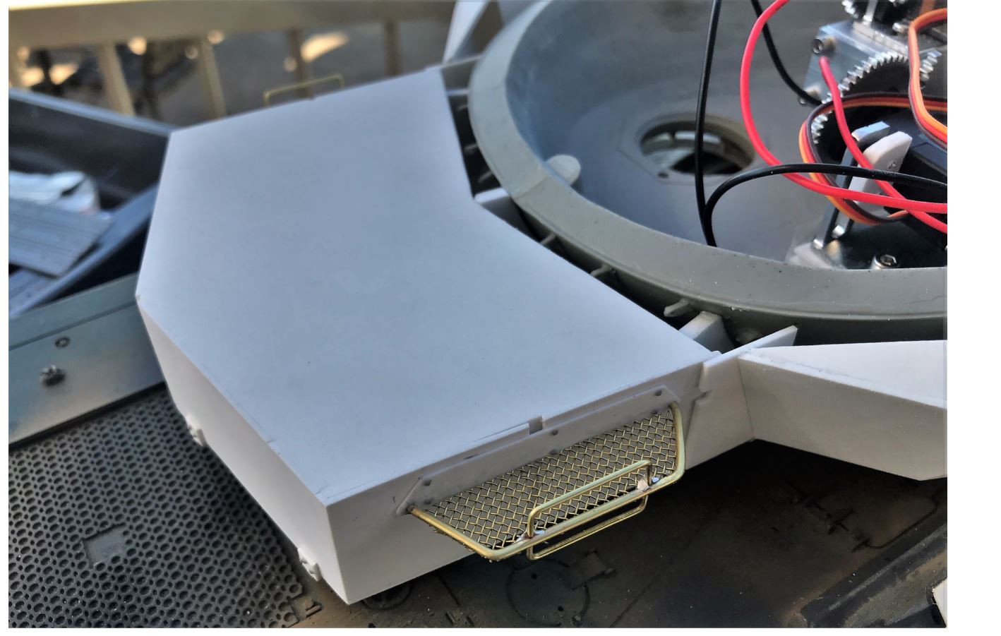

Building the rear plate was uneventful. Only the spare tracks remain to be installed and will be added once i am at that stage. The shackles are not big enough, but these are the biggest i could find. However, they seemed to be of better proportion for the tank than the real ones. The tank might actually look weird to most people with huge shackles seen in first picture and they would think it is a mistake.

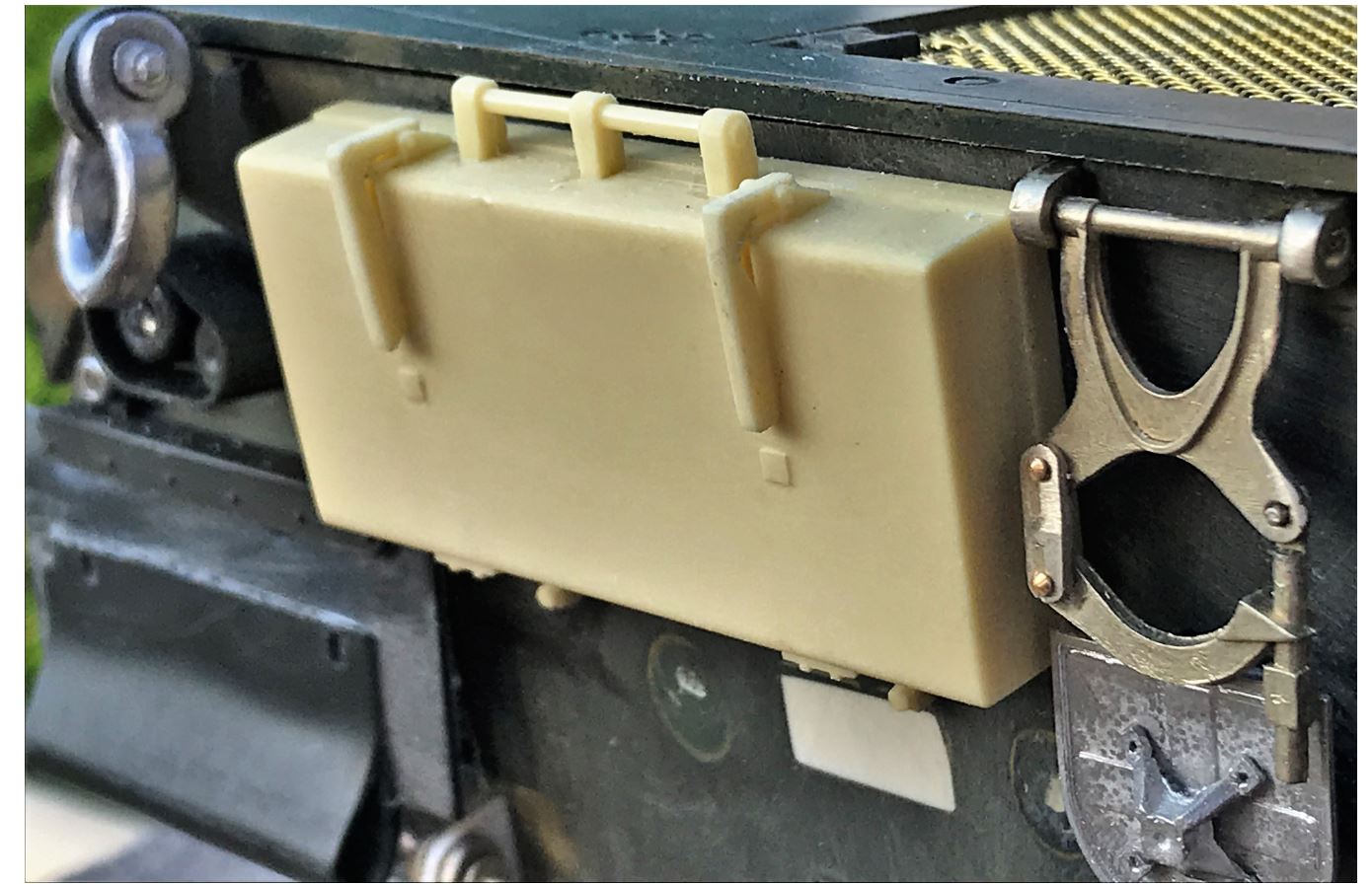

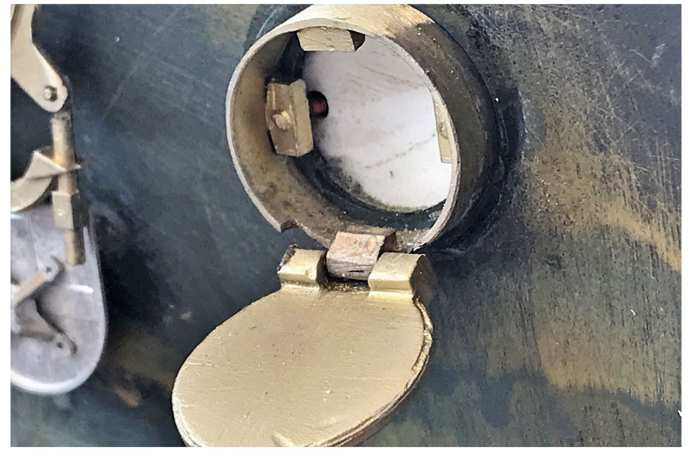

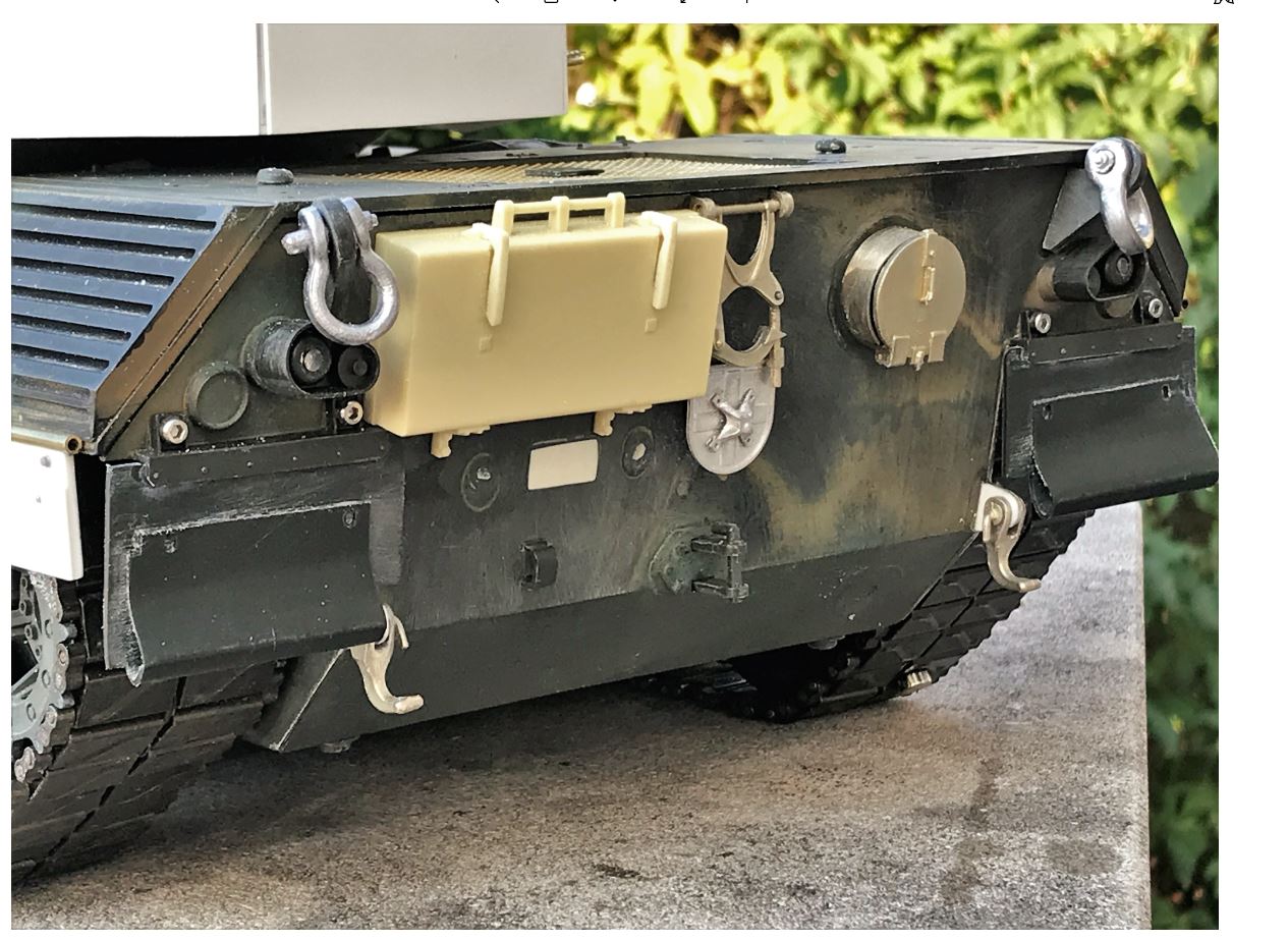

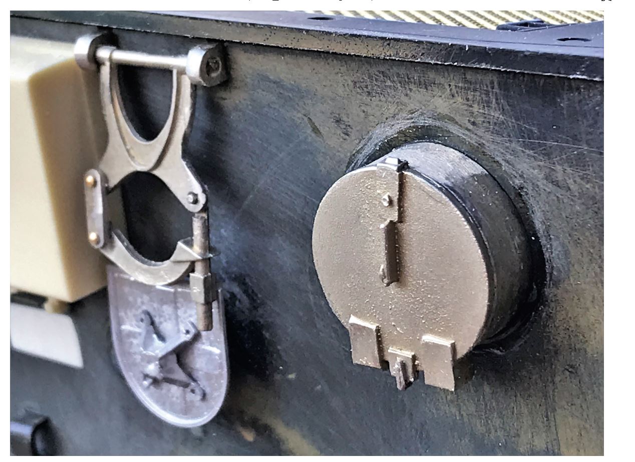

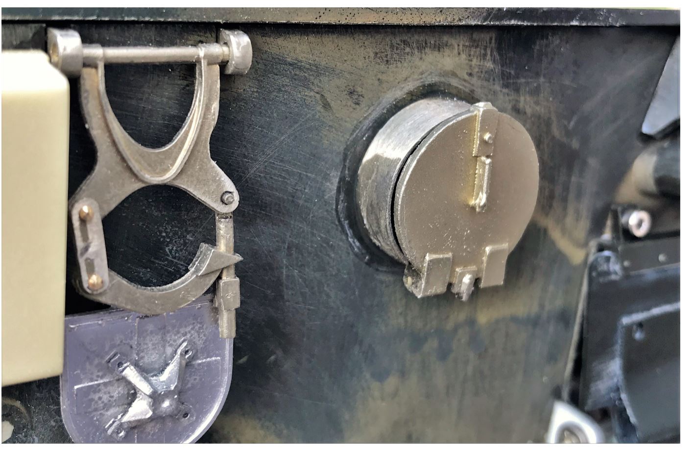

The AFV-Model telephone box is somewhat disappointing. The opening handle is molded in.
The ability to open it is countered by the fact that it does not hold in closed position by itself. In the end, with nothing to show inside and no big fan of gizmos, i ended up gluing it closed with little benefit compared to the Tamiya part.
The gun travel lock is non functional but can flip up/down. The plate at the bottom is an item i got from Ludwig for another build and not used.
The tool box needed to have its latches reworked. The provided shapes did not match references. Otherwise, its good.

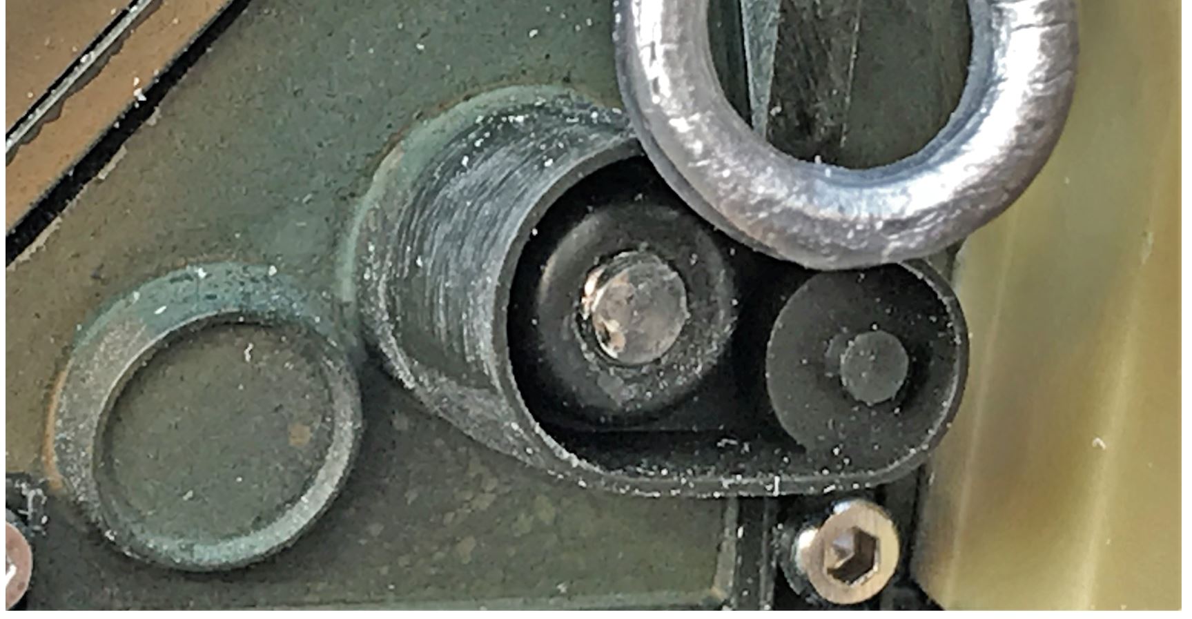

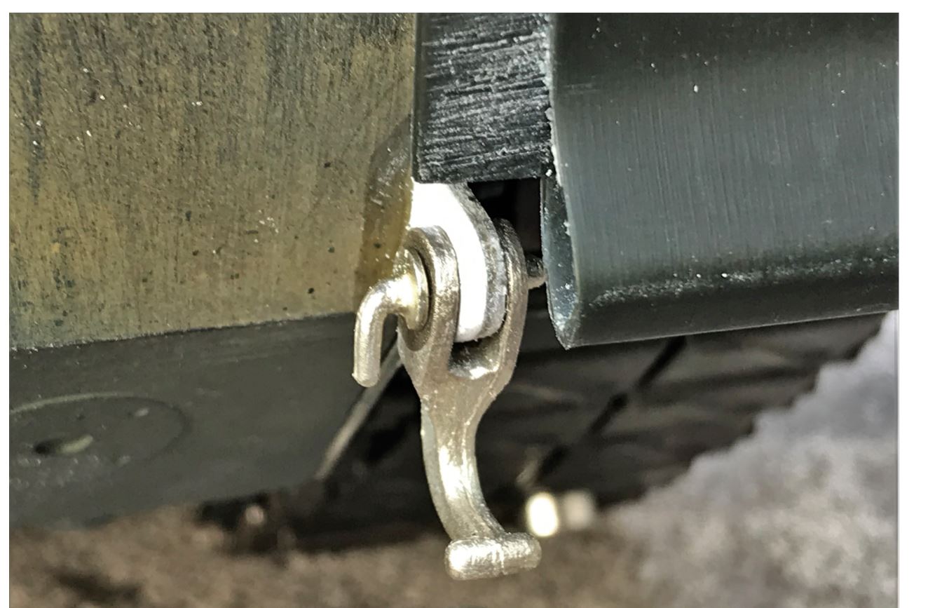

The mount for the tow hook is too thin and was beefed up with a 1mm plasticard.
