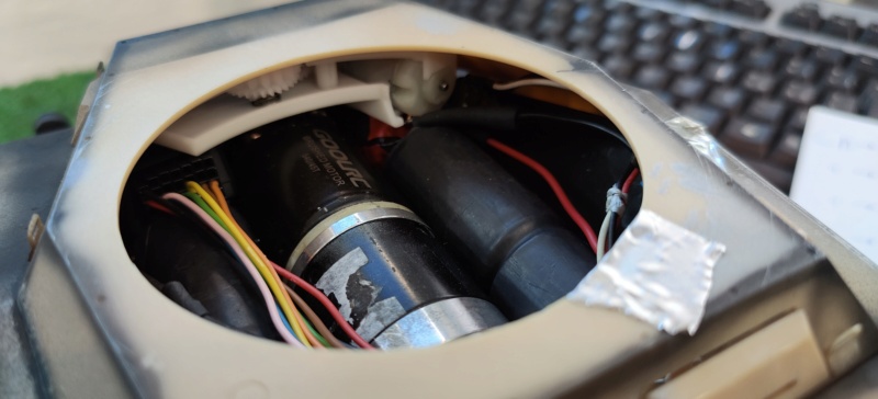

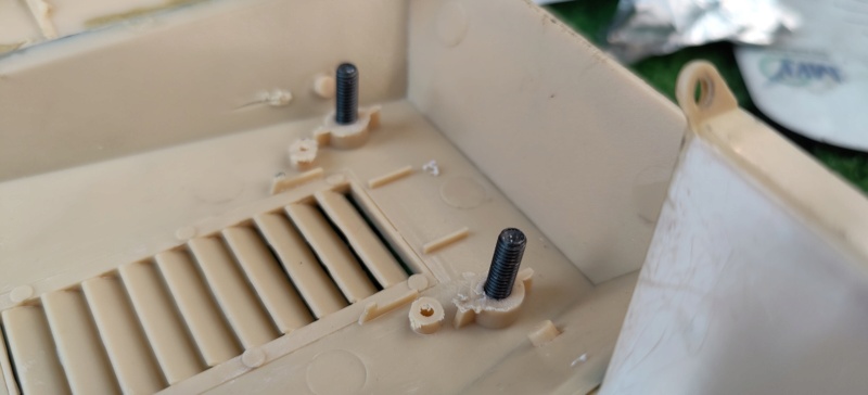

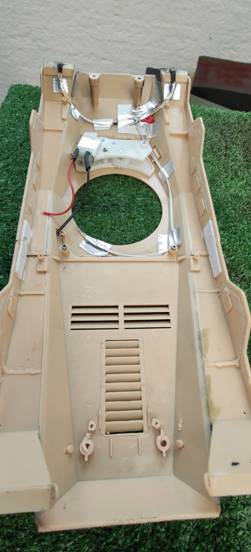

Preparation of the hull cover:

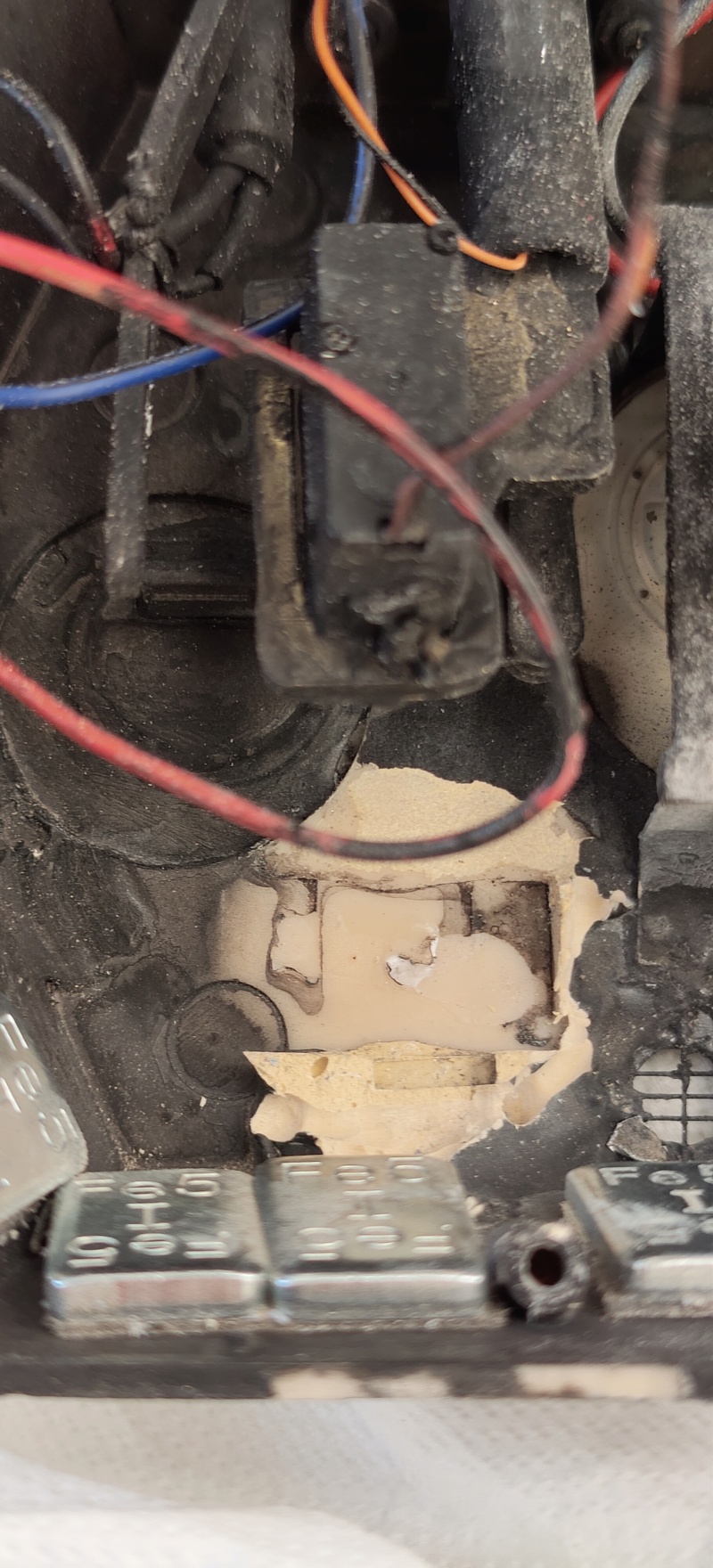

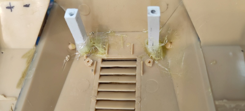

Problems are like exams ... they never end:

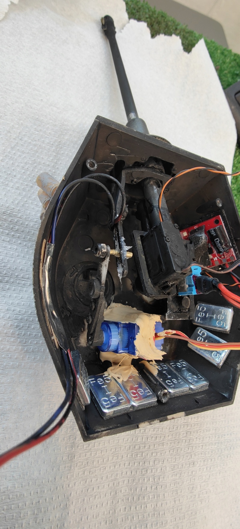

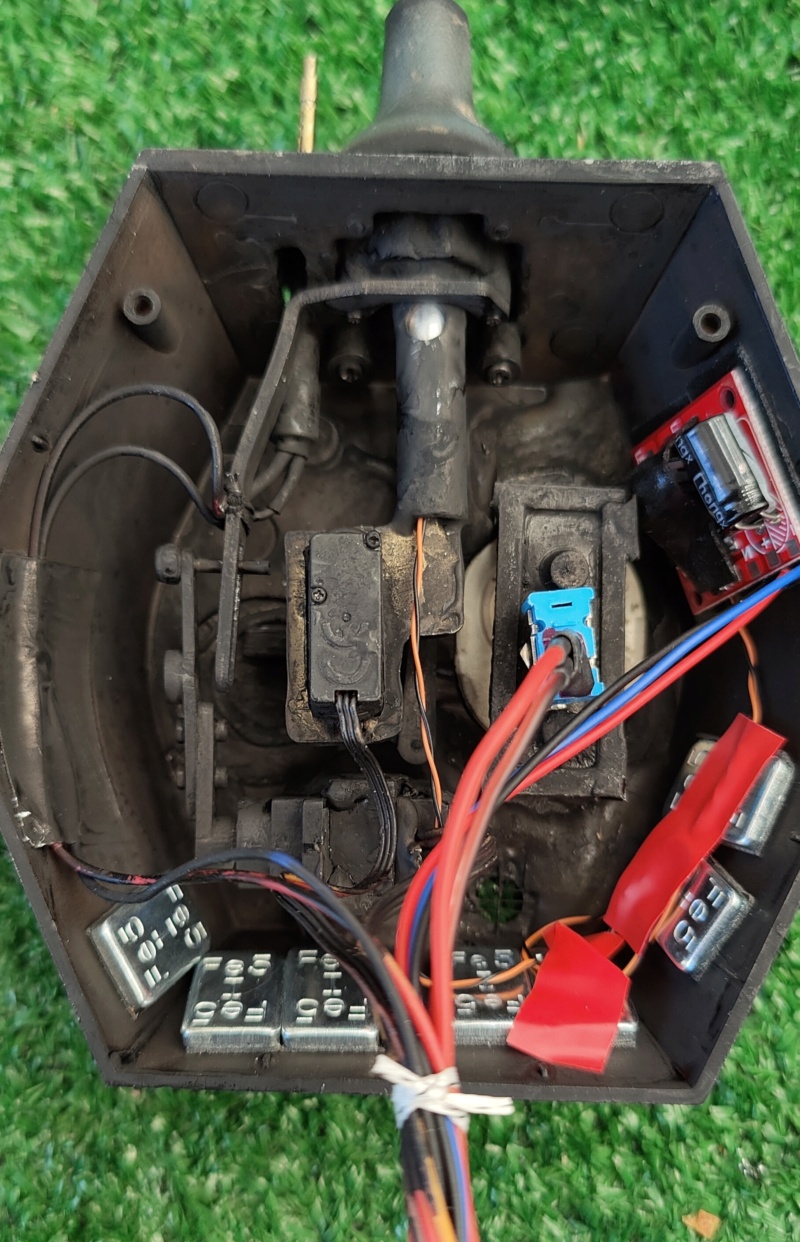

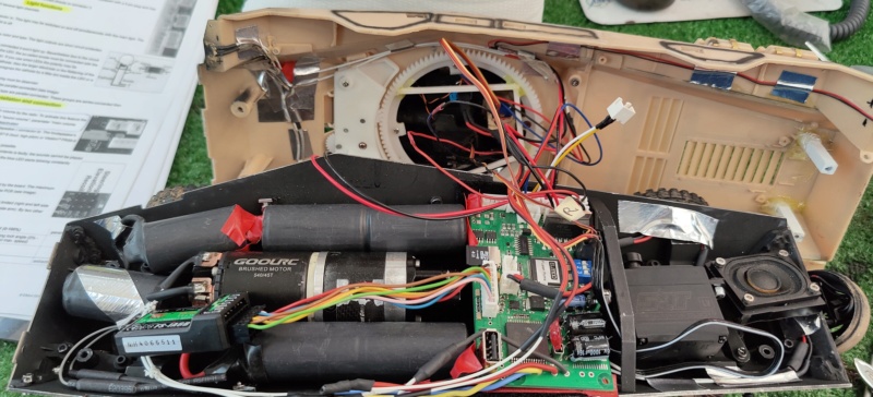

On-the-fly servo change in turret:

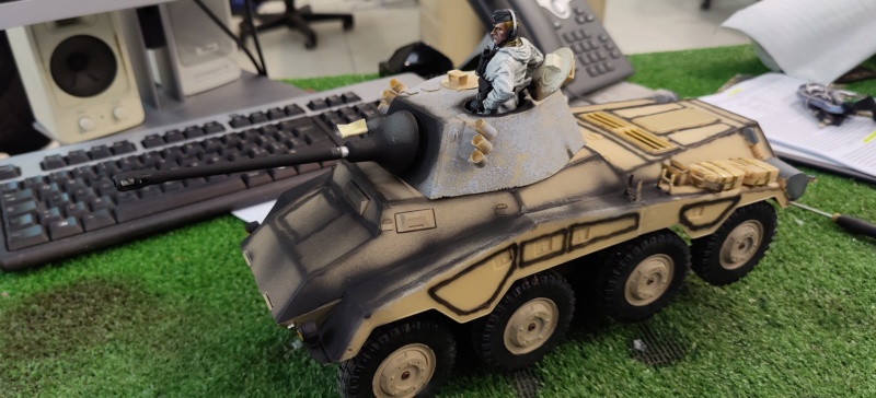

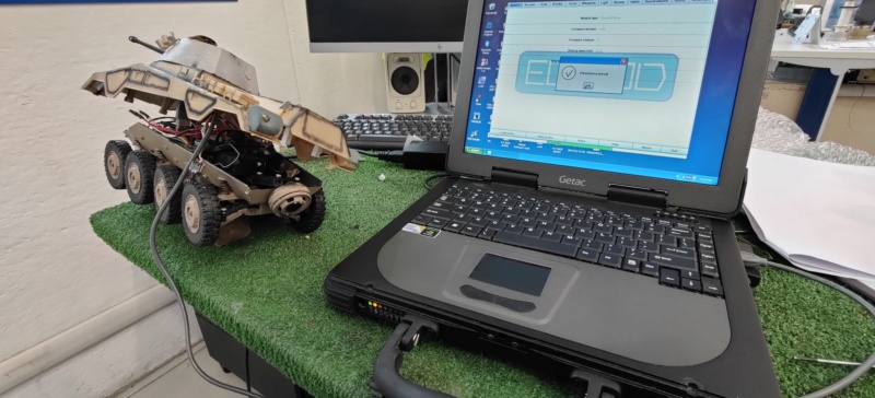

Final setup:

Met5,
An amazingly complicated model...just like the real beast! :clap: :crazy: Got to love the Elmod board! The Puma sure has plenty of grip, it climbed that incline with no hesitation what so ever! One of my favorite armored vehicles of all time...who doesn't love a good Puma?!
Nice "work space" too, complete with a helicopter! Wish I had that much room!
Can't wait to see the Puma finished and an outdoor video too!
Cheers,
Eric.

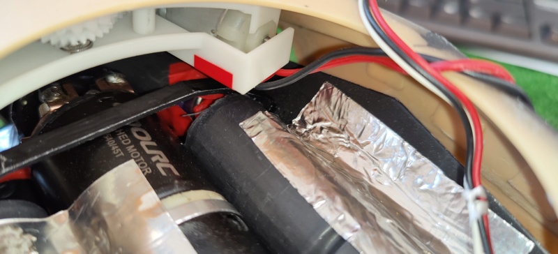

It's been 16 days since the last posted. The turret was operational, but it didn't entirely satisfy me. The bat-mounted elevation servo suffered when he had to bring the barrel back to the full down position .... The barrel only returned (with a jolt) to zero lift after the shot was fired....
Maybe no one had noticed, but I did ....
Changed the servo, eliminated the interference on the digital controller caused by the unfiltered motor of the rotation unit, argued with a hull cover that twisted and blocked the turret, almost killed a battery pack for having moved an element and installed it upside down ... .
Finally a configuration that satisfies heart & soul:

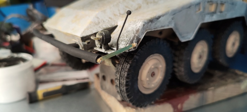

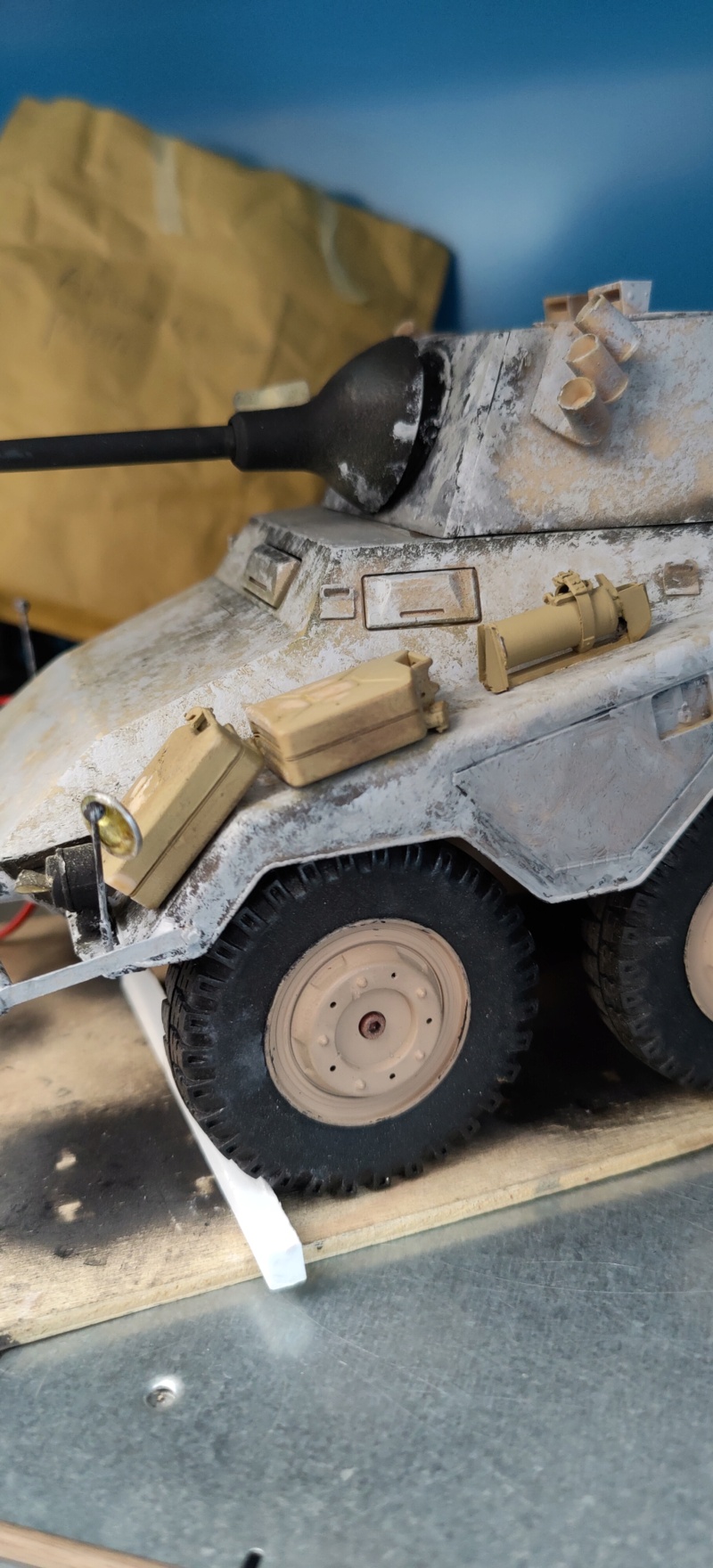

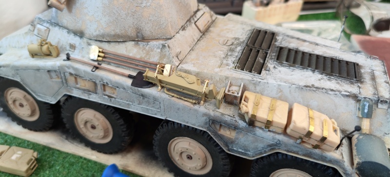

Meanwhile, the sheet metal is prepared for painting and the front bumper are installed:

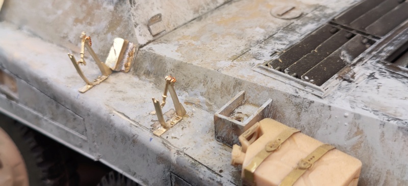

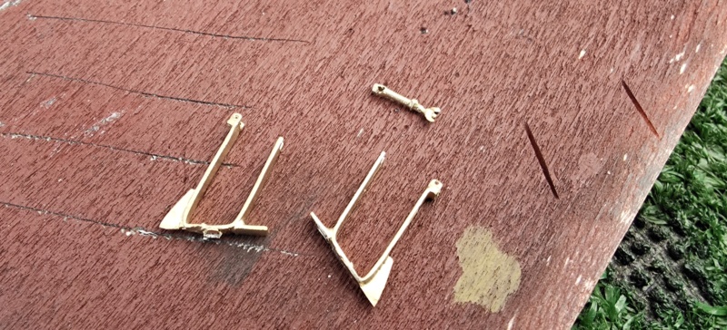

Now let's start with the details of the Puma, it has infinite details so it will be an endless job:

Wow,
When you said infinite details you really meant it! I really like the looks of that Puma! She's going to be a stunner!
Great work! :thumbup:

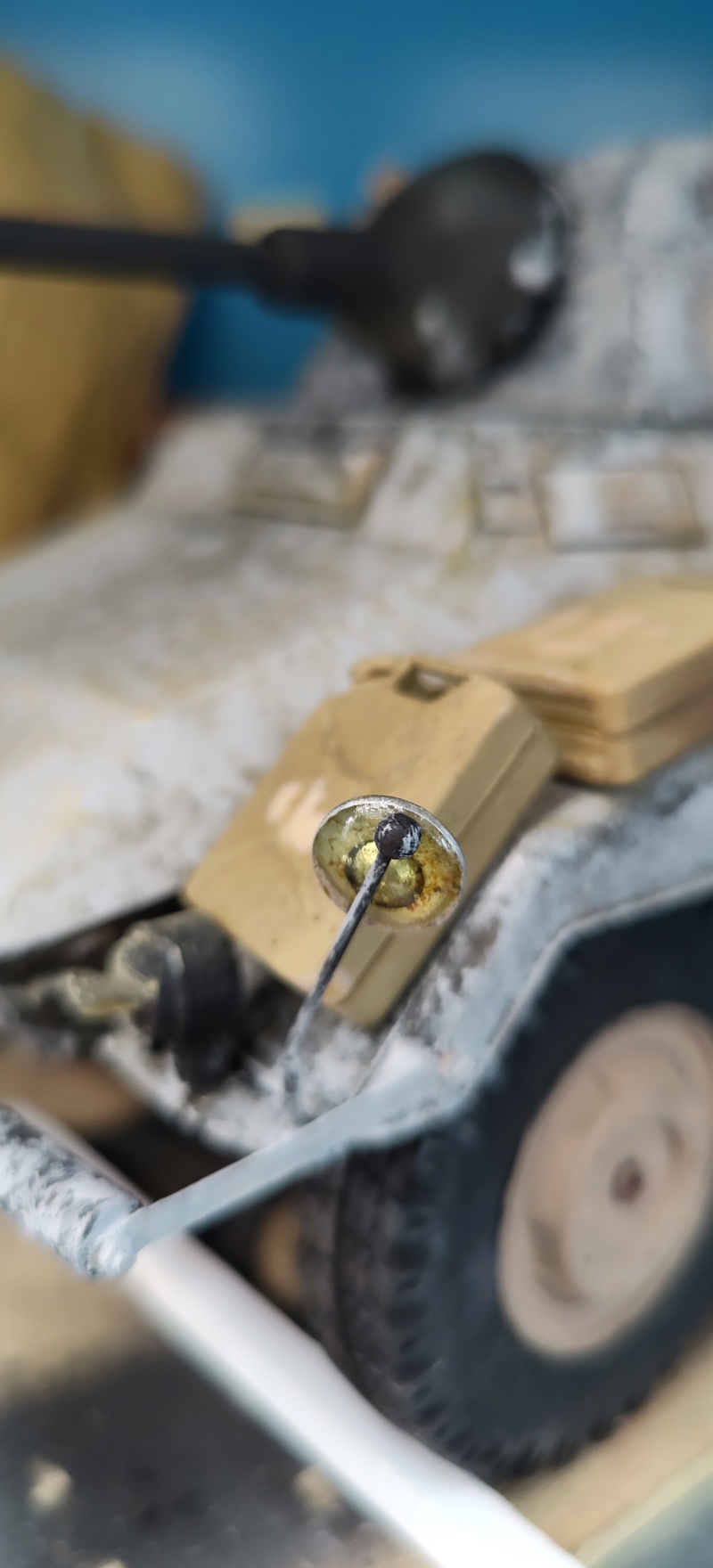

Re: Puma Sd.Kfz. 234/2 Metal Origin 1:16 WIP

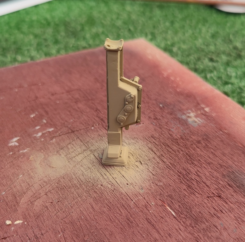

Post by jhamm »

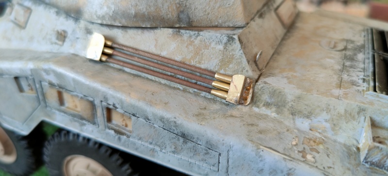

a funny little detail :
