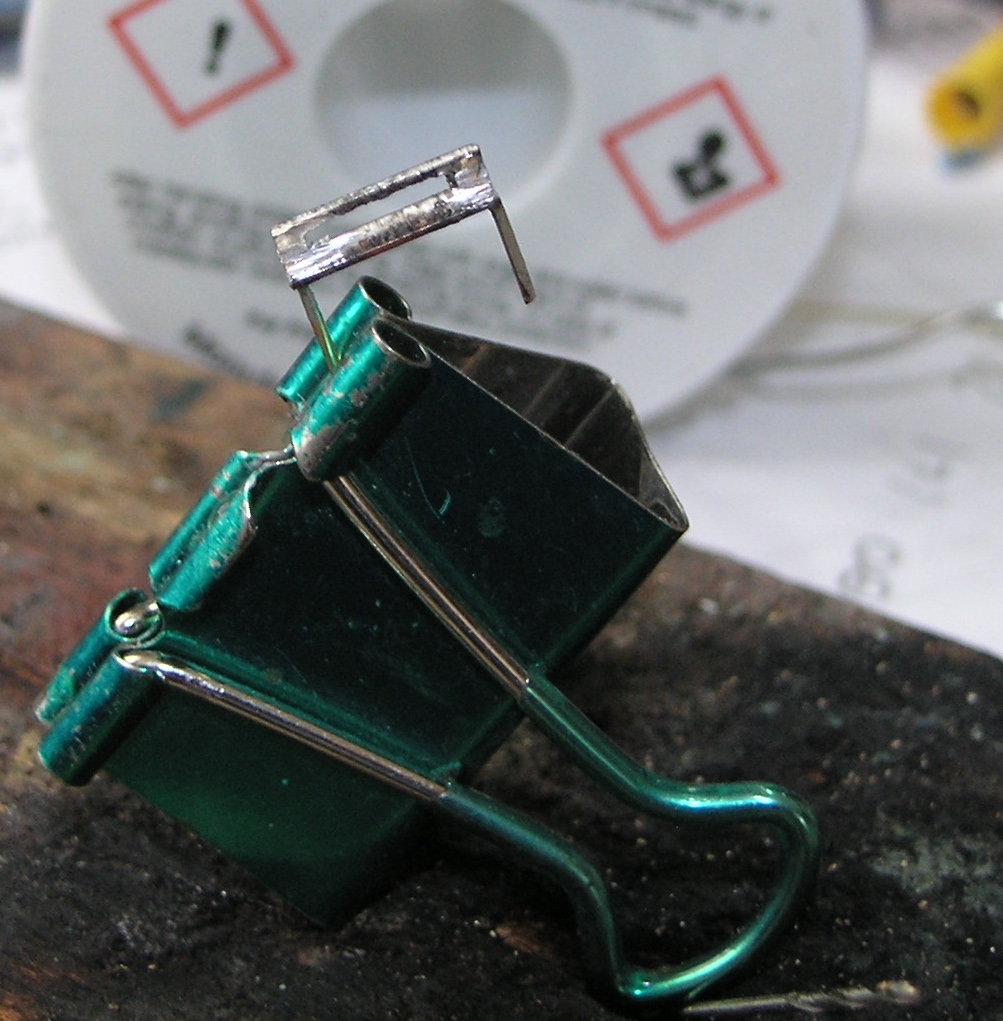

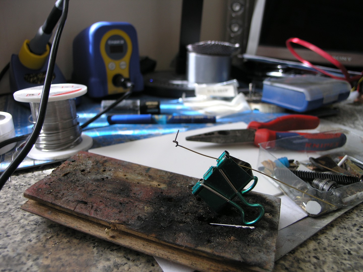

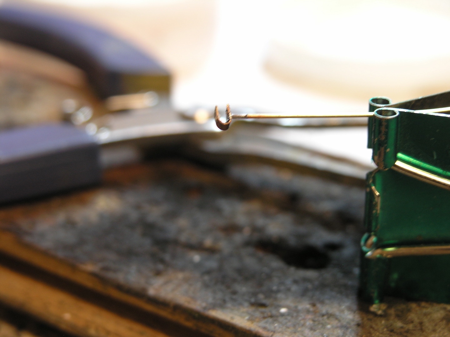

Onto the track puller cable hangers, copied the sizes from the KT's
Brass stud to fix
Brass stud to fix
the fixed end for the loop
The adjustable end, small nut and bolt to go in the slot.

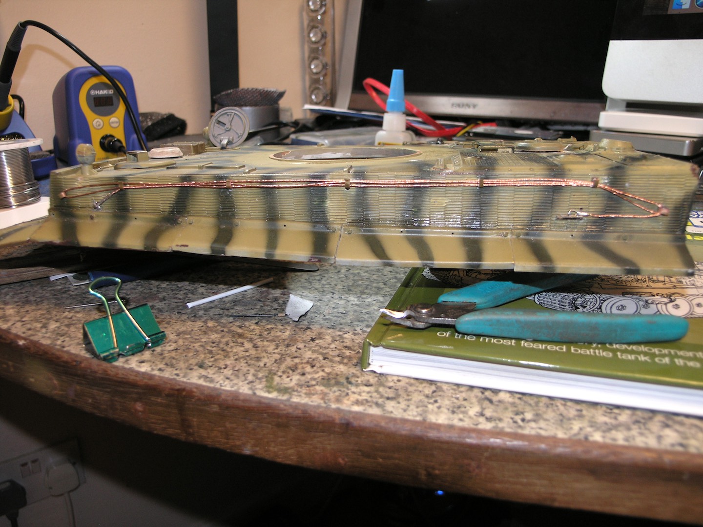

1st go at getting cable correct length, just too long.
1st go at hangers, cable is too long and some hangers need adjusted.

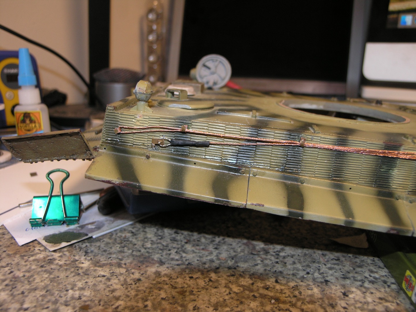

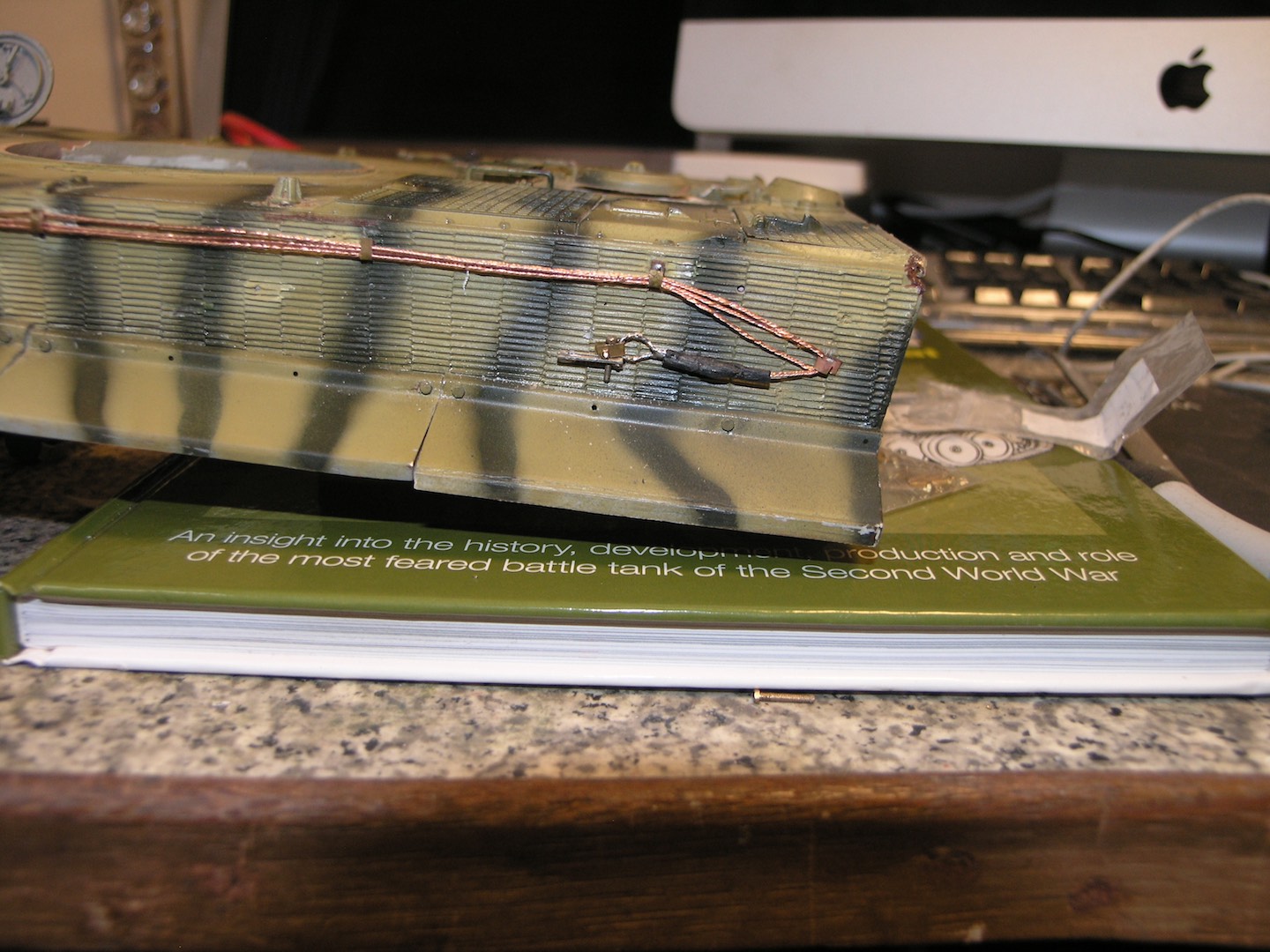

Cable fitted clamps made but don't like the cable ends , need to find out who sells them.
loop and crimped end not very good.
At least the adjustable fixing is ok.

I did mine with a section of aluminium tube that had the cable ends inserted & then crimped with a small pair of pliers.
The profile of the pliers made a fairly uniform crush on the tube & a bit of a file & sand, jobs on.
Your adjustable termination end is very cool. I omitted mine, and its too late to go back.
