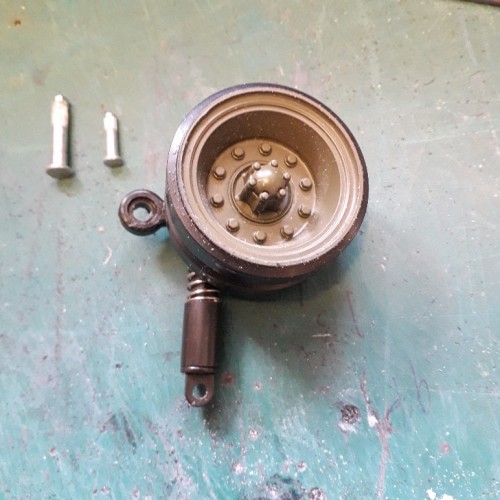

Thought i would describe the running gear i used for this build.
I decided to raid my spare parts stock as to keep the build as a more of can i do it with the spare parts i have and scratch build the rest, excercise.

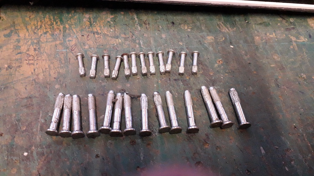

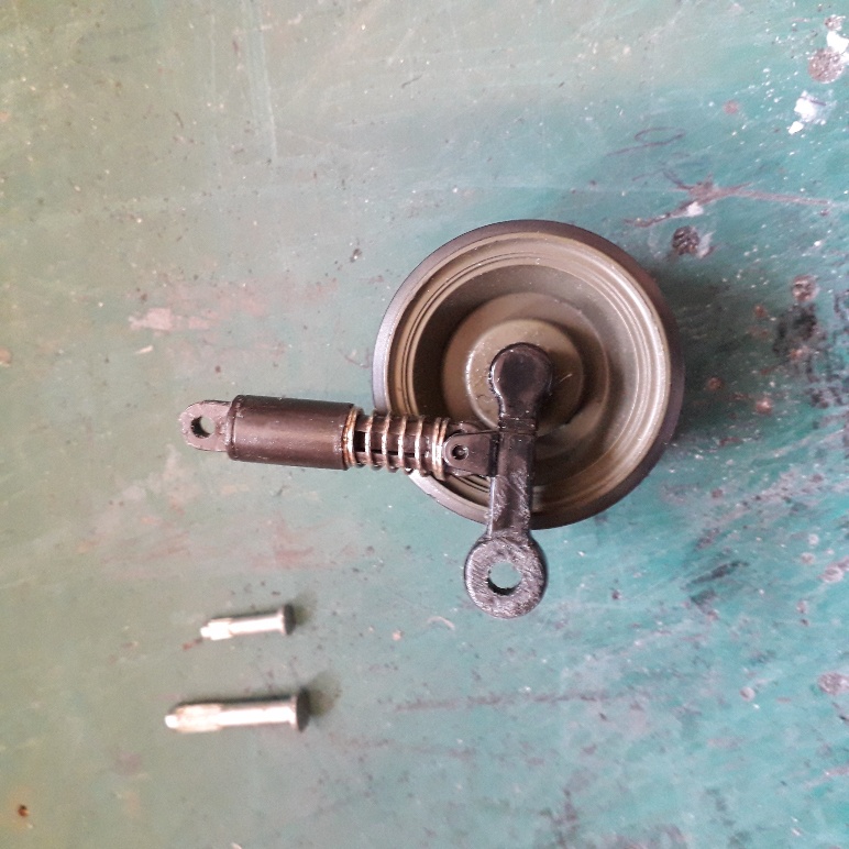

I located 2 old Heng Long scrap Walker Bulldog (appropriately ) lower hulls as i wanted to use a suspension system that was light compact and easy to adapt , i am very much a Keep it simple kind of person, less to go wrong etc.
I found that all the wheel and suspension and damping assembly was all located together and with the removal of 2 studs per wheel it should all come apart in tact so off i went trying to remove them.
After much deliberation and failed attempts i managed to remove 1 wheel assembly in tact, this was measured and angles worked out for the suspension and tried on a scrap piece and all looked good so i worked out the spacing of the idler wheel and rd wheels etc in relation to the drive.

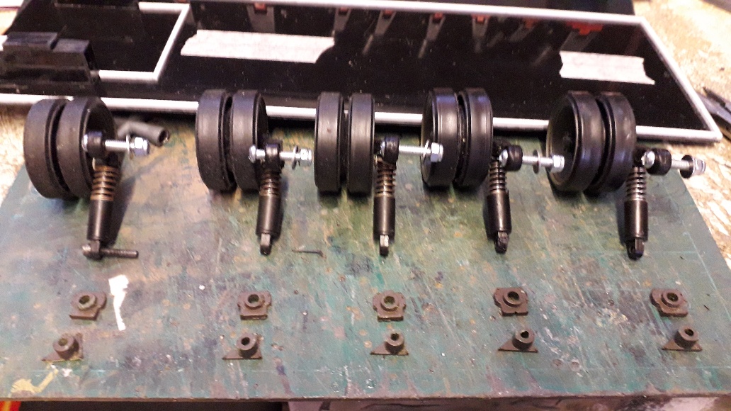

The other 9 wheel assemblies were removed this is what you get.

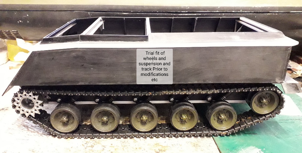

Re: British FV432/30 Bull dog

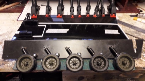

3mm machine screws were located for the top suspension mount and 5mm round head bolts for the lower suspension point all with nyloc nuts were added.
All the holes were marked out and drilled them all 5 wheels on one side were test fitted to the lower hull side.

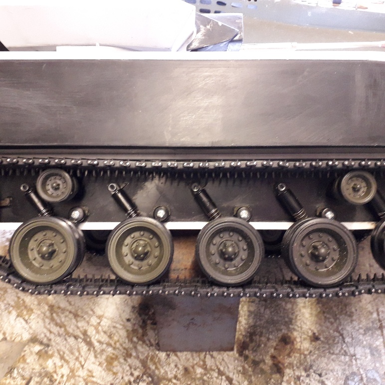

All lined up and looked right so the mounting points were reinforced with correct sized spaces and all the wheels lined up.
With the reinforcement spaces added it was all checked that the track guide was central to where the center of the sprocket would be and it was fine.
I has a pair of old Pershing sprockets that fitted the Matorro Tiger gearbox drive axle so i fitted these and again the centers lined up.
For the tracks i had 2 spare sets of HL Pershing tracks so put them together to make a pair of tracks as the FV430 is at a bigger scale of 1/13 and fitted them and they worked with the Walker bulldog wheels.
The lower sides were fitted the wheels and tracks added connected up and power applied, after a few minor adjustment both tracks were smooth and worked as if they were all off 1 vehicle most happy total cost zero.
Still got to fit the 2 upper return rollers but it worked.
The first and last road wheel on each side has stronger suspension springs to stop the track pulling up when in use.

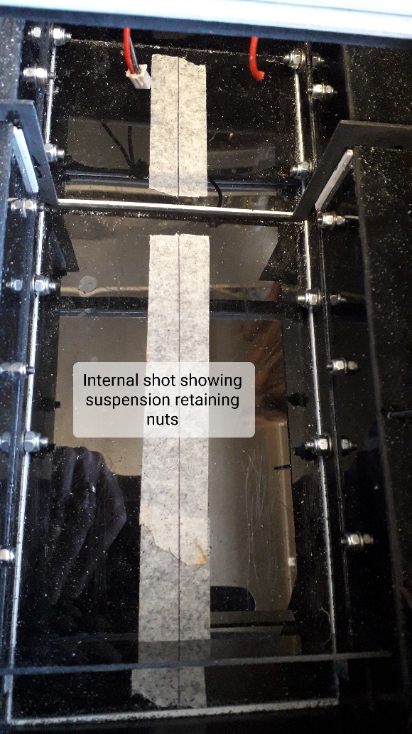

View of inside the hull of internal suspension mounting points with minimal incursion into the hull.

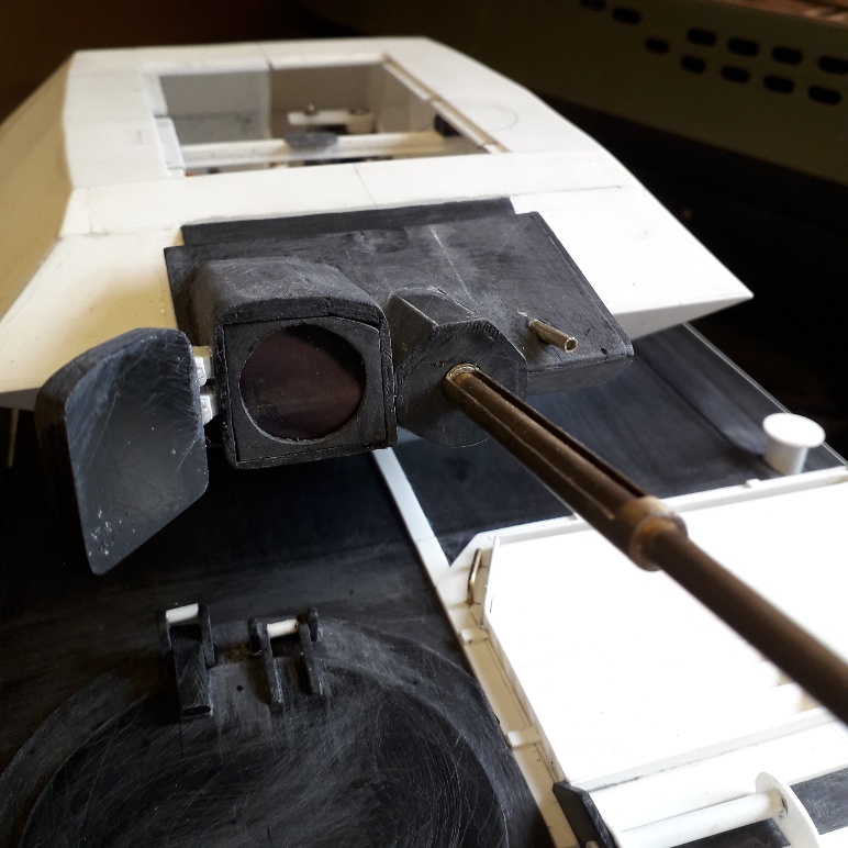

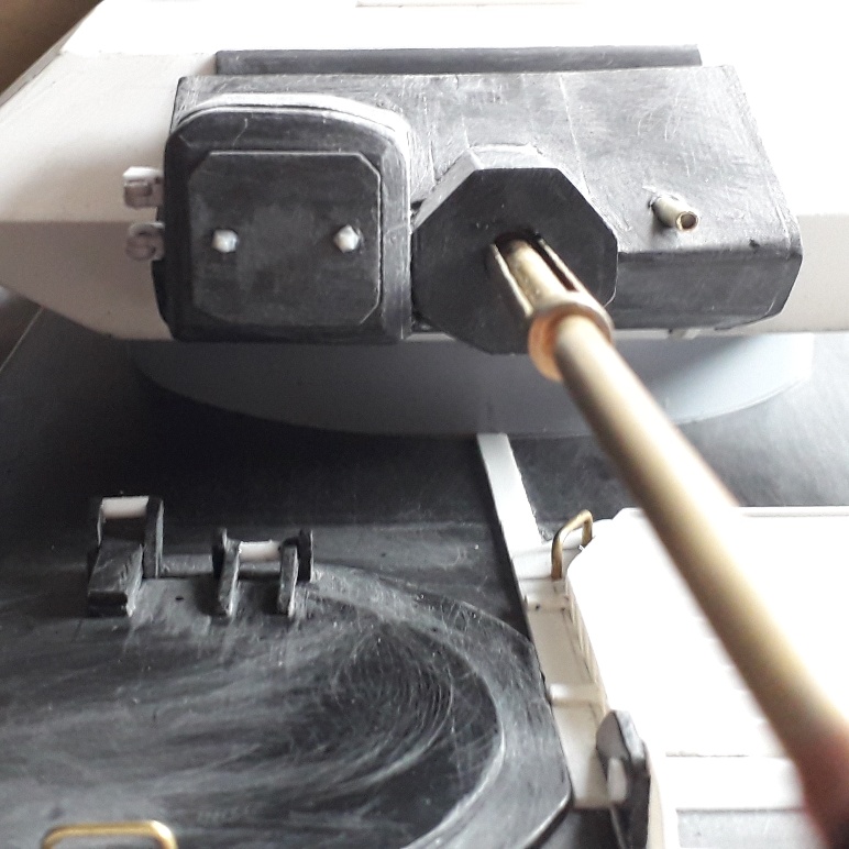

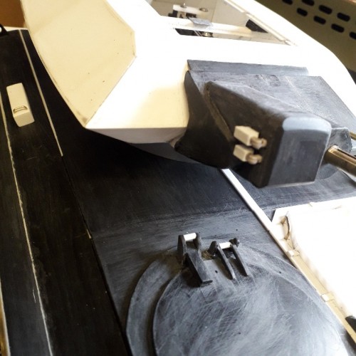

Rarden 30mm night vision optics box and opening door.
Still got to add perspex screen and wiper arm and opening mechanism.
Sub
Sub

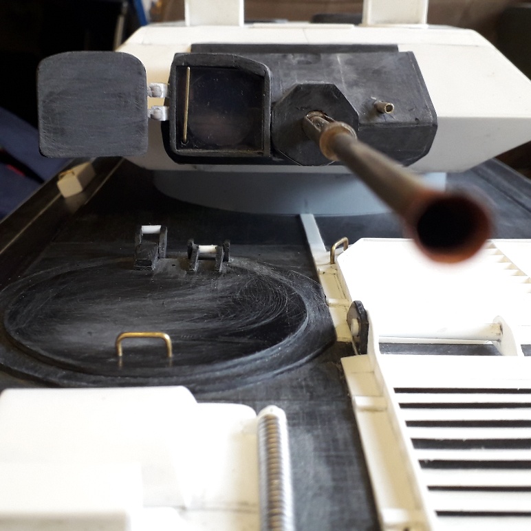

Hi.

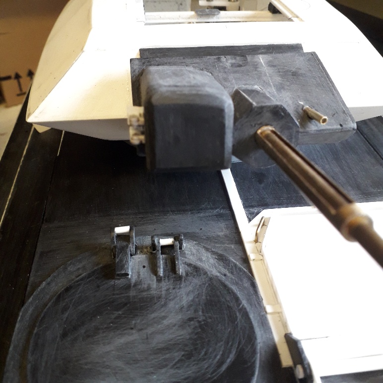

GEC- Marconi Spav L2A1 dual magnified passive night vision lense added and wiper arm.
Outer door bolt on armour plate added.
