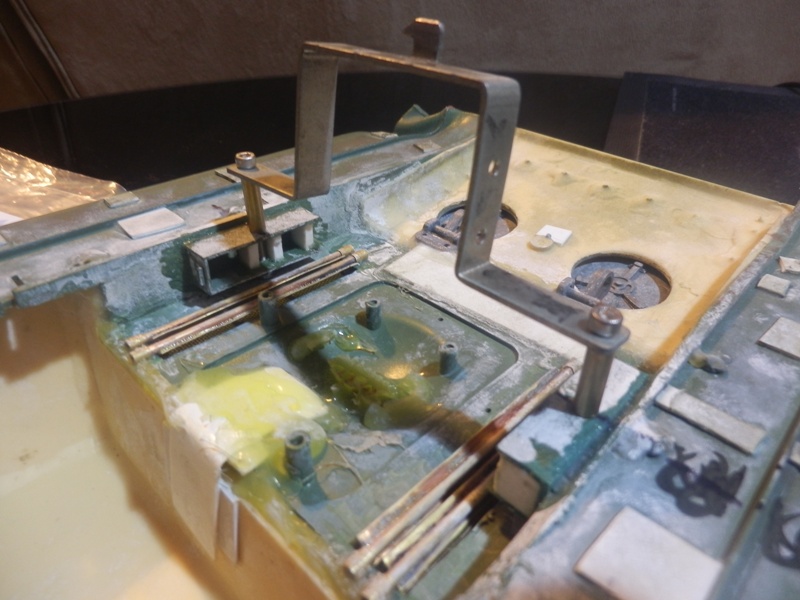

Had a win with repairs to the upper hull bracket that secures it to the lower.
Using left over T34 toolboxes that normally sit on the guards, I cut the longest in half, reinforced the inside with styrene sprue left over from the mounting arms on StuG III Schurzen used on my Kreig Schwein ages ago( lesson kiddies-never ever throw anything out) and super glued them into the inside edge of the upper hull.
There is a large surface area of contact with the flat lid of the tool box against the flat side of the hull sponson's, so having the ongoing strength to handle the bracket should be ok.
Spaced out with brass tube and a washer, the bracket was secured with M3 stainless bolts & a nylok nut under each.
I was about half a mm out on the height setting, but a slight tug on the tang that sits through the lower hull slot with a pair of pliers & the lock snapped shut.

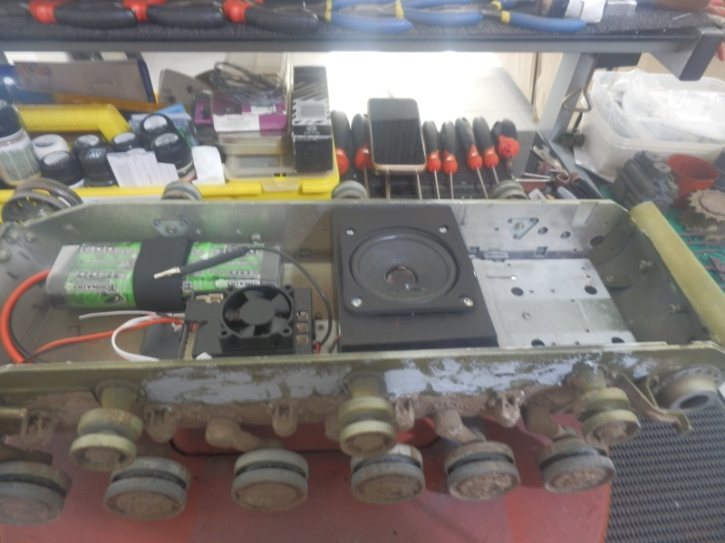

Little bit of minor progress during a few precious hours at home.
Tidied up the inside, made a speaker box for a Visitron 7 boom-box, and secured the bits with double sided tape.
