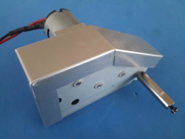

To keep the inside of the tank clean I made some covers.
IMG_20190829_121104 (2) (Small).jpg (72.79 KiB) Viewed 7006 times

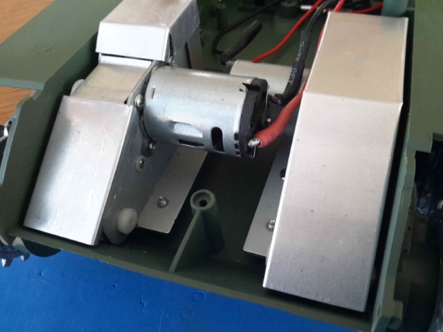

Post by walter »
Opposite view.
IMG_20190829_121049 (2) (Small).jpg (62.19 KiB) Viewed 7005 times
walter
Posts: 567
Location: Geelong Australia
Re: Metal upgrading new Heng Long Panther G
Post by walter »
Inside tank.
IMG_20190830_122636 (2) (Small).jpg (83.52 KiB) Viewed 7004 times

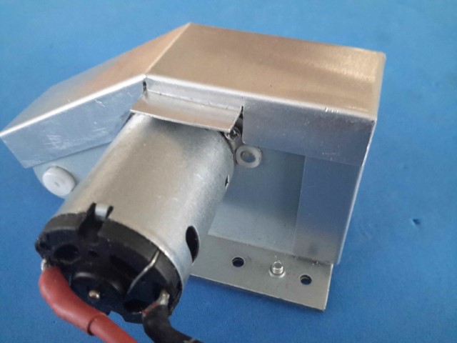

Post by walter »
To prevent motor wires from breaking of I did this.
IMG_20190829_120415 (2) (Small).jpg (89.82 KiB) Viewed 7002 times

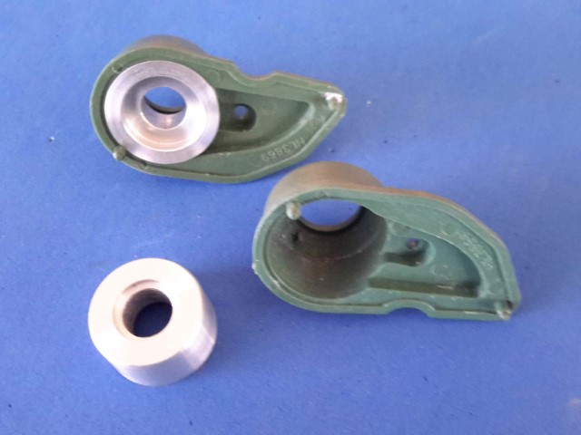

Post by walter »

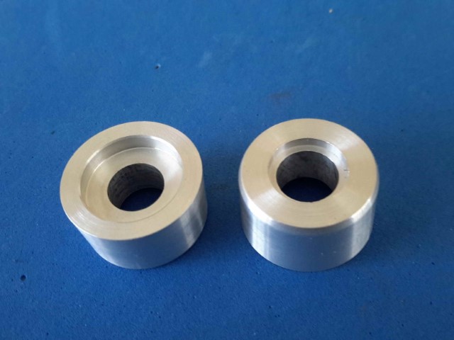

Housing for bushes.
IMG_20190823_113240 (2) (Small).jpg (74.03 KiB) Viewed 7000 times

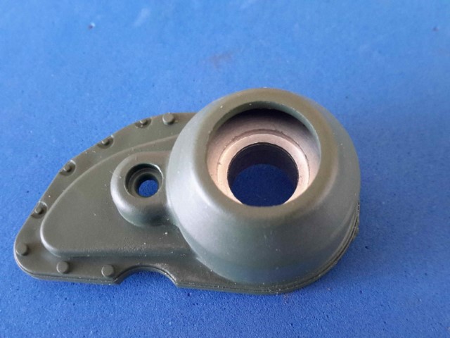

Post by walter »
Bushes in place.
IMG_20190827_120157 (2) (Small).jpg (76.84 KiB) Viewed 6998 times

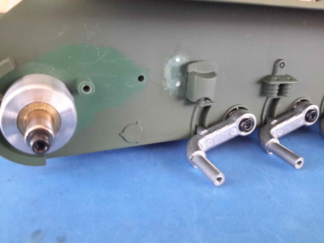

Post by walter »

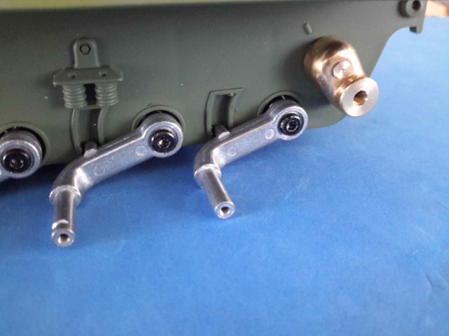

Idler arm.
IMG_20190827_120253 (2) (Small).jpg (77.31 KiB) Viewed 6997 times
