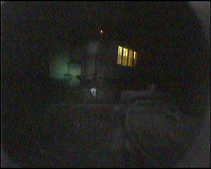

Bit of a numpty statement in earlier post. No need to fit an IR lamp on the tank hull as i have the standard Heng Long head light. It seems its actually throwing more light than my 3 IR LEDS. You definitely need some sort light so you can tell which way the turret is pointing.
tankfpvIR has some ambient light from the windows. You can see the muzzle break in the center. The lower half is the top of the turret with the commanders hatch on the right (closed). To the left of the gun you can see a garden pot. Its about 5ft from the tank. Ignore the red dot near the top its another IR device.
Night.
Night.

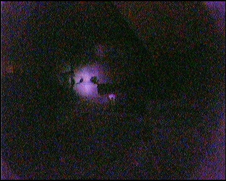

Last one is a different night without the ambient light. Really dark. Bit closer and you can see the pot using just the tanks IR illumination.
Very low light.
Very low light.
These are poor images. The tank is outside with the image sent to the receiver indoors and fed by a capture device into a laptop. The image is a bit better just on a screen.
The illumination just works out to about 6ft but it depends on the reflectivity of the surface. Its enough to stop you driving into objects though.

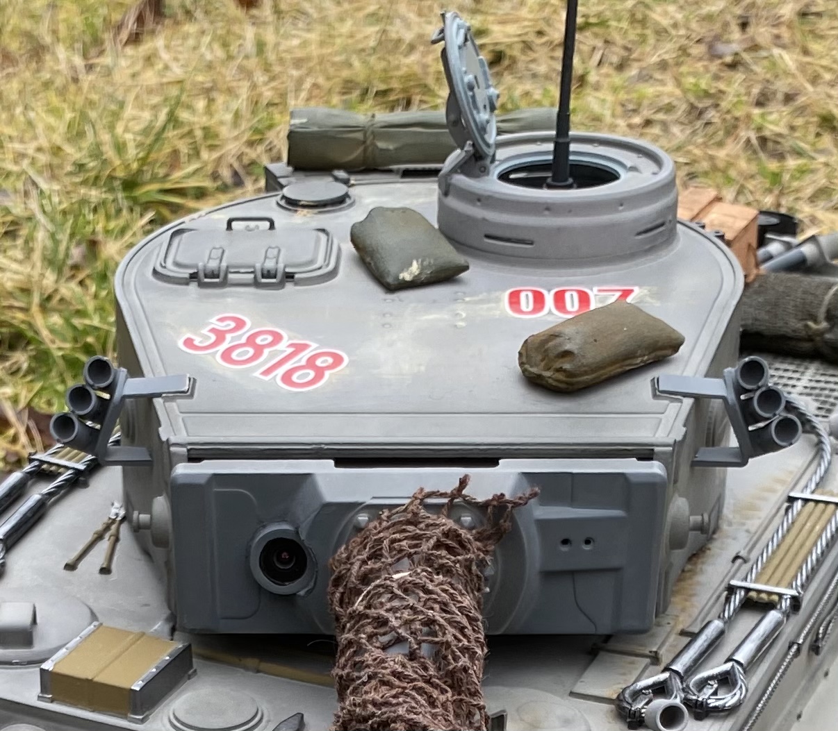

This is my setup. I used a cheap FPV kit on eBay and it works pretty well. I didn’t like the way it looked with sticking a camera on the outside so I found away to stuff it all in the turret with my airsoft gun, barrel recoil servo, mini fan to keep the transmitter cool (600mW), and transmitter. I ran the connector for the antenna into the bb hatch so it can close it when not in use and repurposed the airsoft on/off switch to FPV on/off switch so it isn’t constantly running. I can take pictures of the inside of the turret if anyone is interested.

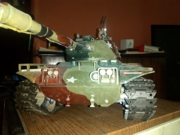

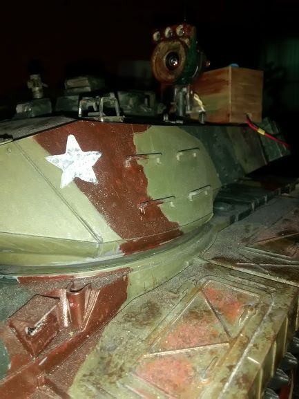

My camera is in the spotlight. It clips on the gun mount so i can switch tanks etc. All my pics are with it on the rear mount.
The 3 lamps on the top are the IR LEDs for night work.

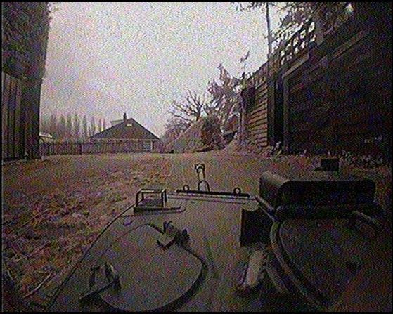

Daylight view.
The wide angle lens is so big the image is clipped in the corners but the rim of the search light.
