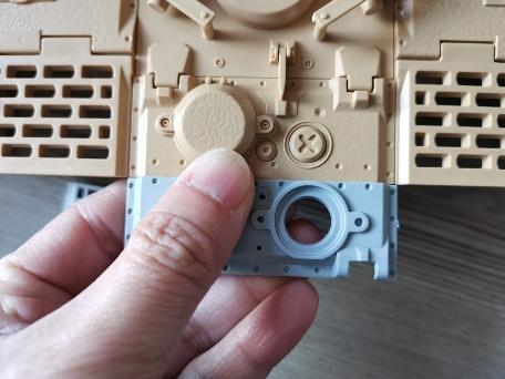

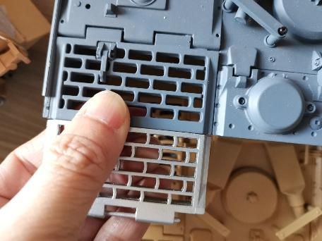

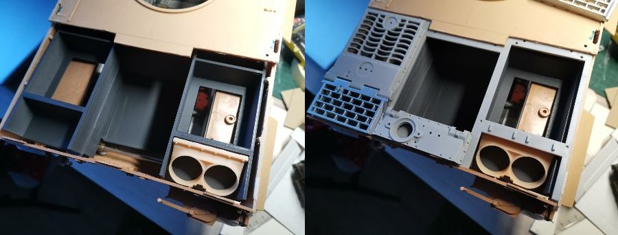

Now a quick comparison with the Taigen/Heng Long hull alongside the Hachette rear deck pieces in case anybody else is thinking of doing a similar project and also it baffled me why the Hachette wasn't marrying up with the hulls so I had a closer look. So the fan grills are of similar size to both HL and Taigen deck, no problems there
Now this is when things start to differ, as you can see from the picture this piece is slightly longer by at least 1mm - not a big difference I admit but it is enough to present problems.
As you can see, an even greater difference in lenght with the Heng Long hull.
So unless you are thinking of using just the side Hachette grills on both Heng Long and Taigen, then it shouldn't present you with too much problems. It's the middle section that will give you a bit more pause.

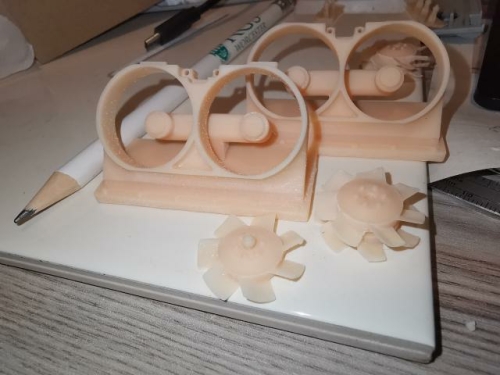

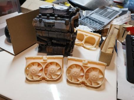

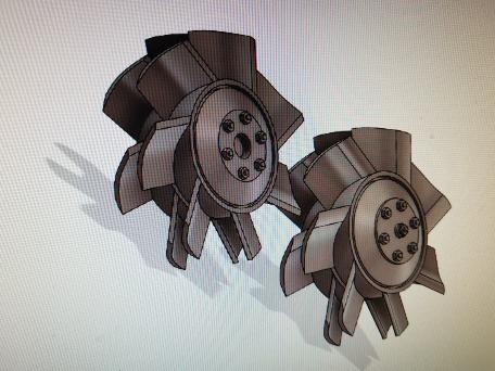

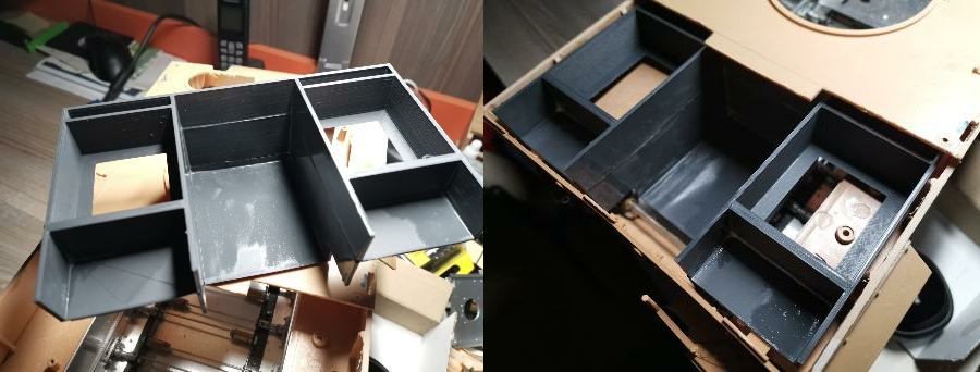

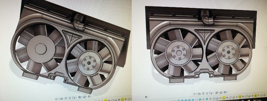

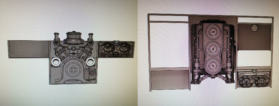

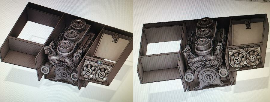

To start with I needed to design the box to go inside the Taigen Hull, I began by creating a maquette using cardboard and then transferring the data onto Fusion so that i can be sure that the rest of the pieces would fit prior to printing. I then printed the box on my FDM printer and kept my fingers crossed and hoped that I had done the correct measurments - 10 or so hours later I was so relieved, now onto stage 2, the gearbox fans and I compiled quite a collection of reference materials but the biggest influence was this picture from a Tiger restoration project Most of my references, mostly other people's project only utilised one blade but I noticed in this Tiger restoration picture that there are 2 blades, one underneath the other and I wanted to intergrate this into my design - 1/16 is big enough to show this so why not?! =) The left fan was the initial concept, the final iteration is the one on the right and it's the one that I printed and assembled fits like a dream =)
So, my idea and you guys will have guessed by now that this JST will be a non-runner as my interest lies mostly in modification, construction, painting and weathering. I do have a few runners in my collection, a Ferhmann Tiger 1, a King Tiger, a KV and a Panzer1, all in boxes and collecting dust sadly. Anyway, since I have these awesome Hachette pieces and the fact that they are workable I wanted to have something to show if you open up the deck. I don't know if there are aftermarket parts for the engine etc or if those will fit but I decided to fire up Fusion360 and get building in cyber space.

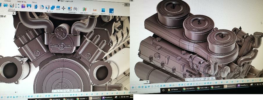

Anywho, as you would have noticed from previous pictures I have in my possession a 1/16 Maybach HL 230 engine. Now I don't know much about this but I believe this is an early engine!? This was eventually replaced with a better version, the HL 210 is that right!? Okay i just did a quick google and I am none the wiser what version is what - 230 is the upgraded version but when i google 230 it mostly shows me this two cylinders engine design!? 210 being the three cylinders on top!? I'm confused - I wanted to use the three cylinders one - which one is that one and do i have to change the marking on my render!?

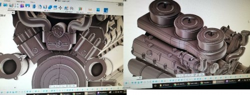

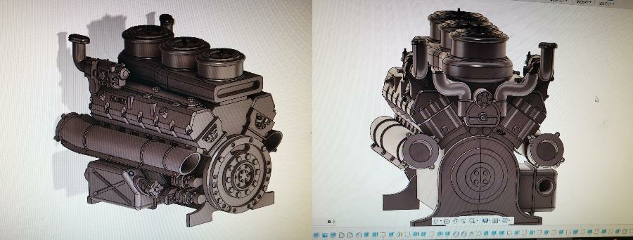

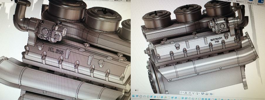

Well I designed the 3 cylinders version using lots of picture references as well as using my model example for measurements. This is by no means accurate as I'm finding it very difficult to find good actual photos of the real thing but it gives a good impression anyway and it's as close I can get it. this is still WIP but mostly the top part is done - the part that's going to show up anyway. the cables, plumbing etc will be added after printing using wires, tubes etc. Here I'm using artistic licence with the markings Unfortunately the full engine is just too big to fit inside and it is a very tight fit in there. I'm going to have to chop at least 20mm from the bottom to make it fit but it should be fine as the side and bottom details aren't going to be seen anyway and cables will hide the rest. Now time to take a break.
no longer will i have to deal with IPA and nasty chemicals that stinks the place. I would love to make it my go to resin but at 1kg, it is an expensive resin, £43 - roughly £10 more than standard resin of similar quantity but it is a joy to use and clean up. Perhaps I will use it on special projects only.Anywho, as you would have noticed from previous pictures I have in my possession a 1/16 Maybach HL 230 engine. Now I don't know much about this but I believe this is an early engine!? This was eventually replaced with a better version, the HL 210 is that right!? Okay i just did a quick google and I am none the wiser what version is what - 230 is the upgraded version but when i google 230 it mostly shows me this two cylinders engine design!? 210 being the three cylinders on top!? I'm confused - I wanted to use the three cylinders one - which one is that one and do i have to change the marking on my render!?

Phenomenal work on creating the Maybach engine for this JST build, PatrickH. Your devotion to realism is humbling (to me at least). I'm sure you'll not want to omit the upright radiators just behind the fans and probably the gasoline tanks behind them as well, but that's for another time. Here's what seems like a pretty authoritative description of the Maybach HL 210 and how it differs slightly from the HL 230. Surprisingly, your three pot oil bath air cleaner is the earlier HL 210 while the HL 230 has the two pots atop the carbs.
http://www.alanhamby.com/maybach.shtml

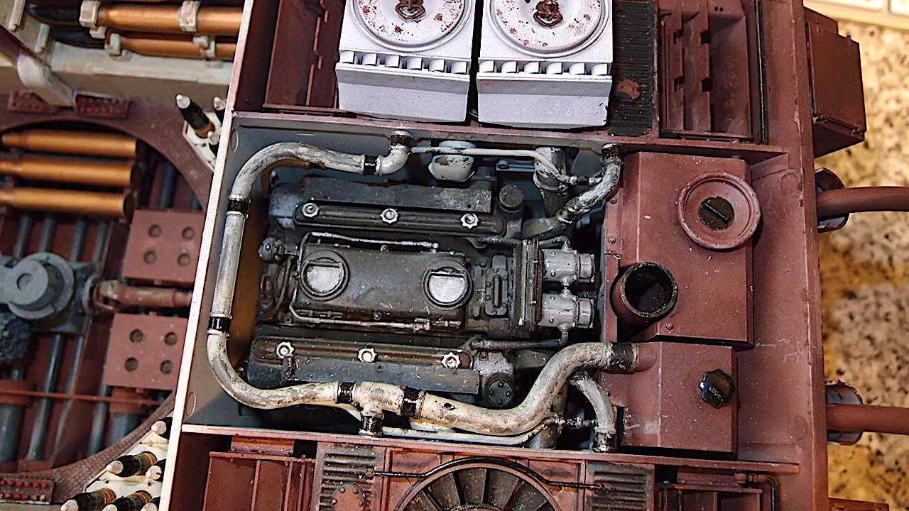

Engine pics , the later 230 engine in the panther . This is how trumpeter do the hoses etc.

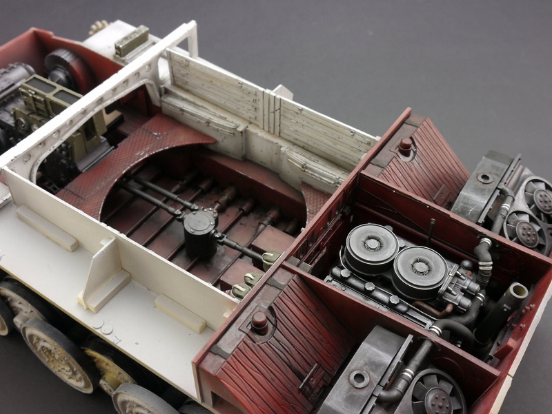

Don't know how far you intend to go with your admirable quest for engine compartment realism, PatrickH, but maybe this will be of some value.
