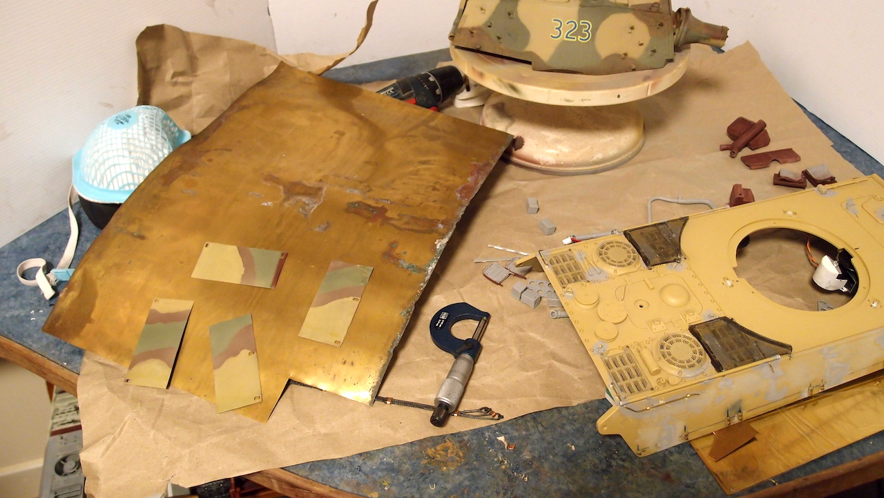

Re: Using Photo-etch parts
Why not find some brass sheet, got one and its .3mm perfect for the panther as its .3 * 16 so almost perfect for Panther side skirts . Another plus is its stronger and holds its shape better that Aber PE and still easy to work with.

Thanks, HB, Richard, and Ronnie (with the good looking micrometer!).
