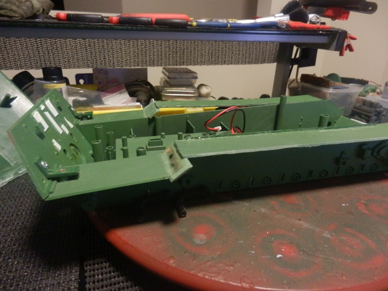

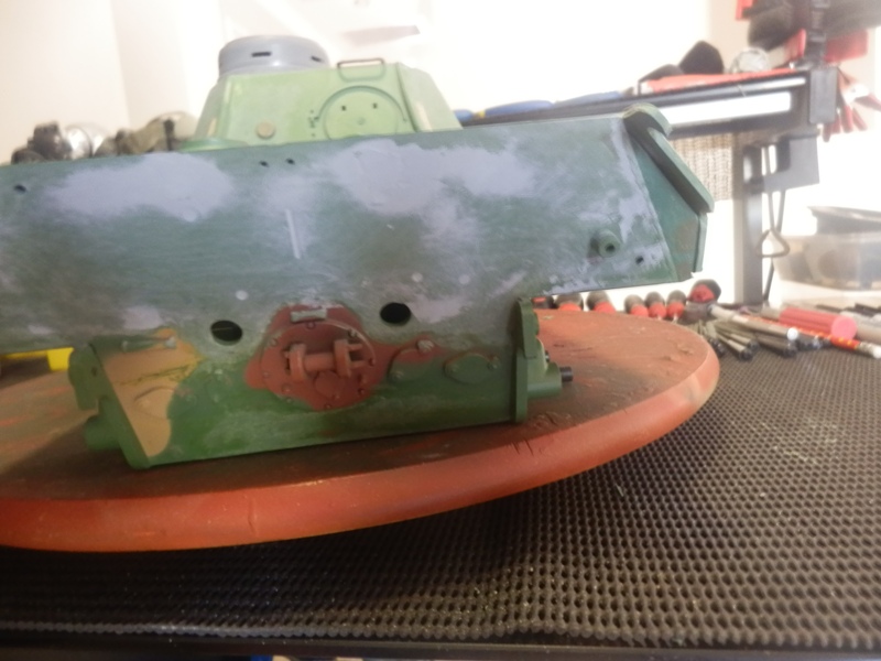

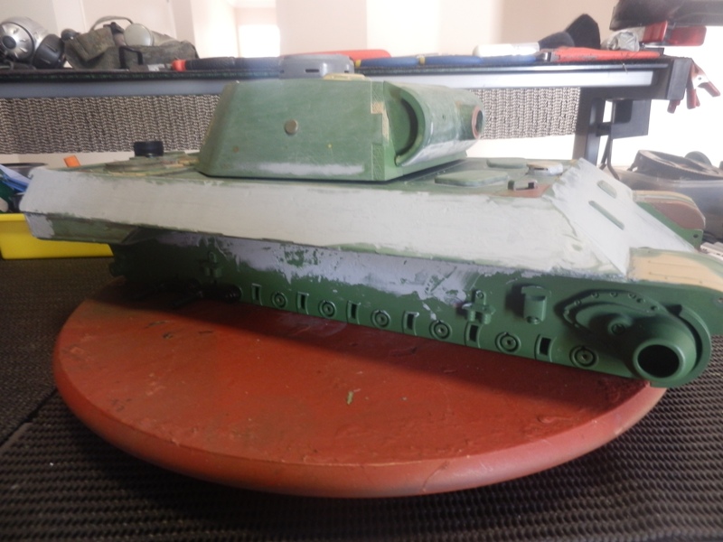

Ive got almost all the hull blemishes out, and used a lot of putty in the process.
Next A/D I do(and you just know there will be one) I will melt plastic into/onto each blemish as required, then sand, then putty & sand to finish.
As I mucked up the rear quarters by 3mm a side when I set the side plates in place, I've had to make fill in pieces to allow the overlap of the sides to the rear plate. :problem:
I was kicking myself, but then in a moment of calm reflection I just asked myself "what would Mr Mcq11 or Mr Hugill or Mr 'C' do" ?
Certainly not get the sooks on & leave it !!
The sides now look right to the rear, and all thats left to fix there is a final sand off , fit the stowage bins & exhausts then its on for the electronics, and set the upper in place for detailing.

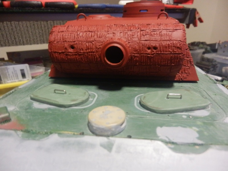

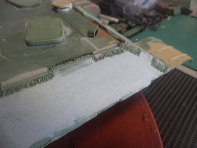

Ive got the welds done around the deck plate to accentuate the unique interlocking design on the early D versions.
Plan to sand them down a little to reduce the coarse texture but still highlight the feature.
All welds & cutting marks are done.
Hull now needs the rear plate doing and handles & hooks placing.
I intend making the handles from paper clips.

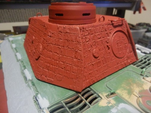

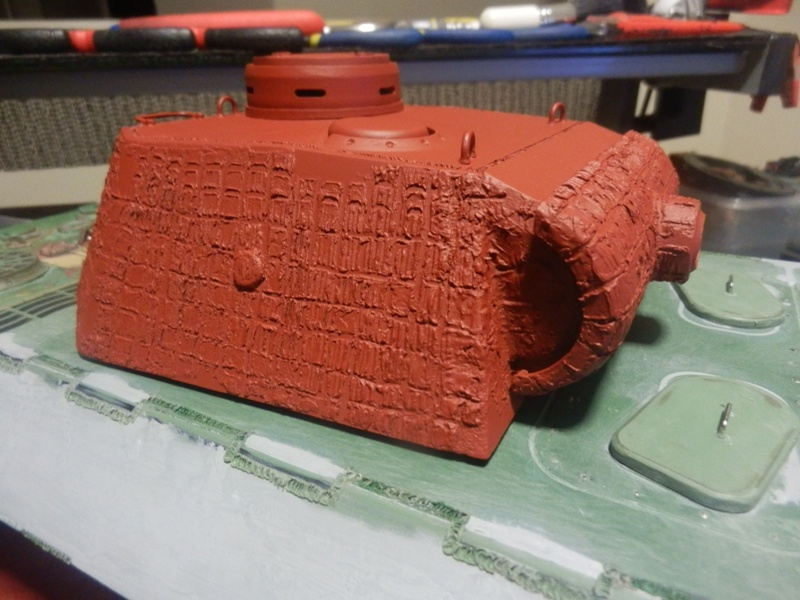

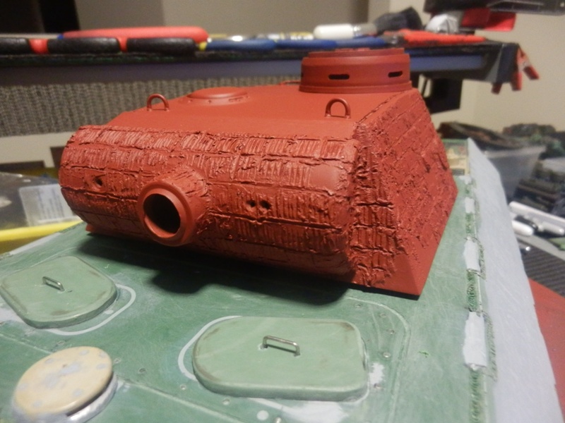

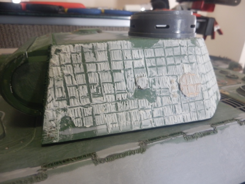

The turret has its square patch zimmerit. What a pain that was !!
I used acrylic gap filler as its slow cure, easy to apply and is slightly flexible.
Its a fair representation of a well aged field applied pattern that again, will be sanded & picked at to reduce the peaks and blend the edges.
There is a bit of panzer-putty mask application later on, but not so much as the F05 Tiger that is going to be a drag ;)
Mounts and blade action soon
Cant wait to get primer on it

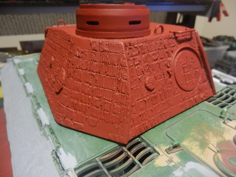

Posts: 11546
Re: RAMSCHAUFELPANZER PANTHER

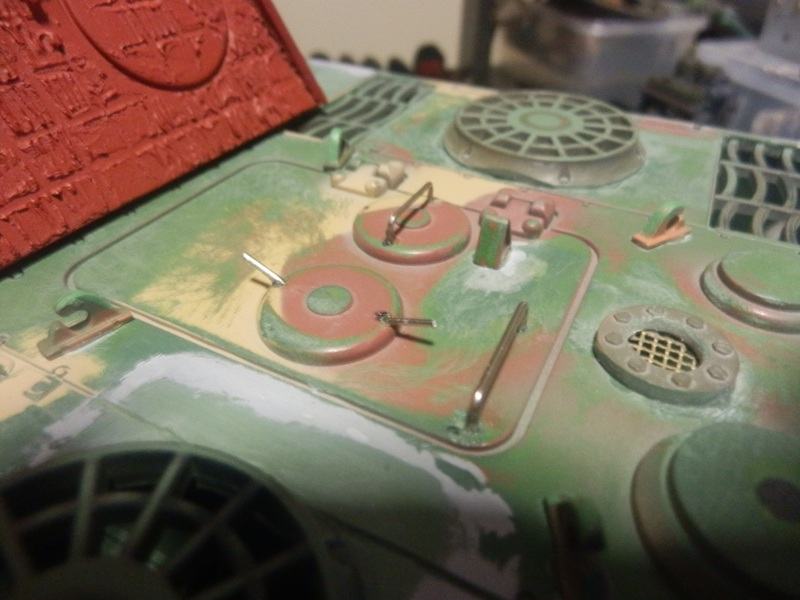

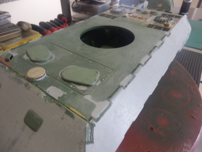

Bit more done.
Various handles & hooks fitted. The early D's had the handles on the access caps on the engine deck hatch made as short "prongs" either side of each cap. Mine has one of the older ones, & one of the newer ones that had a more conventional handle right across the cap.

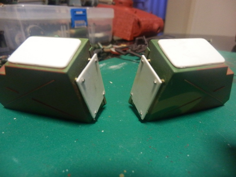

Ive also added the heat shields to the stowage bins. The lids are going to have representative hinges & latches added.
They will go on once the glue has set.
Used short cuts of brass tube as the stand offs, then secured dress making pins through holes drilled into the bins, and super glue all joints.
They will look ok for what they need to be.
Going to use strips of left over brass sprue from assorted vent screen mesh PE to represent the hangers used to attach the bins and side tool brackets to the upper deck plates. The orders were not to weld to the face of the side armour , it would compromise the face hardening.
Only the cleaning rod/ aerial tube straps were stitched to the side armour.
The spare track link hangers were also welded to straps which were bolted to the engine deck.
Soon to repair the front periscope guards, just trying to find the right shaped clothes peg ;)
Got primer on the turret. Looks right now !
The zimmerit is about right for the tank-dozers age, and its abuse over time to when the picture was taken.
You sir are the king of Zimmerit :clap:
