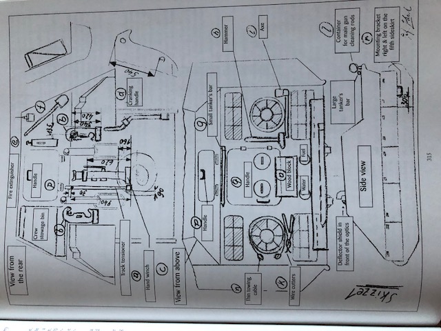

Revisiting a book I came across this bit of gold.
This image has been sketched as a suggestion for relocation the stowed tools etc.
The text says ‘illustrations which originally accompanied the recommendations from the field for modifications to the Jagdpanther. English translations have been pasted over the original German terminology. Abt 654 is a unit I was going to look at for camo ideas but I will try out this tool rearrangement. I like how individual units varied tool arranging or added certain hooks and hangers.
Copywrite to the image and quoted text is from the book The Combat History of schwere Panzerjäger Abteilung 654, by Karl Heinz Münch

Interesting source material you've accessed there, Sinj.sinj wrote:Revisiting a book I came across this bit of gold.
